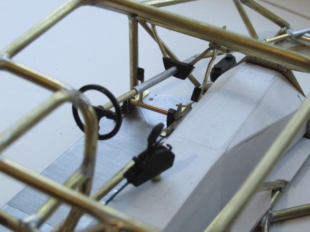

Ian McLaren Posted January 8 Author Share Posted January 8 Next step , rack mounted and the basic shaft components mocked up. Have to come up with three covered U-joints, and I think Paul and I are both on the same wave length for at least one way to accomplish this. 3 Quote Link to comment Share on other sites More sharing options...

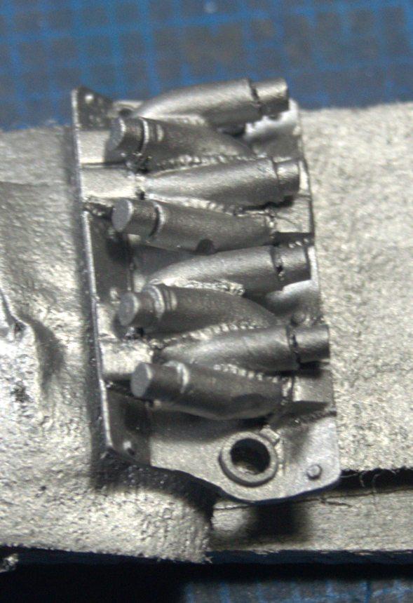

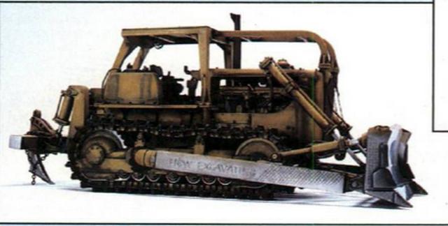

Straightliner59 Posted January 9 Share Posted January 9 13 hours ago, Ian McLaren said: Thank you Francis, According the the National Harassment Runaround Association the floor has to be .024" steel welded in on the drivers side only (rivets are out). Mine is steel, but only .008" but I'm not seeing anyone checking that in the future LOL. I've been playing around with different effects to simulate the welds but haven't found anything I'm happy with so far. It's getting painted with the chassis color so I may be over thinking it. Loving your Demon project! Ian, I knew a guy who "hard-faced" the blade on an AMT bulldozer. He used a brush to apply beads of paint, to simulate weld beads. They were amazing! You can see some of it on the blade arm, here. Sorry I don't have a better picture. That might be worth a try. I made welds for my Supermodified's injection manifold by rolling the knurled end of a cap screw over .010" plastic rod. That worked out, pretty well. 2 Quote Link to comment Share on other sites More sharing options...

Ian McLaren Posted January 12 Author Share Posted January 12 Brake and throttle pedals mounted, steering gear, shaft, and wheel in place. shifter and cable placed. Long block and transmission can now have mounts made and final position determined.. Then the headers can be started 3 Quote Link to comment Share on other sites More sharing options...

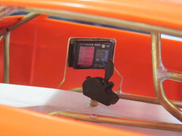

Ian McLaren Posted January 15 Author Share Posted January 15 (edited) Delay box and mount fabricated and positioned, as well as front and rear motor plates not are the only support for the engine and new style valve covers modernize the model. Edited January 15 by Ian McLaren 4 Quote Link to comment Share on other sites More sharing options...
Straightliner59 Posted January 15 Share Posted January 15 That delay box looks right at home, alongside that shifter! This thing is looking, and coming along great, Ian. Quote Link to comment Share on other sites More sharing options...

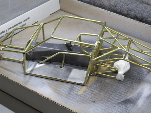

Ian McLaren Posted January 16 Author Share Posted January 16 (edited) Today was about adding some additional bars to the chassis, rear transmission cross member for one, and working on the interior, as well as trying to fit a stock style dash housing instead of the typical box style race piece usually found in this class of car. Edited January 16 by Ian McLaren 4 Quote Link to comment Share on other sites More sharing options...

Ian McLaren Posted January 23 Author Share Posted January 23 Building a chassis jig to allow the design and fabrication of the remaining suspension pieces, ride height is set and the wheelbase is locked in at 111" This will also assist in the fabrication of the headers further along. 3 Quote Link to comment Share on other sites More sharing options...

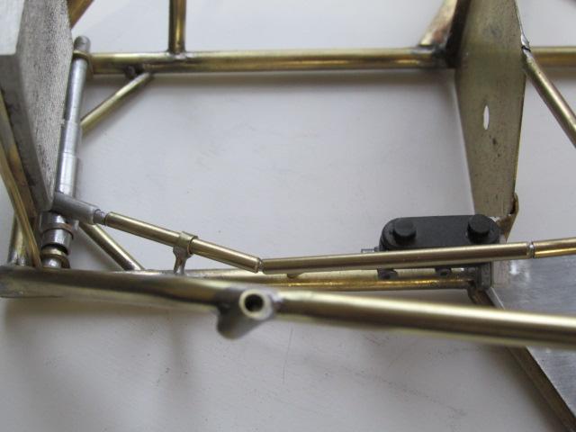

Ian McLaren Posted January 24 Author Share Posted January 24 Started on the rear suspension. 2 Quote Link to comment Share on other sites More sharing options...

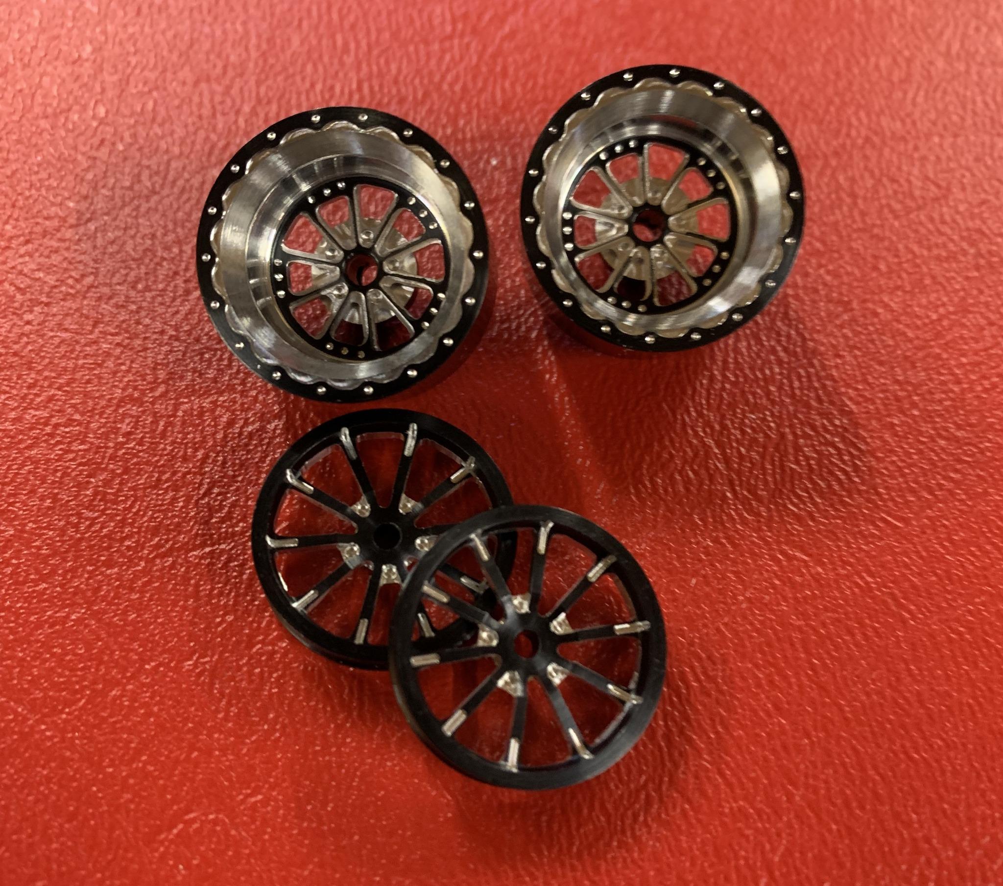

Ian McLaren Posted January 25 Author Share Posted January 25 (edited) 5 hours ago, TerryH said: Ian's full on custom wheels are awesome. For something similar that's commercially available, and you may already know bout these, pardon me if so, but I ordered wheels for my Nitro Nova project car from Dancing Bear Scaled Components. $90 for the set of 4. https://www.dancingbearscaledcomponents.com/model-wheels Yes those look great but, they don't appear to be polished, but the black is cool. Also I have not seen the wheel Jeff did modeled to this point ( I may be wrong on that). I finally got a good photo of the wheels, the center is the axle end, there is no centering ring just like the full size wheels. Also these wheels have separate individual RB Motion bead lock bolts ( not installed yet on both front and rear faces.. Edited January 25 by Ian McLaren 2 Quote Link to comment Share on other sites More sharing options...
