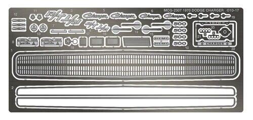

Dpate Posted November 25, 2022 Share Posted November 25, 2022 This is the best route if you don't wanna deal with trying to remove the symbols. Tamiya flat chisel would work pretty good at removing the lettering with patience. 2 1 Quote Link to comment Share on other sites More sharing options...

Ace-Garageguy Posted November 25, 2022 Share Posted November 25, 2022 Dpate's suggested PE replacement is the hot setup if you want a really nice job....unless you're really really good working with riffler files and micro tools under magnification. 1 Quote Link to comment Share on other sites More sharing options...
Can-Con Posted November 25, 2022 Share Posted November 25, 2022 6 hours ago, Ace-Garageguy said: Dpate's suggested PE replacement is the hot setup if you want a really nice job....unless you're really really good working with riffler files and micro tools under magnification. But how would you deal with the thick horizontal bar across the center? The '68 grille doesn't have that, that's why I didn't recommend the PE set strait off. Quote Link to comment Share on other sites More sharing options...
Ace-Garageguy Posted November 25, 2022 Share Posted November 25, 2022 1 hour ago, Can-Con said: But how would you deal with the thick horizontal bar across the center? The '68 grille doesn't have that, that's why I didn't recommend the PE set strait off. I wouldn't deal with it at all. Frankly, I think the horizontal bar would look vastly better than the almost inevitable hacked and bodged mess that would result from any of the other suggested methods. Quote Link to comment Share on other sites More sharing options...

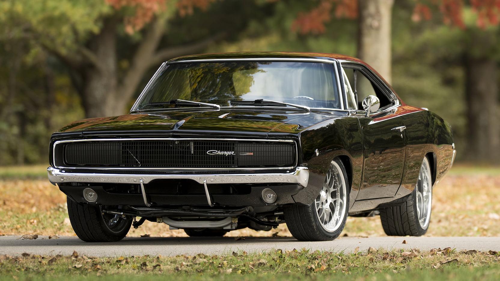

Can-Con Posted November 25, 2022 Share Posted November 25, 2022 48 minutes ago, Ace-Garageguy said: I wouldn't deal with it at all. Frankly, I think the horizontal bar would look vastly better than the almost inevitable hacked and bodged mess that would result from any of the other suggested methods. Better yet, just paint the grille section flat black and just highlight the "Charger" script. It would hide the RT emblem behind a rectangular emblem [3 on that '70 photoetch sheet] and it would look pretty good. Quote Link to comment Share on other sites More sharing options...
Dpate Posted November 25, 2022 Share Posted November 25, 2022 (edited) 21 minutes ago, Can-Con said: Better yet, just paint the grille section flat black and just highlight the "Charger" script. It would hide the RT emblem behind a rectangular emblem [3 on that '70 photoetch sheet] and it would look pretty good. Your pic matches the photoetch besides the bar in the center i doubt it'd be that noticeable once it's inside the actual part painted or not painted shadows would help with that. But there looks like there is different versions of the grille (or maybe the black painted version makes the vertical part stand out more) because this pic here is more on point with the kit part. The 2nd pic is on par with your pic. Either way would look great unless he is dead set on being perfect with it? Than might have to try and find a different option resin or something if it exist. Edited November 25, 2022 by Dpate Quote Link to comment Share on other sites More sharing options...
Can-Con Posted November 26, 2022 Share Posted November 26, 2022 3 hours ago, Dpate said: Your pic matches the photoetch besides the bar in the center i doubt it'd be that noticeable once it's inside the actual part painted or not painted shadows would help with that. But there looks like there is different versions of the grille (or maybe the black painted version makes the vertical part stand out more) because this pic here is more on point with the kit part. The 2nd pic is on par with your pic. Either way would look great unless he is dead set on being perfect with it? Than might have to try and find a different option resin or something if it exist. It's just the way they're painted, Dusty. If you look closely at the grille in the gold car, just under the gap between the Charger lettering and emblem, you can just make out the small horizontal bars in the grille. The silver paint on the vertical bars hides them well compared to the all black grille. 1 Quote Link to comment Share on other sites More sharing options...
