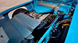

dwc43 Posted January 12 Share Posted January 12 22 minutes ago, TooOld said: I noticed that when I fit the engine into the chassis , looks like Salvino's may have missed this . I've looked at a couple of finished models on line and they both have the tube/caps modified to sit much lower . Haven't decided yet how to handle this . Well, I had some ideas. It's supposed to be rubber hoses on the valve cover area, can you angle the tube forward to drop it, or cut down the "rubber" area and lower the whole assembly? Looking at your pics, it may already be on the distributor. Might have to file a flat spot on the bottom of it to clear the distributor. I doubt it would be noticeable after completion. Quote Link to comment Share on other sites More sharing options...

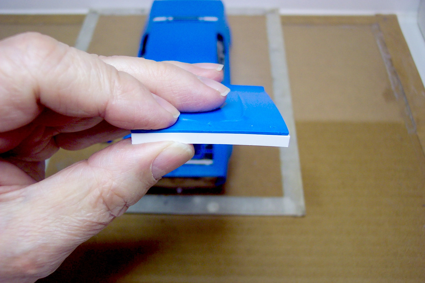

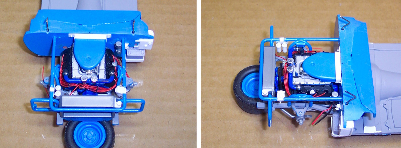

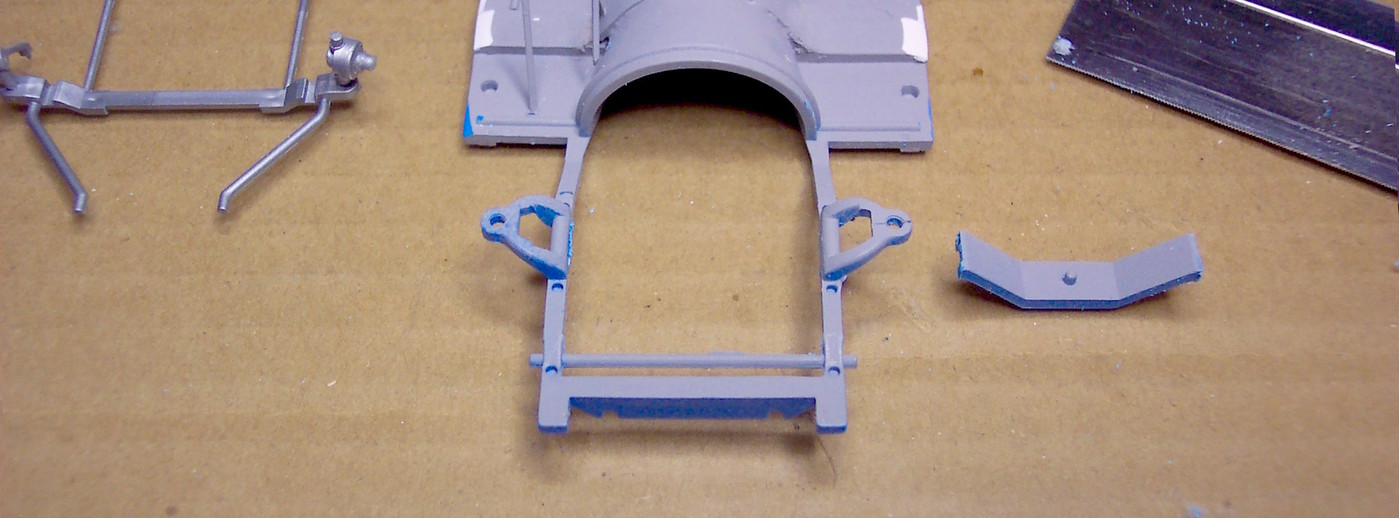

TooOld Posted January 16 Author Share Posted January 16 (edited) While taking a closer look at modifying the crossmember I found that the engine still wouldn't go any lower because the front header tubes would hit so I chose a more radical option of replacing the entire crossmember . Doing this I can lower the engine and eliminate any chances of interference later on . . . one less thing to worry about . A simple crossmember was fabricated using the front suspension as a guide . The suspension is still removable so everything can be painted . With the engine installed and the body back on another check was done . Plenty of clearance and no other modifications are needed ! And the hood closes just fine . It was probably overkill but in this case I felt it was the best option . If I were to build another one I'd address this while building the engine and save myself a lot of time and headaches . Edited January 16 by TooOld 2 Quote Link to comment Share on other sites More sharing options...
Pierre Rivard Posted January 16 Share Posted January 16 Not overkill, you are addressing what the kit designer should have done right in the first place. Great fix! 2 Quote Link to comment Share on other sites More sharing options...

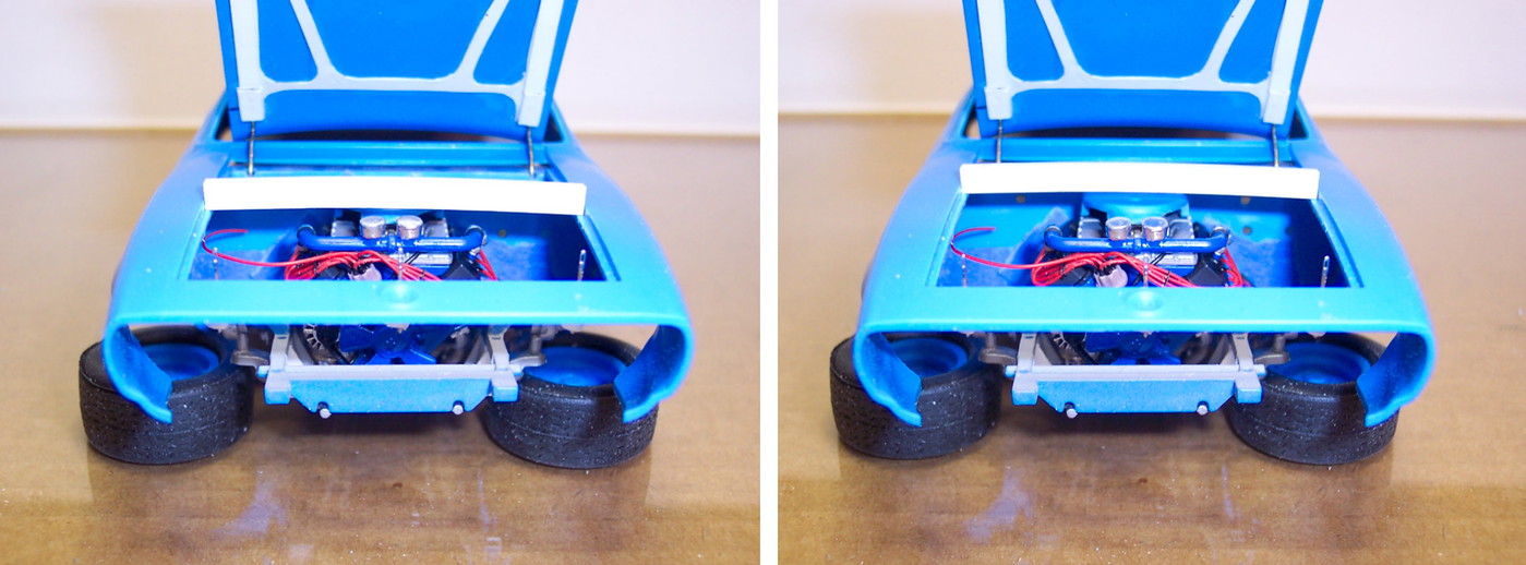

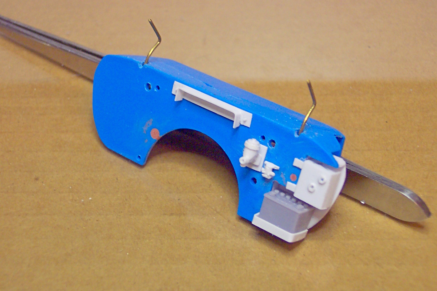

TooOld Posted January 19 Author Share Posted January 19 Made a little more progress by modifying the firewall to add an oil tank , battery , and the air intake . And a shot with everything set in place , nothing is glued so it may be a little crooked . The oil tank is just a block of plastic with a couple brackets and fittings added , not 100% accurate but it will barely be seen when it's all finished . The battery is a resin one I had laying around . I think the small piece that joins the air intake to the housing will make a big difference in the appearance of the finished model . Quote Link to comment Share on other sites More sharing options...
dwc43 Posted January 19 Share Posted January 19 2 minutes ago, TooOld said: Made a little more progress by modifying the firewall to add an oil tank , battery , and the air intake . And a shot with everything set in place , nothing is glued so it may be a little crooked . The oil tank is just a block of plastic with a couple brackets and fittings added , not 100% accurate but it will barely be seen when it's all finished . The battery is a resin one I had laying around . I think the small piece that joins the air intake to the housing will make a big difference in the appearance of the finished model . That looks awesome. Quote Link to comment Share on other sites More sharing options...

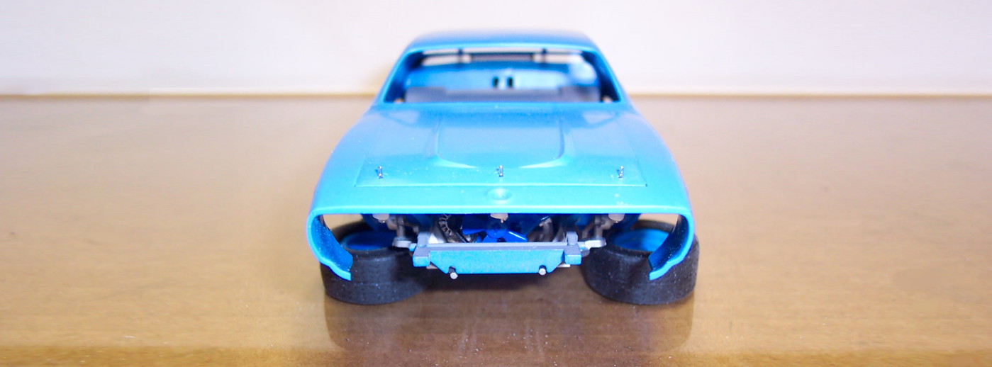

TooOld Posted January 25 Author Share Posted January 25 (edited) I did a quick mock-up of the engine compartment to make sure everything fits and there's no interference between parts , it's pretty tight but looks like all's okay . I've modified the radiator adding a cap , added dual coils , and added a starter solenoid to the firewall . That's about all I can do before paint so it's time to move on to the interior and chassis . Edited January 26 by TooOld 3 Quote Link to comment Share on other sites More sharing options...
