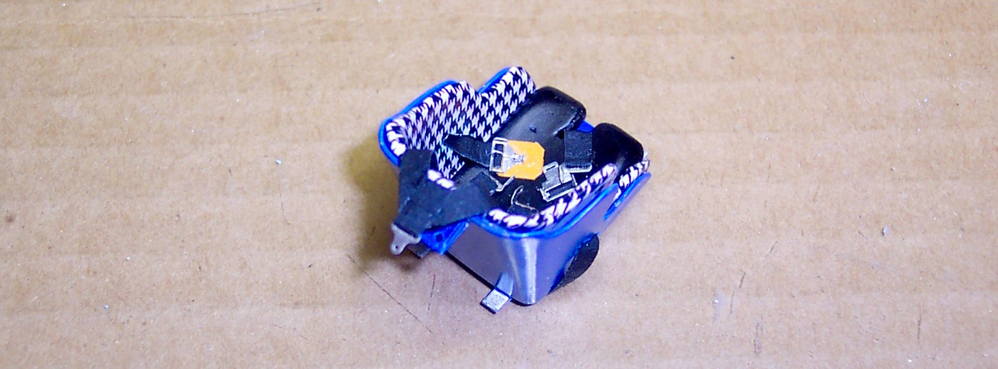

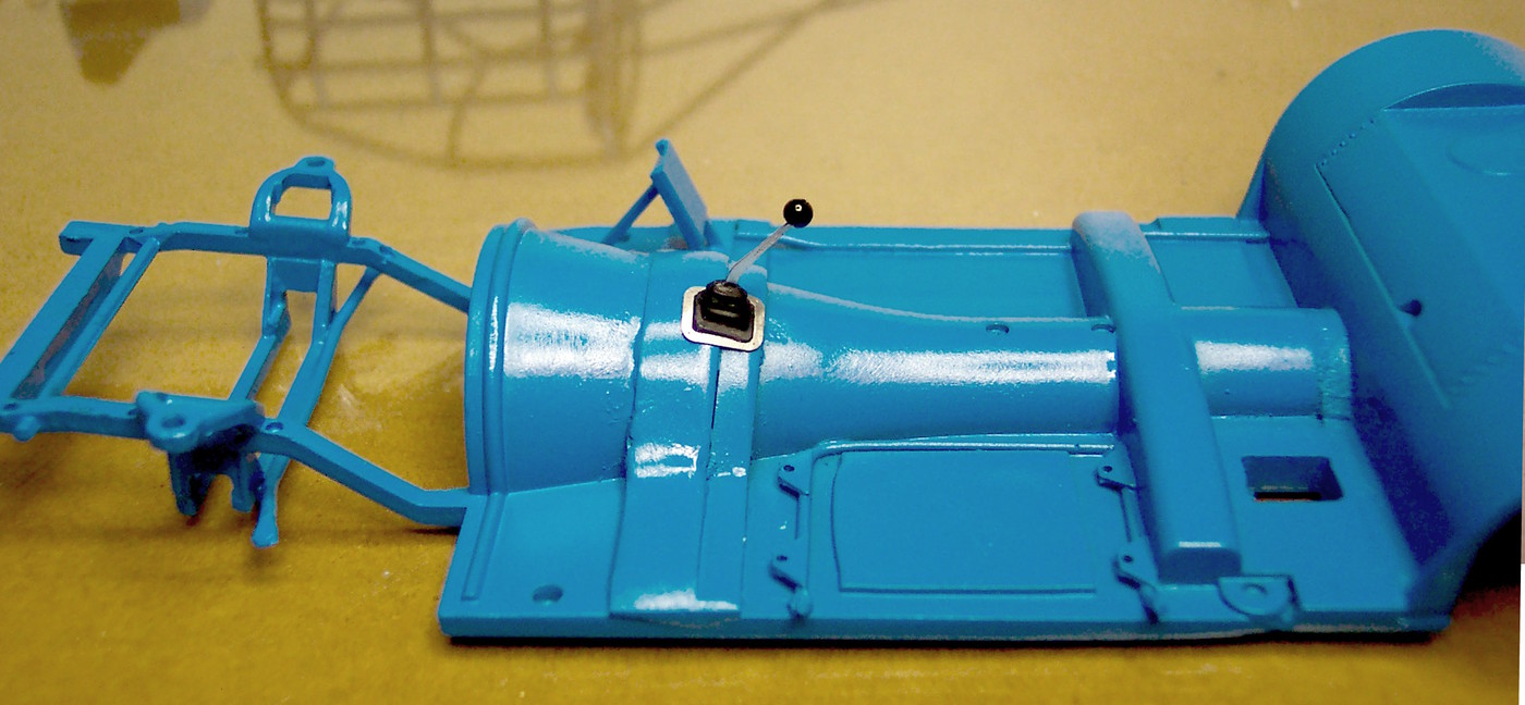

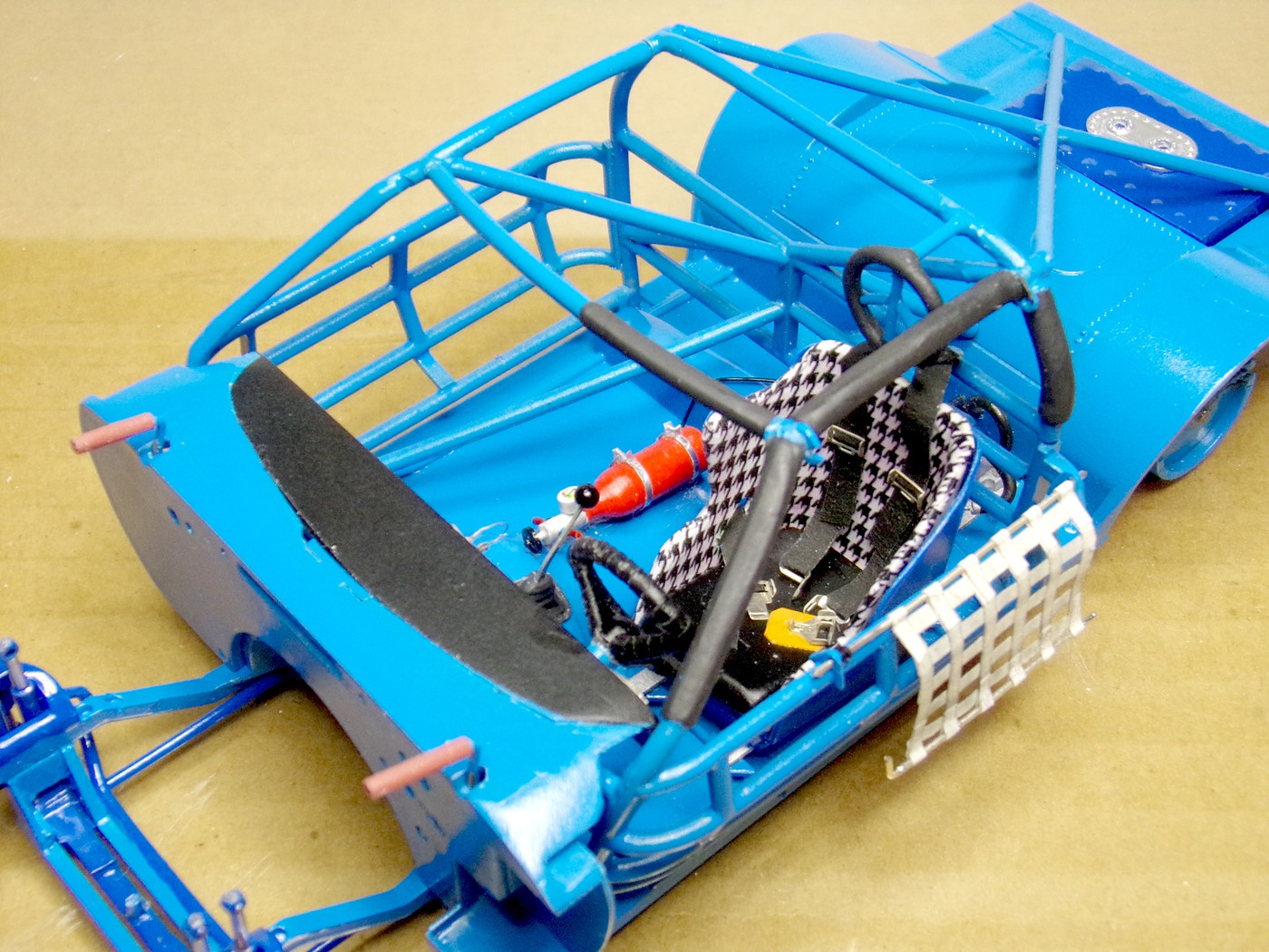

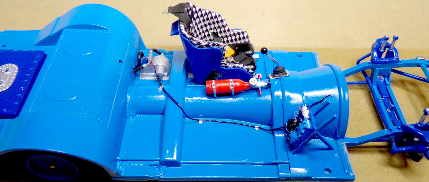

TooOld Posted February 21 Author Share Posted February 21 I managed a couple of quick additions last night . First I made the shoulder belts into a "Y" belt to attach it to the roll cage . And I worked on a new shifter using a Detail Master set and the shifter boot from the kit . The DM set comes with tiny lead balls that you're supposed to drill but I just cut one from a ball-link chain , it already has the hole . The finished shifter . 1 Quote Link to comment Share on other sites More sharing options...

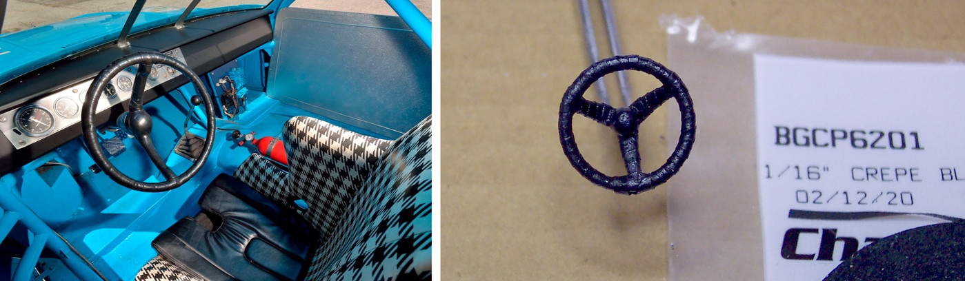

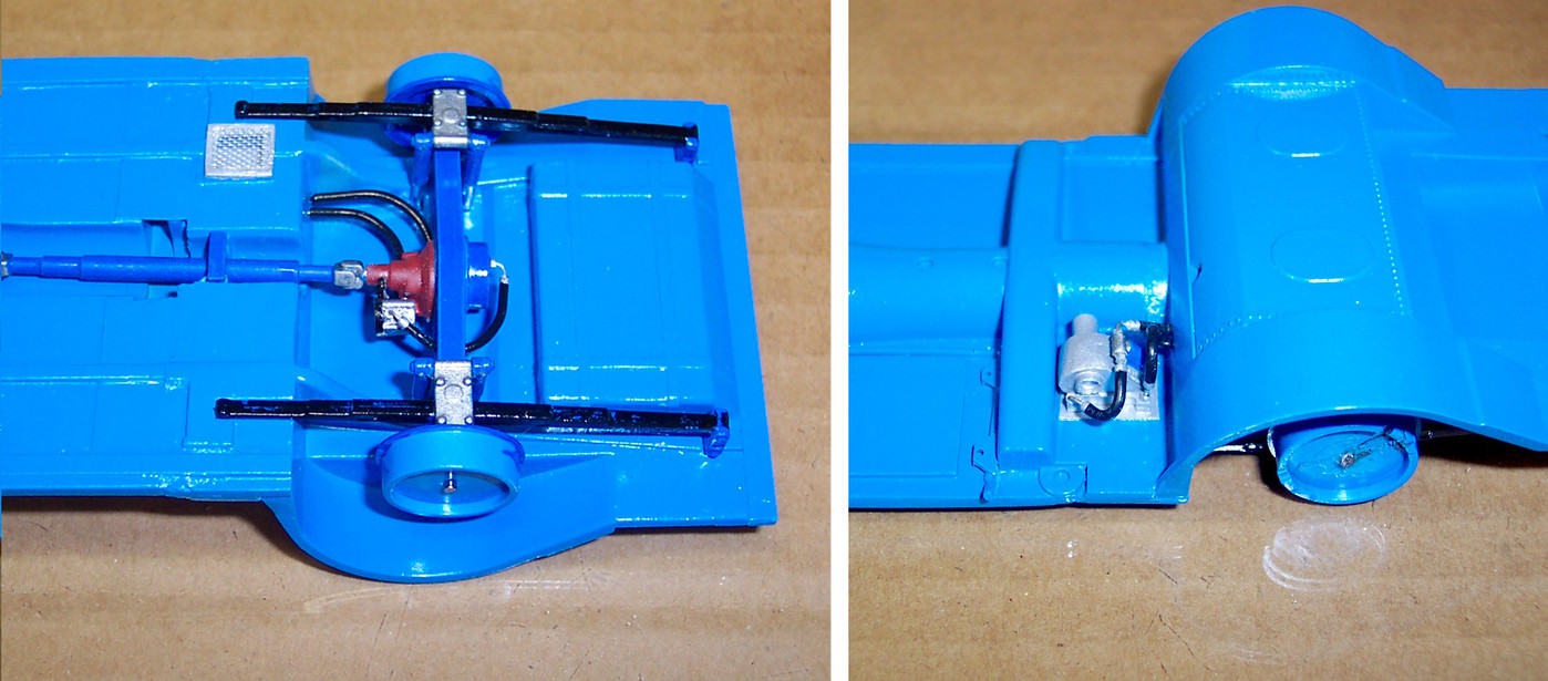

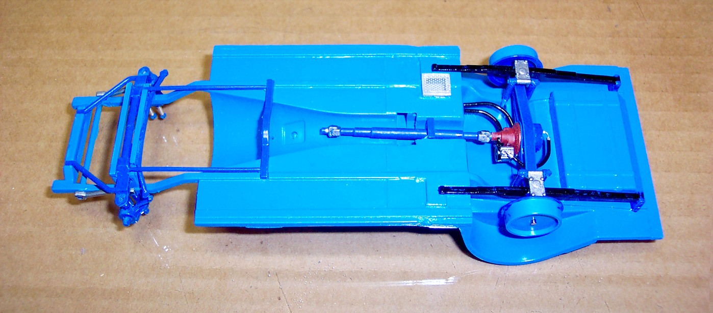

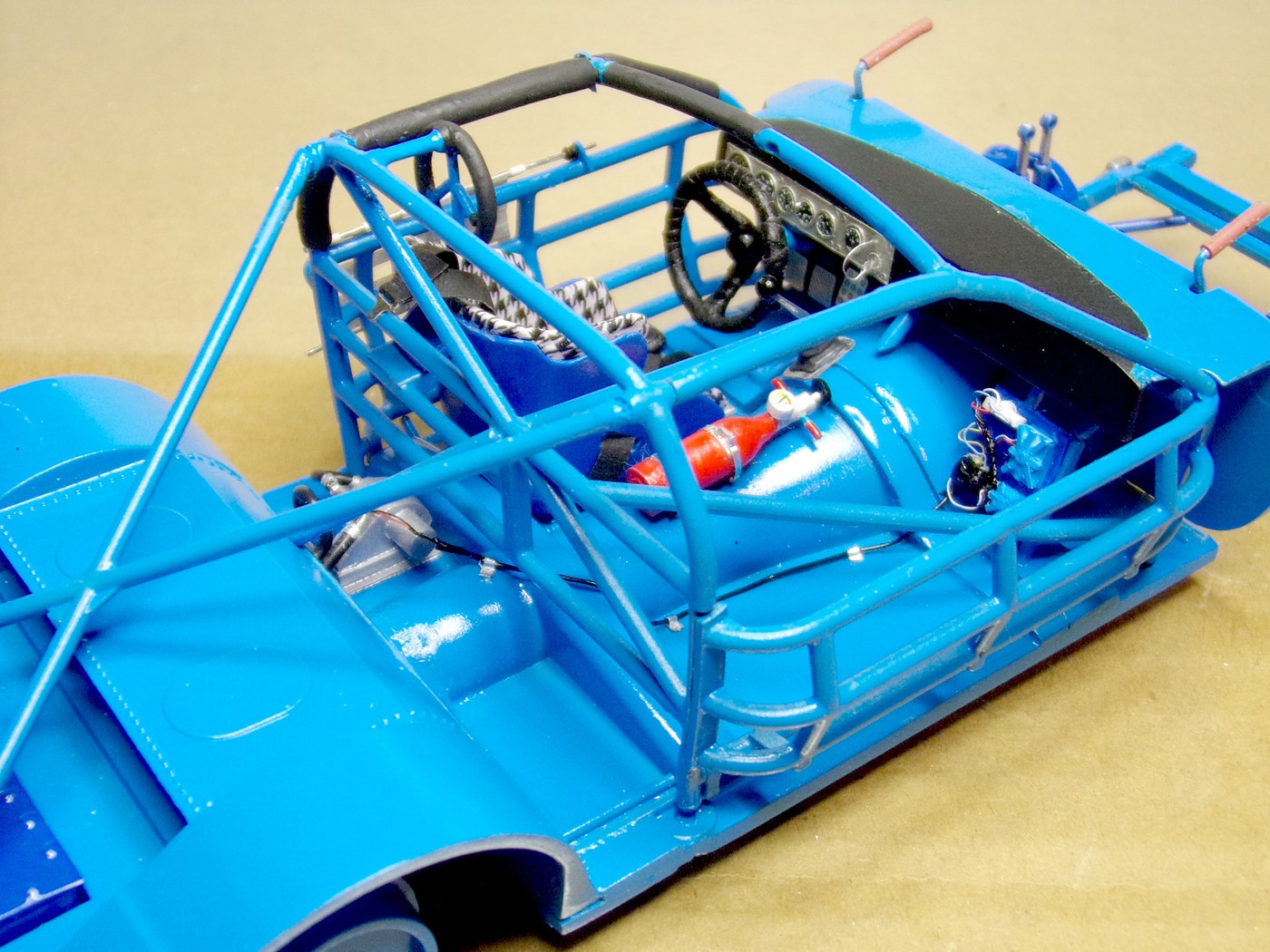

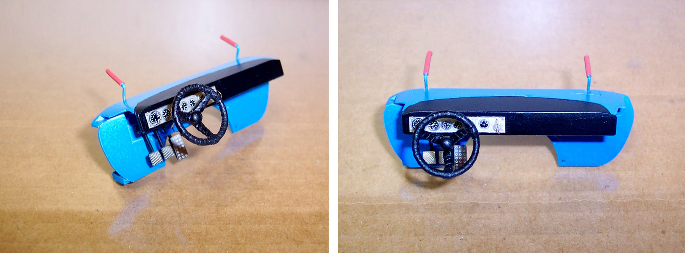

TooOld Posted February 24 Author Share Posted February 24 I tried something different and wrapped the steering wheel with some tape , not the greatest but maybe I can work with it . I was able to tighten the tape before spraying the wheel with some clear , it doesn't look too bad installed on the dash . It's time to start assembling the interior but then I realized I should do the underside first . The last couple of weeks I've been painting all of the parts so it went pretty quick . I also added oil lines for the differential oil pump and cooler . Haven't done anything like this for several years because of arthritis and poor eyesight but I've been feeling pretty good the last month or so and decided to give it a try before things go south again . Now I can move on to the interior ! 2 Quote Link to comment Share on other sites More sharing options...

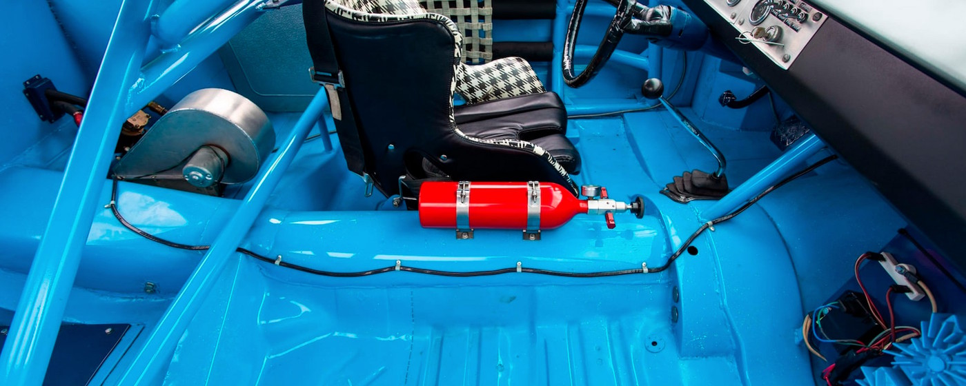

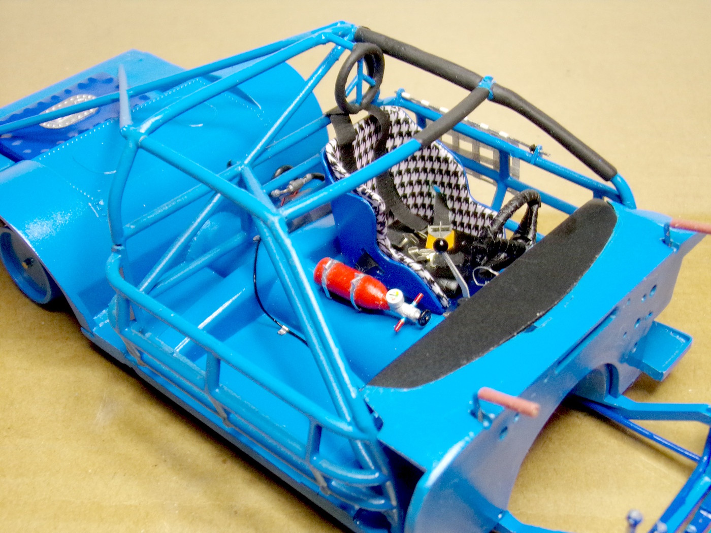

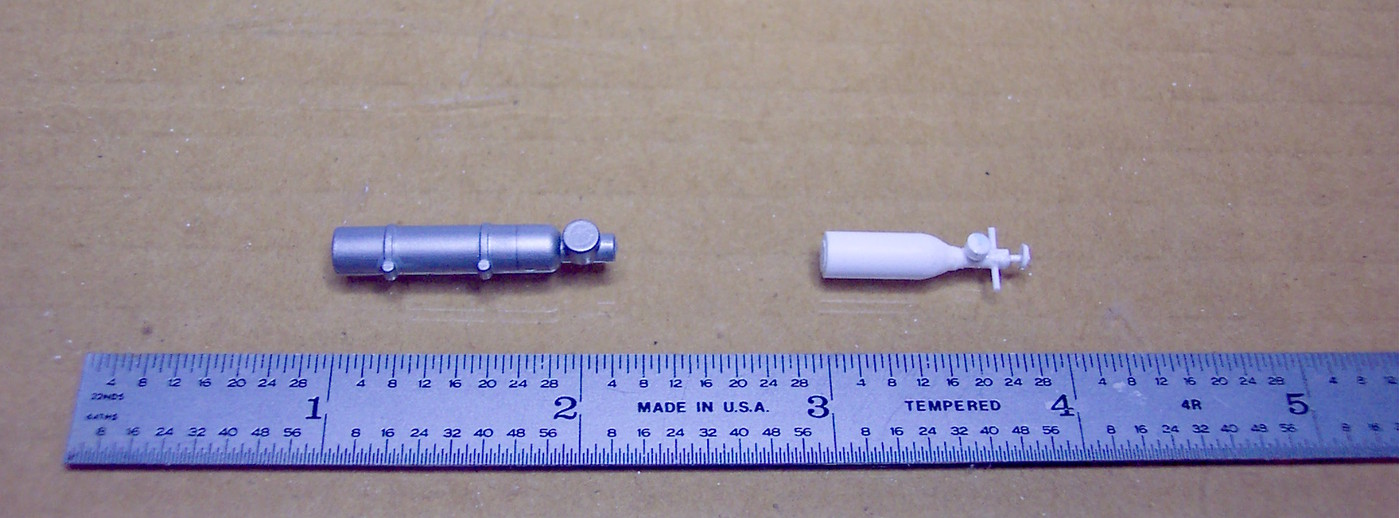

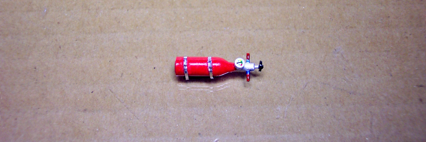

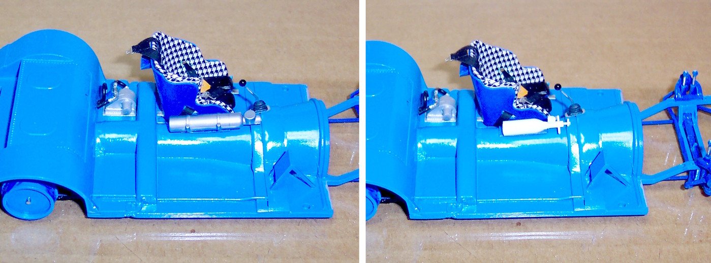

TooOld Posted February 26 Author Share Posted February 26 (edited) Yesterday I found a problem with the fire extinguisher , it's way too big . It measures nearly 32 scale inches long with almost a 4 inch gauge ! Instead of cutting it down I just made a new one . This is inside Petty's car . . . . . . the Salvinos part and my new one . After paint I'll add a mounting bracket and straps . Edited February 28 by TooOld 1 Quote Link to comment Share on other sites More sharing options...

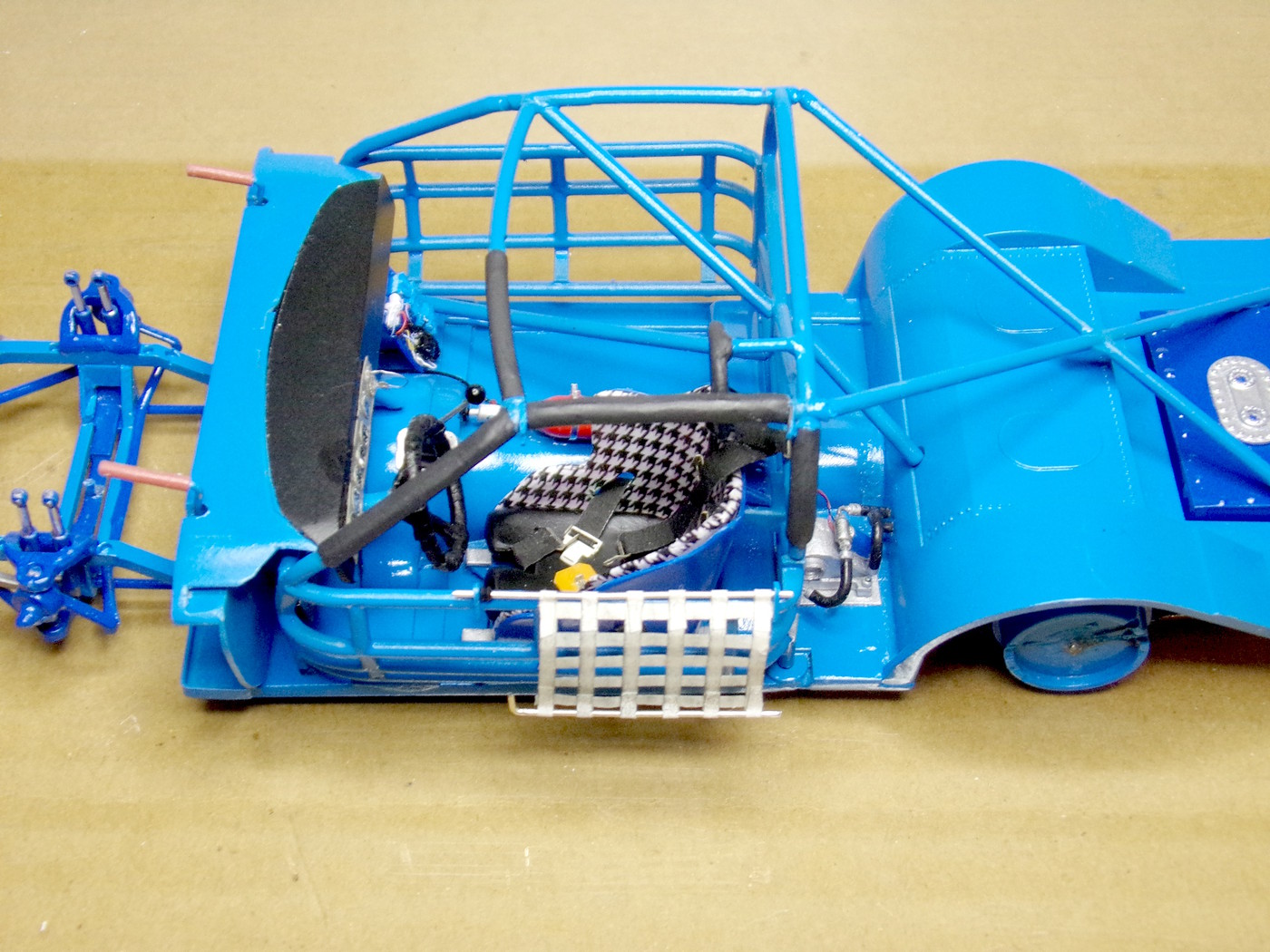

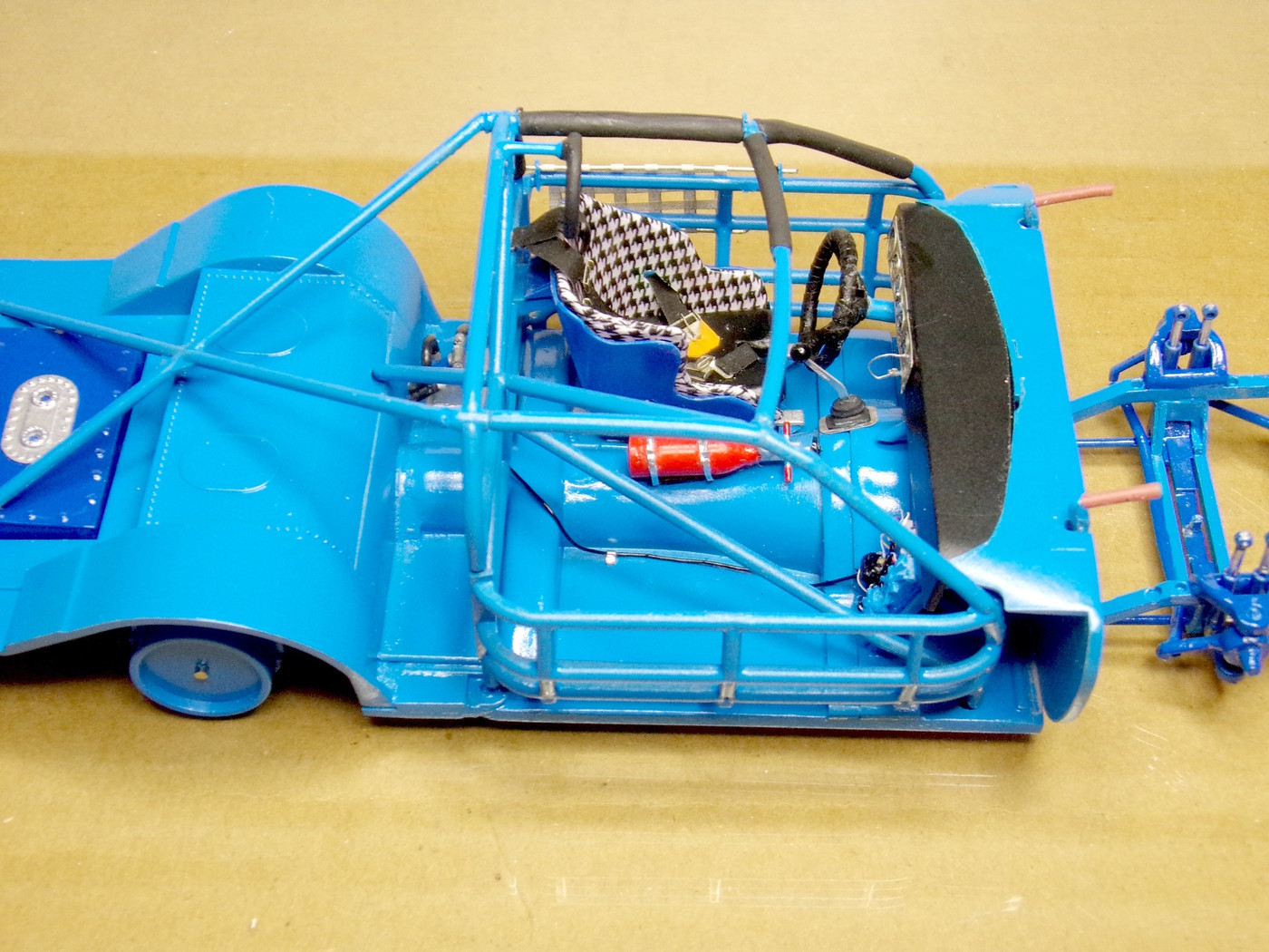

TooOld Posted March 2 Author Share Posted March 2 (edited) I had problems with the fire extinguisher but it's finally finished , crooked straps and all . And the interior is 99% complete , I think all that's left is the rear view mirror . Edited March 5 by TooOld 2 Quote Link to comment Share on other sites More sharing options...

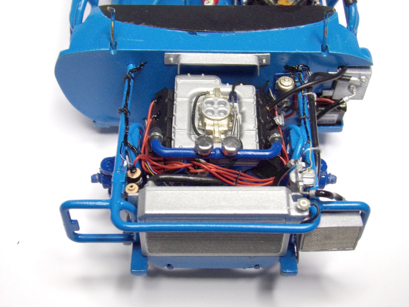

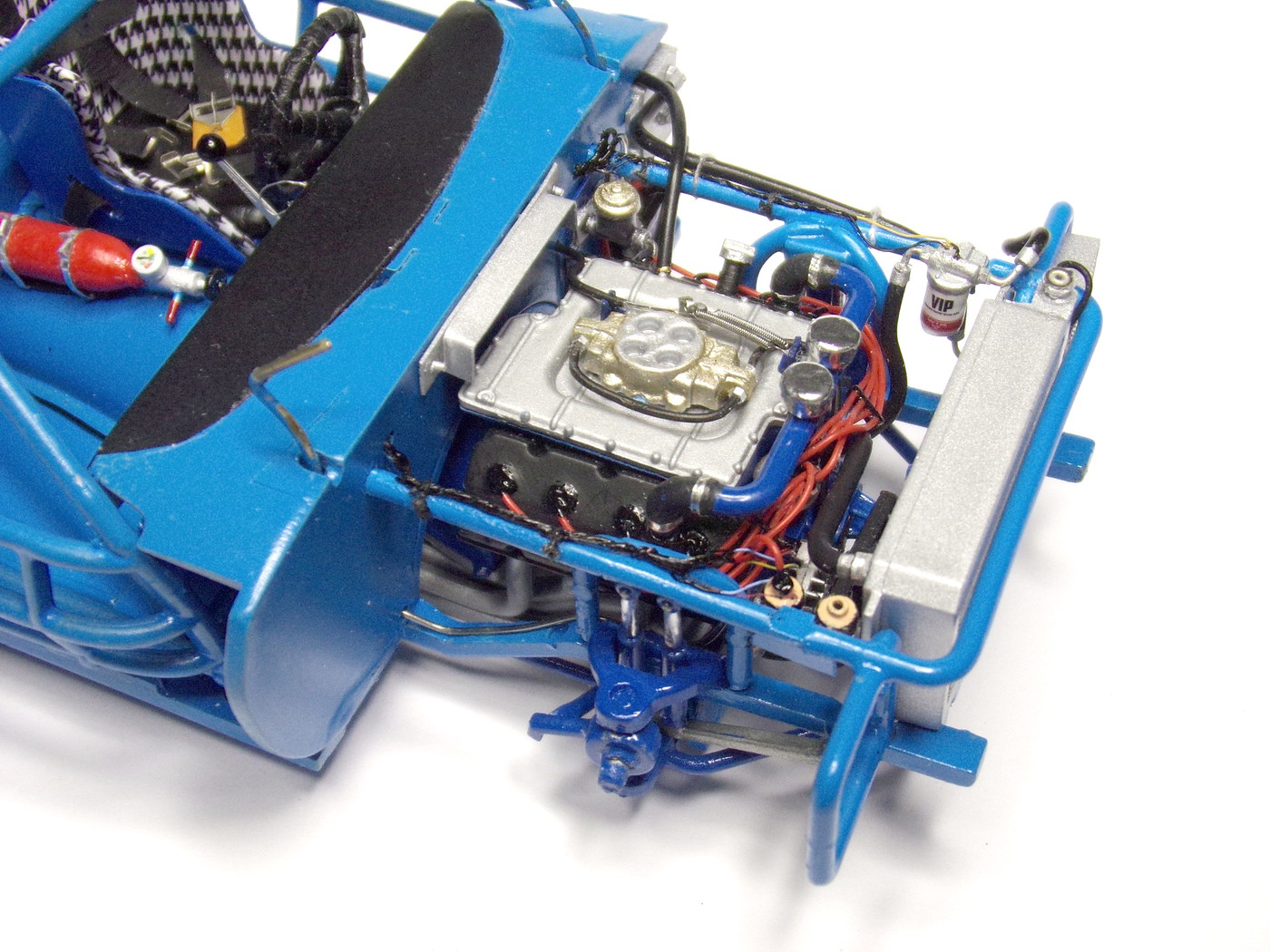

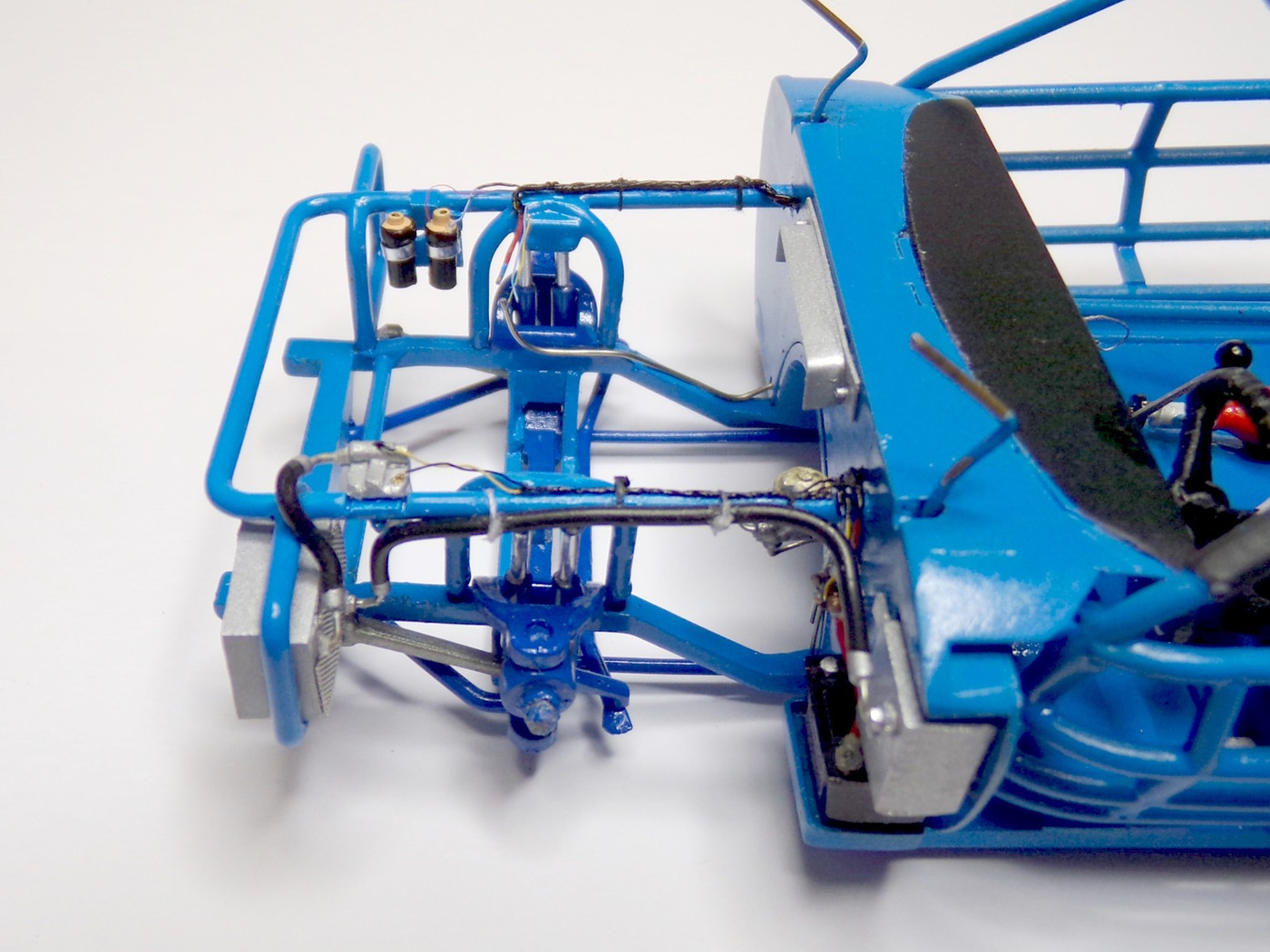

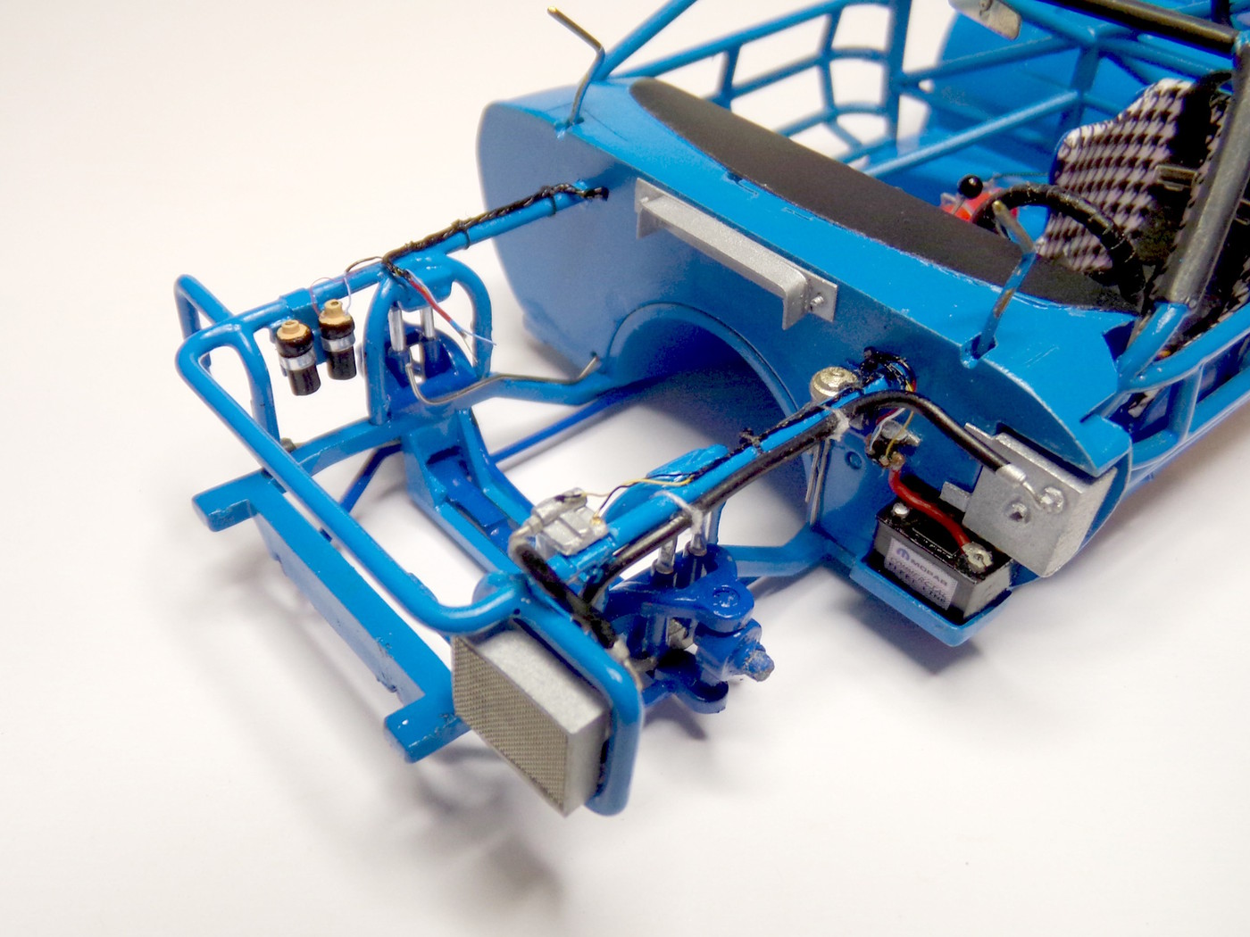

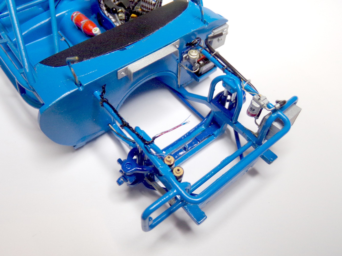

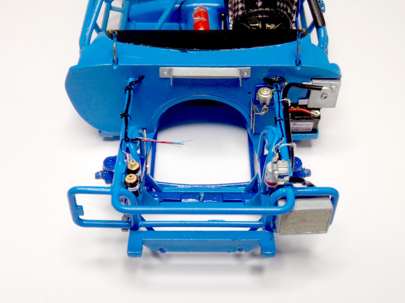

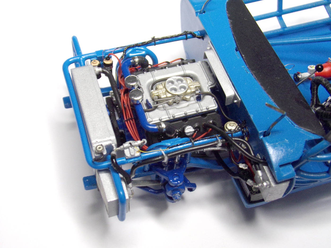

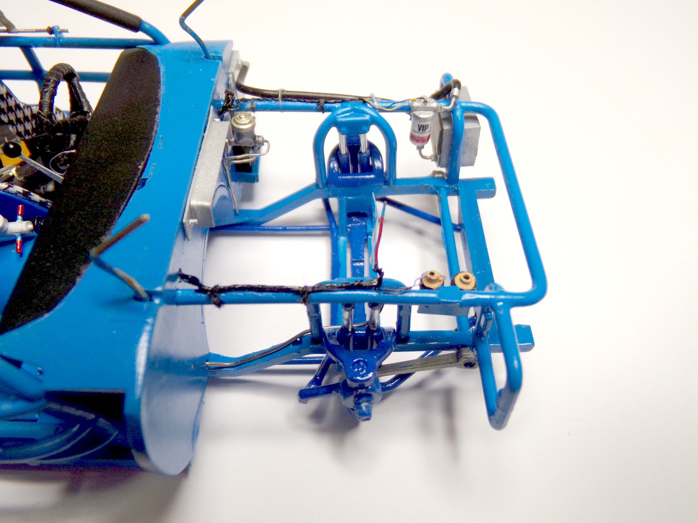

TooOld Posted March 14 Author Share Posted March 14 It's been a while since my last update but this last week I've managed an hour or so every day and I'm slowly making some progress . Here's several photos of the engine compartment , I can't install the radiator until after the engine is in place . That's next , it'll be tight but I tried it once already to make sure and it does fit okay . Thanks for looking ! Quote Link to comment Share on other sites More sharing options...
Pierre Rivard Posted March 14 Share Posted March 14 That detailing is beautiful Bob, Do you make your own oil line fittings? They look very good. Quote Link to comment Share on other sites More sharing options...
dwc43 Posted March 15 Share Posted March 15 Looking fantastic. Quote Link to comment Share on other sites More sharing options...
TooOld Posted March 16 Author Share Posted March 16 On 3/14/2023 at 12:52 PM, Pierre Rivard said: That detailing is beautiful Bob, Do you make your own oil line fittings? They look very good. Thanks Pierre ! The fittings are really easy to make but look more to scale than most I've seen used . Start with a piece of 24 gauge wire , strip the insulation , and paint a collar with aluminum paint . Then you can bend the end as needed before gluing it in place , the small aluminum hex nuts are from RB Motion . Quote Link to comment Share on other sites More sharing options...

TooOld Posted March 18 Author Share Posted March 18 Finally have the engine and radiator installed , I modified the radiator so that the upper hose is on the correct side . There are two sets of radiator hoses in the kit and neither upper hose was even close so I made my own out of solder , one of the lower hoses was close enough to use . I also finished the oil lines , battery cables , and miscellaneous wiring . Whew ! 1 Quote Link to comment Share on other sites More sharing options...
