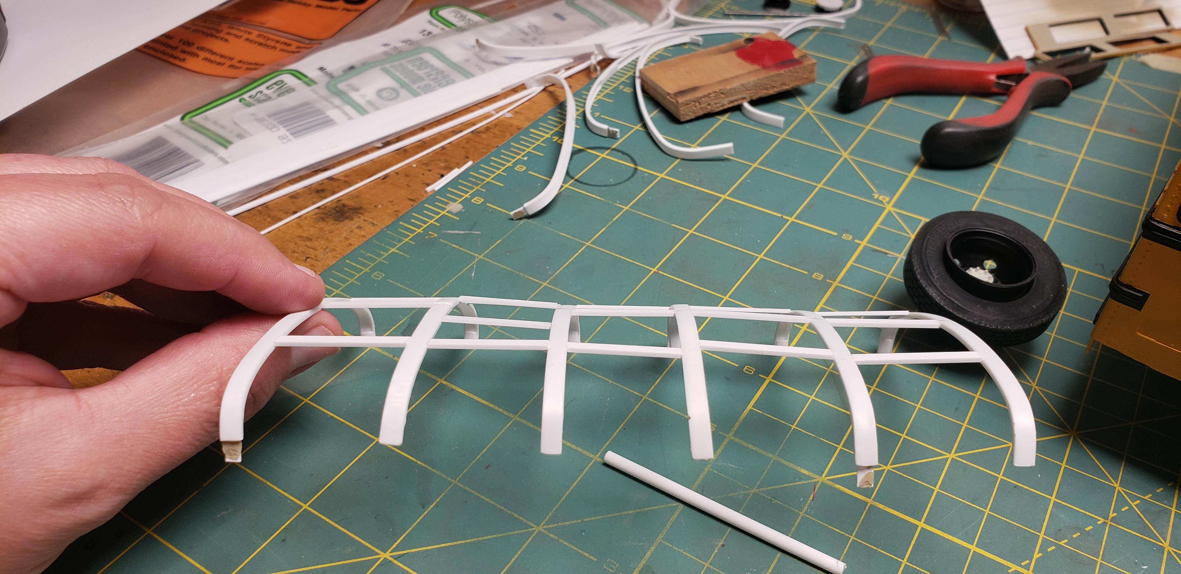

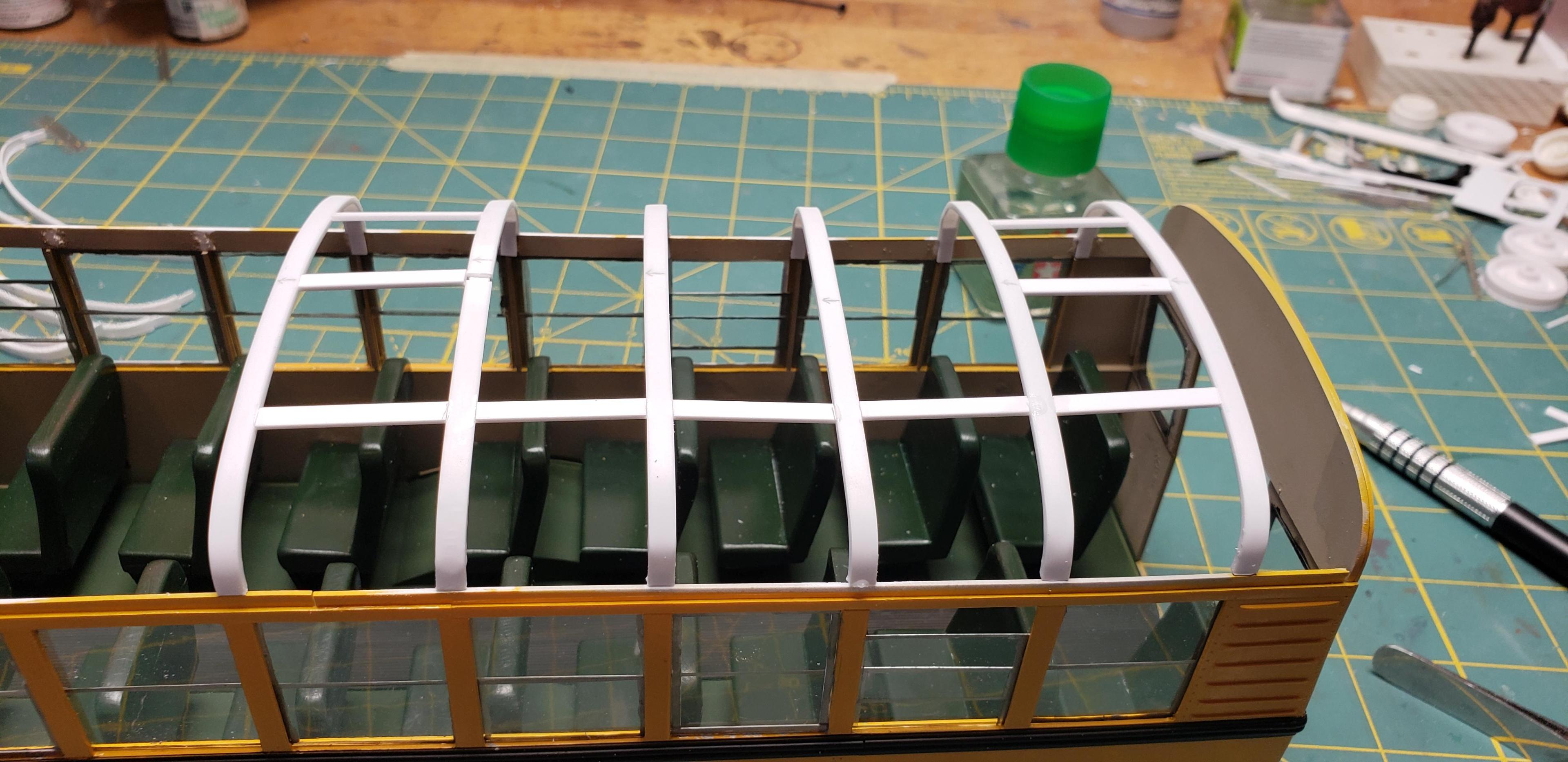

gotnitro? Posted March 29 Author Share Posted March 29 I finally found a method for the roof that seems to work. My plastic ribs didn't work out being uneven, so a tip was suggested about metal flashing. KnS sells thin tin sheet, so I thought I'd try it. This is just a guinea pig test piece, but looks promising. Here's what my attempted ribs looked like..so embarrassing . Even using a jig to create them, every one was slightly different Quote Link to comment Share on other sites More sharing options...
Mopar - D Posted March 29 Share Posted March 29 Jeff I think you are going to be pleased with the tin roof. Your first piece is already looking good. Your ribs look like what mine would look like lol. Quote Link to comment Share on other sites More sharing options...

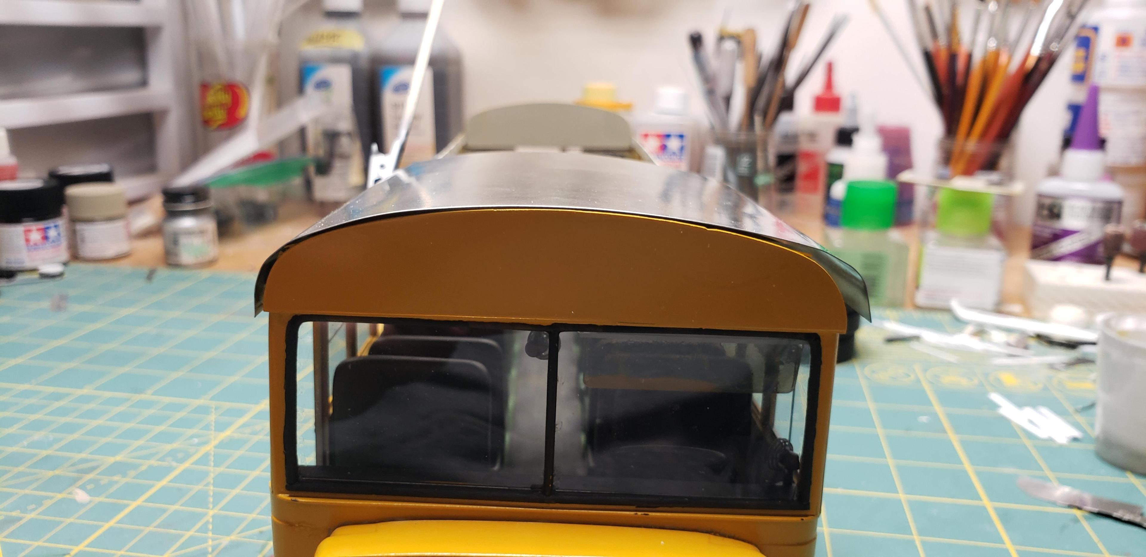

Chariots of Fire Posted April 1 Share Posted April 1 What is the plan for rounding off the front and rear edges of the roof? Quote Link to comment Share on other sites More sharing options...
gotnitro? Posted April 1 Author Share Posted April 1 4 hours ago, Chariots of Fire said: What is the plan for rounding off the front and rear edges of the roof? Haha guess I forgot about those. These will end up squared off oops 15 hours ago, DZ7581 said: I was thinking about using a brass sheet myself for the roof. I want to see how your's turns out. I had both options, the tin is working well. @DRIPTROIT 71- thanks ! Having a couple windows open should keep temps down too Quote Link to comment Share on other sites More sharing options...

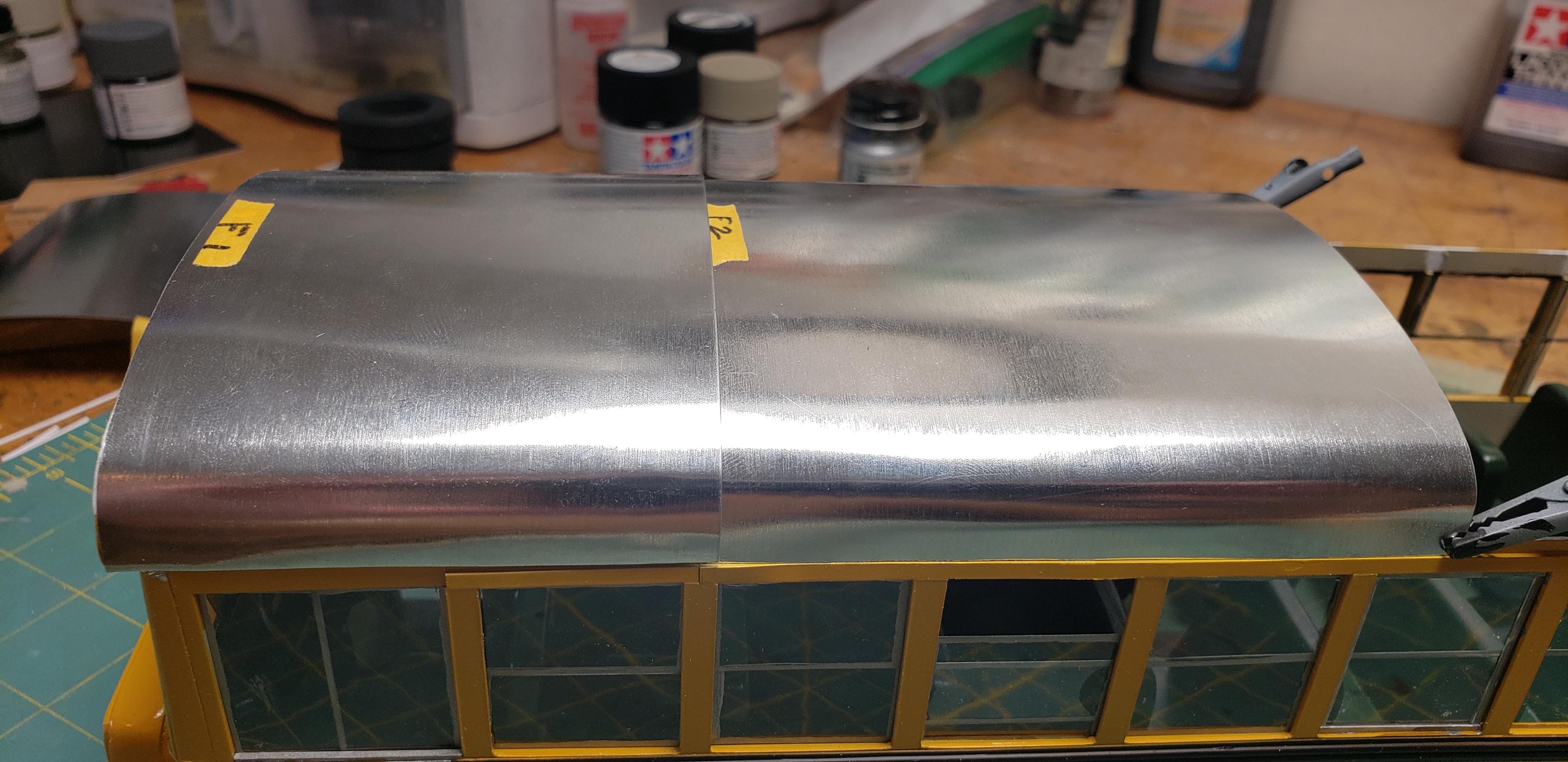

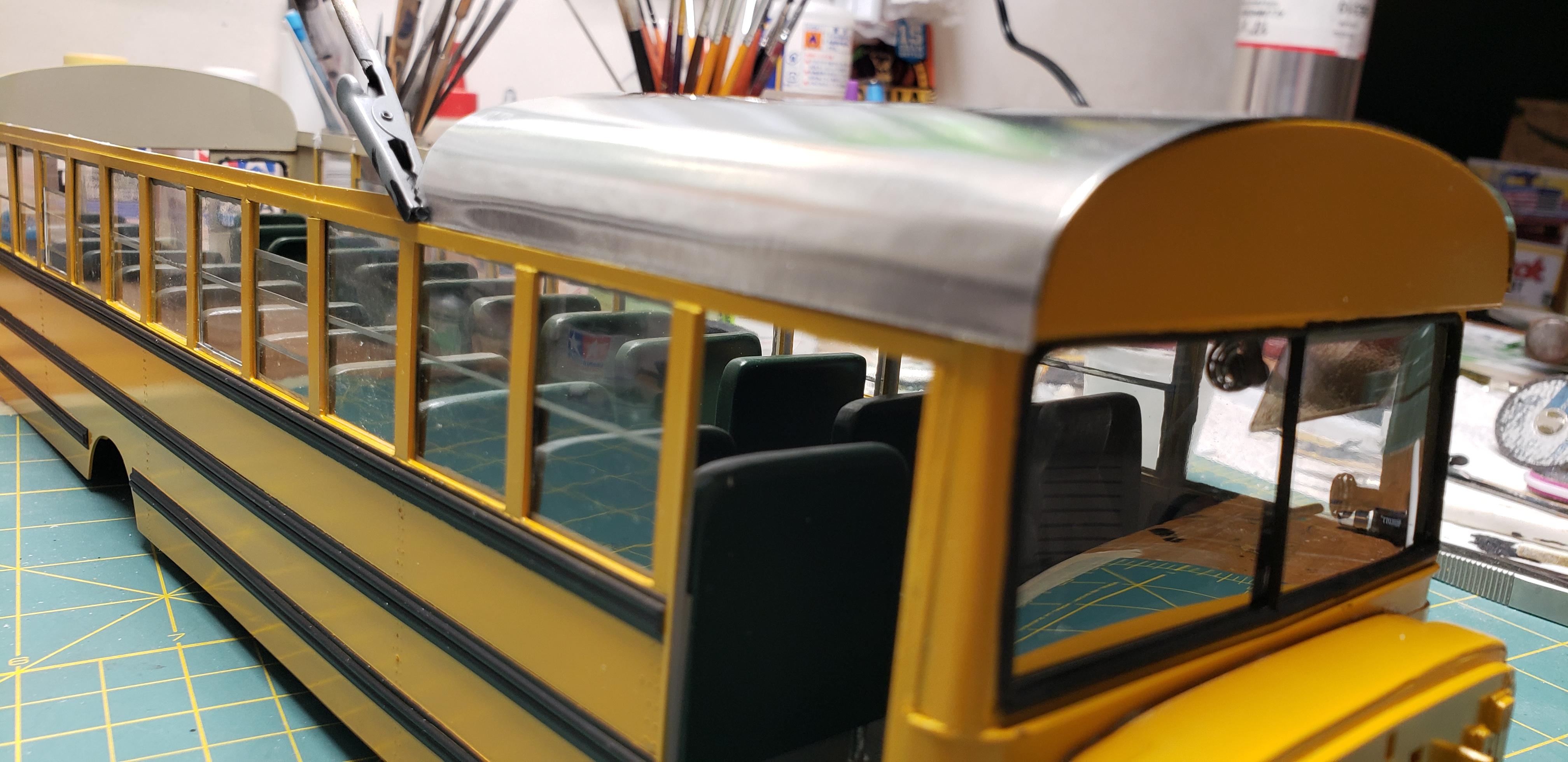

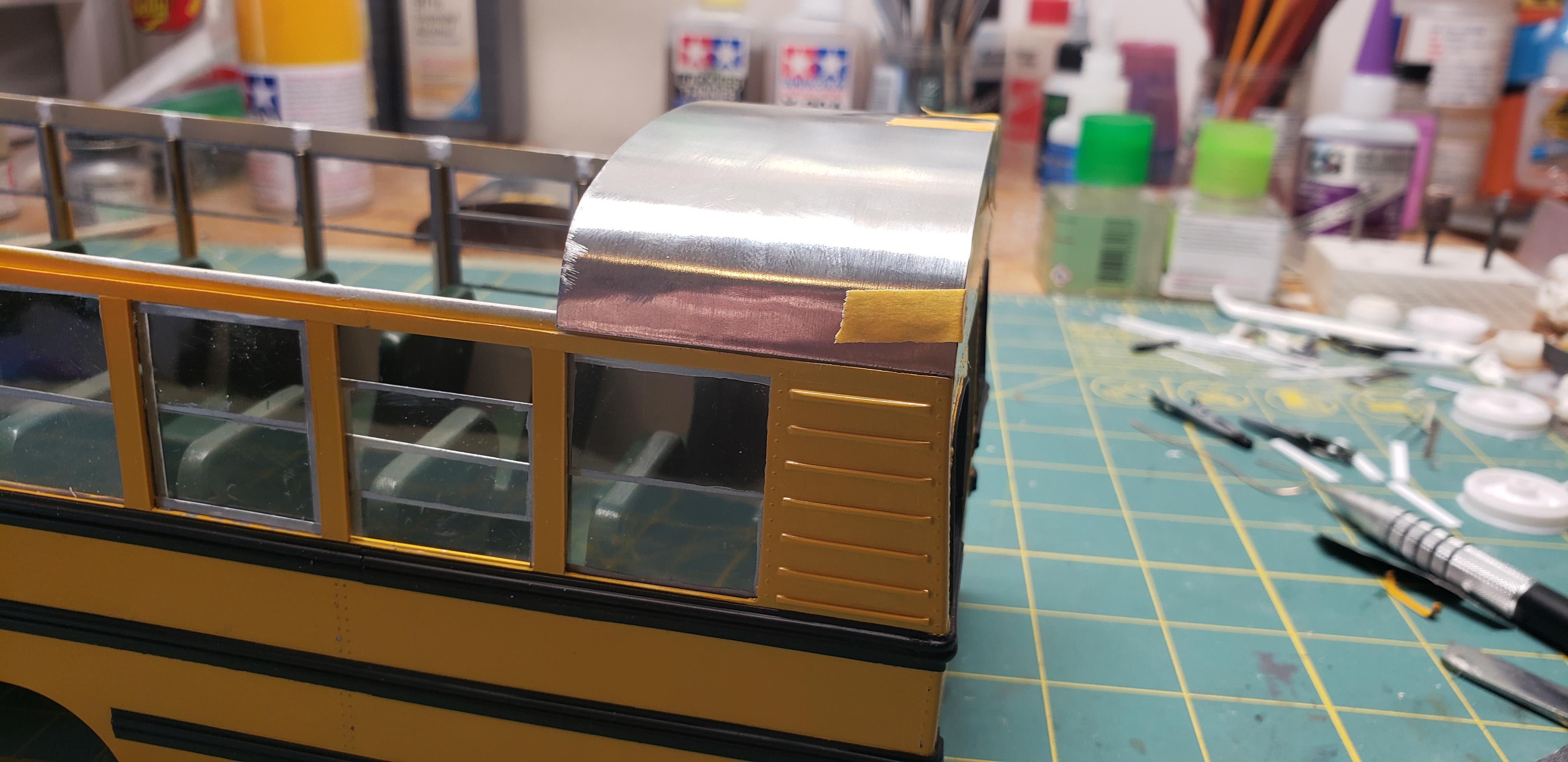

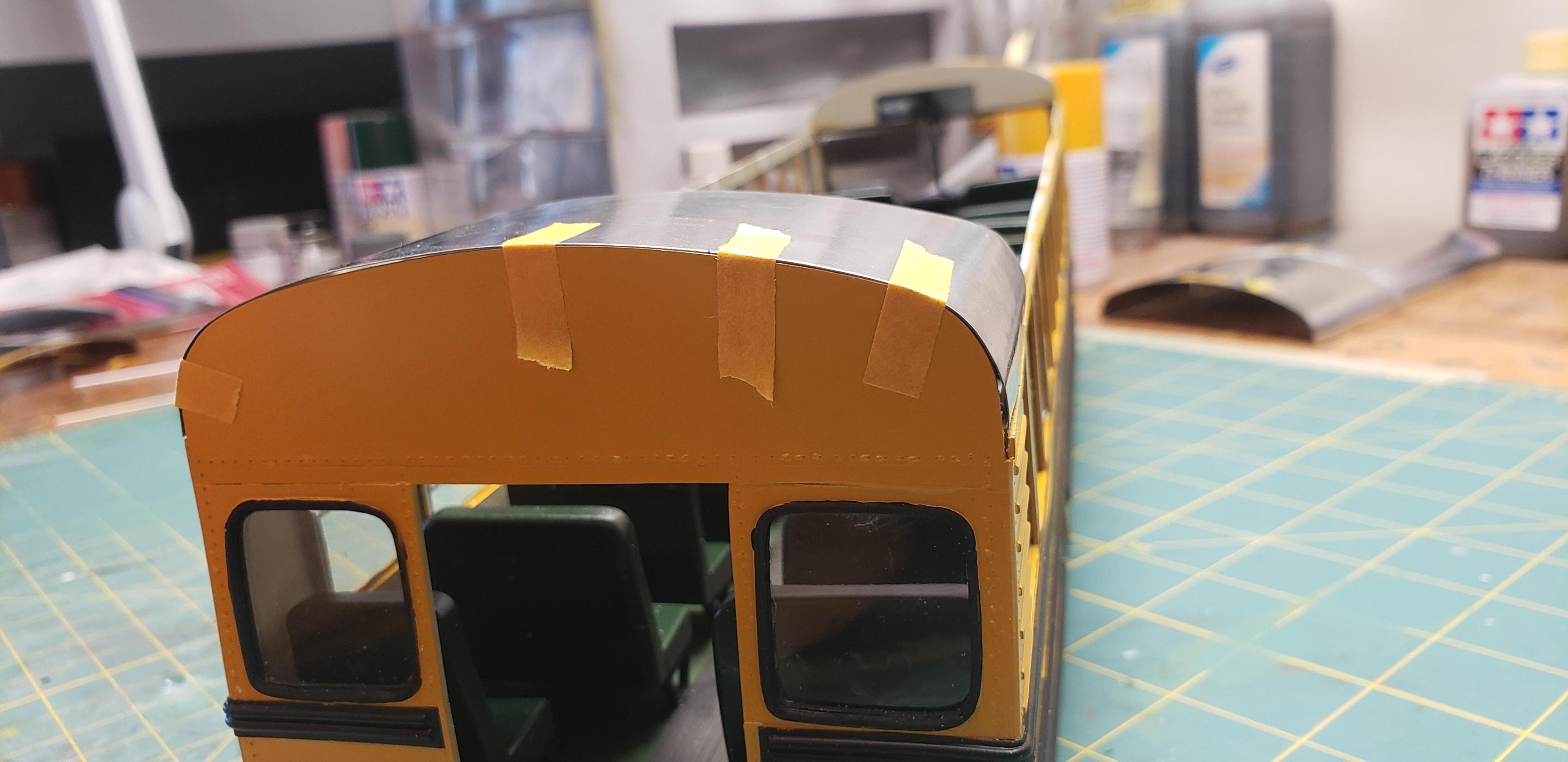

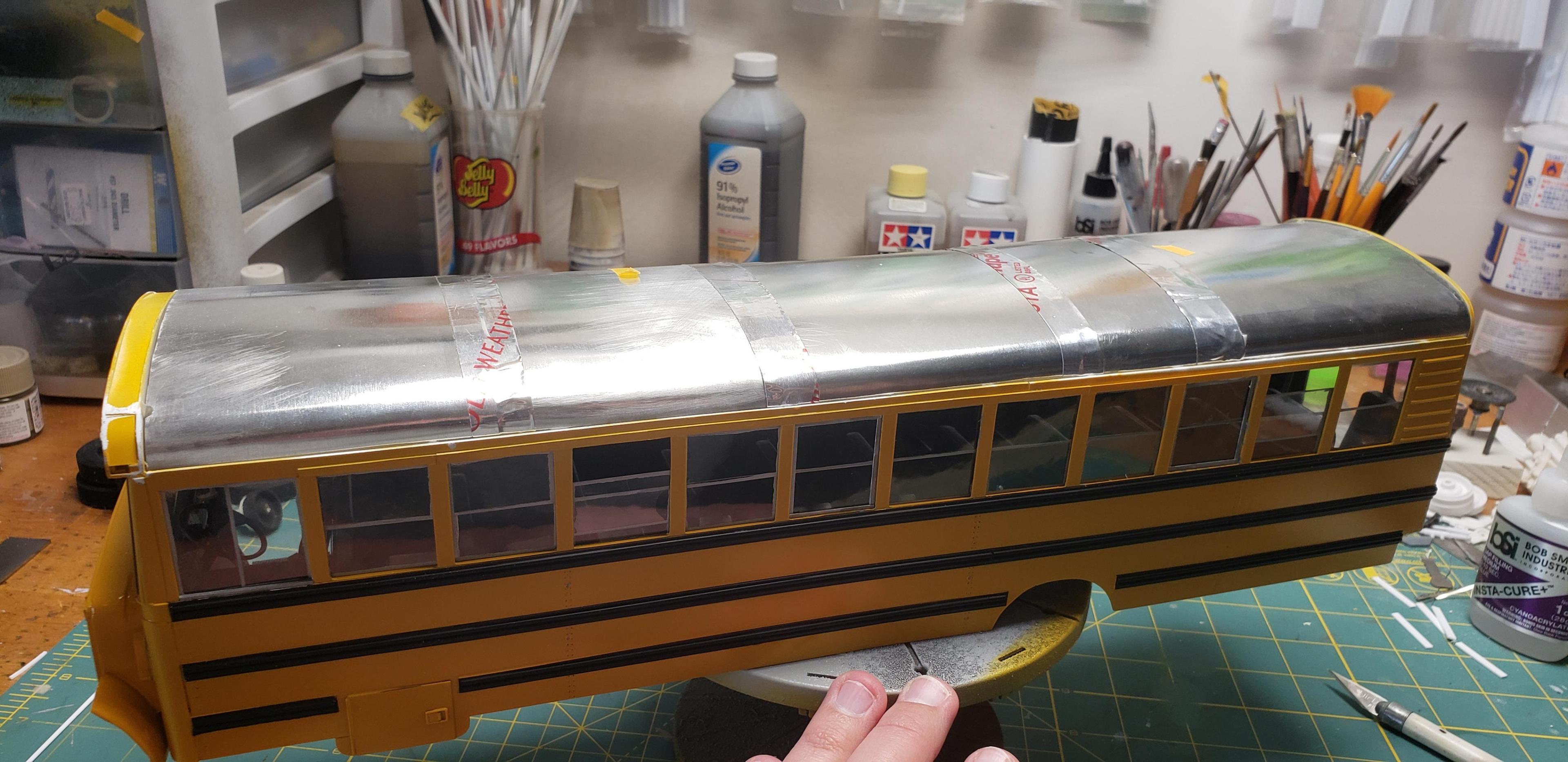

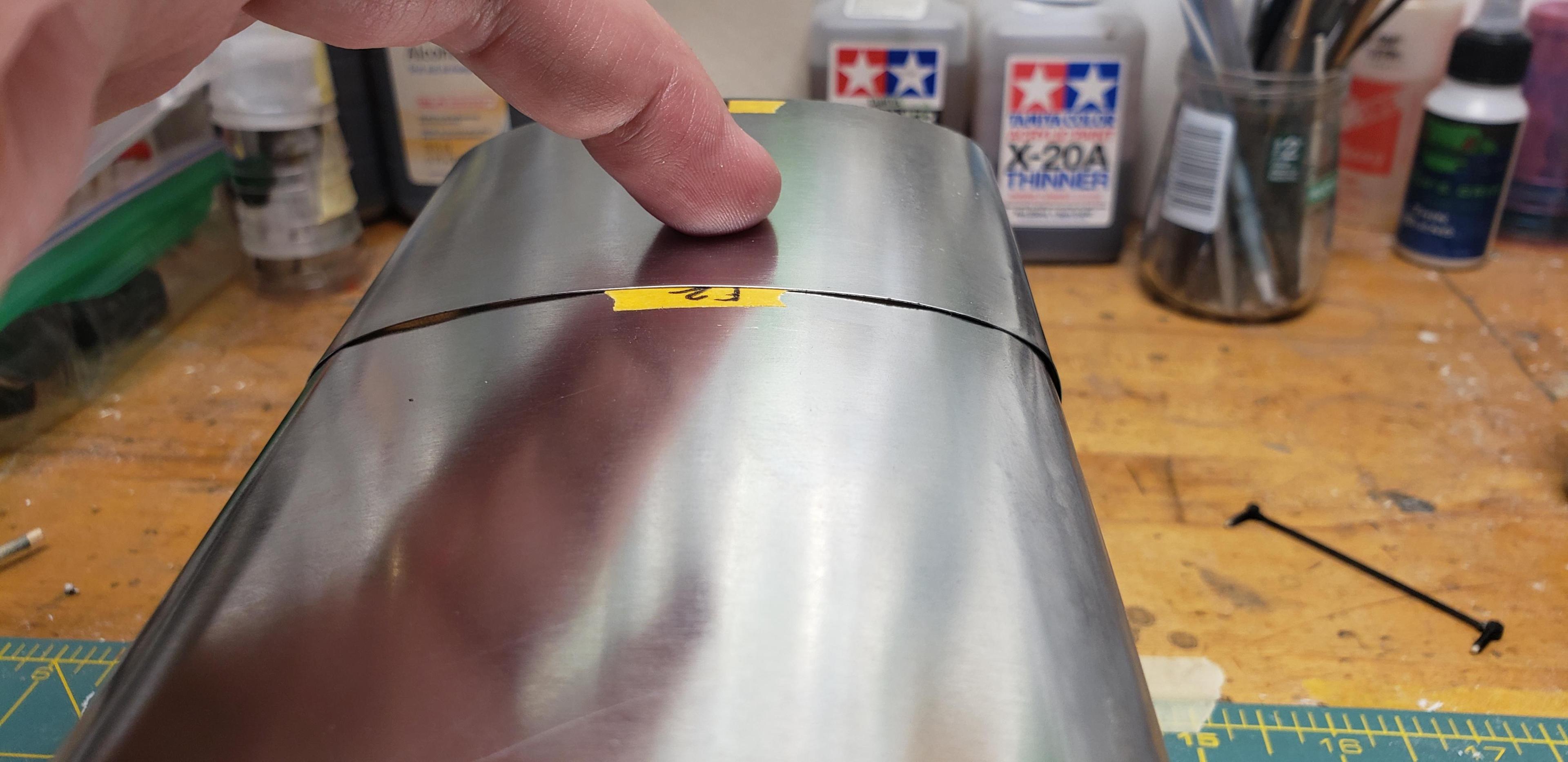

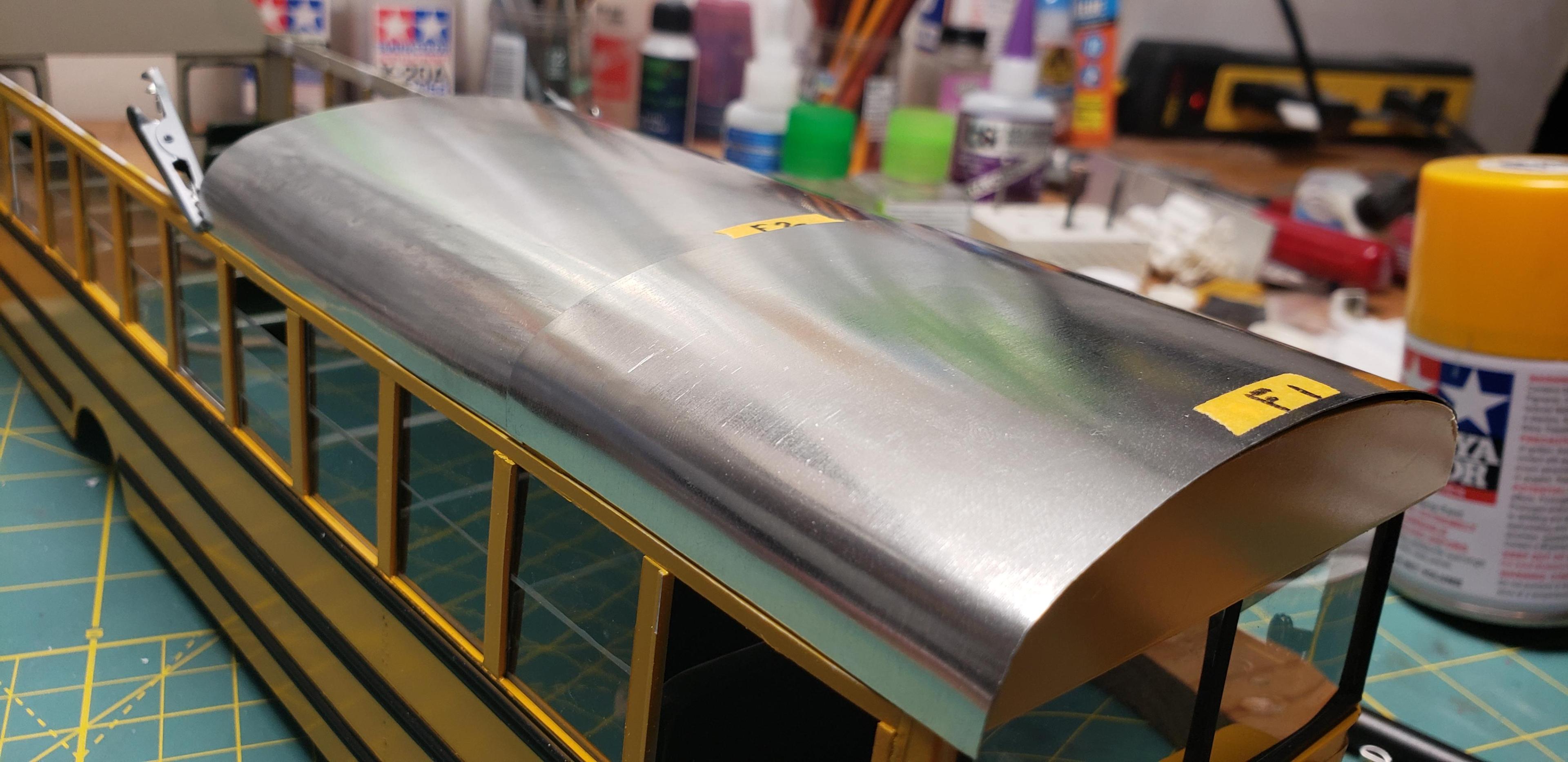

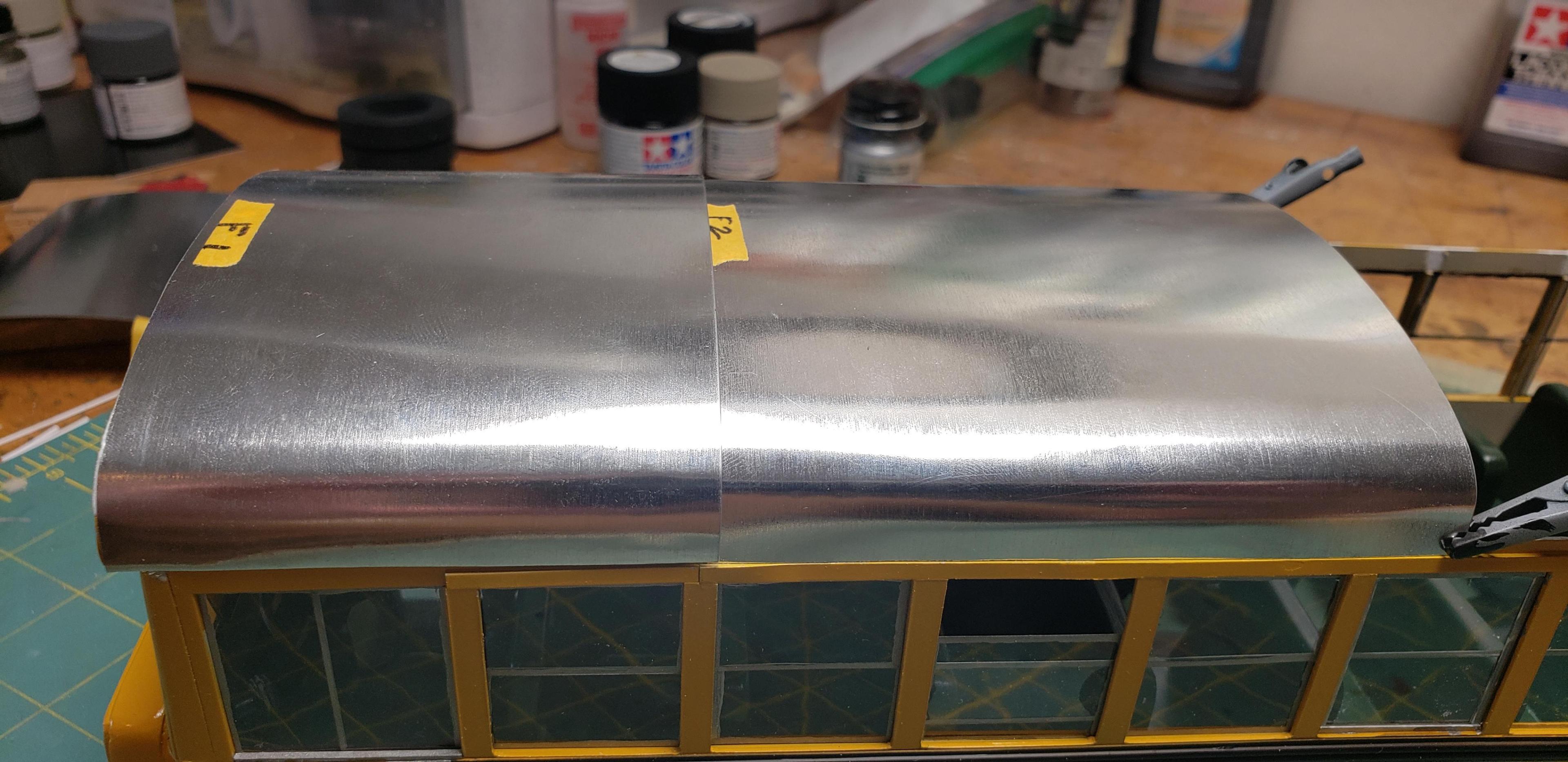

gotnitro? Posted April 1 Author Share Posted April 1 The rear roof went on this morning, and I'm really pleased with how tight it fit. The middle section is underway. I wanted to finalize the shape, but had to take daughter out delivering girl scouts cookies..yummy I want all the panels to end at a window frame, then after paint apply the Archer rivets Any feedback welcome! Quote Link to comment Share on other sites More sharing options...
Mopar - D Posted April 1 Share Posted April 1 Looking great Jeff! What are you using to make your bends they look perfect. 1 Quote Link to comment Share on other sites More sharing options...
gotnitro? Posted April 2 Author Share Posted April 2 12 hours ago, Mopar - D said: Looking great Jeff! What are you using to make your bends they look perfect. The middle of the roof is bent using a tamiya rattle can. The tighter edges I've been bending using a 1/4 styrene tubing. The tin bends (kinks) very easy, so I'm trying to ease the shape into it. Most of the time its resting on my leg while slowly rolling the edges. I found a neat trick for measuring the width before bending...by using a piece of string to lay over the body. Then transfer that to the ruler! Very little excess after bending Quote Link to comment Share on other sites More sharing options...

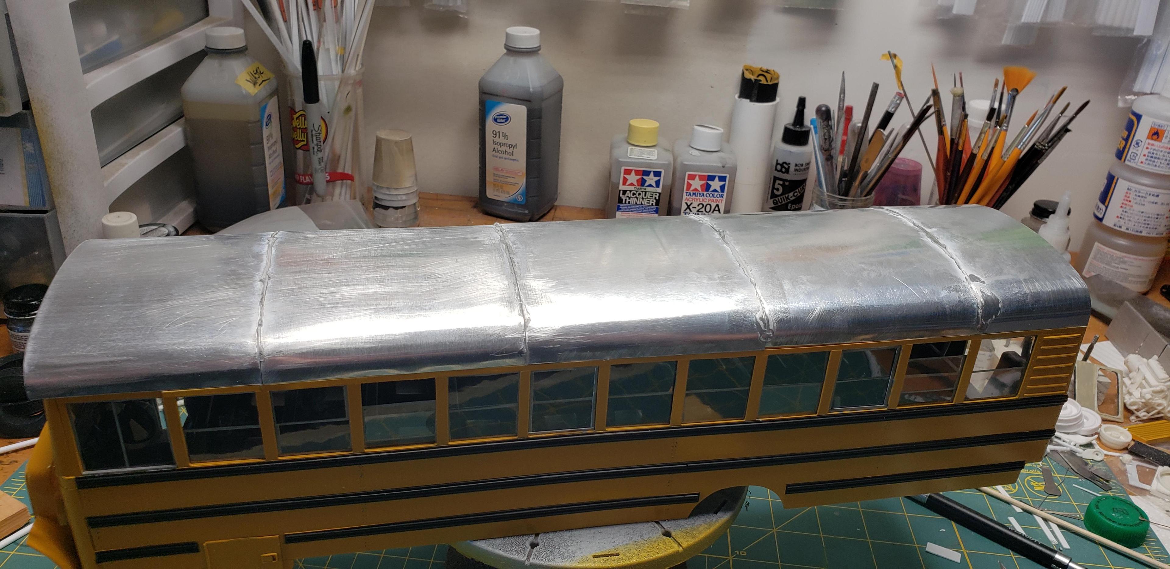

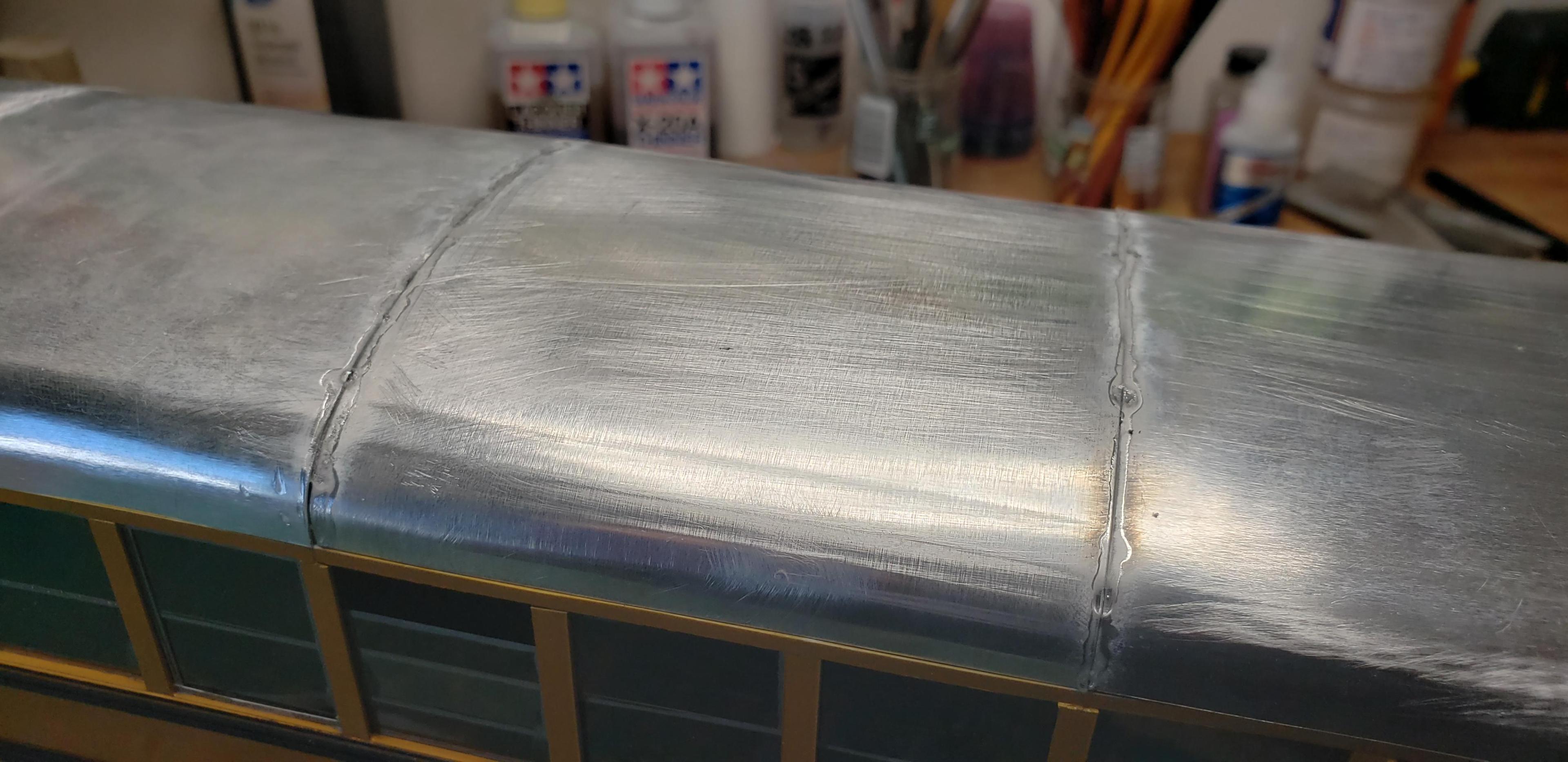

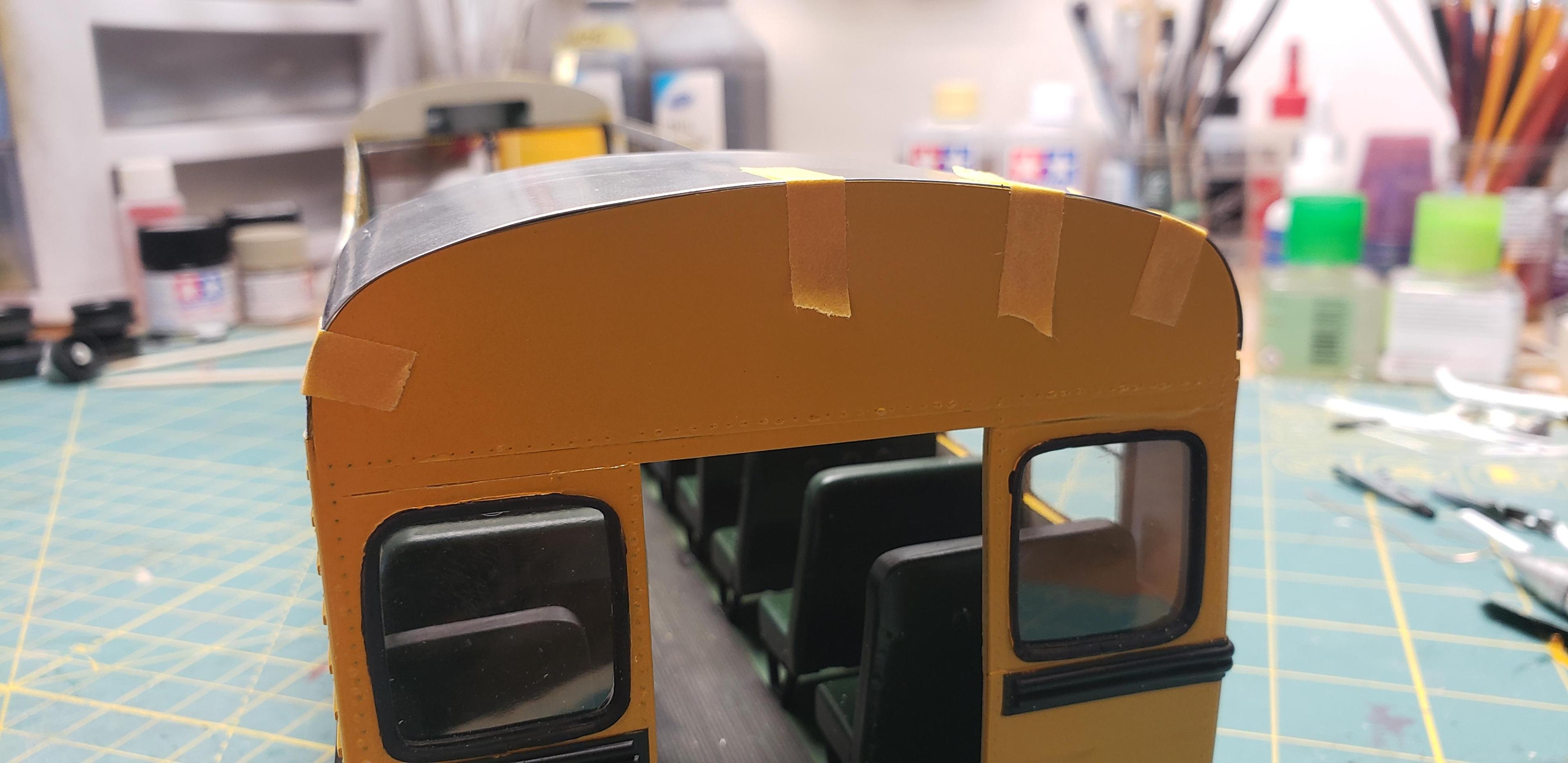

gotnitro? Posted April 10 Author Share Posted April 10 The roof is finally installed in its rough state, but everything handmade statts off that way. I used the old roof as an inner liner, then formed a 2nd over that. The inner keeps the walls tight, preventing the bowing I was dealing with. The inner roof in place , sealed w hvac tape The outer roof installed..ugly now, but will finish up smooth. Once the joints are sanded down, I'll give the entire roof a once over w steel wool to remove any fine marks. Prime and paint will follow 2 Quote Link to comment Share on other sites More sharing options...
