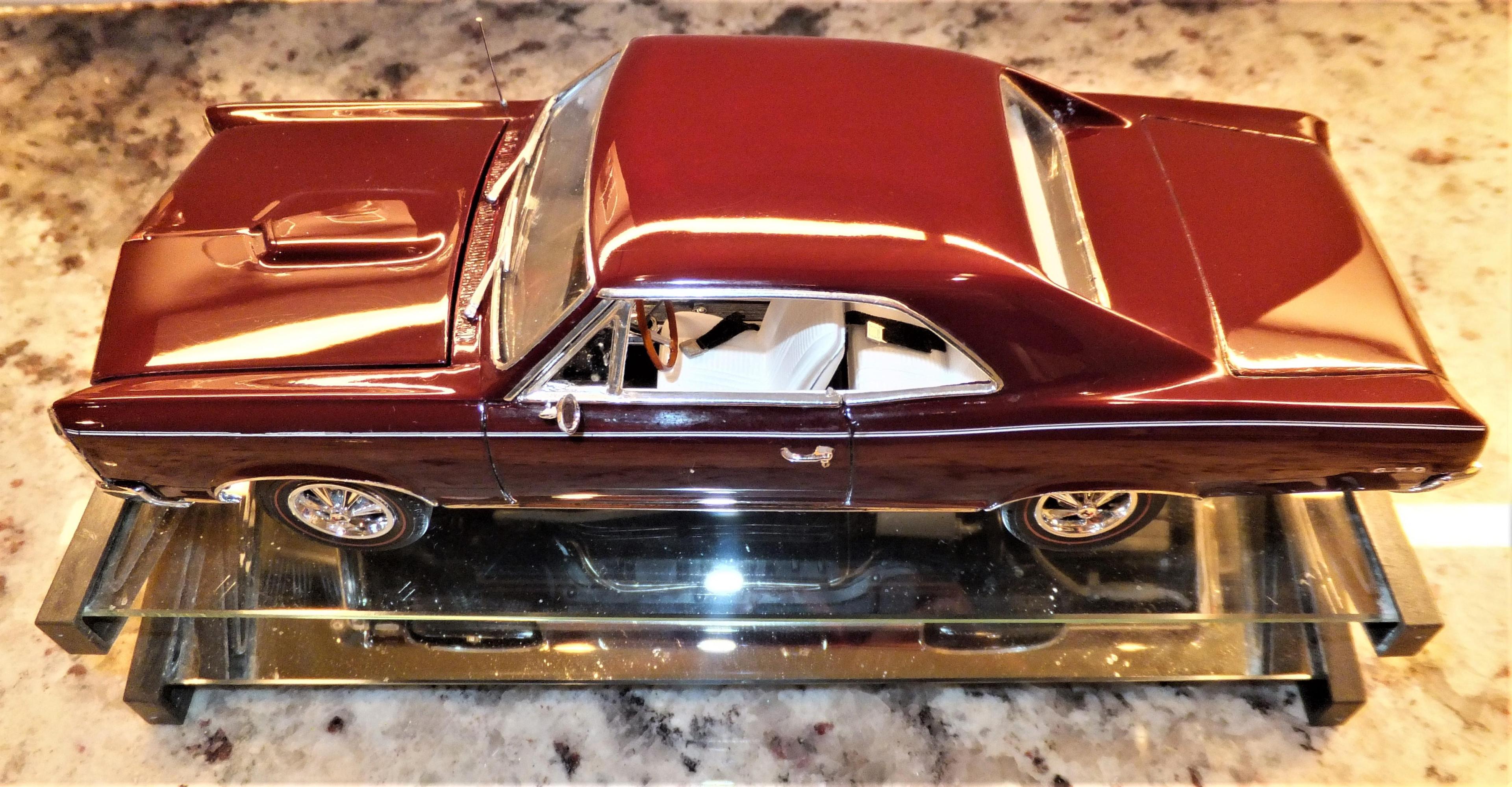

Cool Hand Posted January 29 Share Posted January 29 (edited) Looks like the paint can hasnt been shaken enough. Polished TS-11 over black surfacer. Edited January 29 by Cool Hand Quote Link to comment Share on other sites More sharing options...

TransAmMike Posted February 5 Share Posted February 5 (edited) On 1/28/2023 at 8:19 PM, Cool Hand said: Looks like the paint can hasnt been shaken enough. Polished TS-11 over black surfacer. Wow Luke, that is one beautiful paint job. When you say "surfacer" are you referring to Mr. Hobby surfacer and if so, which one. Thanks, Mike Edited February 5 by TransAmMike Quote Link to comment Share on other sites More sharing options...
KWT Posted February 5 Share Posted February 5 On 1/28/2023 at 8:19 PM, Cool Hand said: Looks like the paint can hasnt been shaken enough. Polished TS-11 over black surfacer. HoLy... wow... Quote Link to comment Share on other sites More sharing options...
