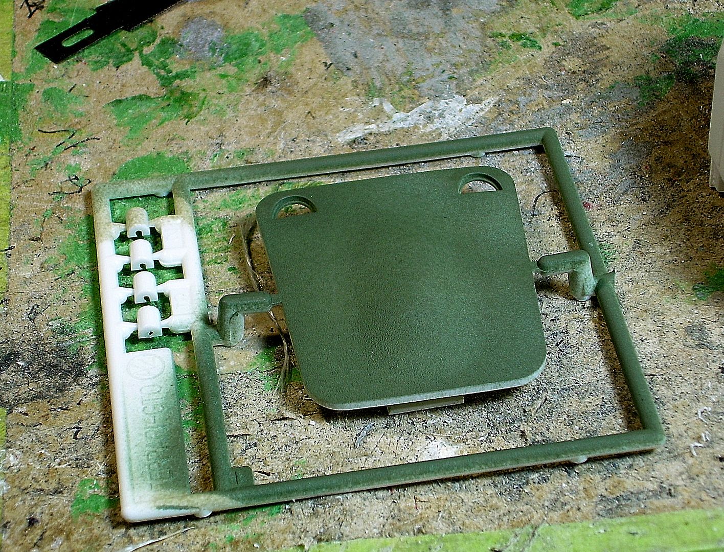

gman Posted February 28 Share Posted February 28 SEM makes a paint branded as EZ Coat Olive green- a search of the interwebz didn't turn up any affiliation with Dodge. https://www.smsdistributors.com/products/sem-62223-ez-coat-olive-green-16-oz-aerosol I have used SEM paints on 1:1 vehicle trim and interior parts. SEM paints are on the "hot" side for plastics, but if that is indeed the shade called out, you should be able to get something in the same ballpark in enamel, lacquer or even acrylic craft paint that will look the part without potentially crazing the kit styrene. Quote Link to comment Share on other sites More sharing options...
