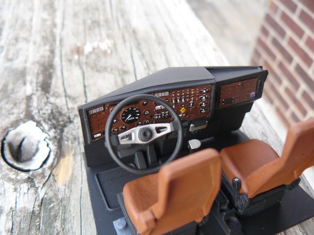

This is the interior in my PB 378. The dash is a decal supplied with the kit for the gauge and switches detail.
The rest is paint.
