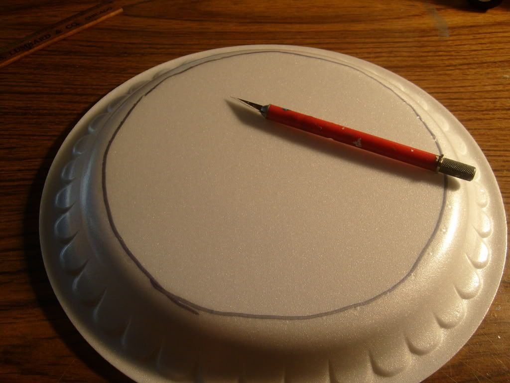

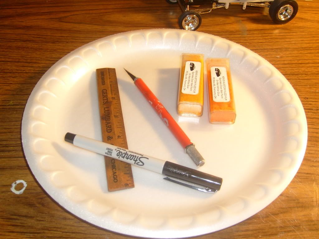

gseeds Posted April 20, 2009 Share Posted April 20, 2009 heres a easy fast why to get a low rider, show car or custom interior,and i hope im not steping on anyones toes here,but a few guys have said they would like a how to on interiors and i know what works for me, im working on my c cab project,doing the interior panels,and since its a show rod it has to have a cool show rod interior right?,and since im doing it i may as well take a few shots of it and share it with the guys here on the site,this is an easy way and cost effective way to get that show car interior look. first take a foam plate,cut out the flat area,then mark out your patten or grid useing a ruler and pen, then scribe the tuff or tuck lines useing the back side of a plastic knife,then cut out the shapes of your interiors panels with a #11 blade,try the fit and trim as needed,apply a base color as close to the fuzzy fur your going to use,you can also make pipping useing colored electical wire,any q's just ask,have fun, i ll put more photos of mine once i chose a color,i may go with two shades of pink,im thinking pie wagon.ive added a few photos of done cars. Quote Link to comment Share on other sites More sharing options...

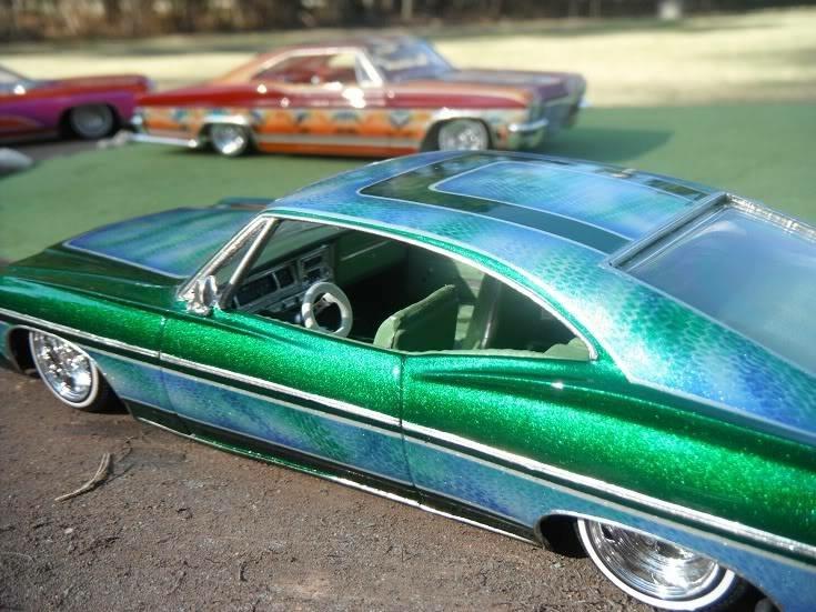

gseeds Posted April 20, 2009 Author Share Posted April 20, 2009 so more cars ive done this way, hope this is of some help. Quote Link to comment Share on other sites More sharing options...

gseeds Posted April 21, 2009 Author Share Posted April 21, 2009 Looks great, and looks like it'd be a fairly easy technique to master. I was wondering what type of paint and adhesive you use on the panels, seeing as how styrofoam a notoriously finicky material where paints and glues are concerned. Thanks for sharing! thanks guys,i hope some one trys this and post some pics, Khart as for paint and glue i just testors bottle paint as close to the color of fuzzy fur im useing,and just glue in panels with CA glue,i dont know the name off hand, but its the normal glue sold in all the hobbie stores,i use the one in the purple bottle,hope this helps. Quote Link to comment Share on other sites More sharing options...

Eshaver Posted April 24, 2009 Share Posted April 24, 2009 Gseeds, somethimg tells me ya mighta been into the " Custom Van " scene back in the early seventies. Biscut Tufting was all the Rage then and from the looks of the French curve couch in the Paddy wagon , well ya give yerself away. Very handy tip there ! However let me warn everyone that "Foam plates are sensitive as to what adhesives you use and what Paints to use as well. Generally using White or Testors White glue is safe as well as epoxies . Paints are yet another area where you are better off using acrylics on if you're not sure what to use . Nowiffini yer bent and determined to use " Hot paints", seal with a coat of Elmers glue and then Paint over top ............ That will work as I have had to do much the same thing when I'm building my service stations .......... Ed Shaver Quote Link to comment Share on other sites More sharing options...
