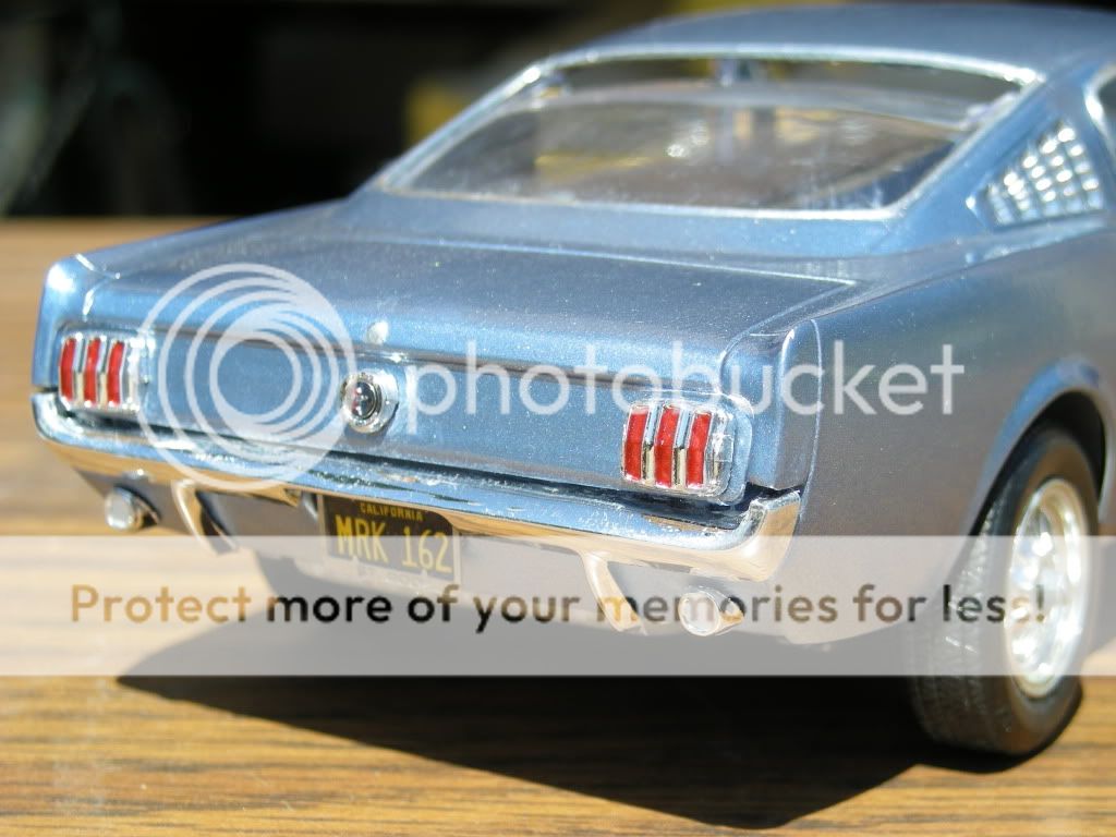

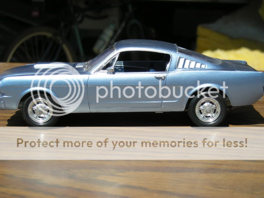

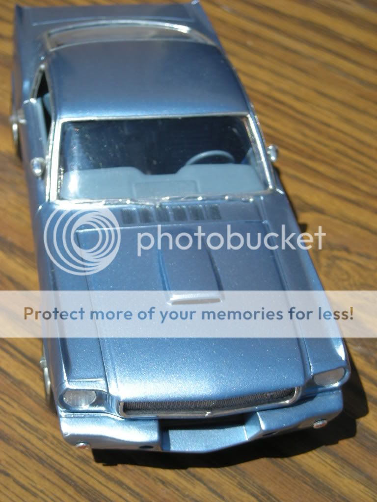

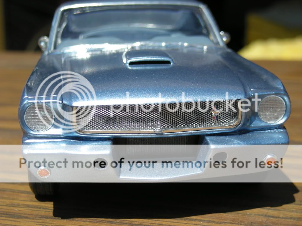

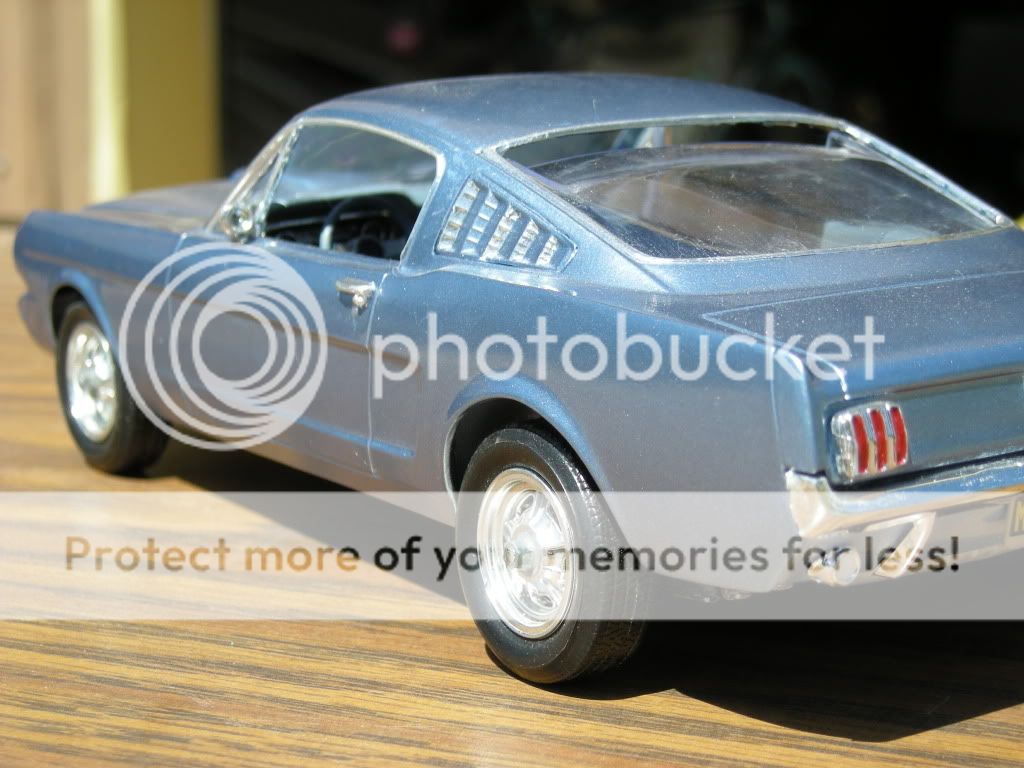

Modlbldr Posted July 8, 2009 Share Posted July 8, 2009 Well, I finally finished one to post here. It is a mix of the Revell GT350R and the 2+2 Fastback. Paint is a Duplicolor automotive spray that closely resembles Pontiac engine blue. More photos coming. Later- Quote Link to comment Share on other sites More sharing options...
Harry P. Posted July 8, 2009 Share Posted July 8, 2009 What's up with that giant gap between the rear window and the roof? Quote Link to comment Share on other sites More sharing options...

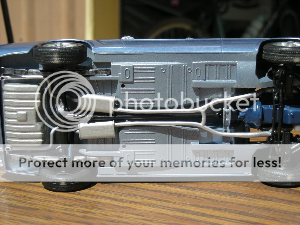

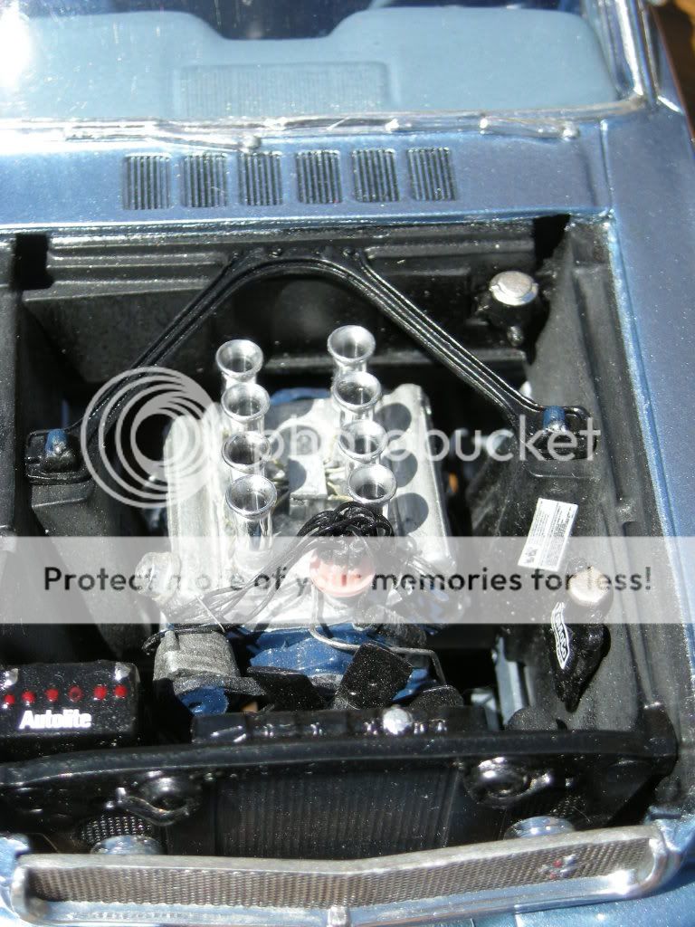

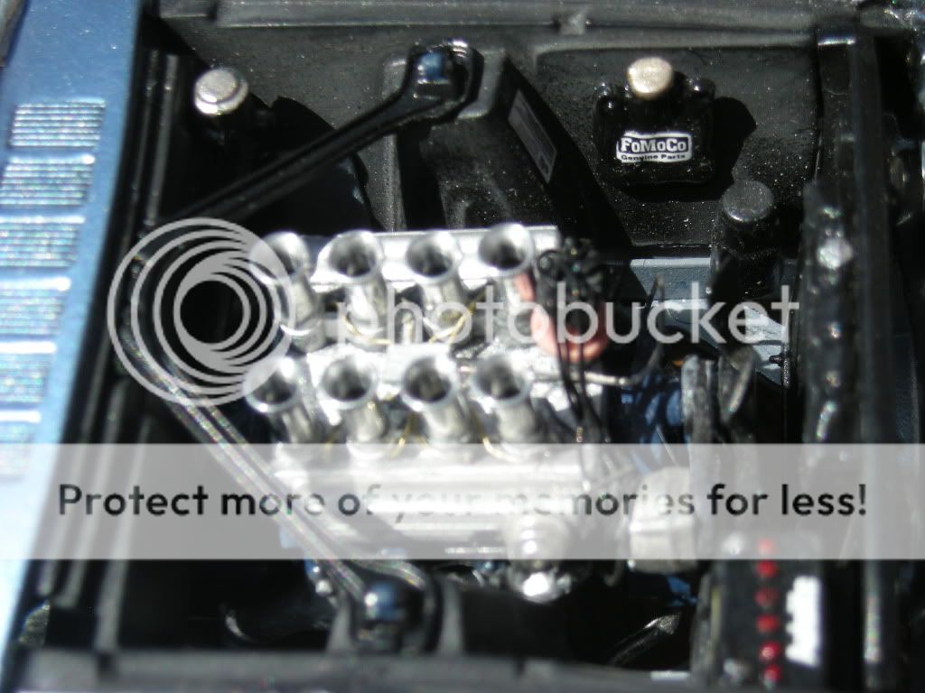

Modlbldr Posted July 8, 2009 Author Share Posted July 8, 2009 I swapped in the 428 from the AMT 71 Mustang. This was a pretty easy swap only requiring a longer drive shaft and slight extention mods to the exhaust pipes. I added aftermarket velocity stacks. I still need to add the radiator hose. The rear plate was made by cutting a piece of aluminum from a pop can and adding the decal and then a PE frame. I hope you enjoy it and any comments or criticizms welcomed. Quote Link to comment Share on other sites More sharing options...
Modlbldr Posted July 8, 2009 Author Share Posted July 8, 2009 Harry- That is the GT350 rear window. I can't stand it. However, when I installed the stock window, I fat fingered it with some glue. I had to use the racing window as a last resort. I guess it was a plexiglass window in the racing versions that allowed for ventilation or something. Later- Quote Link to comment Share on other sites More sharing options...
Harry P. Posted July 9, 2009 Share Posted July 9, 2009 You could have polished out the glue smear... or made a new window out of clear acetate. Oh well... next time. Quote Link to comment Share on other sites More sharing options...

Harold Posted July 12, 2009 Share Posted July 12, 2009 The GT350-R had a back window like that to pull heat out of the cockpit. Historic precedent. Quote Link to comment Share on other sites More sharing options...
