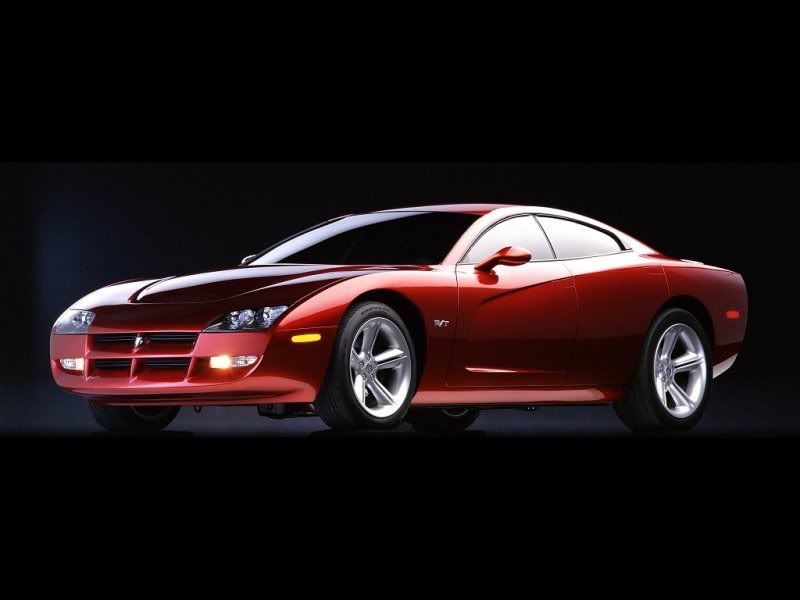

That's a pretty ambitious project! Can't wait to see it finished, it should be pretty impressive.
BTW, here's what the initial Charger concept looked like... and what we all thought the "new" Charger was going to look like:
When I saw this, I was pretty excited about the Charger coming back. In fact, I decided then that my next new car would be this one. What a disappointment it was when what we actually got looked nothing like this, but more like it was styled by the same people that gave us the new "gangsta" 300... :D
I did a couple of different renderings based on what Chrysler actually did put into production as the new Charger, including this one:
Why Chrysler didn't put the concept version into production is a mystery to me!
Harry, you don't know how many times I've wondered the same thing!
There is probably only one answer = Daimler.
I've thought about doing this very car a number of times using the original '68/'69 Charger, a Dodge Stealth roof......and maybe some fancy plastic surgery to create the front end.
.............so many projects so little time! :D

On the concept (the one that was the real concept for the what we have now charger) .. It looks like it should be a remake of an intrepid or avenger or w/e that's called...
The same grill design may be a trademark style.. but it's getting played out and to put it on a concept for a legend in the car world doesn't settle well with me
I must say, that would be LEGENDARY to see!
The one thing that I never noticed, and I don't even mind the way it was done, but the concept was a 4 door also, but it looked so right I literally glanced over it for the first several pics of it.
I just got to wonder how they went so wrong with the Charger, and ended up almost too similar to the original Challenger. Thats the Mystery. I really expected the Challenger to end up being as awful but to my surprise there is a nice treat still left at Dodge :D

I am glad to see that Harry dragged up the Charger Concept car from around 2000. I also thought that was a great looking car, but knowing the way the manufacturers worked back than, I knew it would only be a “teaseâ€, because they didn’t have the stomach to produce a vehicle that was that “cutting edge†back than, and now they don’t have the checkbook to do something like that. I fear that from here on in, at least for GM and Chrysler, it will be just boring fuel efficient vehicles for the masses. We’ll see, maybe GM has a few more Camaro’s and Pontiac G8’s in them and perhaps Chrysler, with Fiat’s guidance can give us some sporty European style sports sedans….maybe, maybe not…but anyway, the reason for this post is that I also loved the slippery and sleek updated version of the 1968-69 Charger. I built my own version of the car back than.
