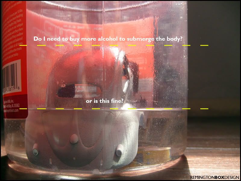

remingtonbox Posted September 28, 2009 Author Share Posted September 28, 2009 (edited) Well... I got some 90.5% alcohol just now... but it doesnt cover the bug in the container. I have a lid but does the item you are trying to strip have to be completely covered? Thanks so so so so much for all the help. I would have bought some super clean but the nearest place that carries it is 30-45 minutes away. I hope this works! Remington On a total side note... how do the pictures (except the last one) look? I am trying to get to the point of ###### Cranky, Bill Geary and others on this board that have photography skills to die for. Edited September 28, 2009 by remingtonbox Quote Link to comment Share on other sites More sharing options...
randx0 Posted September 28, 2009 Share Posted September 28, 2009 Well... I got some 90.5% alcohol just now... but it doesnt cover the bug in the container. I have a lid but does the item you are trying to strip have to be completely covered? Thanks so so so so much for all the help. I would have bought some super clean but the nearest place that carries it is 30-45 minutes away. I hope this works! Remington On a total side note... how do the pictures (except the last one) look? I am trying to get to the point of Clay, Dave and others on this board that have photography skills to die for. I haven't used the alcohol but when using chemicals it should be covered to prevent dangerous situations. Quote Link to comment Share on other sites More sharing options...

randx0 Posted September 28, 2009 Share Posted September 28, 2009 you probably need more ,however maybe you want to wait and see how this works for you before you go and get more. Quote Link to comment Share on other sites More sharing options...
Rider Posted September 28, 2009 Share Posted September 28, 2009 Not to sound like a dic but, your spinning your wheels with the alcohol, the primer is solvent based, alcohol won't do a thing. The Easy- Off WILL WORK and you'll be back to square on in a couple of hours. I sprayed my Charger when I posted and almost all of the primer is off. I hope you get this sorted out. Cheers, Curt Quote Link to comment Share on other sites More sharing options...
remingtonbox Posted September 28, 2009 Author Share Posted September 28, 2009 Not to sound like a dic but, your spinning your wheels with the alcohol, the primer is solvent based, alcohol won't do a thing. The Easy- Off WILL WORK and you'll be back to square on in a couple of hours. I sprayed my Charger when I posted and almost all of the primer is off. I hope you get this sorted out. Cheers, Curt So this Easy Off... do you get it at Safeway or ALCO? Those are my two options... Quote Link to comment Share on other sites More sharing options...

remingtonbox Posted September 28, 2009 Author Share Posted September 28, 2009 Well… I have the Bug in 32 ounces of Easy-Off. We will check back this time tomorrow and see what transpires! I couldn't find the sprayer kind so we got the aerosol. THANK YOU!!! Remington Quote Link to comment Share on other sites More sharing options...

remingtonbox Posted September 29, 2009 Author Share Posted September 29, 2009 Well, so far so good... I scrubbed it a little last night and a lot of the primer came off. I resoaked it today and I hope I can prime tonight with some Plasticote. Thank you so so so so so so much for all the help! Remington Quote Link to comment Share on other sites More sharing options...
