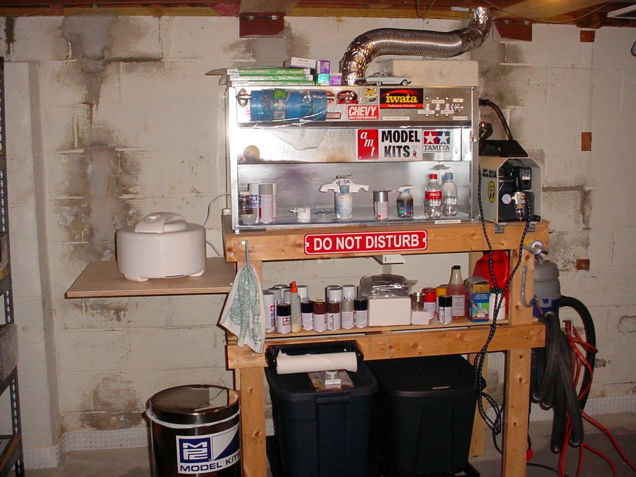

Marc @ MPC Motorsports Posted April 14, 2015 Share Posted April 14, 2015 Spend a little more money and get a Pace Paint Booth. No worries there. Quote Link to comment Share on other sites More sharing options...
mrknowetall Posted April 14, 2015 Share Posted April 14, 2015 (edited) Like Marc said! Ante up more money and get a Pace Booth. It'll be an excellent investment in your hobby, and your safety. Edited April 14, 2015 by mrknowetall Quote Link to comment Share on other sites More sharing options...
my80malibu Posted April 14, 2015 Share Posted April 14, 2015 I bought a paasche paint booth recently what size is the Pace pictured above? Quote Link to comment Share on other sites More sharing options...

karbuildr Posted April 14, 2015 Share Posted April 14, 2015 I also purchased a Pace Peacekeeper Deluxe paint booth a couple years ago. It's worth every penny. Using a proper exhaust out a nearby window you can literally paint all year long. Quote Link to comment Share on other sites More sharing options...

gluebomb Posted April 16, 2015 Share Posted April 16, 2015 I have the mini-plus Pace spray both and that works fine for 1/24-1/25 scale cars. I will also agree that it does not pull dust towards your work piece, from what I've noticed anyway. Quote Link to comment Share on other sites More sharing options...

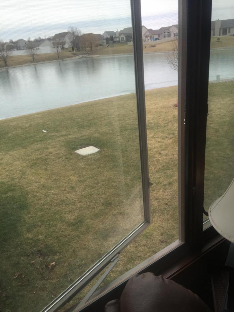

Byron5150 Posted January 28, 2016 Share Posted January 28, 2016 (edited) hi guys, For those who are venting there hoses out the windows, anyone have a suggestion or solution. For venting out windows that wind in and out, with built in removable, but not sliding screens? These are what my windows are, like I said the screen is built in but is removable. Any ideas as Im getting my airbrush compressor and am finding out I may not really need a booth for tamiya acrylics but it would be nice to have one. Edited February 2, 2016 by Byron5150 Quote Link to comment Share on other sites More sharing options...
