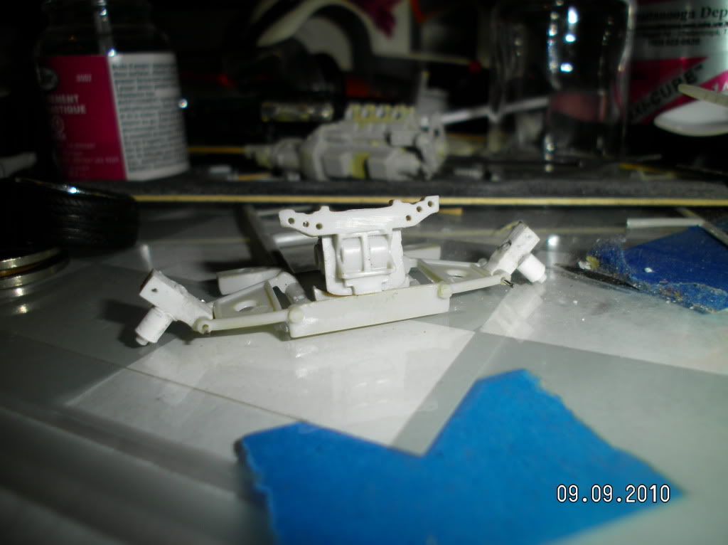

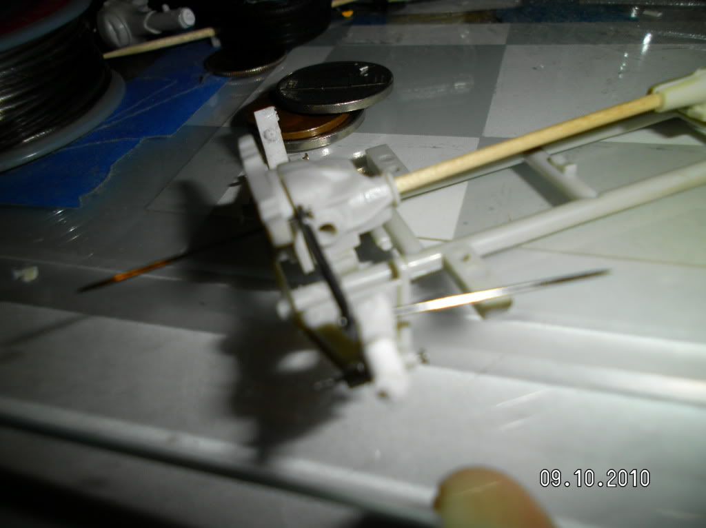

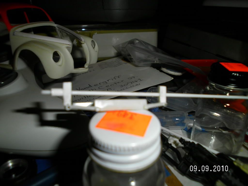

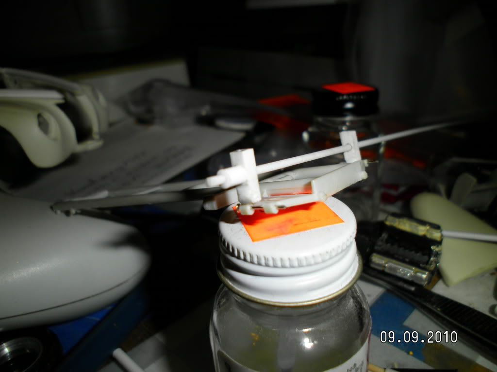

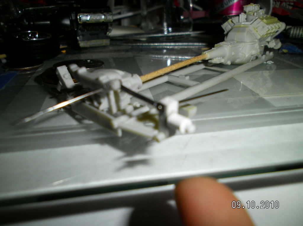

Jason Vandergriff Posted September 10, 2010 Author Share Posted September 10, 2010 Been a while since ive done anything with this. I finally got the frame partly worked out rear suspension is almost done except for shocks. I built rear spindles from square stock drilled and sanded to get a nice looking piece. Started at the lower a arm mound and worked my way up saving the wheel mount for last. Using 1/16 round stock for my center pin that my wheel would attach to. Ill redrill the back of the spindle for the drive shaft.For the upper arm i took .050 solder and my needle nose flattened an end out and drilled with a 70 bit cause im using pins to attach everything. Had i cut the rear arms loose the suspension would work. heres a few pics of whats been done. Quote Link to comment Share on other sites More sharing options...
