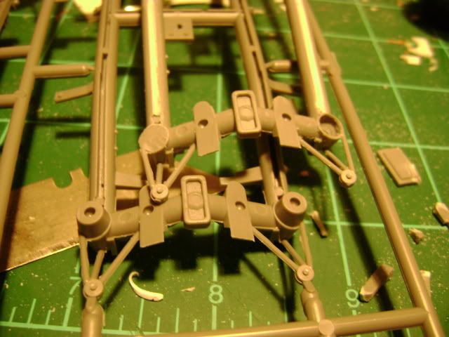

The frame has slots on the bottom of it because of the thickness of the casting to prevent the plastic from caving in as it cools. These needed to be addressed so I started shoving plastic into the notches, let them dry and started hacking them down to size. For the most part, all is pretty smooth but it will take some more filling and sanding to make it all pretty in gloss black.
All the cast in mounts and brackets were removed so they could be replaced with the photo-etched wonders in the MCG kit. One of the first modifications to the GS Corvettes was moving the battery to the rear of the car. So, I cut off and sanded smooth the battery mount on the front of the frame. The AM frame also does not have any front spring detail. It only has a boss on the bottom of the frame where the lower control arms sits. I started to grind this off with a ball bit and a low speed mini cutter being careful to avoid the radiator mounting support. Once the area was fairly flat and matched the inset area indicating the bottom of the frame, I switched to a smaller bit and started to grind out the pocket for the spring. In the pictures, you can see the unmodified frame (groves and all) along with the modified smoothed frame, one of the spring pockets has been flattened and the other hogged out.
Here is the frame with both hogged out and ready.
Next, I got out my trusty Flex-I-File and after giving the entire frame a once over, started to thin down the radiator supports. The kit supports are about twice as thick as they look on the real car.
You can see the difference in size on this picture.
And here is the thined support with just a little cleanup left.

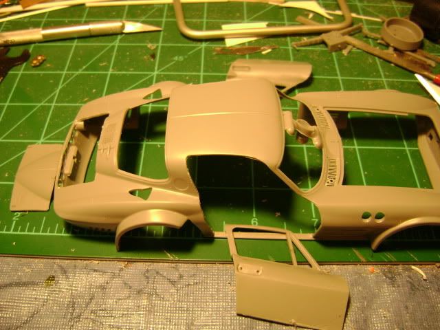

I put the frame aside to work a bit on the body. I started by grinding out the inside of the cowl vents until I could see the white edges of the vents starting to show through the back. Mind you this was with a very small burr and working very slowly. Then using a new blade, I trimmed the vents so they were open.
After this one was done, I followed suite with the second side. I then tried to gently cut out the doors and trunk lid. I have a few cuts and marks to clean up but the deed is done.
That's all for this weekend. Stay tuned for more...
