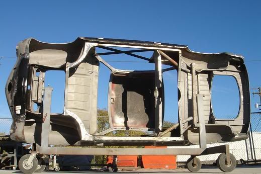

LOL!!
You guys crack me up.
No that is a metal car.
Ghia's like bugs have a pan.I have seen my friends 63 ghia without the body on it.
Here is a picture of one without the pan bolted up.
http://www.thesamba.com/vw/forum/album_pag...p?pic_id=312655
I have pictures of a few more baja ghias too.
Check out "The Samba" for great vw info and pics
A ghia is also known as a type 3.
Doug R

I think yu just proved mah point Doug.....
someone has stripped tha interior sheetmetal out, otherwise they wouldn't have put those stiffner bars in to keep tha body from collapsing in on itself, right?

zeb - There is no 'interior sheetmetal' to strip out; what you're looking at is the body unit itself, separated from the pan. The stiffener bars in the door openings were put there because that particular car was having major body structural parts replaced. The shiny metal on the underside of the rocker panels and fresh black panel under the nose are dead giveaways. The diagonal tubes just ahead of the rear wheelwells(under the rear seat area) are not structural, they just carry heat to the rocker panel channels from the engine.
