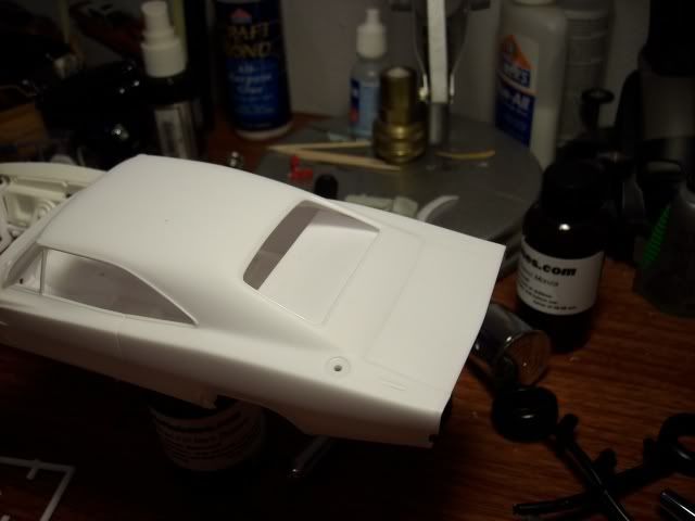

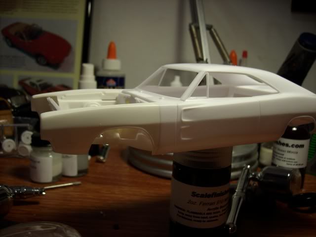

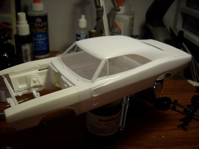

HI
THIS IS MY VERSION OF THE CHARGER 500., I use a Revell CHARGER DAYTONA AS A BASE .
I REMOVED THE FRONT AND INNER FENDERS OF THE DAYTONA AND I USED THE FRONT FENDERS AND INNER ENGINE COMPARTMENT OF THE RT.YOU JUST NEED THE FRONT GRILLE FROM THE MPC CHARGER AND THE REAR DECK DECAL TO COMPLETE IT.
THE STEEL WHEELS COME IN THE LIMITED EDITION 68 CHARGER FROM REVELL AND MIISING LINK RESIN HAS THE DOGDISH HUBCAPS .
TAKE A LOOK!
I HOPE THIS PICS WILL HELP YOU ON YOUR BUILD
