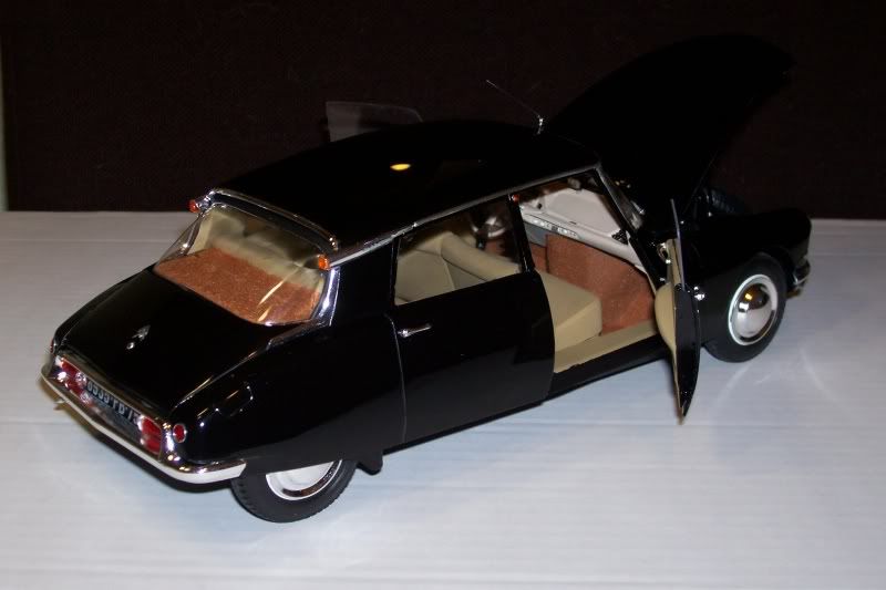

keep up the good work on this model. I love your colour combo and detailing. I also started down the dark path with this kit, it is buildable and draws a lot of interest at shows as you hardly ever see one completed.
Yours will be a show stopper once completed. I did do some detailing to mine but not as much on the interior. In the end I was glad to get it all together!
Here is a pic of my completed build.
