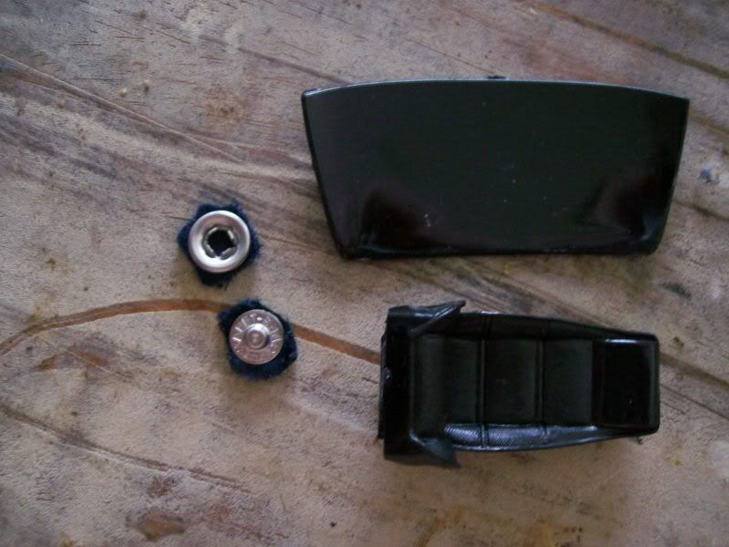

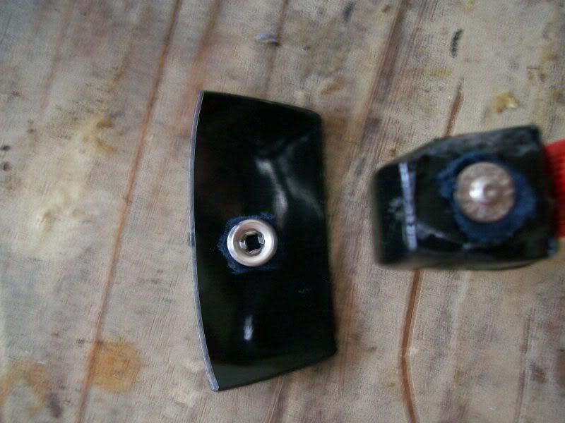

swivel seats
most lowrider cars that use seats like the ones posted above prefer to have them swivel so they turn towards the door to aide in getting out. here is a VERY easy way to replicate this.
go to a craft shop and buy a pack of snaps (like used for the top button on work shirts etc.). glue the male end to the floor and the female end to the seat. snap together. done. it is very easy and really blows people away when they are use to seeing them glued solid. the best part is you can do it very early on in the mock up and unsnap them for paint.
this can be used for seats, turrets, and just about anything that needs to spin. Also make sure you spend a little extra and buy a good quality snap. this sounds silly but the real cheap ones have alot of wobble in them.
here is some pics that may help for explaining.( as if it is needed lol)
NOTE: I JUST NOTICED I DID THE EXAMPLE BACKWARDS PUT THE PART WITH THE NUB ON THE FLOOR NOT THE SEAT!!!!! --sorry
