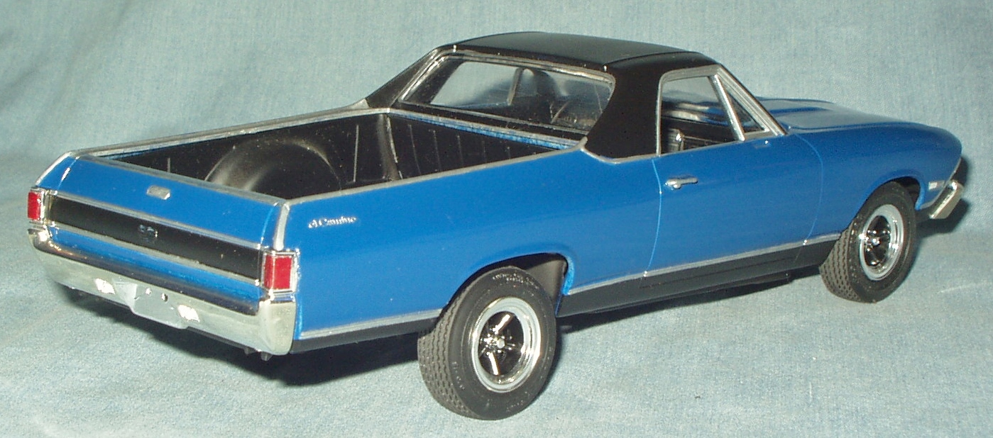

On this recent glue bomb rescue, it was missing the right taillight. I made a replacement by cutting clear plastic from a (Walmart) blueberry package, folding it to the correct angle, then coloring it inside and out with a red Sharpie. With VERY careful measuring and cutting, mine actually fits better than the left side kit part! Total time for the fabrication was maybe an hour.
Improvise! Adapt! Overcome! B)
Snake 45 you do nice work .. Thanx fr the tip . I am having no luck locating Taillights for a '63 Lincoln Continental . I will try this .. Thanx ..
Nice Camino.... 😎👍
