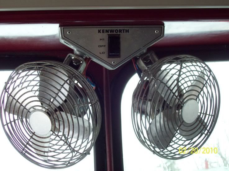

clayton Posted October 24, 2010 Share Posted October 24, 2010 Thanks guys for the tips, I have contacted both Ben and Jamie in regards to rims. I want this to build to be as accurate as I can get it. On the interior, does anyone know if the interior twin fans are available as an aftermarket item? Just don't know how I would go about making them otherwise The trailer will require some heavy mods to make it a brown Co trailer but I've got a few ideas. Also trying to find out if anyone does trailer door hinges, working ones that is? Or am I starting to dream now? Cheers Chris You dreaming,,,,,,, there is a old trailer about a block from the house what year and make don't know but maybe you can get a idea,I'll get a photos of the hinges. In fact I went trailer hunting yesterday and left the camera as home. Quote Link to comment Share on other sites More sharing options...

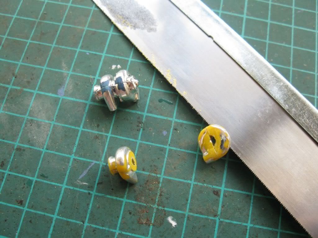

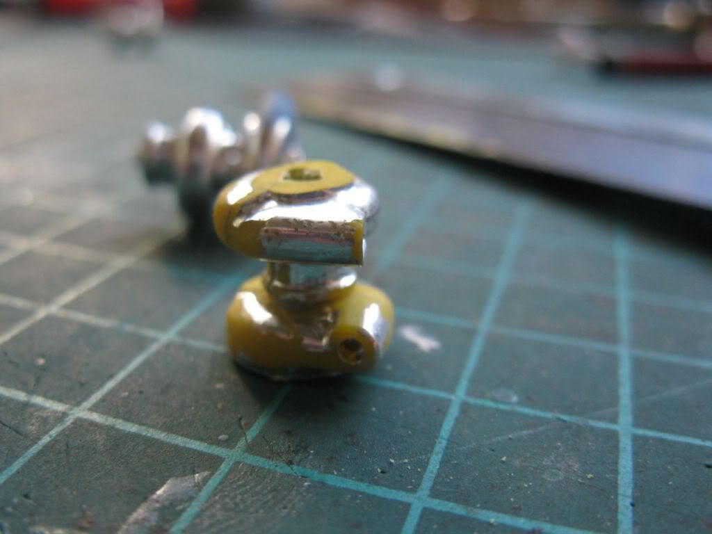

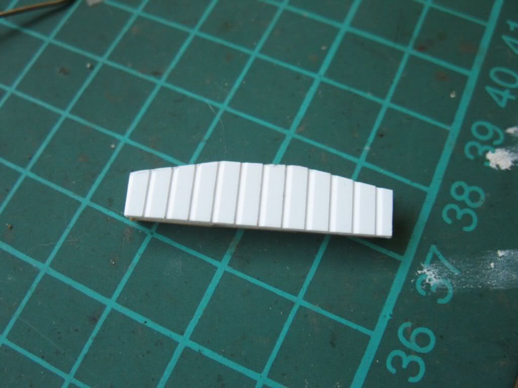

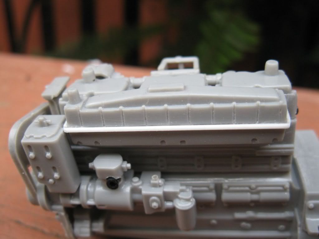

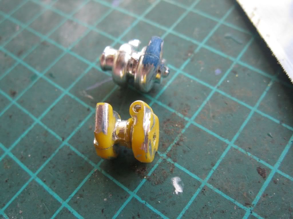

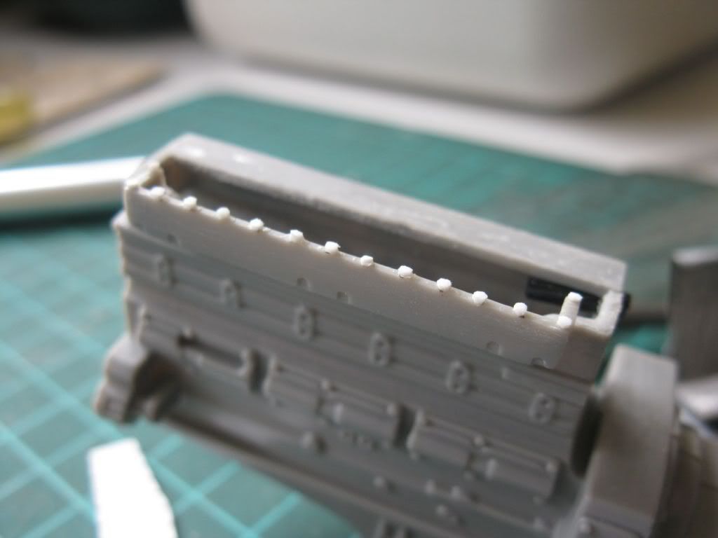

CharlieBravo Posted November 7, 2010 Author Share Posted November 7, 2010 (edited) More Engine work today. (I know, I know, I'm the slowest modeler in the world!) Wasn't happy with my last attempts on the cylinder head cover area so started from scratch and made a complete new one. Old attempt; New work; adding some bolts; Still need to sand down the bolts more This kit has a twin turbo set up. I needed to modify one for the single turbo setup as they were back-to-front if you know what I mean. Blue one is the original. I had to cut up the yellow one and rejoin in reverse. Cheers Chris Edited November 8, 2010 by BjMckay Quote Link to comment Share on other sites More sharing options...
Old Albion Posted November 7, 2010 Share Posted November 7, 2010 Chris, Nice engine detailing, I like it. Dave Quote Link to comment Share on other sites More sharing options...
CharlieBravo Posted November 7, 2010 Author Share Posted November 7, 2010 Chris, Nice engine detailing, I like it. Dave Thanks Dave, appreciated Chris Quote Link to comment Share on other sites More sharing options...
cam Posted November 7, 2010 Share Posted November 7, 2010 outstanding work, Chris your engine looks great. I don't bother with the bolt head detail but it really stands out. for me I think adding that detail would take the fun out of it, I'm already using a worklight with magnifying glass and reading glasses. Quote Link to comment Share on other sites More sharing options...
CharlieBravo Posted November 9, 2010 Author Share Posted November 9, 2010 outstanding work, Chris your engine looks great. I don't bother with the bolt head detail but it really stands out. for me I think adding that detail would take the fun out of it, I'm already using a worklight with magnifying glass and reading glasses. Thanks Cam. The bolts weren't as painstaking as I thought, just used some hex-shaped platic rod, cut off small bits, then sanded them down carefully after they were glued. Cheers Chris Quote Link to comment Share on other sites More sharing options...

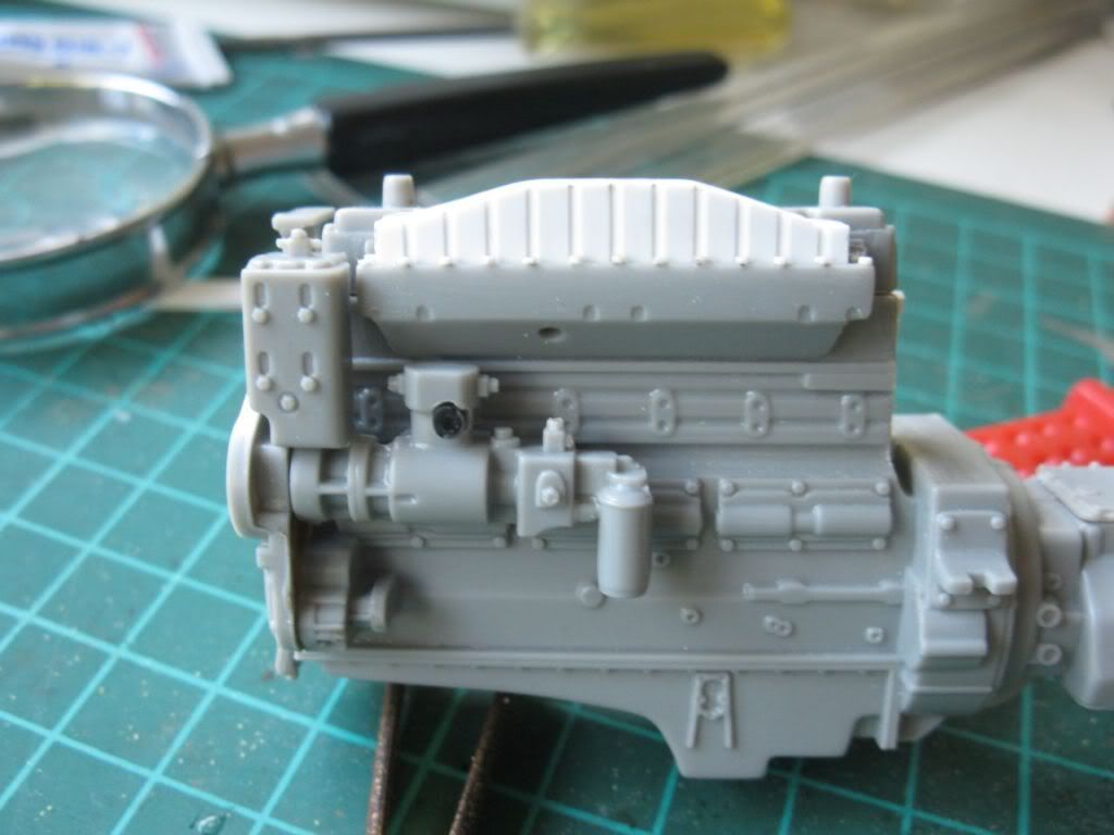

CharlieBravo Posted December 26, 2011 Author Share Posted December 26, 2011 Still alive!!! Thanks for the interest guys. This is my pet project and I've never built a truck model before(apart from a 1/32 BJ kit) so want to get it right. But yes it's been a long time since I've updated and even worked on it. I have still been sourcing aftermarket parts such as the Ben Wicker aluminum wheels, I posted shots of that in another thread titled "Aluminum 10-hole Alcoas". They are awesome so thanks to Ben and Jim Littiken for those. Been hell busy as I'm trying to get into the Australian Army as a helicopter pilot so it's taking a lot of my focus, that and my new baby girl Charlie, free time is hard to find!!! Enough excuses though. I have completely changed the work I've done on the motor again! I have got a hold of a few pieces from an Italeri Cummins which I'm incorporating into the Revell motor. I will try and post some pics of that tomorrow. I sometimes think my vision far exceeds my skill level though, especially when I see fine work like Sergey's "Love Machine" build for instance. That is some master work. I need to get cracking. Chris Quote Link to comment Share on other sites More sharing options...

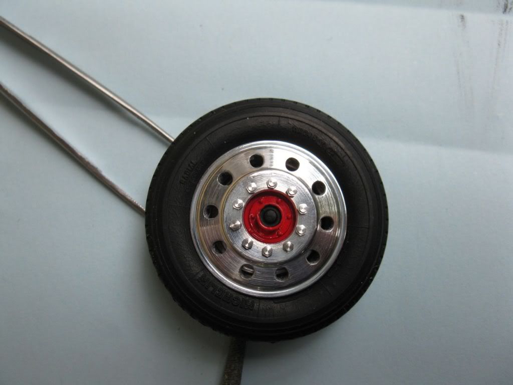

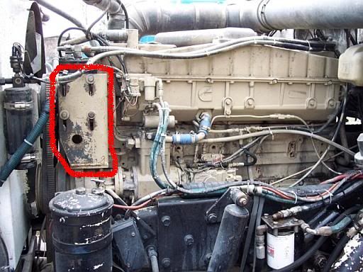

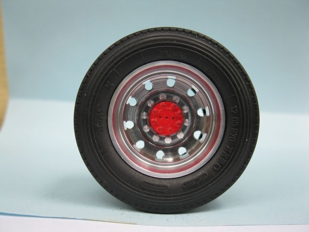

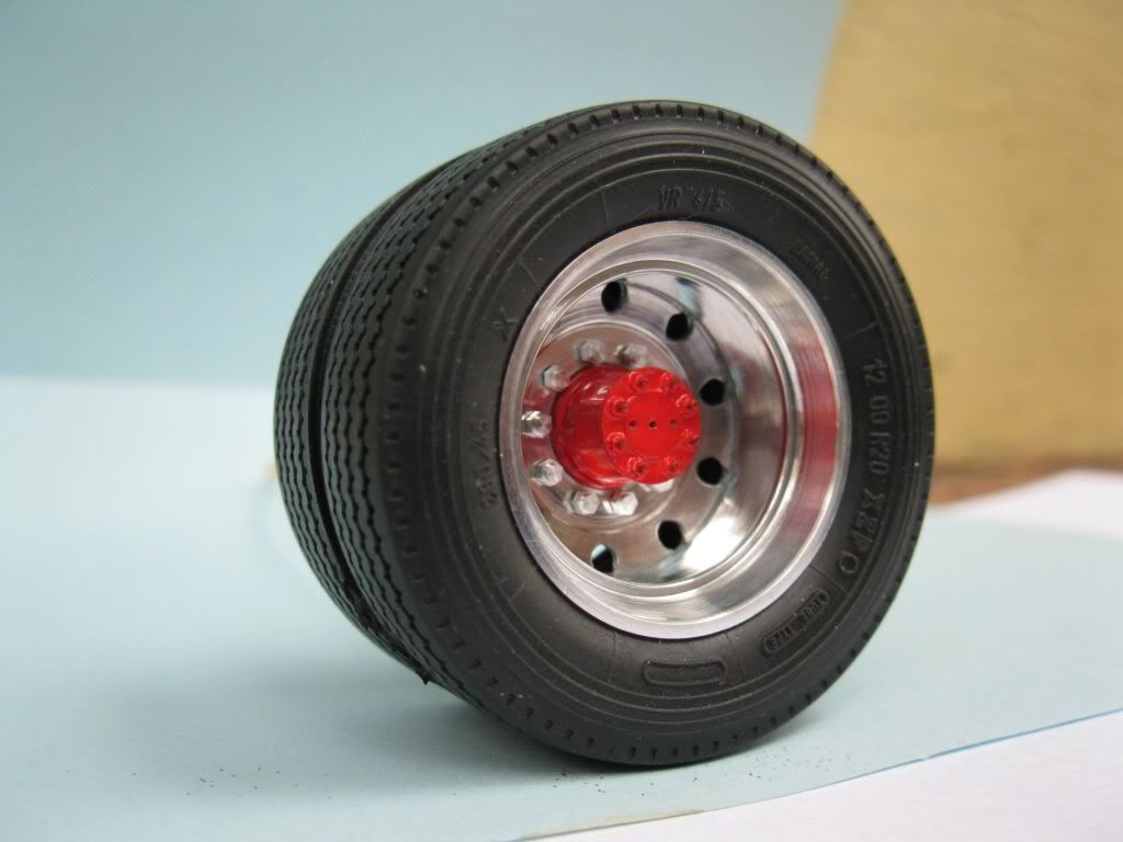

CharlieBravo Posted December 27, 2011 Author Share Posted December 27, 2011 (edited) Thanks Dennis and Jaroslav, your comments are much appreciated. Scott, I've seen those hinges of yours, they're great and will have a crack at doing them myself also. I have been still fiddling with the aftercooler area and have knocked up another attempt using parts from an Italeri kit. I am happy with it but now my problem is seeing they are 1/24 scale, they may well be too big for the revell engine? On a dry fit, it may end up being too high and too wide, but will persevere at the moment. Here's some pics. The black part is the Italeri kit part. I have posted these before in a separate thread but here's some shots of my aluminium wheels that I've had made On a separate note and pardon me for my lack of knowledge but can anyone tell me what this is and what is it's purpose? I notice it's on some Cummins and not others? BJ's rig had a Cummins NTC400BC. Does anyone know if this part is standard on that motor or should it be left off? Cheers Chris Edited December 27, 2011 by cj0203 Quote Link to comment Share on other sites More sharing options...
Semi Trailer Mechanic Posted December 27, 2011 Share Posted December 27, 2011 That's the a/c freon compressor mount/adjustment. Loosen those four bolts and the compressor wil slide up tightening the belt and down loosening it. Quote Link to comment Share on other sites More sharing options...
CharlieBravo Posted December 29, 2011 Author Share Posted December 29, 2011 Thanks Scott!! Quote Link to comment Share on other sites More sharing options...

CharlieBravo Posted December 30, 2011 Author Share Posted December 30, 2011 The rims are Ben Wicker designed and were machined by Jim Littiken. I then had them sent back to Ben after Jim machined them and he cleaned them up and also polished them. I love em! The hubs are also Ben Wicker. Quote Link to comment Share on other sites More sharing options...
