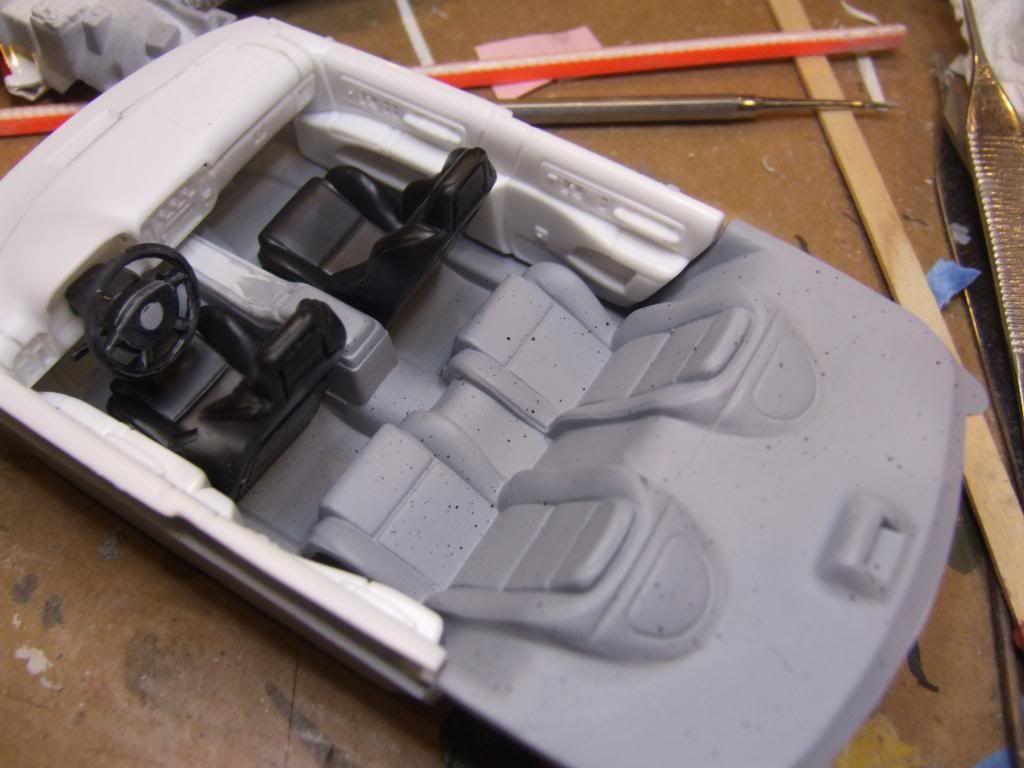

Well between work and life in general all I've finished so far is integrating the GTO rear seats into the Impala. Here's a mockup of the interior. I used the GTO wheel and column, front buckets, and rear seats. What ya can't see is the GTO's pedals and I haven't placed the shifter yet.
The GTO buckets need a lot of seam work yet.

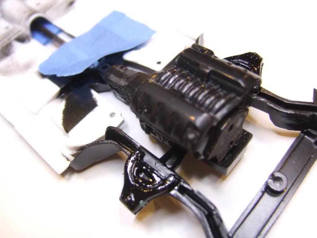

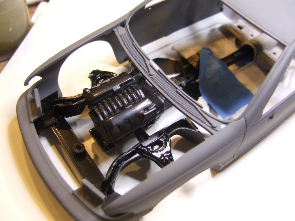

The front end has been modified to allow the LS1 to sit realistically in the frame. A coworker has a GTO so were going to pop his hood for references next Wednesday.

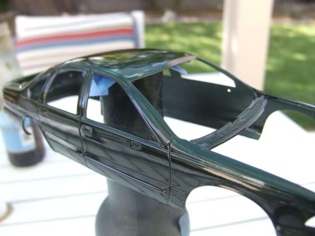

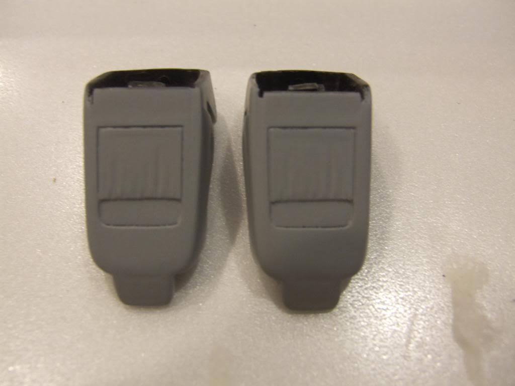

I'm still leaning toward my decision to use the original wheels from XStuning.

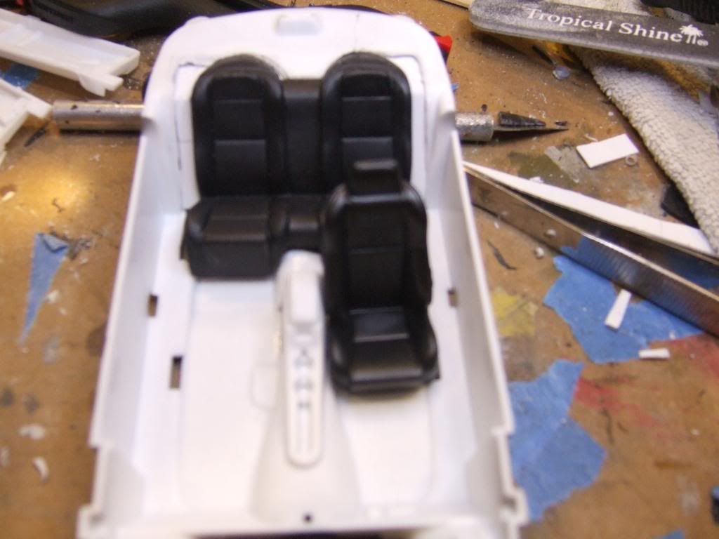

Here's the front seats sans seams.

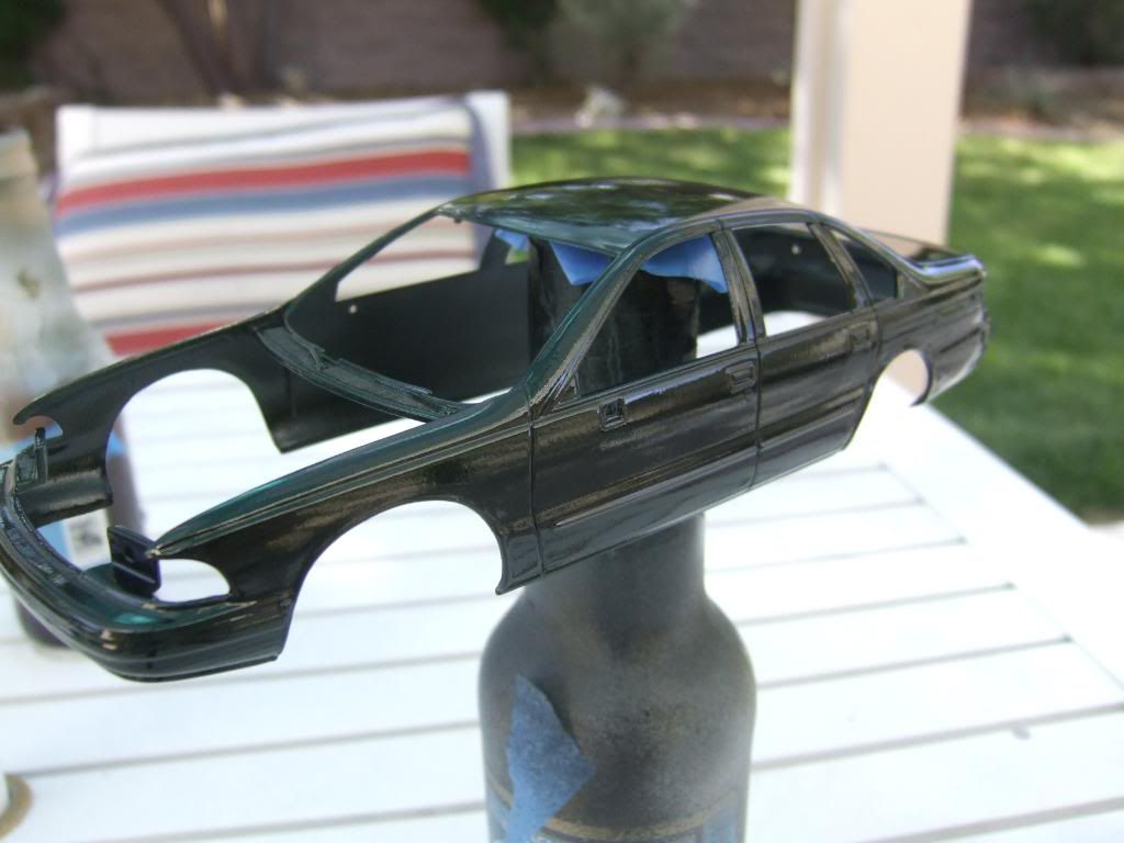

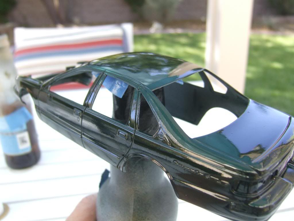

I got some color on the body. I airbrushed MM British Racing Green metallic, building up the color slowly. I dropped an airifle pellet in the jar to keep the flake agitated.
Once it dried for about 6 hours, I clear coated with MM High Gloss Clear enamel.
It looks smoother in person than in the photos. Thanks to no humidity, and the now luke warm Nevada sun this will be ready soon. I'm thinking a good rub with Novus and this will be almost perfect.
G
