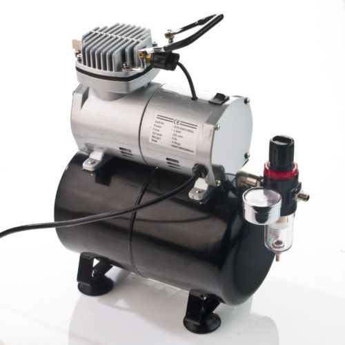

Just bought myself one of these, there made in China, (but then what isn't these days ?) by the Fenghua Bida Machinery Manufacture Co.
Sits nicely under my desk, gives plenty of power and is pretty quiet, you can talk quiet easily while it's switched on, I know a lot of people bang on about Iwata, but the cheapest Iwata over here was £250.00, and then it only had a small 450 c.c airtank, I paid 75.00 for mine, has a 3 litre airtank, no contest !
