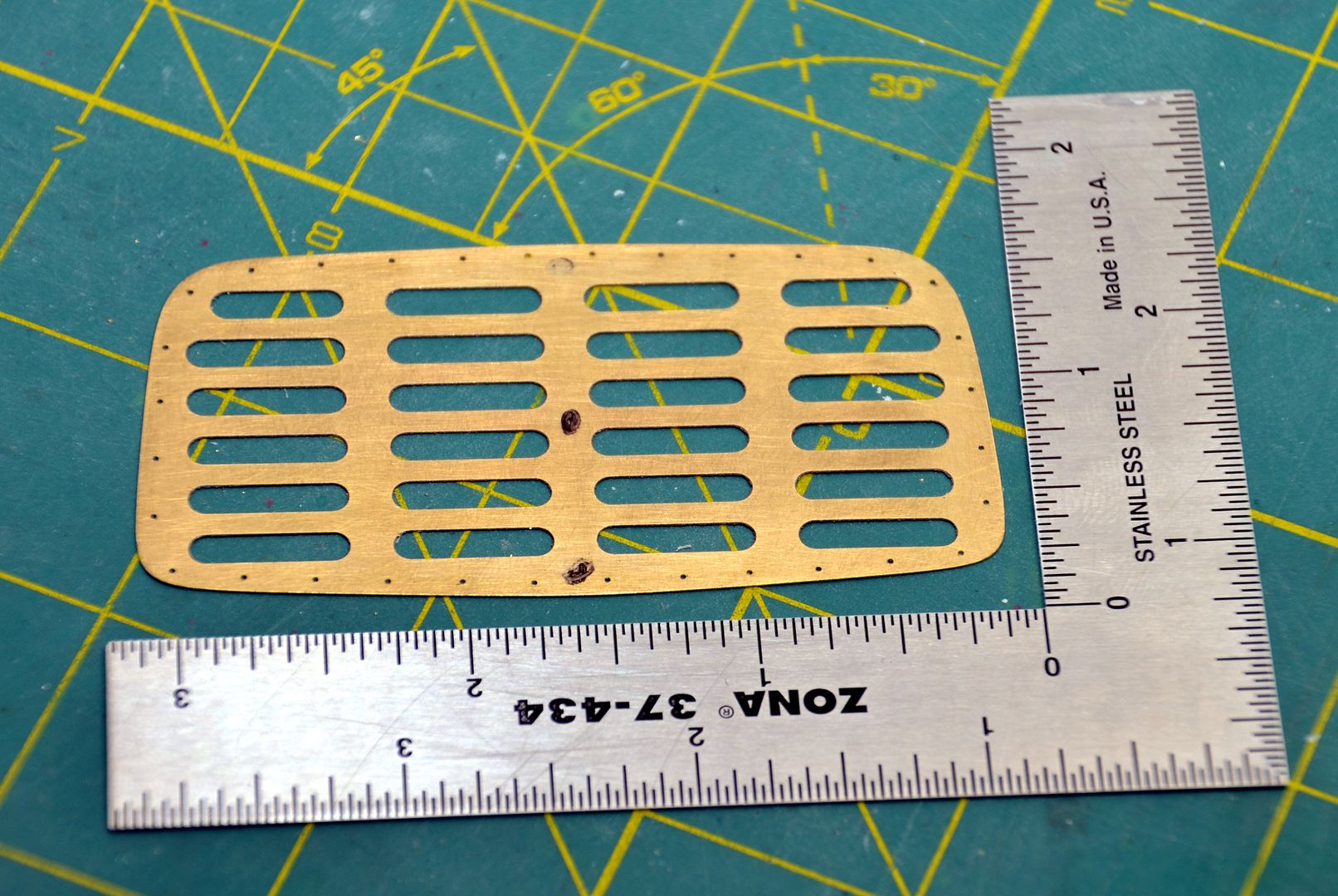

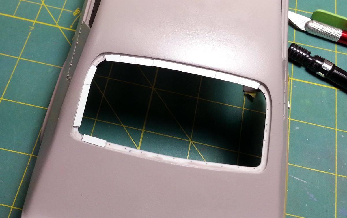

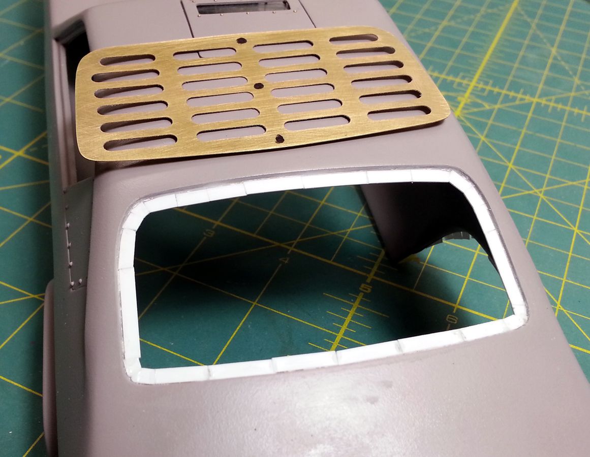

Ok Fellas... Its about time that I get an update on this bad boy. Well this past weekend I did some work on the back window to get the window that I had machined at work to fit in its proper place. Feels good to get past this hurdle now. Anyway I had to sand the edges down on the brass window to get it to fit the way I wanted but I intentionally designed it a tad on the bigger side. Well I ended up having to sand off about .025" from the sides and not quite as much on the top and bottom... maybe .010" to .015". so once I got it to fit then I had to add material to the original lip to get it to sit at the correct height. I added a piece of .020" thick Evergreen Styrene for the lip. Once the lip was added, I added some Evercoat 2 part body filler and then transfer drilled the mounting holes into the new flange. After that it was time to Transfer drill the holes into the brass window. Did that and put the rivets in to see how it looked. I am happy with it now and can move on to fixing the body tin. Here are pics of the progress....
So here is where I started by adding small strips of .020" thick Evergreen styrene to build the lip up. I glued the pieces in with Zap-a-Gap CA glue:
Here is more pieces added to the lip so you can see how it was built:
Here is is once I had all of the pieces in prior to sanding or adding the mounting holes:
Here I have sanded the lip down and now its ready for the holes to be drilled:
Here is the pics of the holes drilled into the flange. sorry that its a little blurry:
Adding more pics in next post

Good to see this back on track Chris..... Good to see.

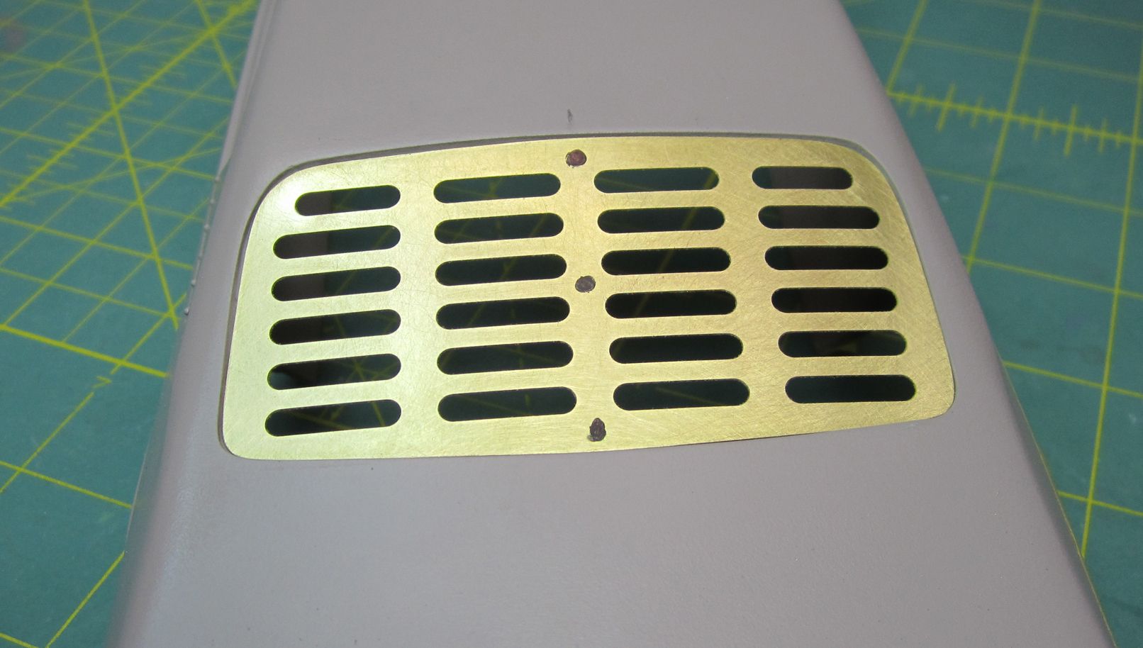

So here is the fit up of the window into its home to see how it fits, I was pretty happy at this point:
After transfer drilling the holes into the back window this is what it looks like:

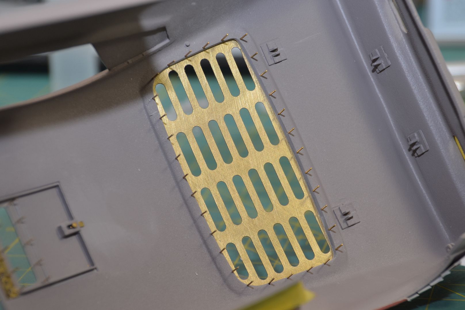

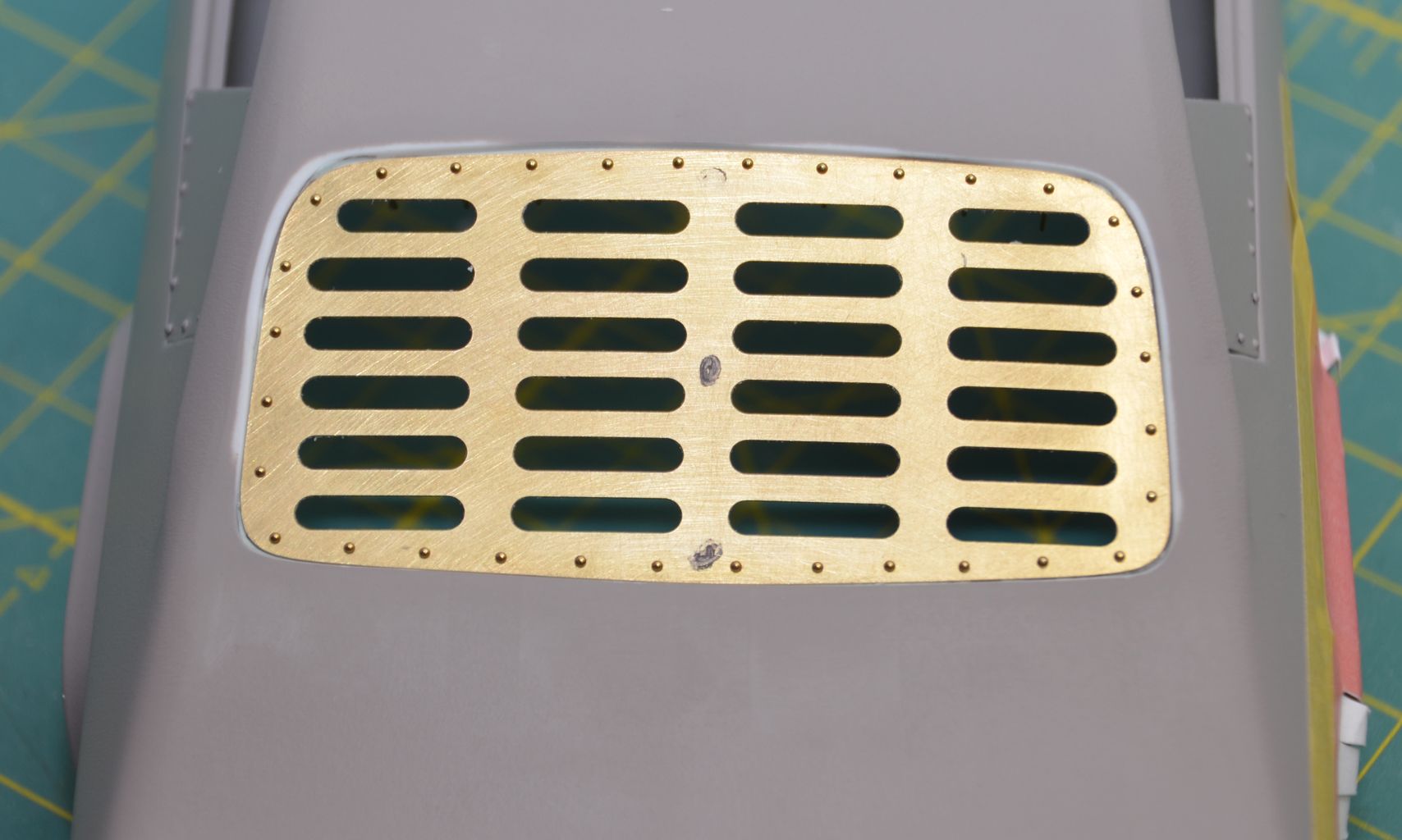

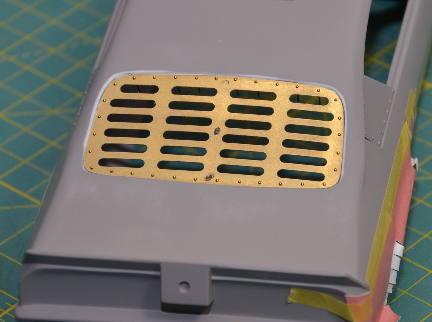

Here it is in the body with the rivets installed:
Straight on shot:
Here is what it looks like on the inside:

You are my kind of builder Chris.   I LOVE it.     Cheers Tim

Chris......Great looking window........glad you got over that hurdle;)

That's pretty major Chris. Shame it's getting painted, but when it is, it'll look like the real deal.

That came out great. So gald you used a metal piece instead of the thick plastic one that was in the kit. Nicely done. Glad you're back at it.

Glad to see this back on the bench. Nice job on the window. One more piece done. Keep up the good work.
