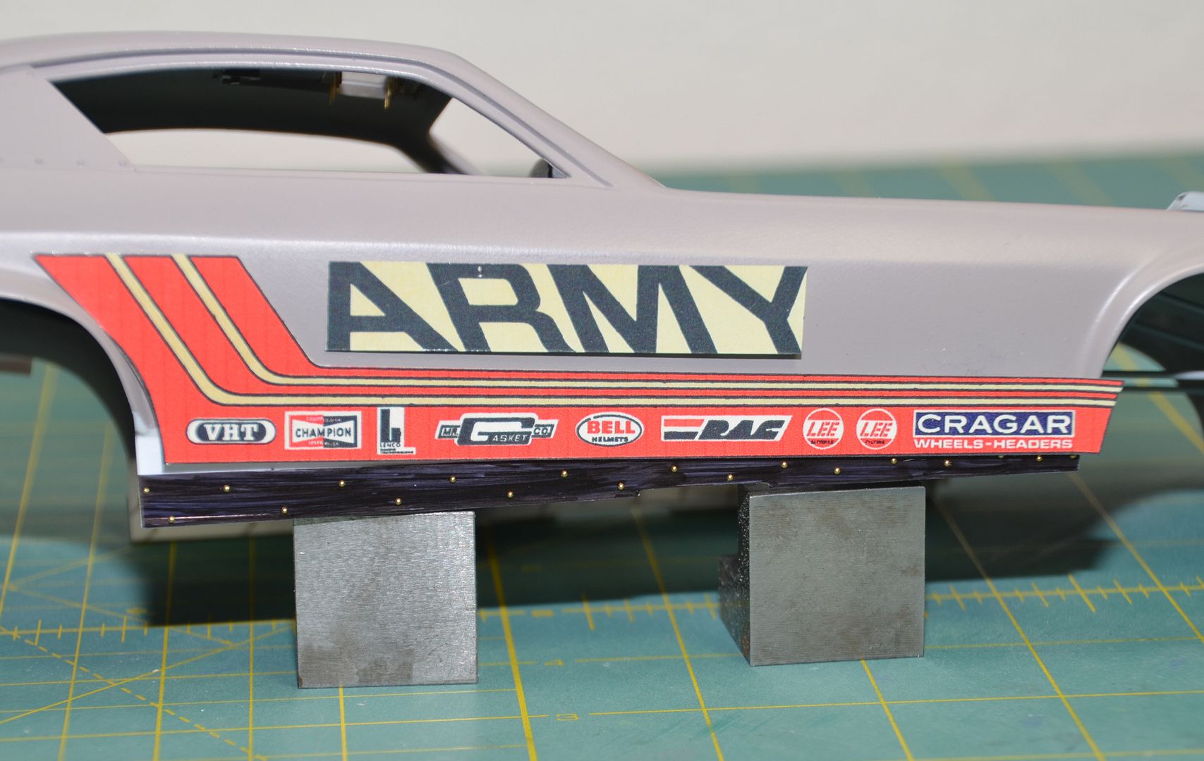

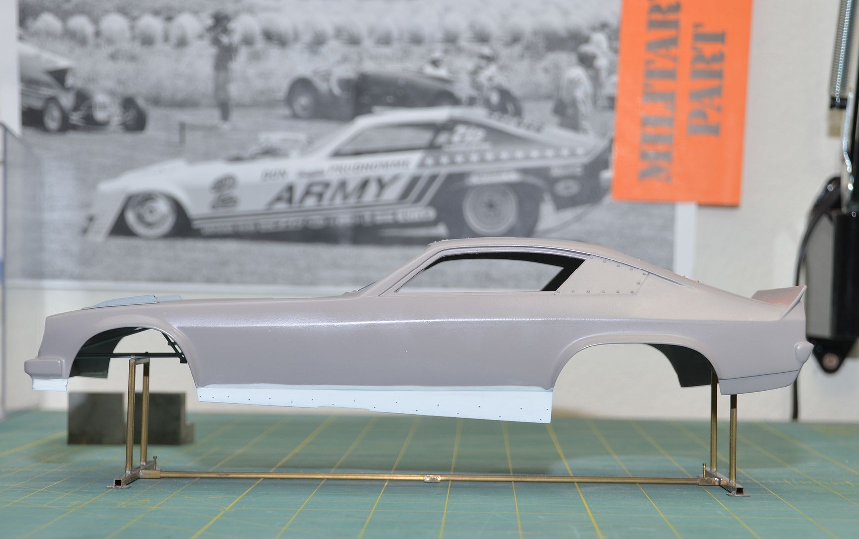

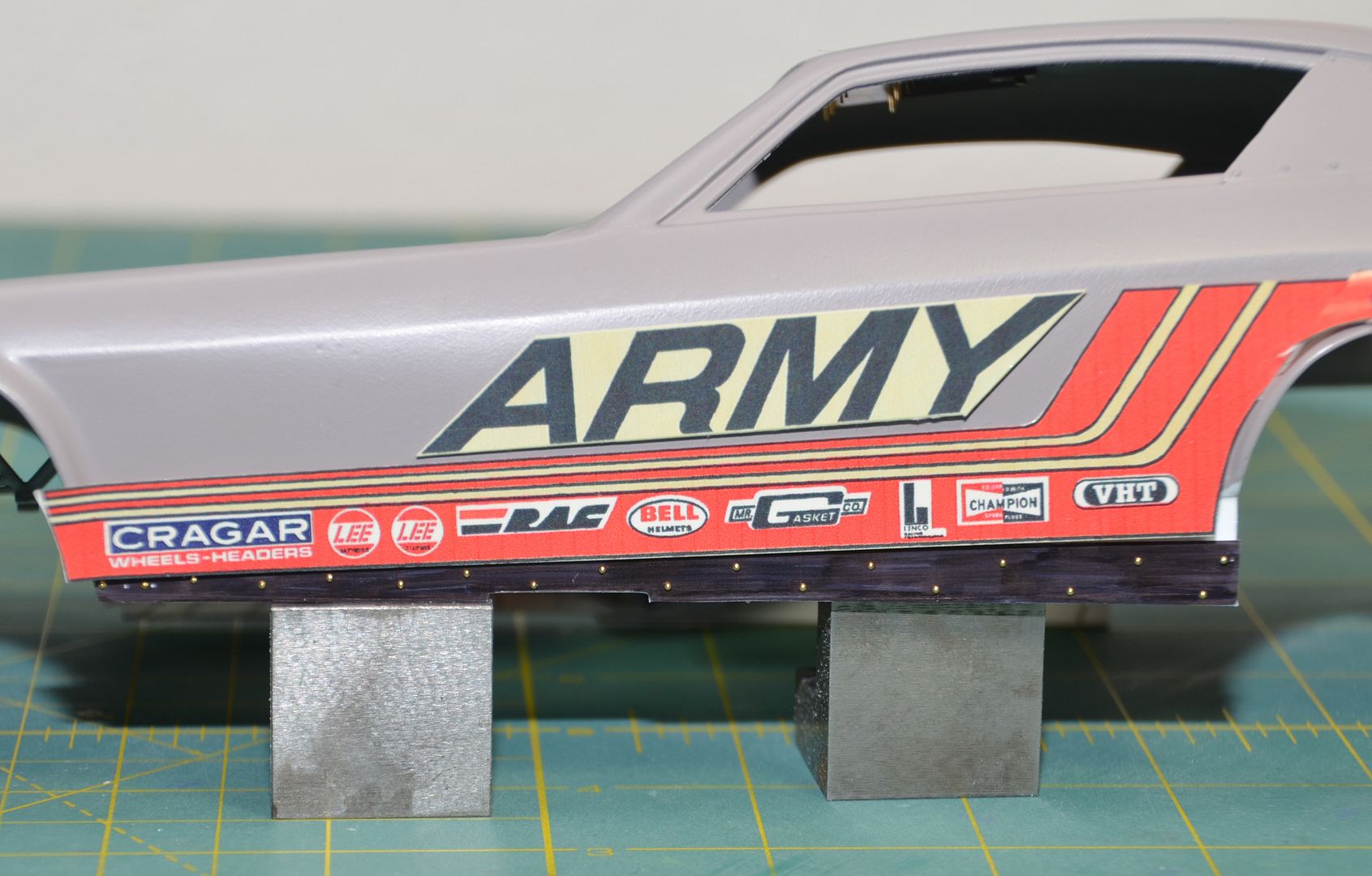

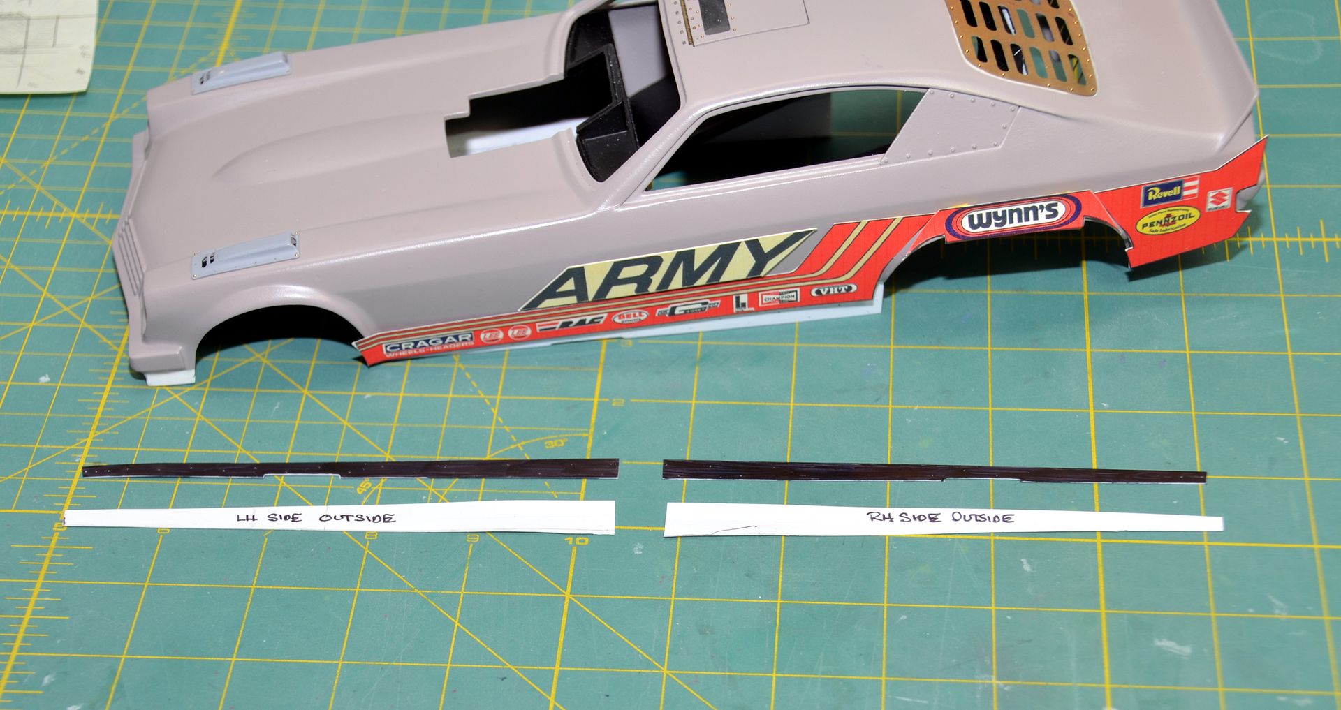

Mooneyzs Posted January 7, 2016 Author Share Posted January 7, 2016 Hello All.. I know I have been away for a little bit but I have been getting a little bit of work done and think its time for an update. Had to do a few more body mods but am finally happy with it. Hope you guys will enjoy.... So I had to extend the rocker panels down because Revell didn't do the best job in capturing the correct look well stance of the body...lol So I added some styrene to them: Did the Same thing to the other side: When I was extending the rocker panels I started by creating templates from .010" thick styrene and then I made templates for the heat shields that get attached to the rocker panel. I colored the heat shield template with a black sharpie But I will be going back and fabricating the piece of out brass for the final part, I also had cut out a set of the decals and taped them to the side of the body to get an idea of how it would look with the heat shields and placement of everything: Up-Close shot of the heat shield attached to the body with rivets from Scale Hardware: And of course here is the other side: Quote Link to comment Share on other sites More sharing options...

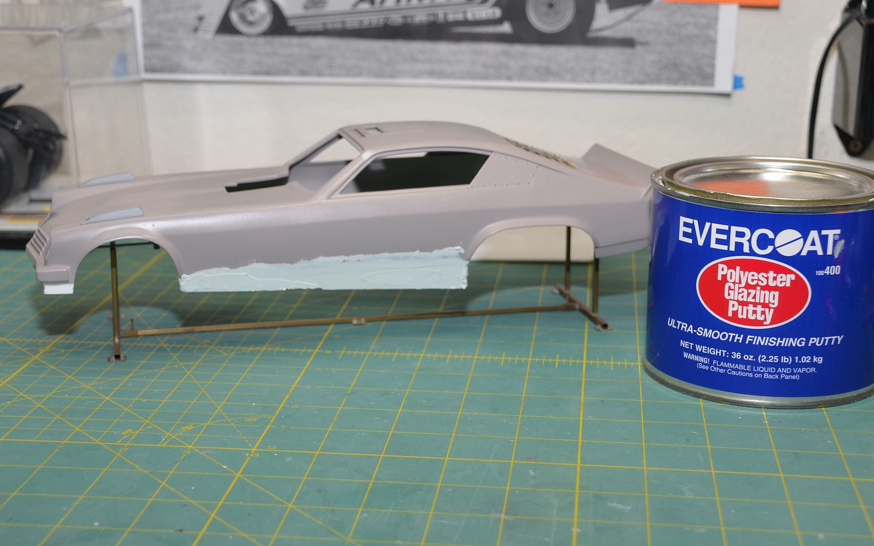

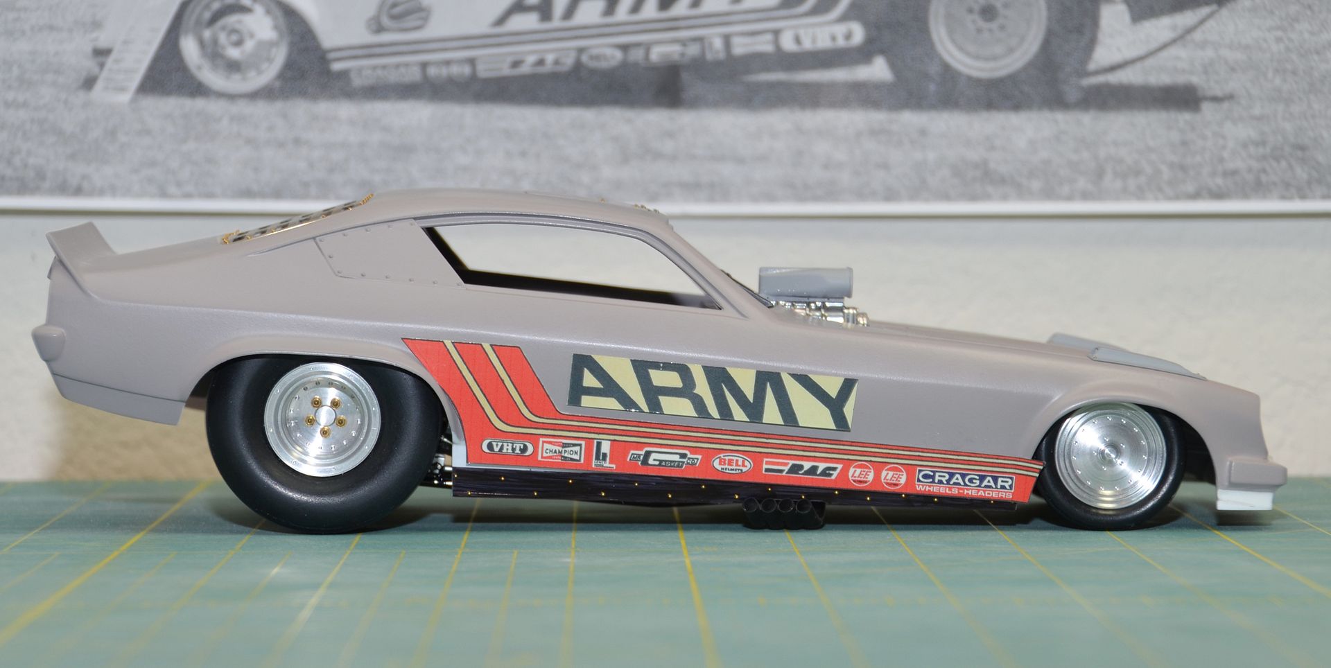

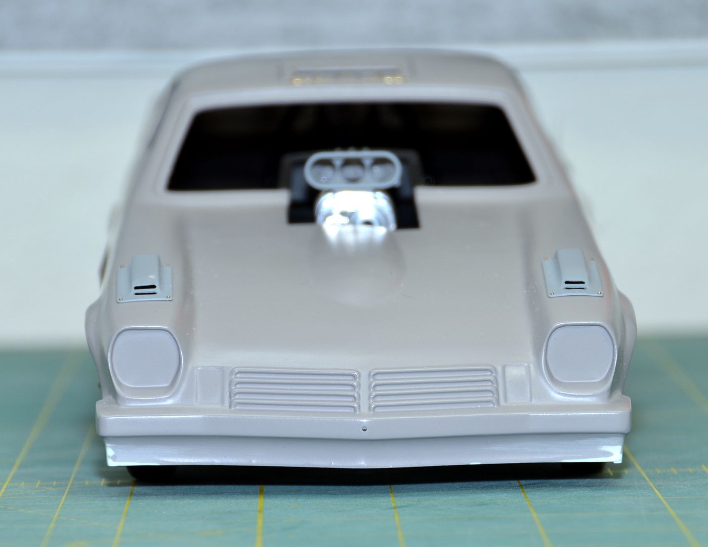

Mooneyzs Posted January 7, 2016 Author Share Posted January 7, 2016 Well you know I had to mock the body up on the chassis to take a look how it would look sitting on the chassis and well I am super happy with it now. the stance looks a little more spot on: Here its is on the other side: I had to then throw in a front shot: It is now time to add some body filler to the newly added side pieces: Body filler on the Right side: Quote Link to comment Share on other sites More sharing options...

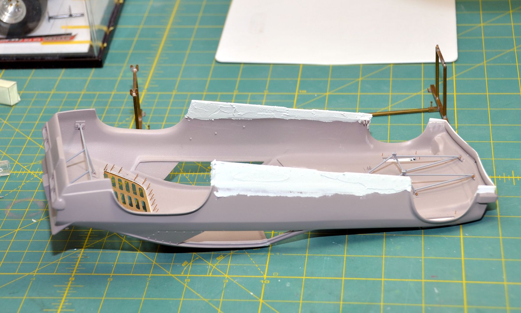

Mooneyzs Posted January 7, 2016 Author Share Posted January 7, 2016 I also had to add body filler to the inside of the pieces: So I decided to purchase a used Parachute Pack for research purposes to be able to measure and scale it down, so I can make my own. You will see here the 1:1 and then to the left I have a resin parachute from Flashpoint and then you can see a flat pattern on a small piece of paper as well as my first prototype that I had folded up in paper to see the sizing which I need to adjust one or two things on it: Here is a closer shot of my flat pattern, along with the first made chute pack and the resin one: Quote Link to comment Share on other sites More sharing options...
