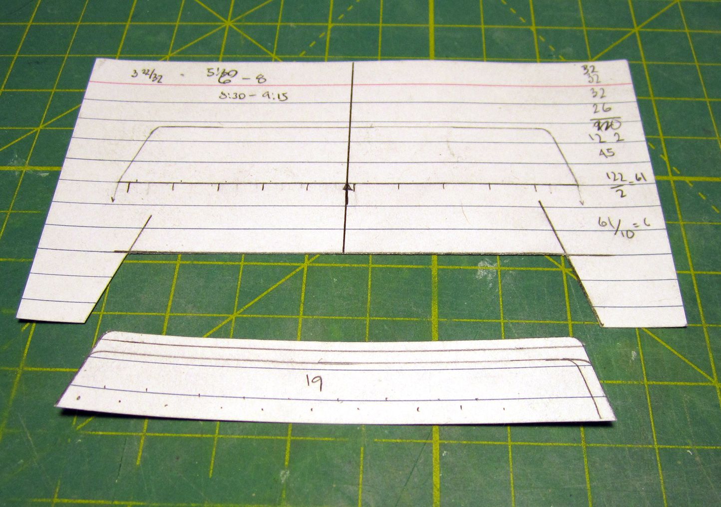

Mooneyzs Posted June 30, 2014 Author Share Posted June 30, 2014 (edited) Steve... thank you very much... Jimmy... i am still in awe of your work. Ok fellas.... i know I havent posted much lately on this but I have gotten a little more work done. I am hoping to put the last of the bondo that is needed on the tins tonight and in the mean time I have started to work on scratch building a new spoiler for the body. What was supplied in the kit just wasnt gonna do it. I spent a few hours the other night making a template for what I wanted. Started out with a 3x5 card for the template, which then turned into a template out of styrene. Then last night I made the spoiler out of brass and it seemed it took me an hour to scribe the brass. Yes I said scribe....lol. spoiler was made from .010" thick brass. I need to transfer drill the mounting holes into the brass when I get home then i will get some pics up for you. I. Making some slow progress but at least its progress and was a nice break from the tins. Edited June 30, 2014 by Mooneyzs Quote Link to comment Share on other sites More sharing options...

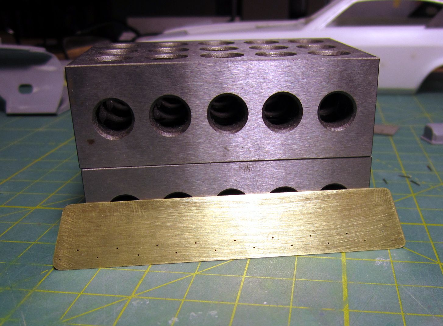

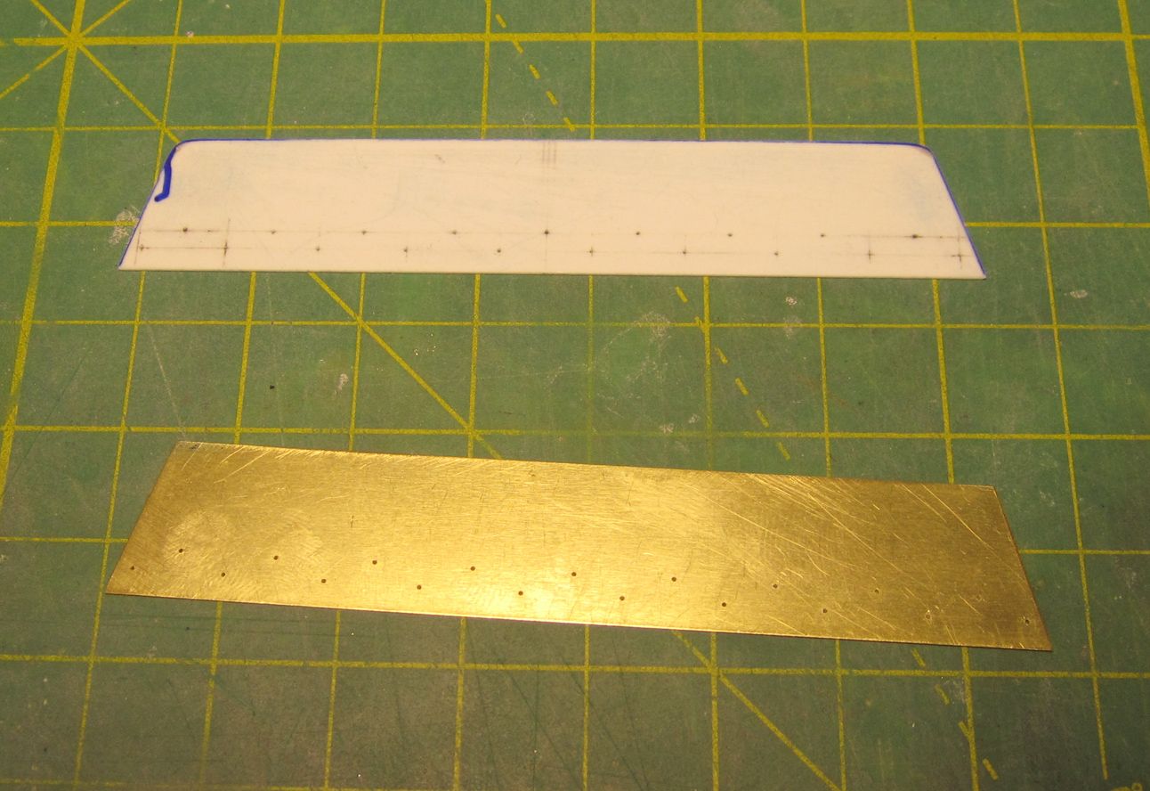

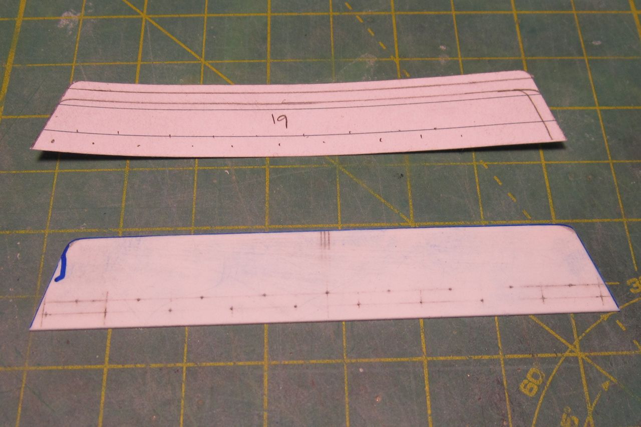

Mooneyzs Posted July 3, 2014 Author Share Posted July 3, 2014 Hello Fellas.... Finally got time to get the pictures downloaded. I took a small break from the tins and decided to work on the rear spoiler. I will let the pictures do the talking... Here is the start of the spoiler. I started by making a template out of a 3 x 5 card: I next made a template out of some Evergreen Styrene and got the mounting holes drilled into it: I decided to make the spoiler out of .010" thick brass: Here is the the 2 templates and the spoiler out of brass: Here is the start of me transfer drilling the mounting holes from the styrene template to the brass piece: Quote Link to comment Share on other sites More sharing options...

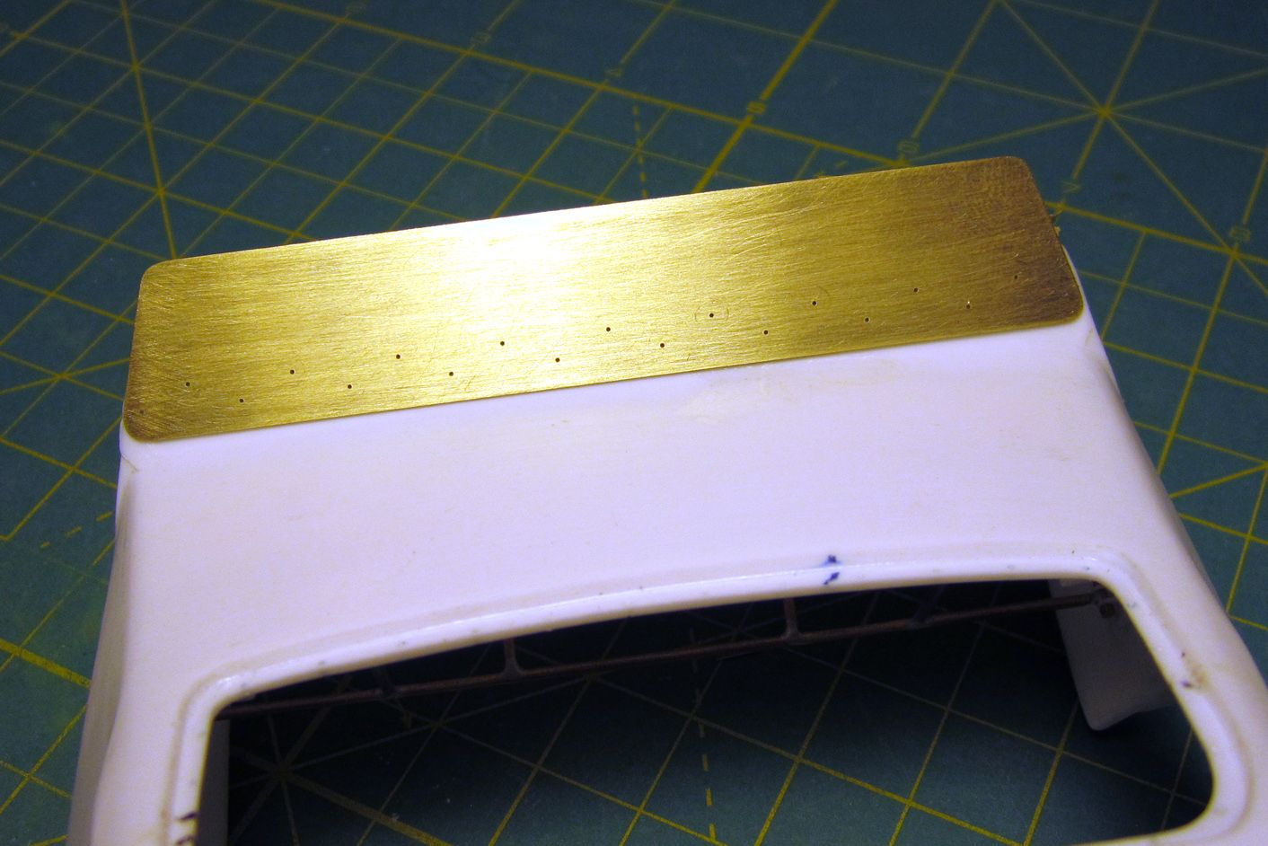

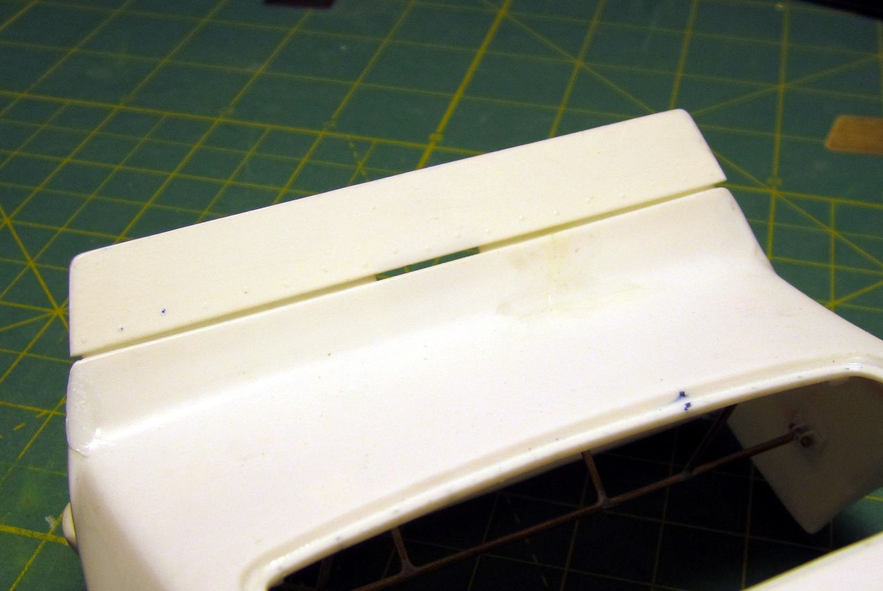

Mooneyzs Posted July 3, 2014 Author Share Posted July 3, 2014 Here is the piece once I was done drilling all of the holes. I couldn't believe that it took me 2 to 2-1/2 hours to drill 19 holes....lol, Guess that's how it goes drilling the holes by hand with a .016" drill bit: Here is the Spoiler with the corners rounded: Here is what the kit spoiler looks like on the body: Here is the new spoiler on the car. I still need to transfer drill the mounting holes from the spoiler into the body: Quote Link to comment Share on other sites More sharing options...

jwrass Posted July 3, 2014 Share Posted July 3, 2014 Chris, Looking great!!!!! Very nice detail work, super finish on the brass. All ready for some of that new primer I like your jig set up. Where did you got those L shaped blocks? jimmy 'Rass" Quote Link to comment Share on other sites More sharing options...
