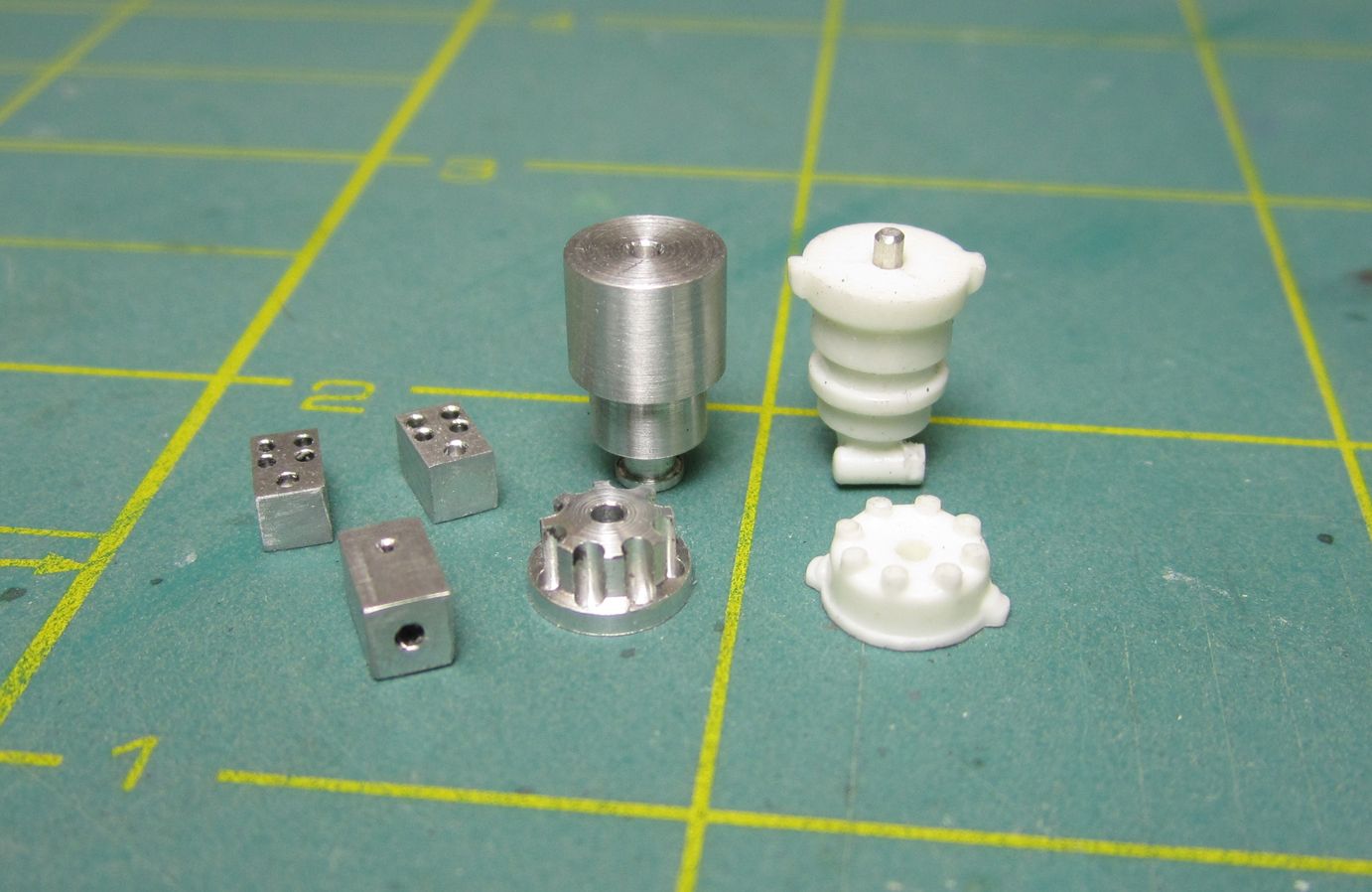

Mooneyzs Posted April 20, 2016 Author Share Posted April 20, 2016 Here is a very minor update.... I have started on the distributor cap. Here is the machined cap and base: Here I have cute some 3/64" Dia brass tube 1/8" long and placed into the cap: Here is the cap sitting on the base. More work still need to be done to both: Quote Link to comment Share on other sites More sharing options...

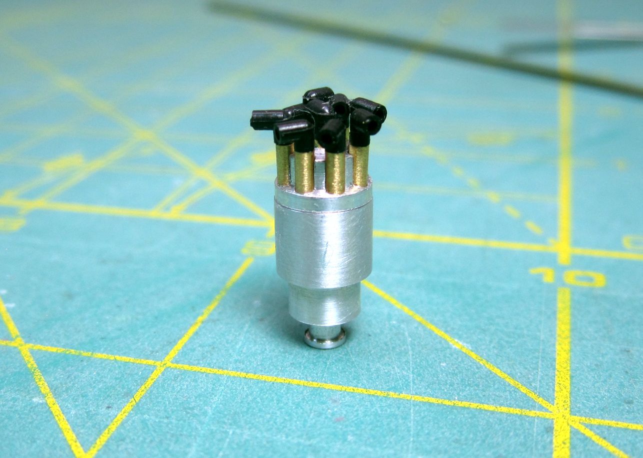

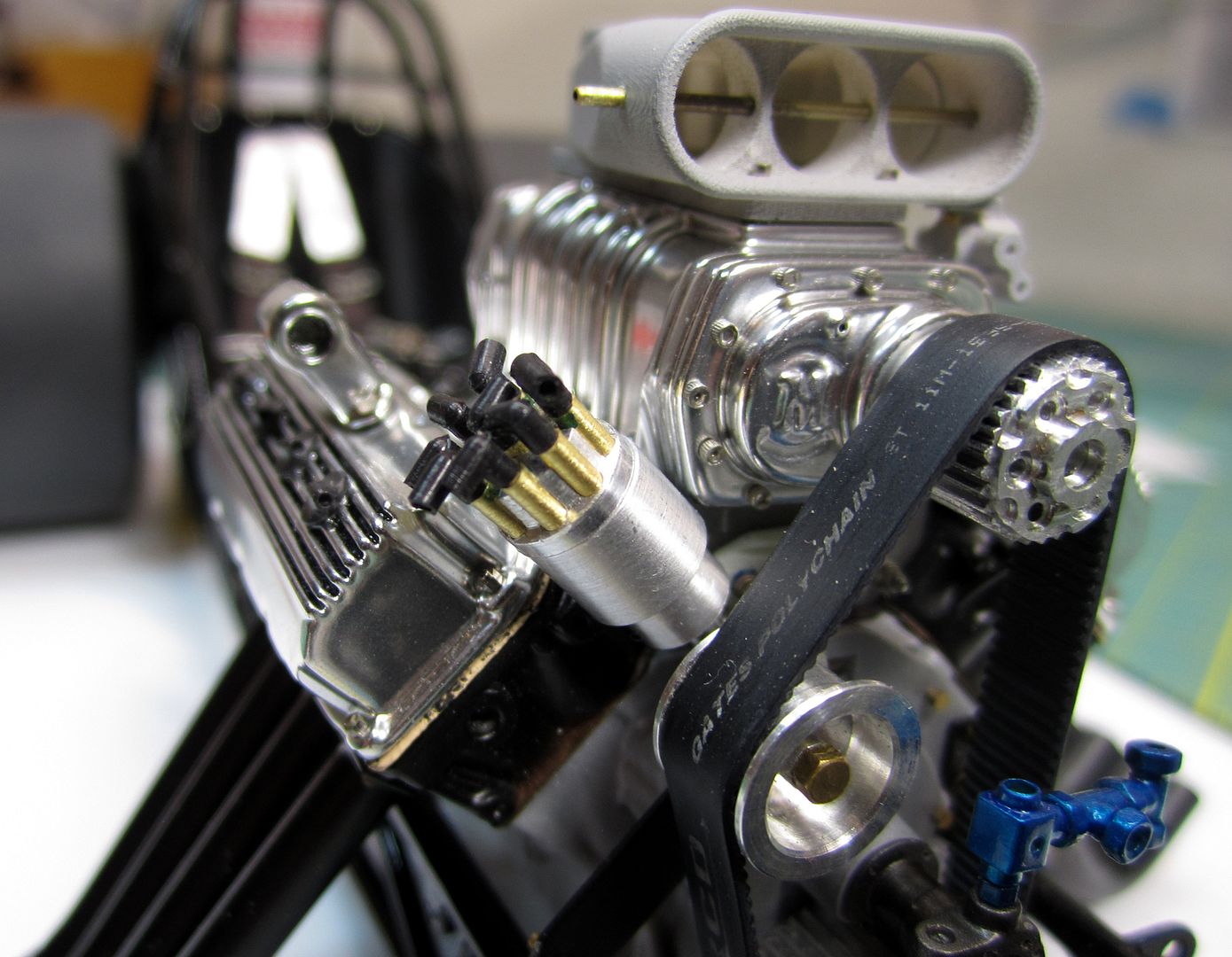

Mooneyzs Posted April 21, 2016 Author Share Posted April 21, 2016 Ok its time for a quick update.... I have been doing a little more work to the distributor. was working on the distributor boots. They are from RB Motion. Here are a few pics.... Here is the distributor cap with the boots in place: Here is the distributor mocked up on the engine: Quote Link to comment Share on other sites More sharing options...

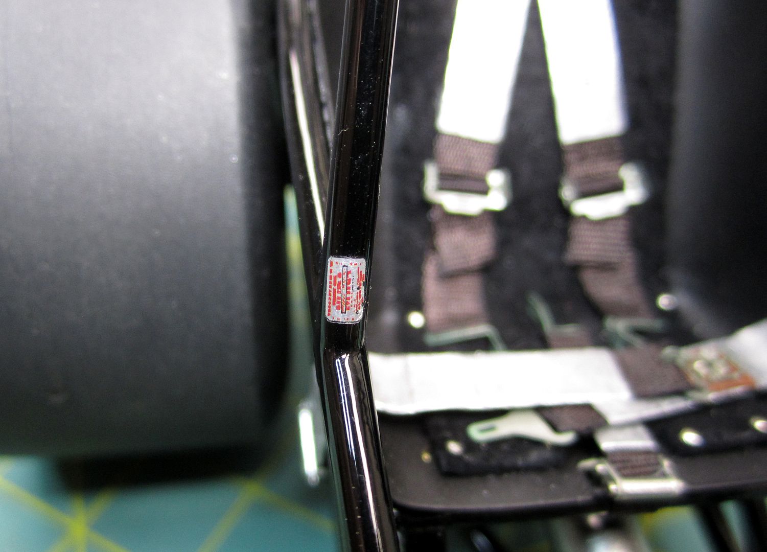

Mooneyzs Posted April 30, 2016 Author Share Posted April 30, 2016 Ok Fellas... just a quick teaser pics to show you guys. I am hoping to be at the bench most of the day today so we shall see what all I can get done and hopefully I will have some updated pics to share later today or tomorrow. I was able to get the Chassis Cert Sticker installed: Quote Link to comment Share on other sites More sharing options...

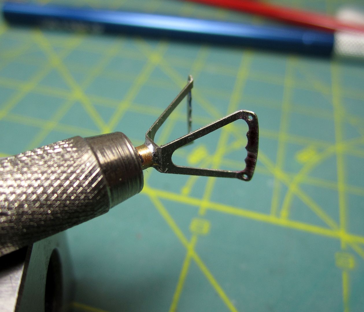

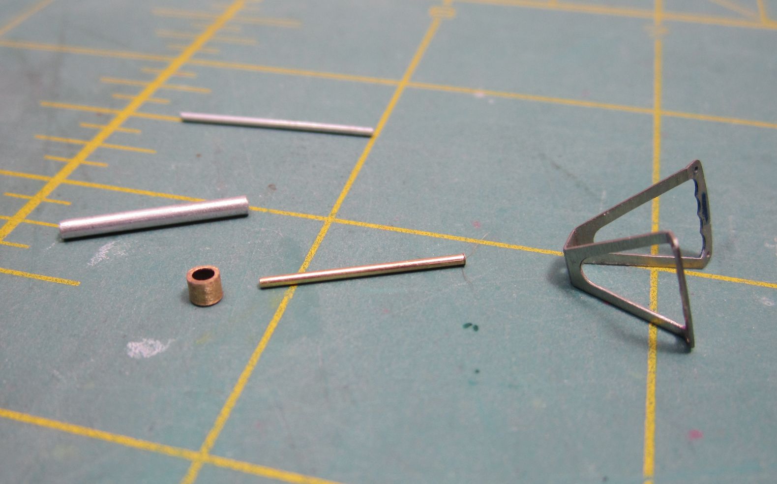

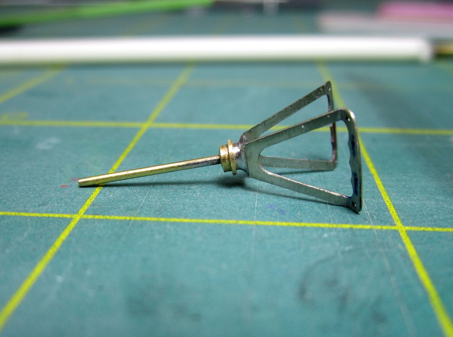

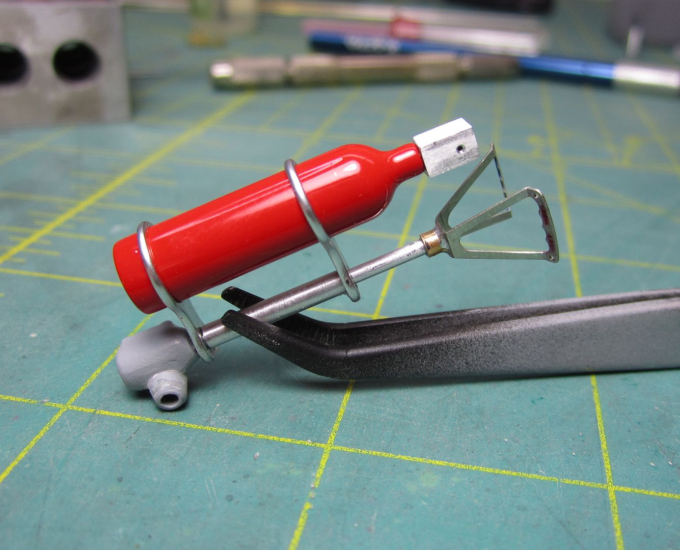

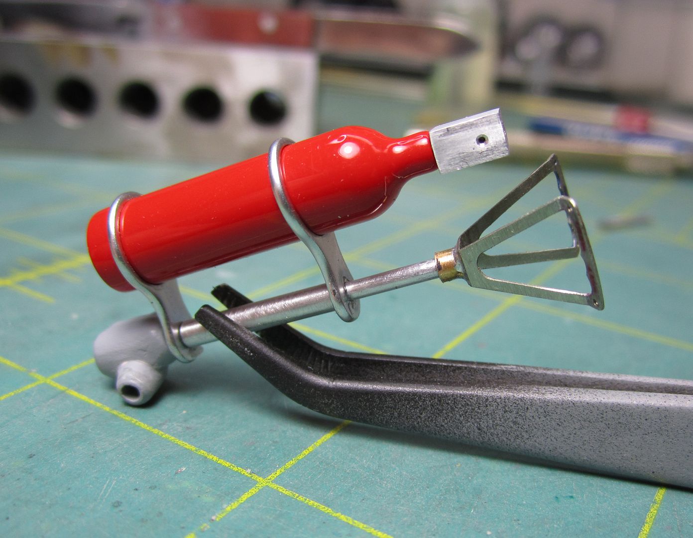

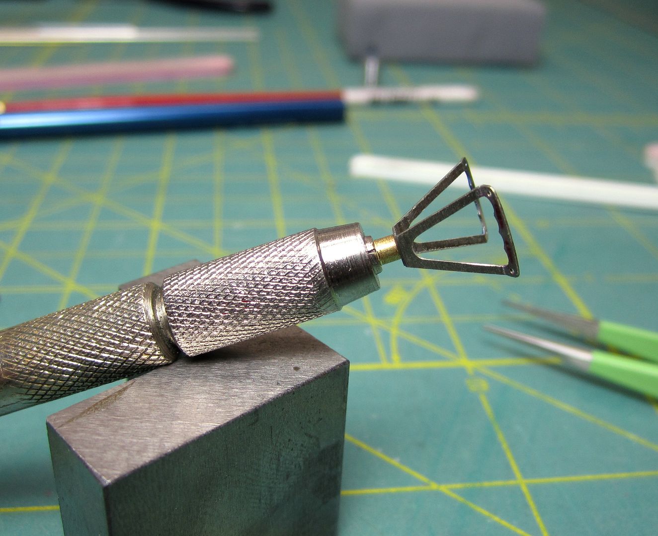

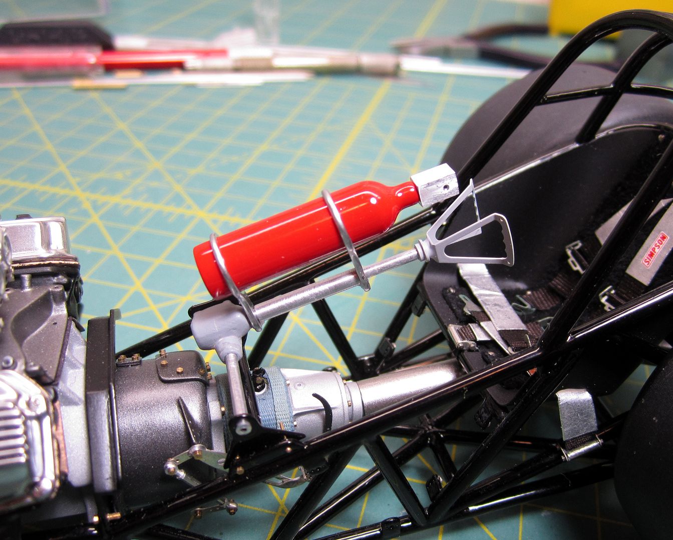

Mooneyzs Posted May 1, 2016 Author Share Posted May 1, 2016 Alright Fellas.... It's time for another update. I got some bench time in today. I started with working on the distributor cap and the Mallory ignition box. got them sanded and primed and then went in a different direction and worked on the butterfly steering wheel. I needed to make the quick disconnect attachment and think I am pretty happy with how it turned out so far. There is still some sanding and prepping to do but I think it should do the trick. Alright onto the pictures.... Here is all of the parts that I started with. Future Attractions 1/16th scale Photo-Etch Butterfly Steering Wheel, 1/32" Dia. Brass Rod, 1/16" Dia. aluminum Tube and 3/32" Dia. brass tube: Here is the steering wheel mocked up. Now the reason for the Aluminum tube was to use it as a spacer to keep the quick disconnect centered on the steering wheel. The steering wheel had a hole in the center which I put the 1/32" Dia rod thru and then the 1/16 Dia Aluminum tube slipped over that and then the 3/32" dia brass tube over that. I am soldering these pieces together and I purposely used the aluminum so that the solder would n't stick to that and it would get removed: Here I was using my Pin Vise to hold the pieces together so I could solder them: Here is the Solder joint after soldering it: Quote Link to comment Share on other sites More sharing options...

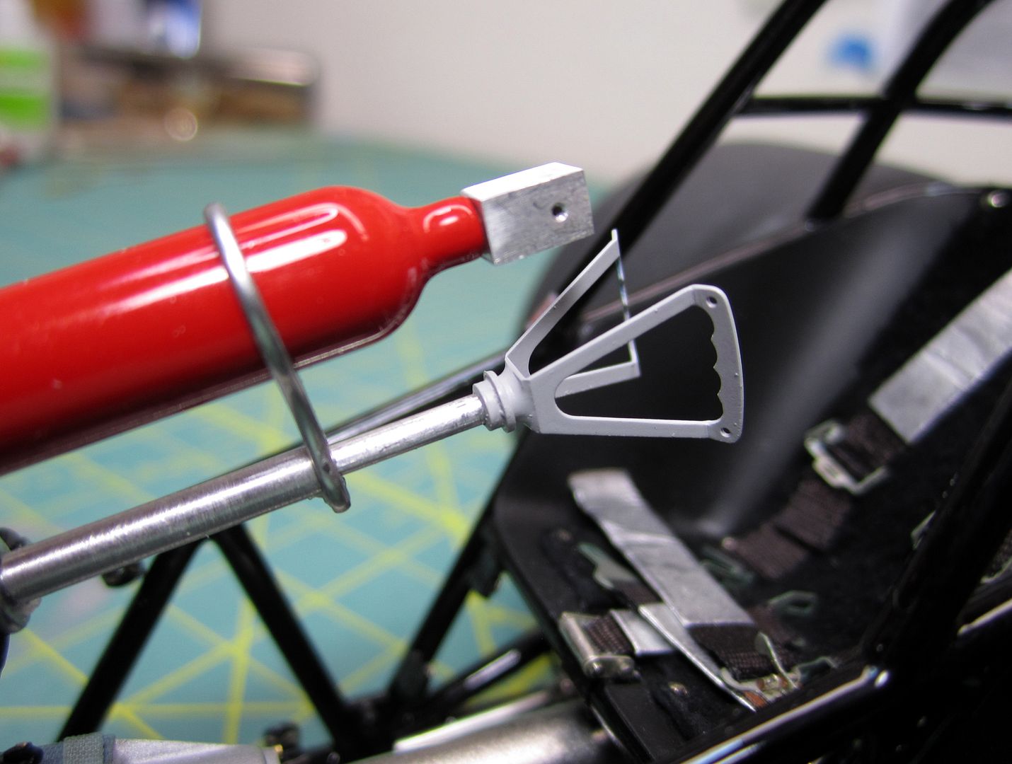

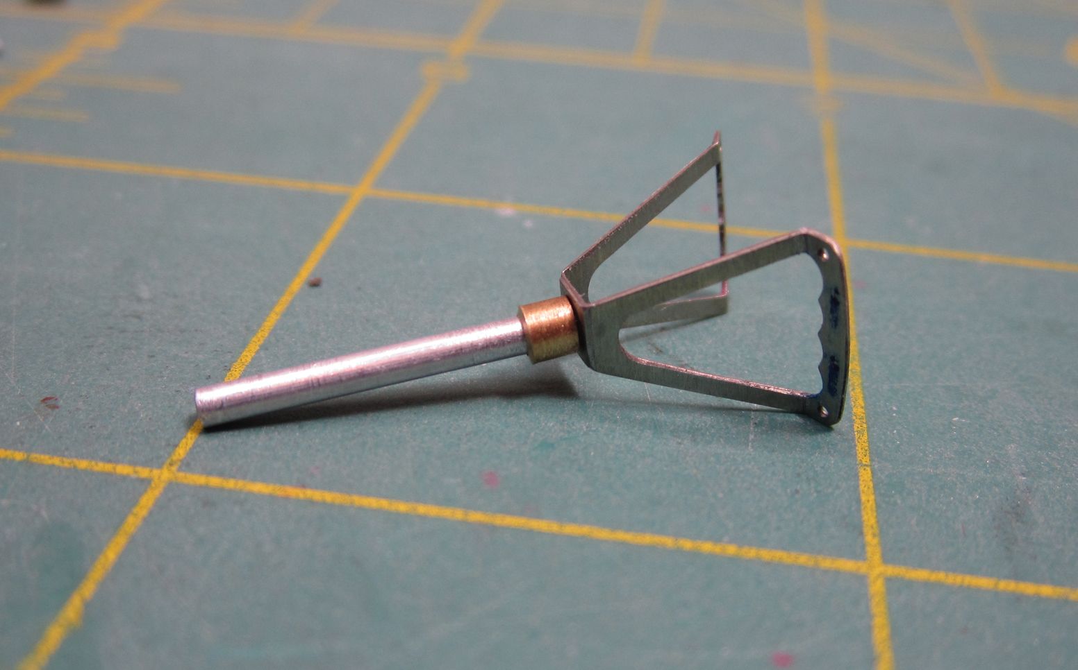

Mooneyzs Posted May 1, 2016 Author Share Posted May 1, 2016 After getting the Steering wheel Soldered up I had to see what it looked like on the steering shaft: Then I had to go back and make a very small ring to put on the quick release to represent the quick release lever: I then got the Butterfly steering wheel shot with some Tamiya primer to see how things look and It needs a little sanding: And here is a close up of it, I can't wait to get it painted black and the wood grips glued on to it: Quote Link to comment Share on other sites More sharing options...
