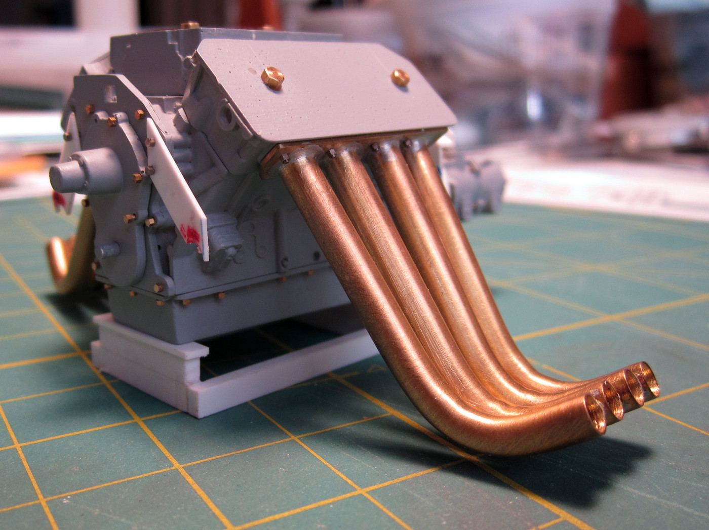

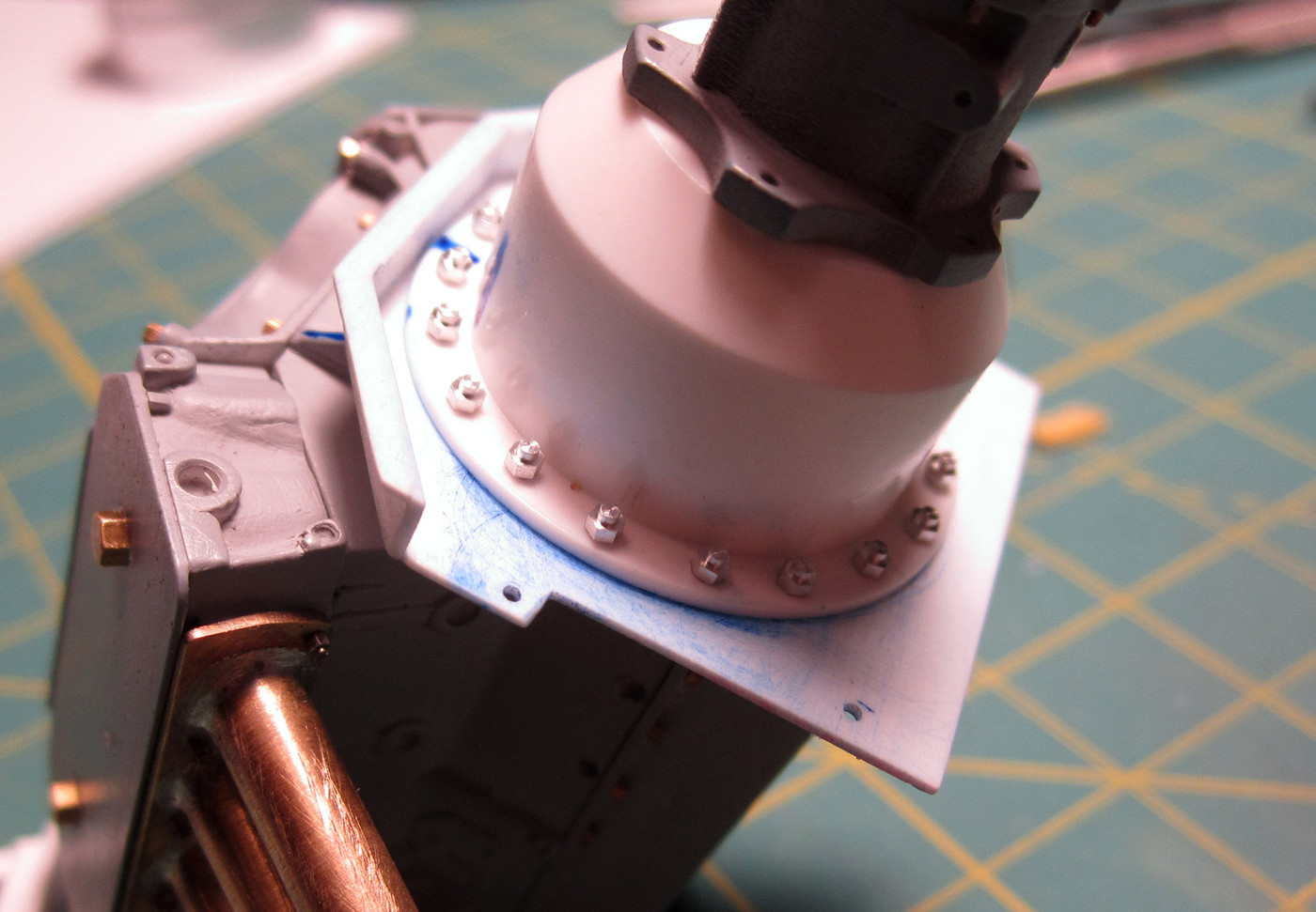

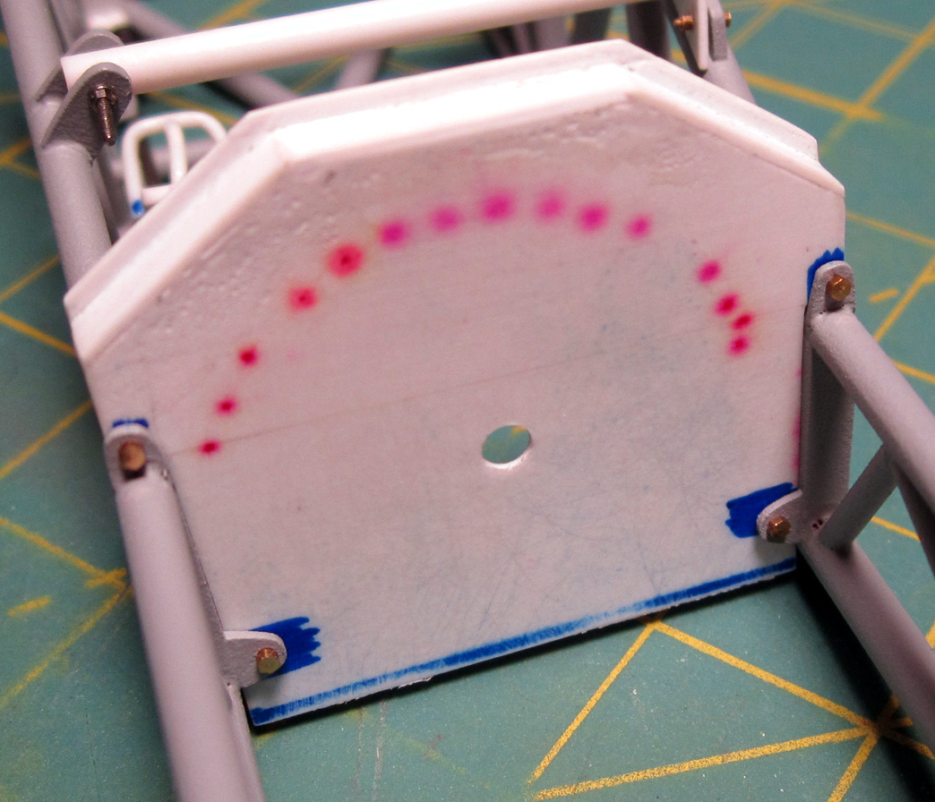

Mooneyzs Posted May 4, 2012 Author Share Posted May 4, 2012 (edited) Richard.... sorry to make you wait so long but got some pics to show ya Joe.... Thanks Joe.... you are right sometimes a break to clear your head gives you new fuel in the tank to get past something that you couldn't see at first. There has been quite a bit of planning with this build figuring out what I am gonna do as well as what colors will be used. Well guys I have a few quick shots to show you before I go sit down at the bench and get more done on this. These pics were from last night that I didn't get to post until now. will let the pics do the talking now. I started out by drilling and tapping holes in the block to attach the heads and the manifold. I am using 00-90 size bolts. It's a great way to mock things up since I seem to put it together and take it apart quite a bit at this point. I was getting tired of taping it and taking off, taping it together again, taking the tape back off : I then got the holes transfer drilled in to the mid plate and placed bolts in to do a fit check. But before i did that I had to drill out the holes in the tabs and let me tell you it wasn't fun trying to drill them with just the drill bit and being so close to the frame rails. It must of took me at least an hour or more just messing with these holes : After that it was time to make my little engine jig to hold the engine at the height that I want it to sit in the chassis. This will help me drill the holes in the mid plate as well as get it lined up with the block and the bell housing: Here is a couple of shots of the engine sitting on the Jig: Here I have set the mid-plate in place with the hardware. Then I stuck the jig in between the frame rails, set the engine down on it. I realized that I needed to open the hole up on the center of the mid plate to allow the tubing that I am using to line up the block, bell housing and lenco tranny. I made it free floating so that I could get the holes drilled in the proper place. This was one of those things I kept thinking about and for a little while I wasn't sure how I was gonna do it and it sorta just click with me this week and I was like that is how I should do it. The light bulb went off in my head . I was like its about time hahaha : Well I am off to the bench to go transfer drill these holes and do some other work to the engine. I should have some more pics a little later for everyone. Edited June 16, 2020 by Mooneyzs Quote Link to comment Share on other sites More sharing options...

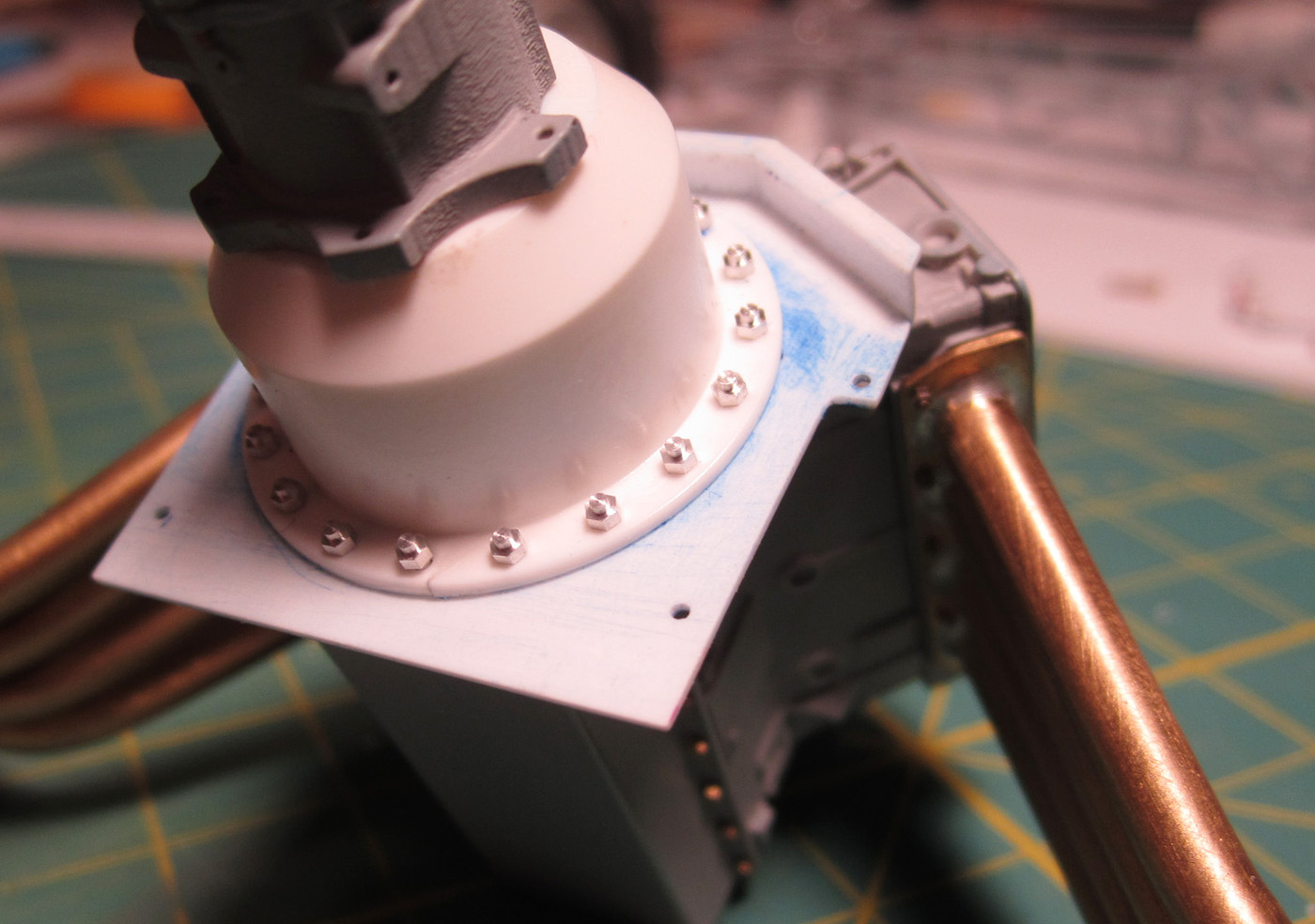

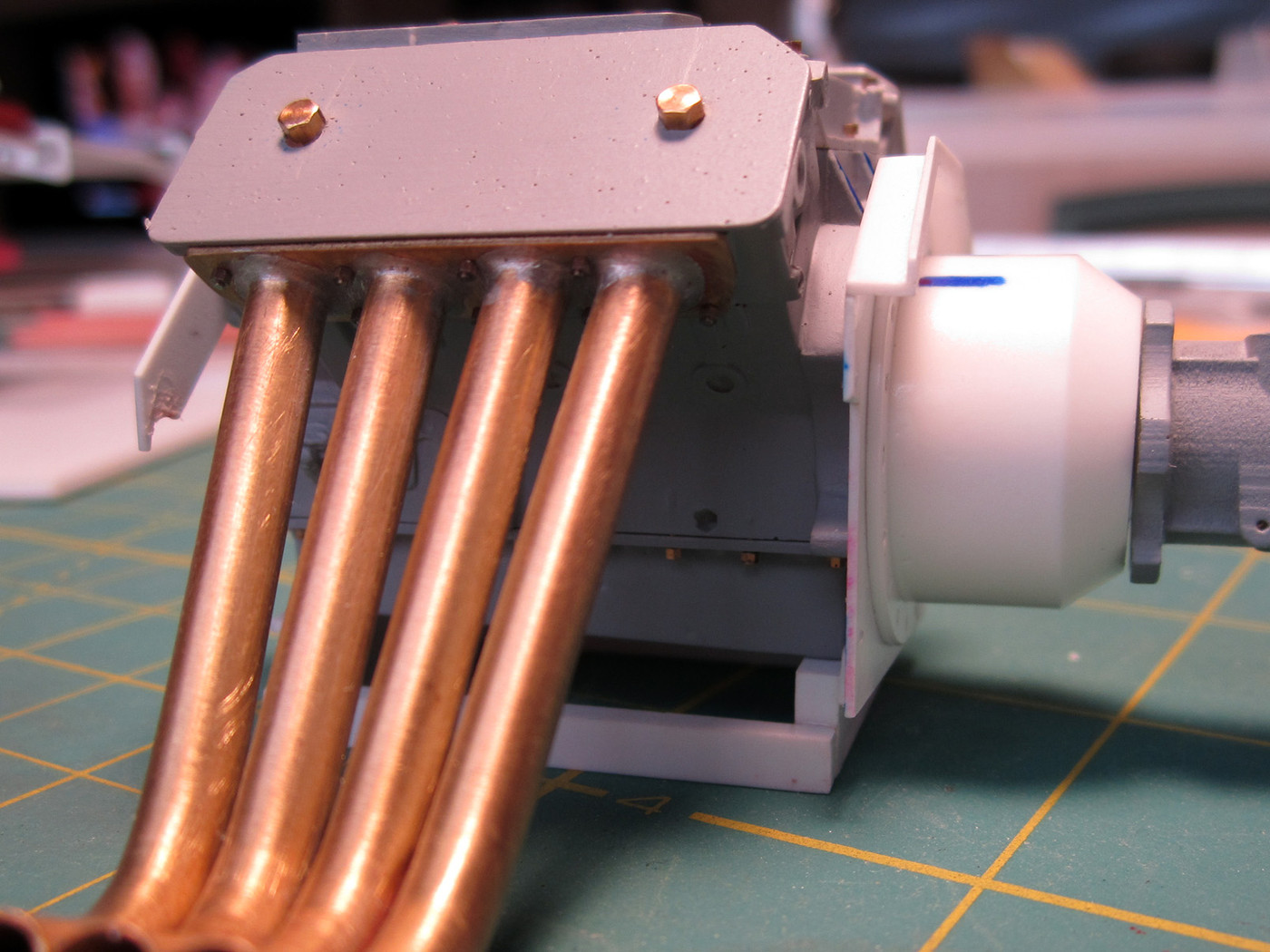

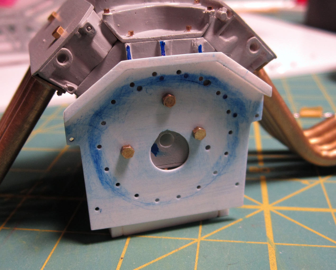

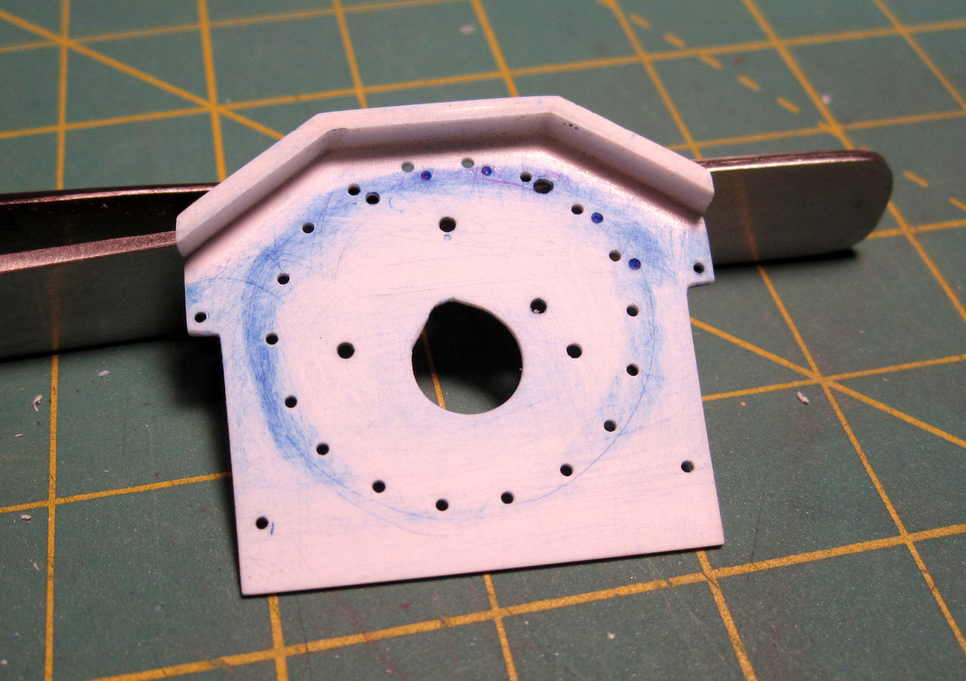

Mooneyzs Posted May 4, 2012 Author Share Posted May 4, 2012 (edited) Well Guys I was able to get some more bench time in and got the rest of Bell housing done with the bolts and drilling holes. now my next step is to move back to the front motor mounts and redo those now. Here are a few more pics..... Here is the Mid-Plate after I transfer drilled the hole in them. Don't mind that there are a few extra holes there, I sorta didn't start out in the right spot last night and the reason why I stopped there and fixed it tonight : After getting the holes drilled for the bell housing, It came to me I might as well bolt the plate up to the back of the block, so I added three 00-90 bolts to the back to mount it to the block: After that I ended up cutting a couple of pockets in the bell housing which you don't see that would clear the bolt heads. Then it was time to put the Nut & Stud in place to test fit it:. I am very pleased with the results: Edited June 16, 2020 by Mooneyzs Quote Link to comment Share on other sites More sharing options...

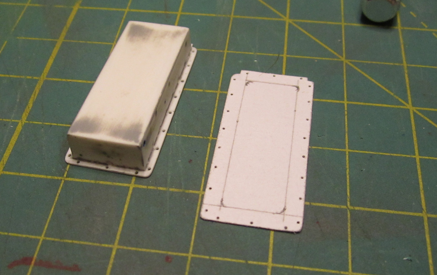

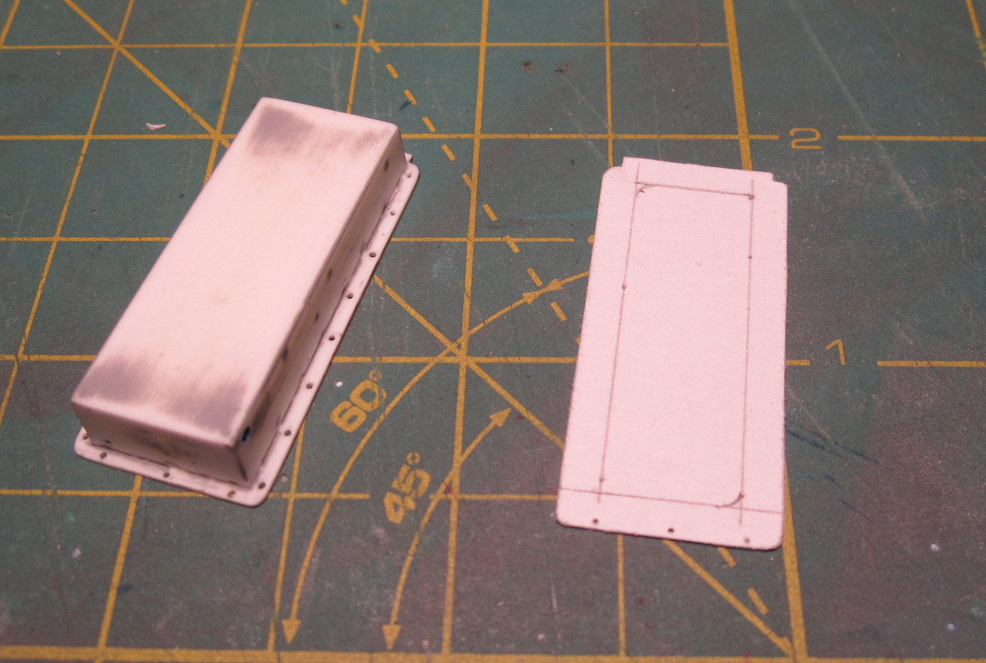

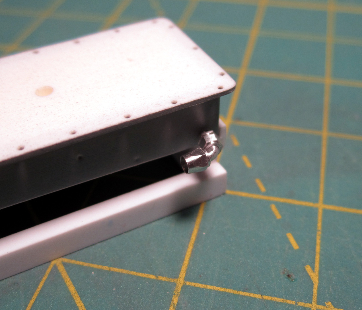

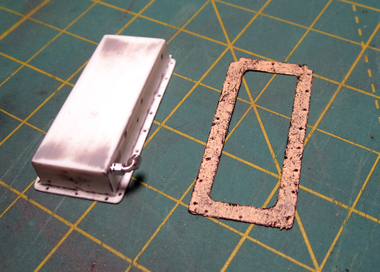

Mooneyzs Posted May 10, 2012 Author Share Posted May 10, 2012 (edited) Hello All... Sorry I haven't posted much in the past week but I sat down at the bench last night and did a little work. Took pics but didn't have time to post last night. Made a little progress... not much but pretty cool what i worked on. Gonna get back on work on it more after posting these pics. I started out by drilling the oil pan for the RB Motion fitting, can't wait to get the fittings painted: I decided that I would start working on the oil pan gasket next. I started out with a 3x5 index card. I then laid the oil pan on it and traced the shape with a pencil. Then I took my xacto knife and cut it out: I then laid the oil pan back onto the gasket and took my pin vise and drilled the holes into the gasket: Next I cut the center section of the gasket out with my xacto: After that I decided to color it with a black Sharpie for a base before painting it a tan color: Once I painted the tan color on, I took flat black and did a little bit of a dry brush tap on it to try and create a cork looking pattern. I probably would of been better off if i would of misted flat black from a spray can from a distance to create this look, but happy with the outcome: I then had to set it on the oil pan to check it out: Edited June 16, 2020 by Mooneyzs Quote Link to comment Share on other sites More sharing options...
