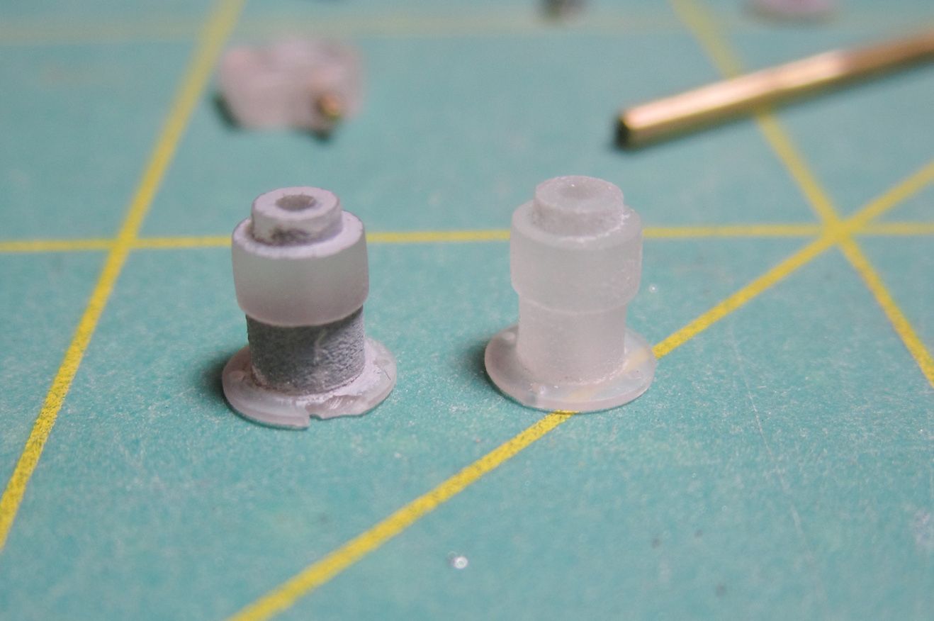

Well it started out where I busted one of my fuel pump bases from pulling a bolt out of it when I was transferring the holes to the engine block. I was glad I printed a few extra sets up:

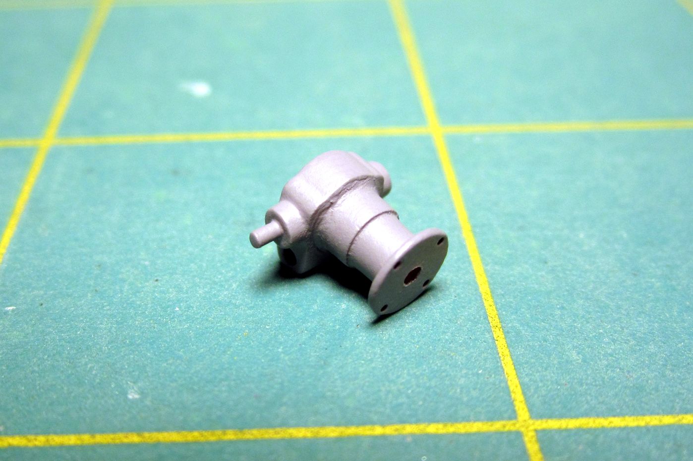

I then got the fuel pump glued together. I used superglue around the joint:

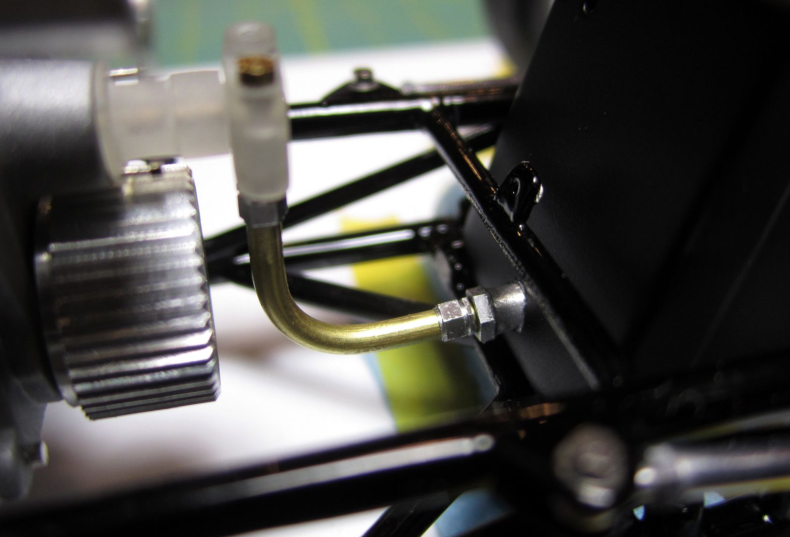

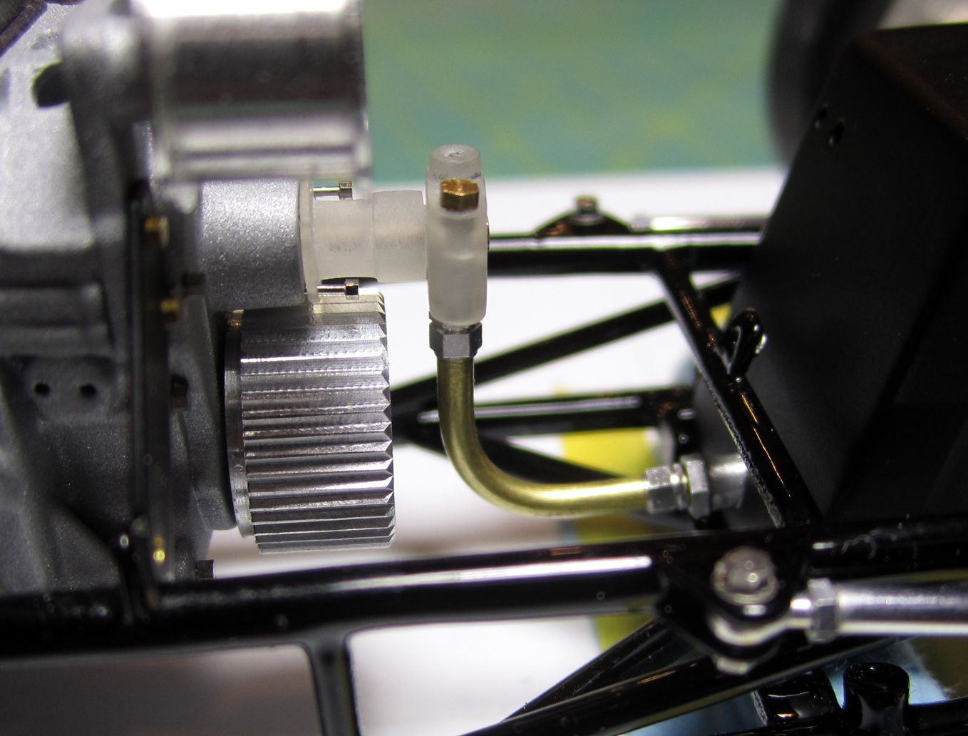

I decided to redo the fuel tank supply port as well as making the fuel line out of brass tubing which I will cover with heat shrink tubing when I am done with it. I felt that the first supply port I made was way too big and didn't look right. I used two RB motion fittings and had to drill them out to fit the tubing:
Link to comment

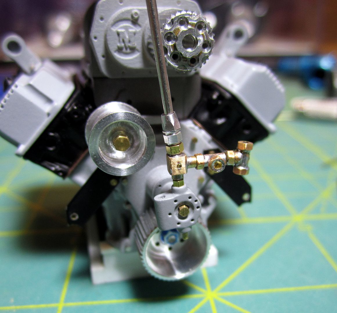

Here is the fuel line mocked up in the chassis, I apologize that the focus is off a little was hard getting the shot I wanted:

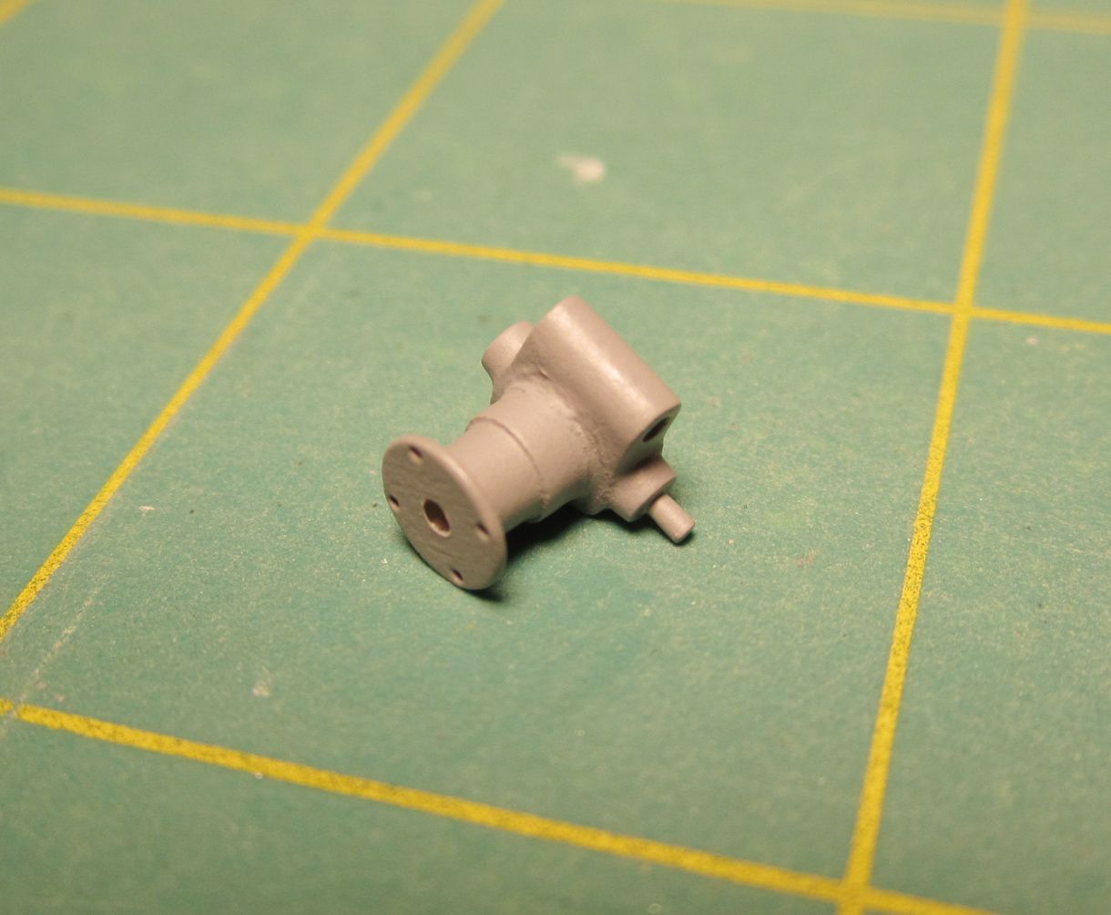

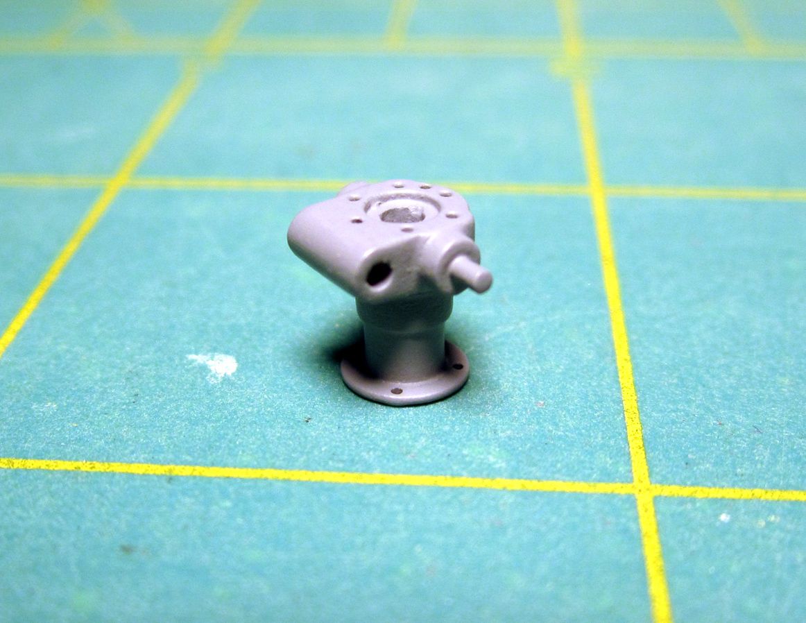

Here is a few shots of the fuel pump in primer. You will notice that I need to sand the joint smooth where I had glued it, once sanded you will never know it was two pieces...lol:

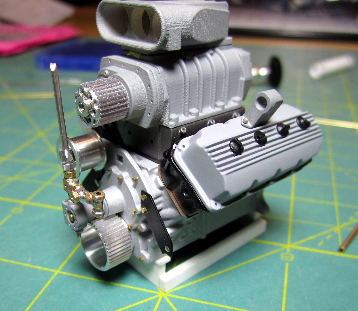

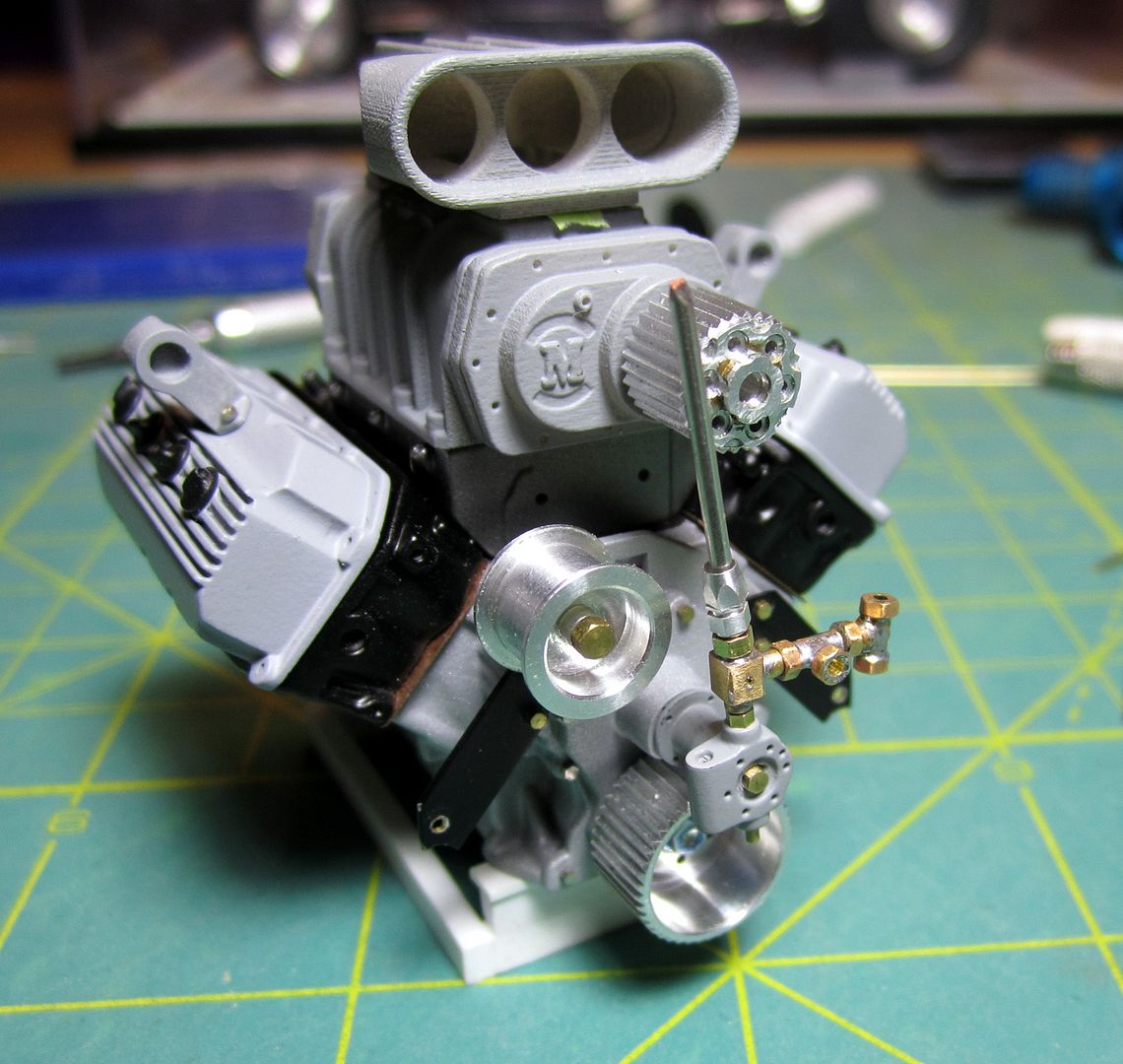

Well fellas... I got some time at the bench yesterday and think I make a pretty good accomplishment with what I worked on and happy with it so far. Hoping to get some more time today at the bench but I need to get some stuff done for work before I can play with the model today....lol. I worked more on the fuel system yesterday. I need to give a big shout out and thank you to Dave (Comp1839). He has been a big help to me though out this entire build with information on many of the little details I have been adding to this build. Dave spent an hour with me on the phone yesterday helping me with some dimensions and walking me thru some things with the fuel system. I am grateful for his help and this build wouldn't be were it is without his knowledge. Again, Thank you Dave.

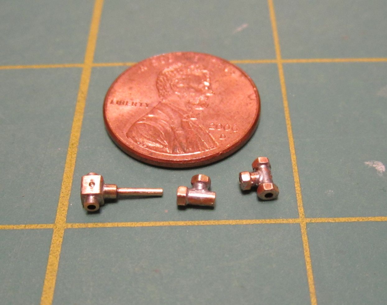

So I was working on the fuel shut off valve and the tee fittings that are attached to it. I spend about 7-1/2 to 8 hours yesterday fiddling with these 3 parts. It always tends to take longer than I think it will with some of these parts. it took a little while to figure out what I was going to do and how I wanted to make them. Not to mention that I redid some of them a few times because I messed up on cutting the correct lengths. Anyways here are some pics to share.
Here is the start of the shut off valve and tee fittings. I decided to make them out of brass and solder them all up.:

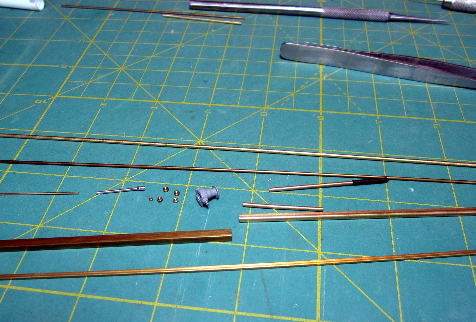

Here is some of the pieces after getting the brass stock cut to size:

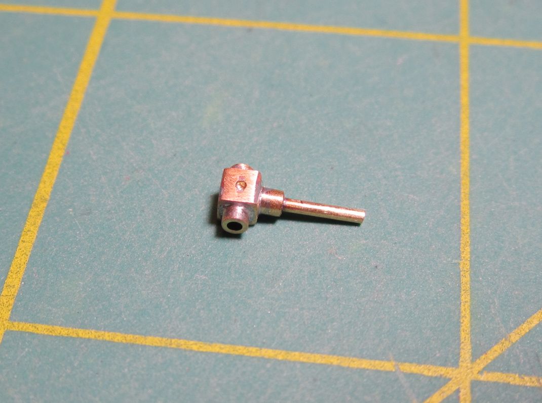

This is the Fuel Shut Off Valve, It is made up of 4 pieces that were all soldered together, There is still some more work that needs to be done. I need to make the lever that attaches to the body:

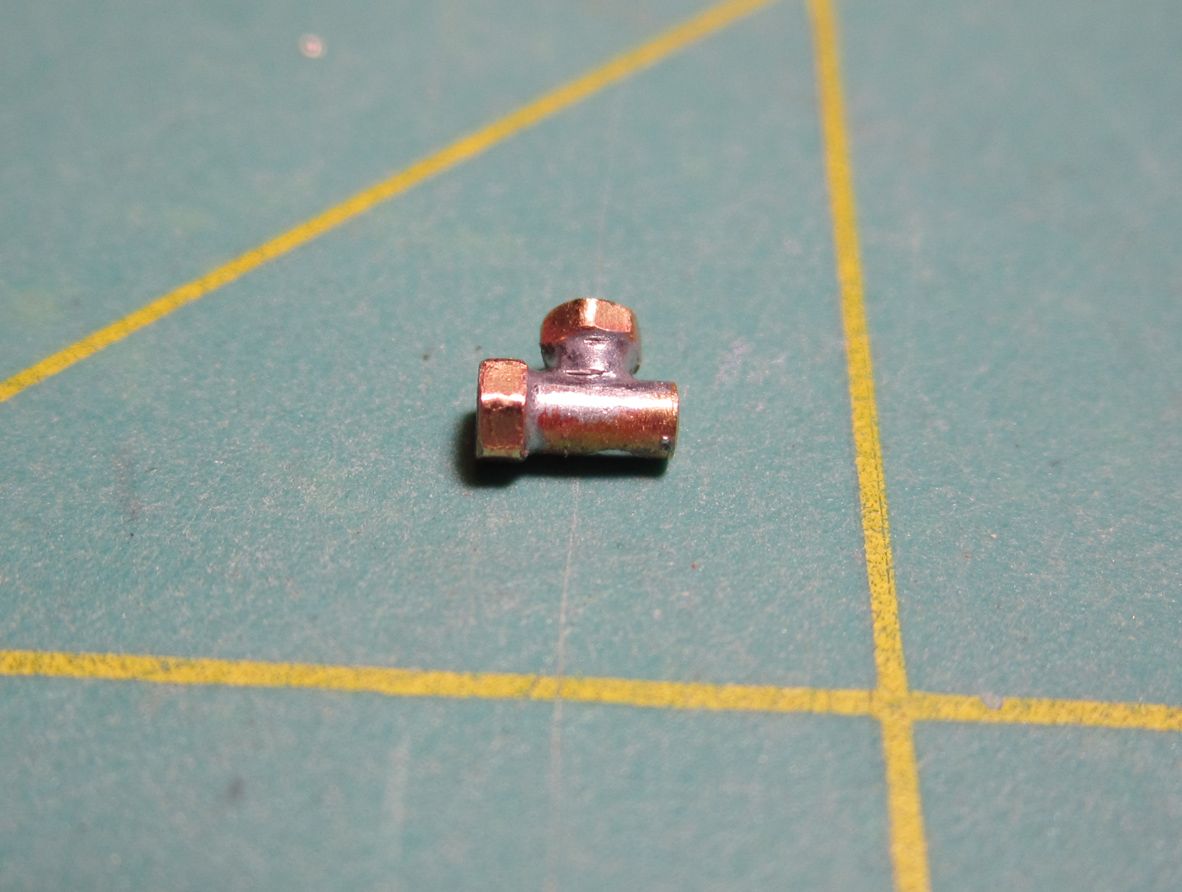

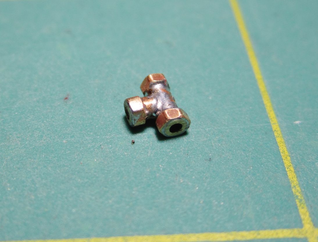

Here is Tee Fitting #1. this one is also made up of 5 pieces. the two hex fittings are scale hardware hex nuts that I drilled out and soldered to the assembly:
Here is Tee Fitting #2, This is made up of 6 pieces, and I did the same thing with the same scale hardware hex nuts:
Link to comment
Here are all of the pieces next to a penny so you can get a feel of the size of them:

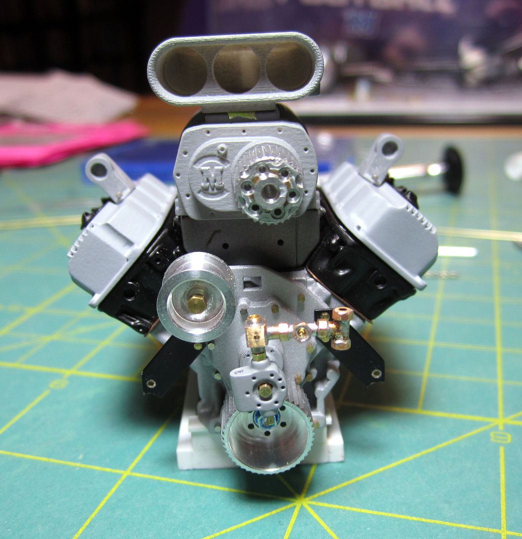

Now for a few shots of the parts mocked up on the engine. Today I am hoping to get these guys cleaned up, sanded and primed so they will be ready for some paint:
