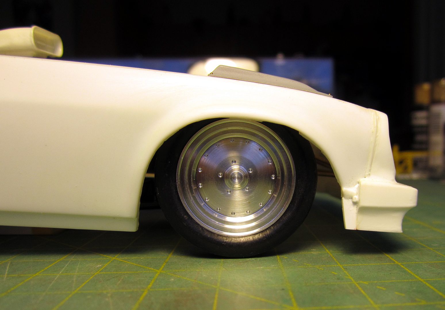

ok Fellas.... Been working on this today and had a few little set backs, not really a set back but I found another issue with the Body tins that I was working with. I had noticed that once I put the tins in place and bolted it in that I was having an issue with the body sitting correct on the chassis. I believe that the cause was from the fix I did when I broke the tin and how I re-glued it. I found that the portion of the tin that sat on the mid plate was the spot I could fix this problem. I had to sand it down to get things to fit right and after sanding it down I think I may have to redo the holes in that spot of the tins for the rivets. Anyway I will be showing you a whole bunch of pics of this from what the body sitting on the chassis before fixing and what it looks like after fixing. I apologize in advance for the bunch of pics I will be showing you.
Here is the start of what the body looked like sitting on the chassis with the tin installed:
Here is the front wheel well and rim, prior to the tin work fix the wheel well sat down to the rim. You can see that there is some distance between the wheel well and the top of the rim... maybe 1/16" or more??:

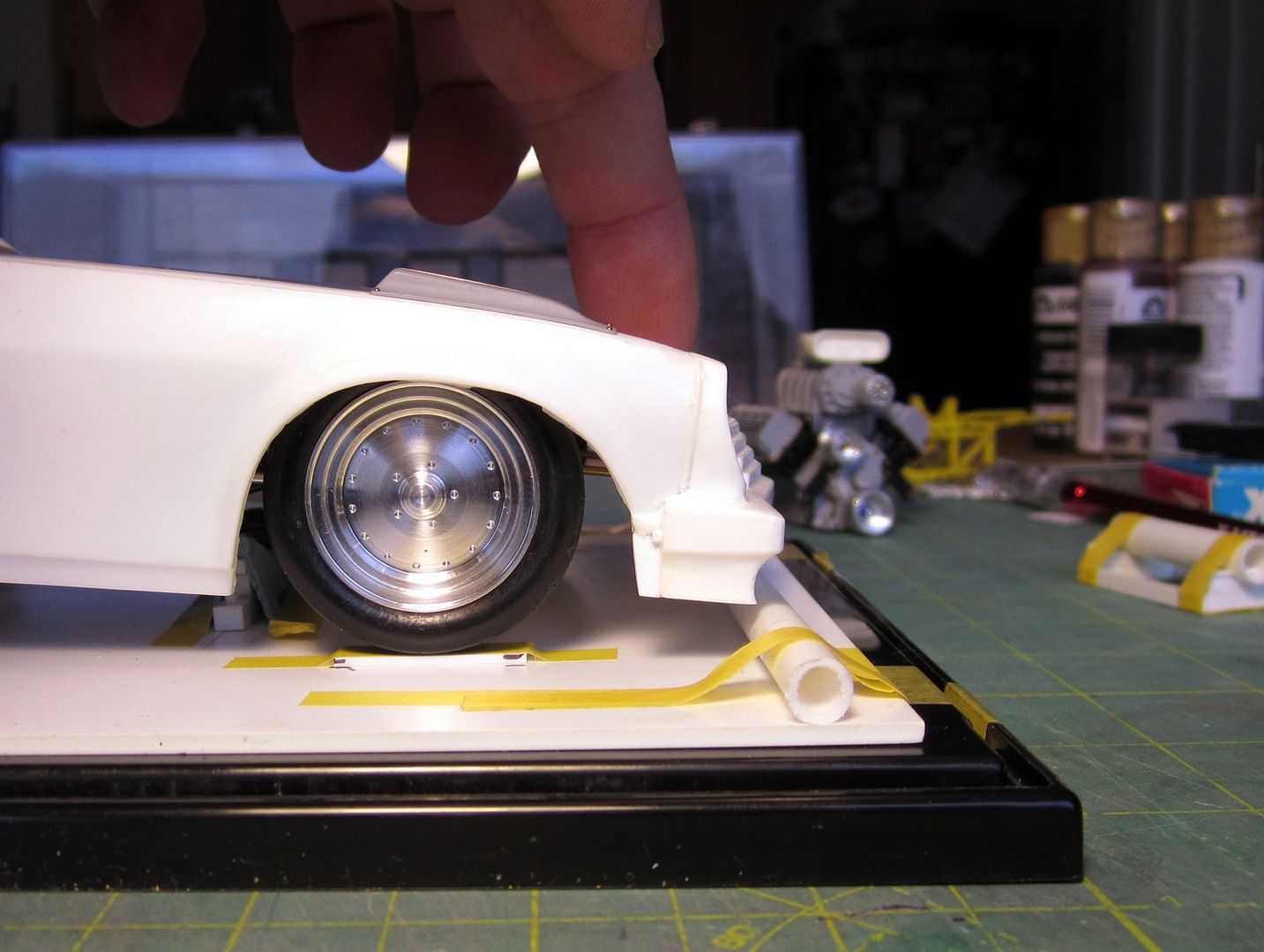

Here I applied pressure with my finger to get the body to sit down on the front body mounts and the body was pivoting on the mid plate of the engine:
Here is the view of the opposite side, same scenario with no pressure there was a major difference with the distance from the wheel well to the top of the rim:
Again I pressed the body down to sit it to the body mounts and the gap looks right now:

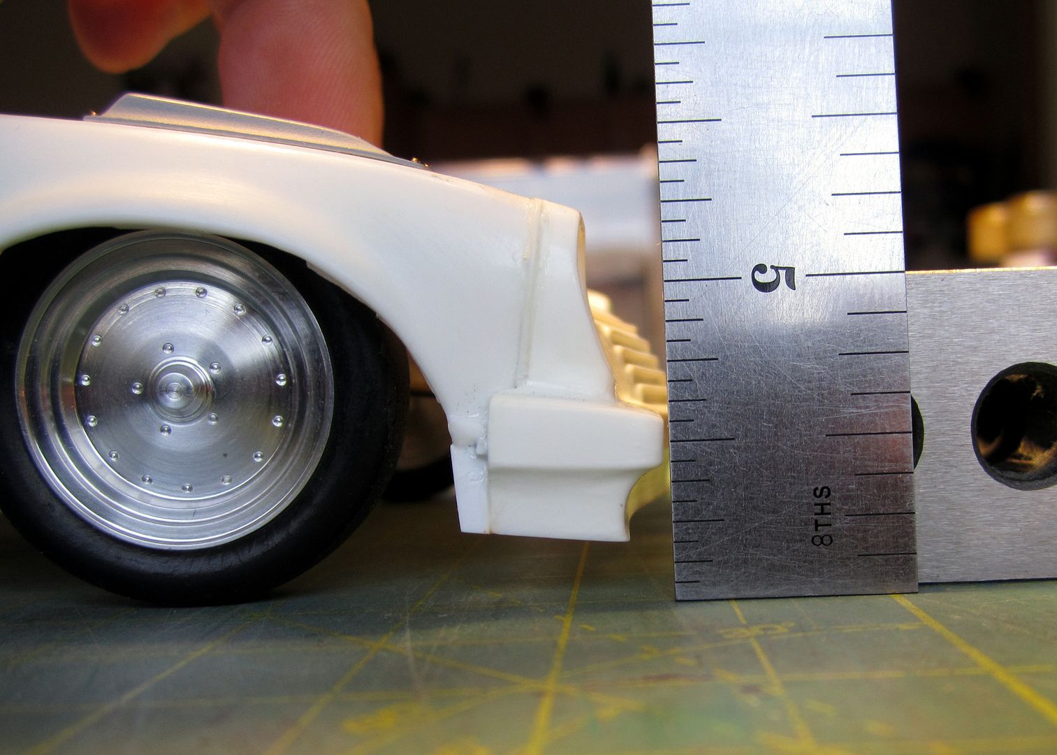

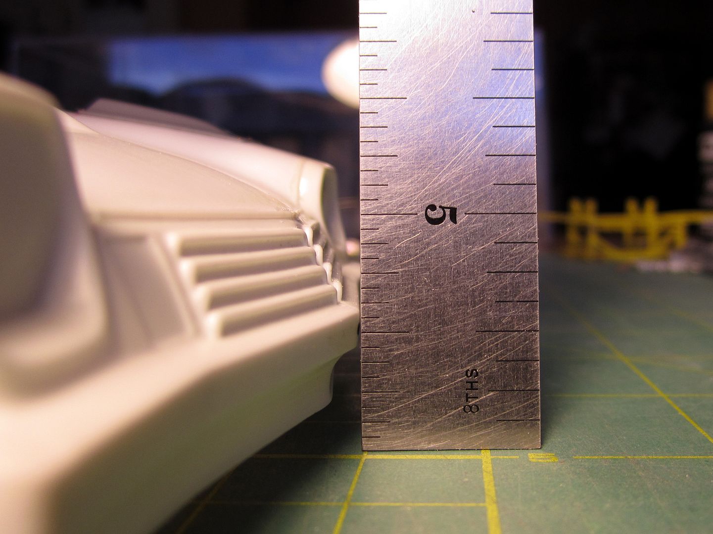

Here is some measurements I took to show that it was off:
Here it is again with pressure that I applied and where it should sit:

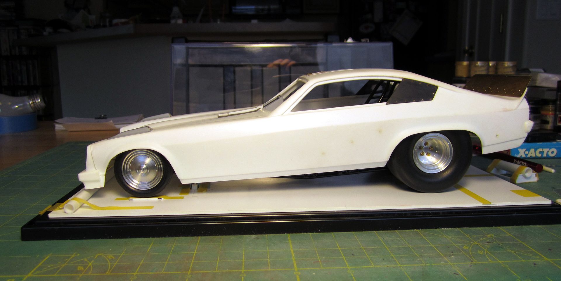

SO this is after I took the time to sand and fit check for a while until I got it to sit correct. I sanded the tin work in place so that I got it correct and am happy with the fix:
Here is a new shot of the body sitting on the chassis without me pressing down on the body:

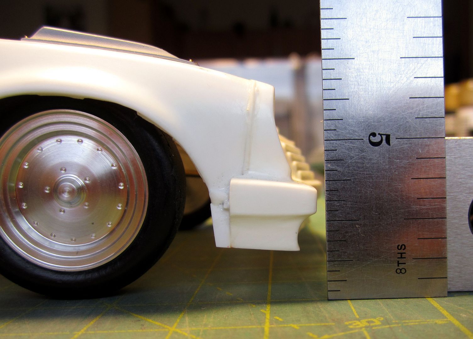

Another measurement showing that the front of the body was sitting a 3/16" off the ground which is equivalent to 3" in 1:1:

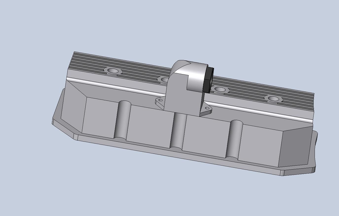

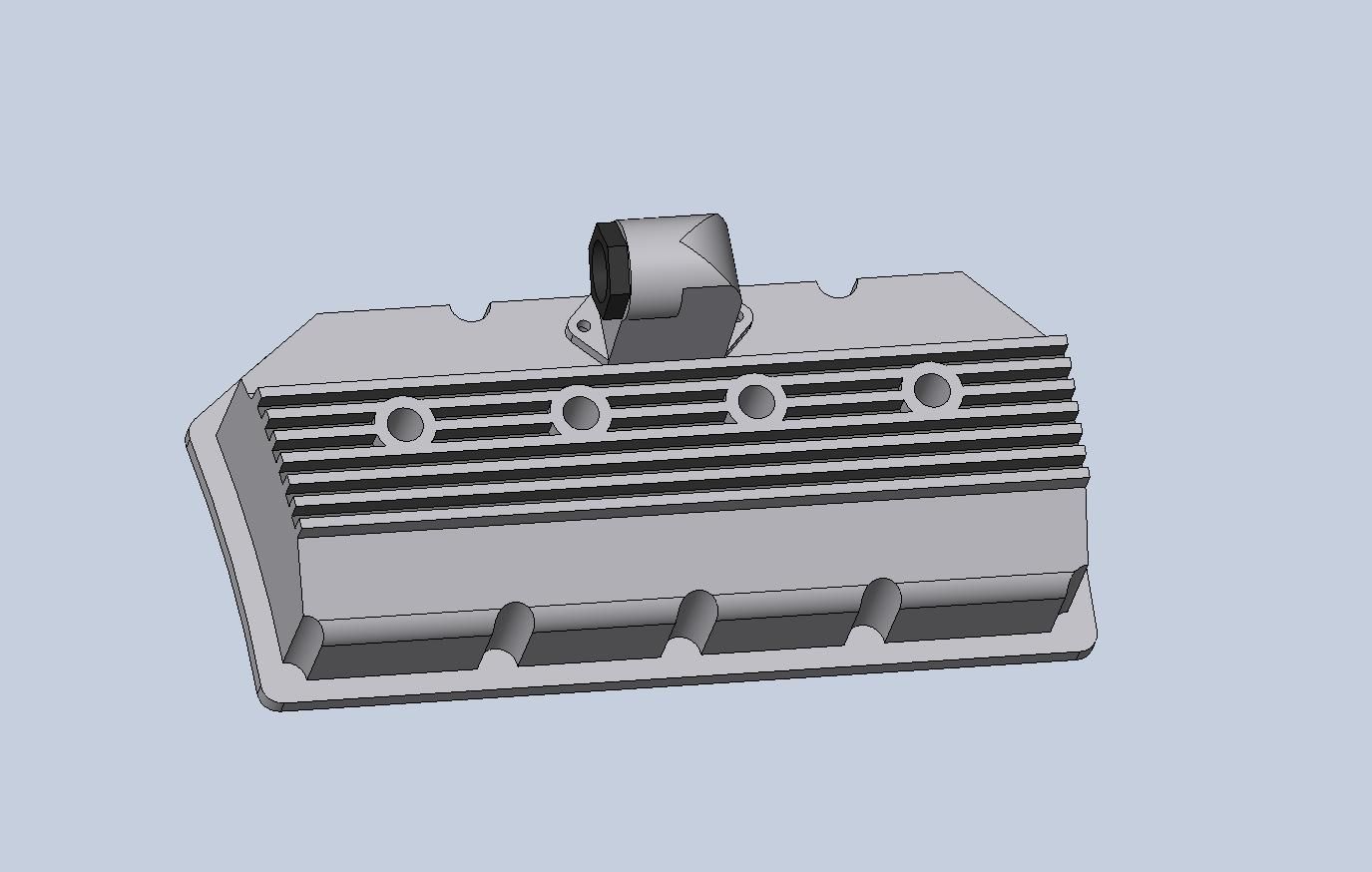

I took a couple of hours to model the valve cover and valve cover breather in Solidworks. Now I didn't model the valve cover 100%. I took the Mark Johnson Resin valve covers and measured it and reversed engineered the valve cover. I need to be able to get the size correct. So I could design the valve cover breather to fit the valve cover right. I will be scratch building the valve cover breather and wanted to figure out the design first before I started it. I will print of the views and use the drawing for the templates to make these:
Here is another view of the breather/blow off plate:

Sits down real nice there Chris. nice work on the Solidworks dwg. I am learning how to use Solidworks on my own right now. Its a pretty friendly program so far.

Dave... Thank you very much. Glad to hear Solidworks is going good. It's a pretty easy to learn.

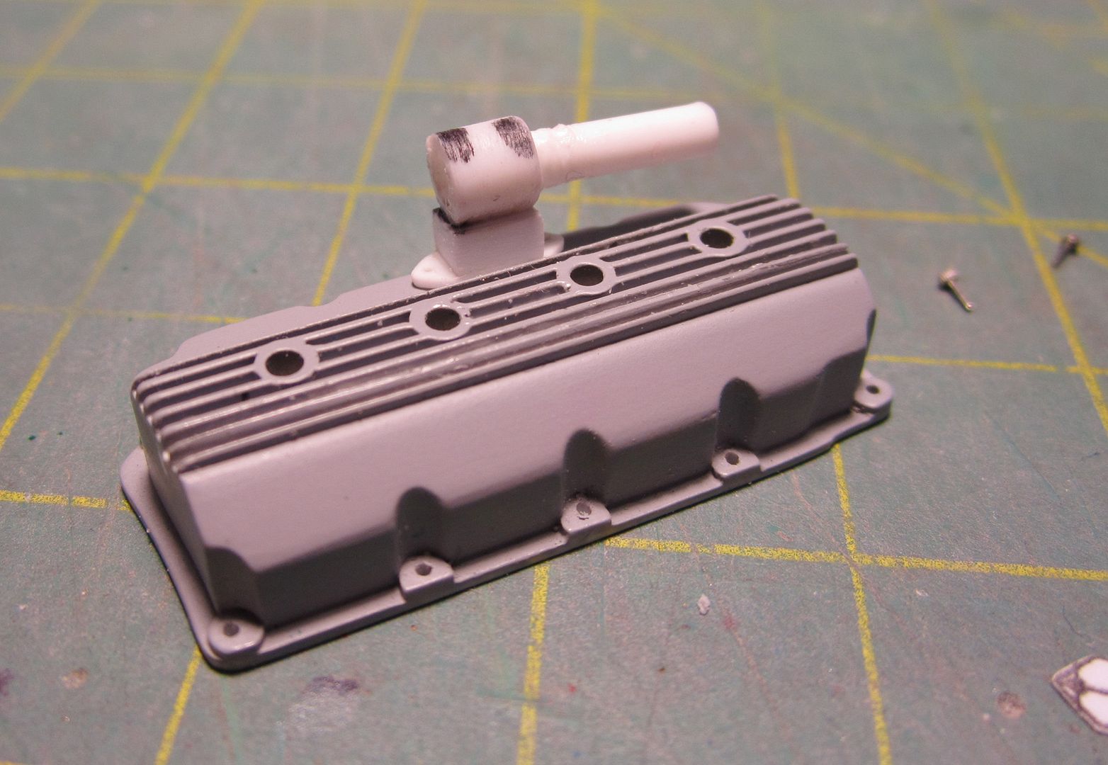

Well Fellas.... I am glad to say that I have gotten a little bench time tonight so far. Hoping to get some more but wanted to show you the progress on the Breathers for the valve covers so far. I sorta got to a stopping point on them because I need to let the glue dry for a bit. I sorta loaded a few areas up with Weld-On #3 (same basic stuff as Tennax or Pro-Ambroid, I just buy it in quart size containers) and its little soft in a few areas that I need to cut and shape.
Here is the start of the breathers with the raw materials. As you can see I cut out templates that drew up in solidworks to scale, cut it out and used a glue stick to glue to the evergreen styrene for my templates:
Here are all of the individual parts that I have cut and ready to glue together:
Here I have glued all of the pieces together. I left the length of the one rod long on purpose and that will be getting trimmed down and shaped:
I just set the breather on the valve cover to get an idea on how it will look:
I am still actually debating if I want to send the CAD files for these to Shapeways and have them 3D printed guess I am curious how they would turn out if printed.

Glenn...thank you so much. It feels great to be back to the bench. I should be getting a lot more time on it. No the tube will be rounded on the back like the pics I posted on the previous page.this is still in a little rough state. I am still waiting on some parts from RB motion to get here and I want to get these shaped so I can get some primer on them :)
