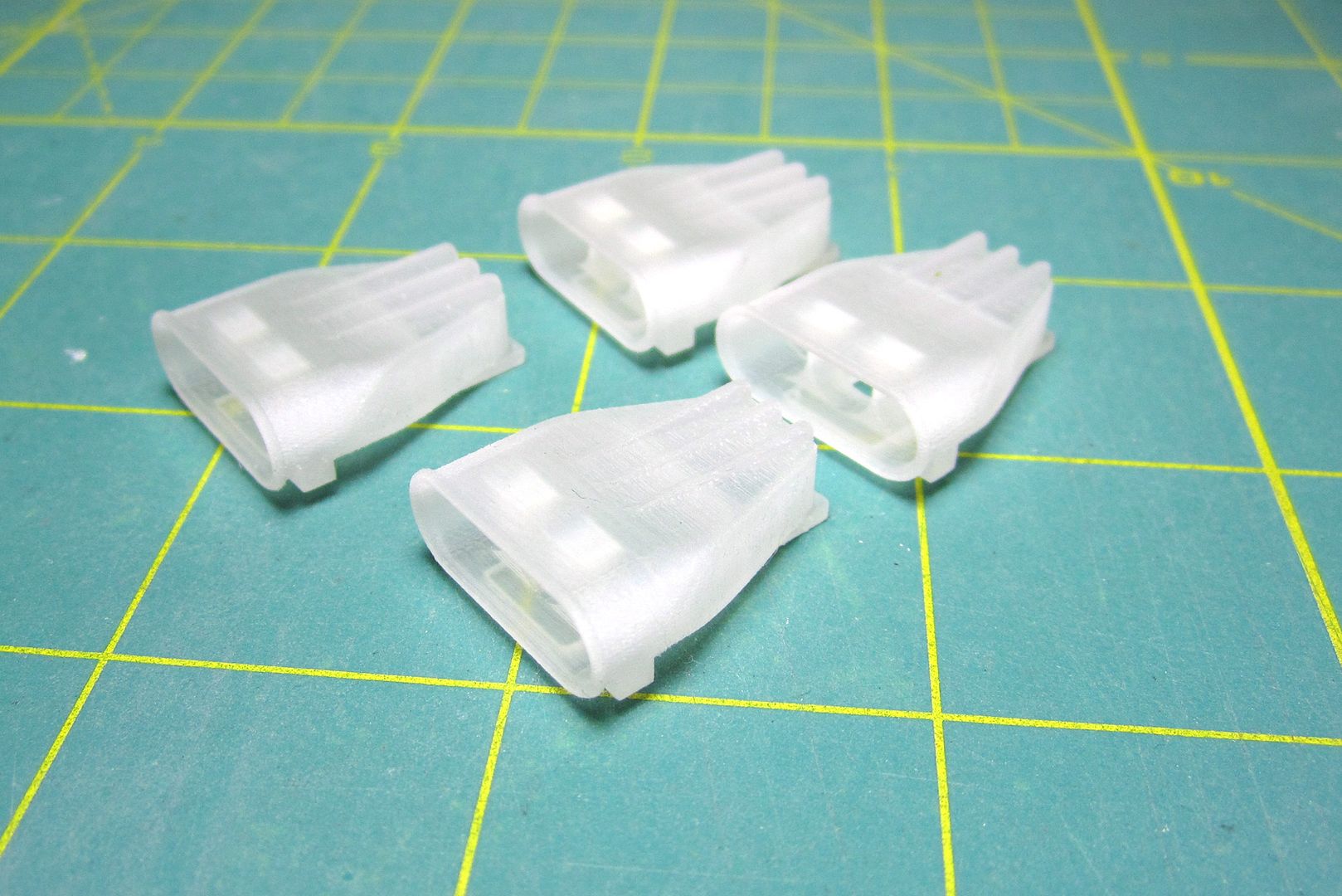

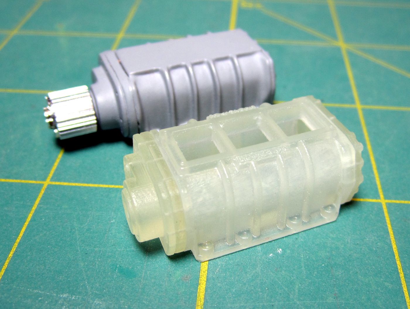

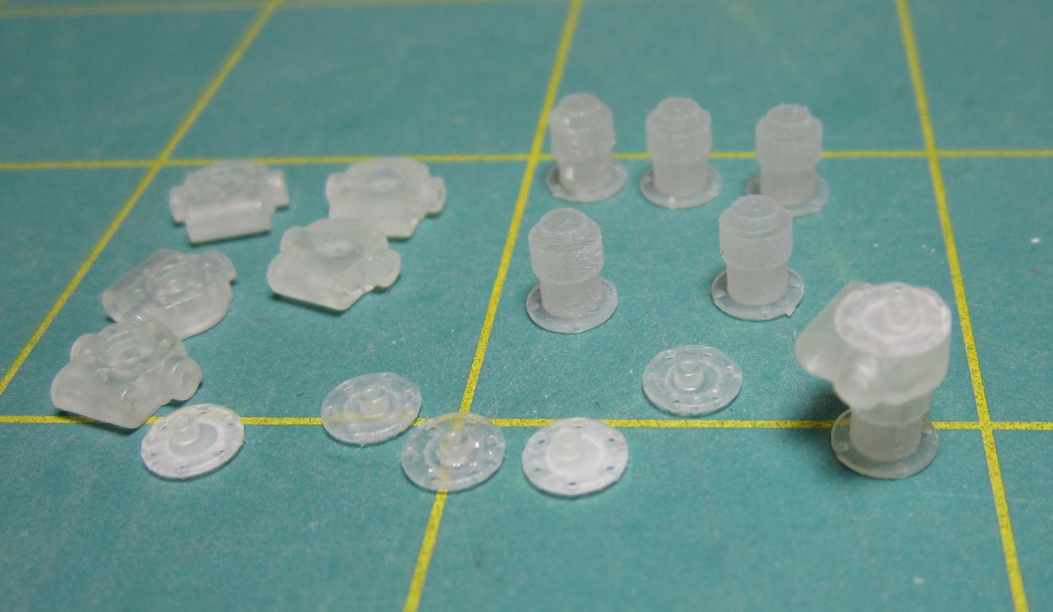

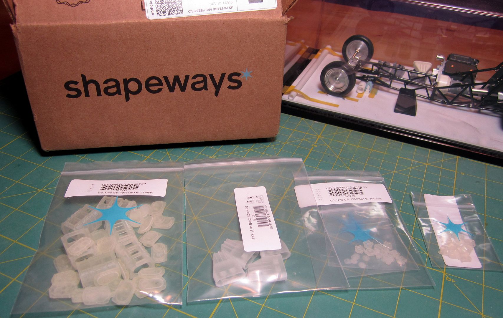

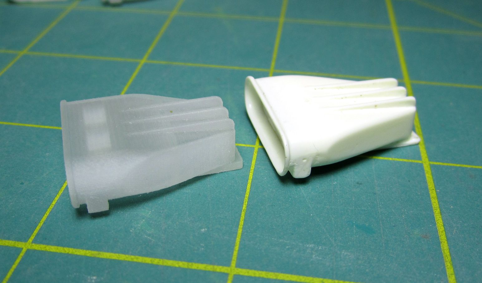

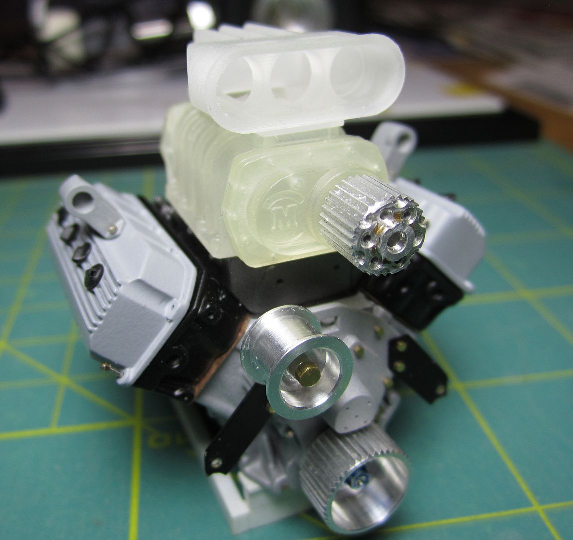

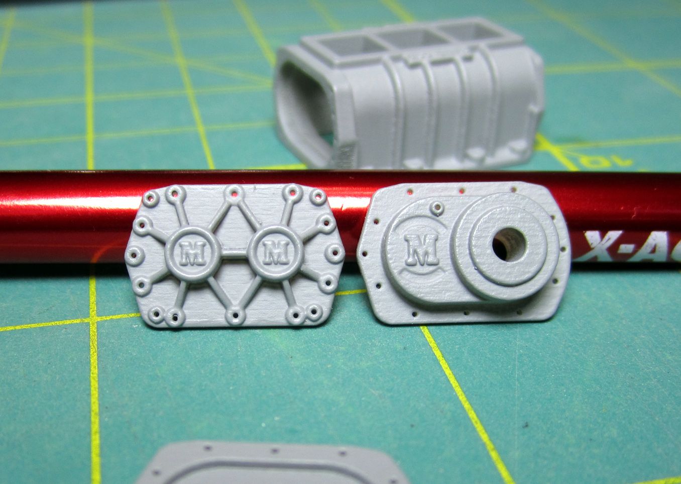

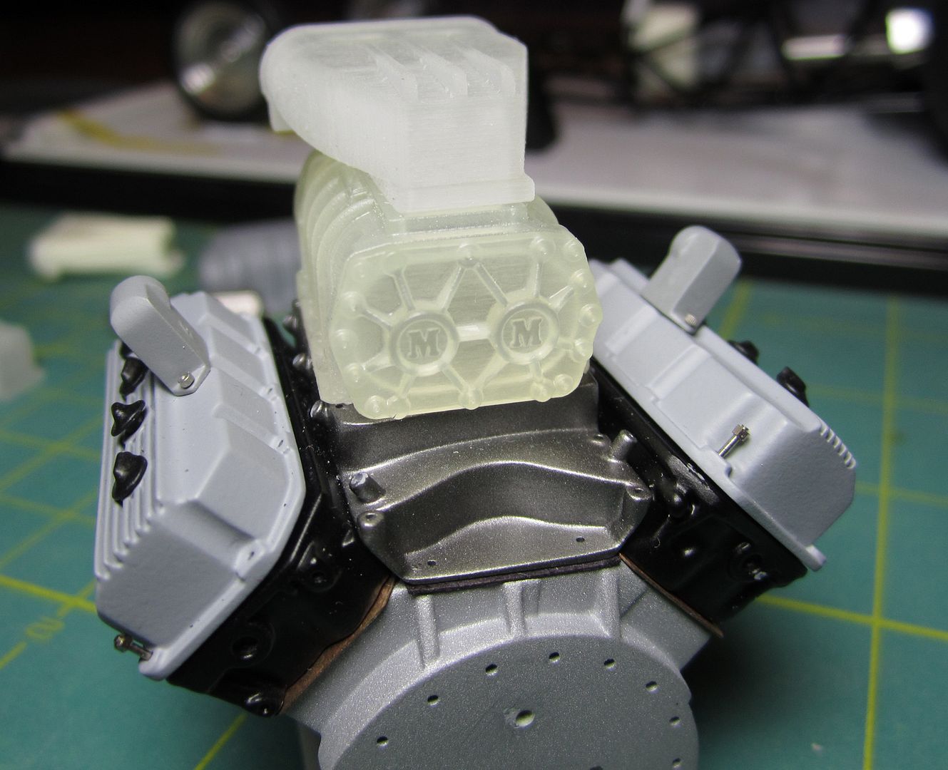

Mooneyzs Posted November 7, 2014 Author Share Posted November 7, 2014 Well Fellas... Tonight when I got home I had a surprise waiting for me that I had no idea that it showed up..... Anyway will Let the pics to the talking.... Yep.... You guessed it my order from Shapeways arrived a week early and I was surprised to get it so soon: Here are the blowers, I ordered a few extra because It ended up being cheaper in the long run but you will see here that I have two different styles of the front plates. One where I had added the lettering for the Mooneyham Blowers and one where I left the lettering out because the lettering was small and didn't know if it would print correct and well it didn't. So I will be most likely to use the one with out and having a decal made for the other part: Here are the injector hats. Sorry about the color it was hard to get a good shot of them. I am pretty happy with how these turned out but I think I am going to have to go back and revise and have another couple reprinted. I sized most of my holes at .016" and well I think it was too small because a few of the holes didn't print. I figured I would make them smaller than I needed and I could drill them out. I will get them fixed. These are still usable but would of been nice if they holes would of shown on there, especially the one for the shaft for the butterflies: Here is a shot of the resin one next to the 3D printed one: Here is a shot of the 3D printed Blower next to the resin: Quote Link to comment Share on other sites More sharing options...

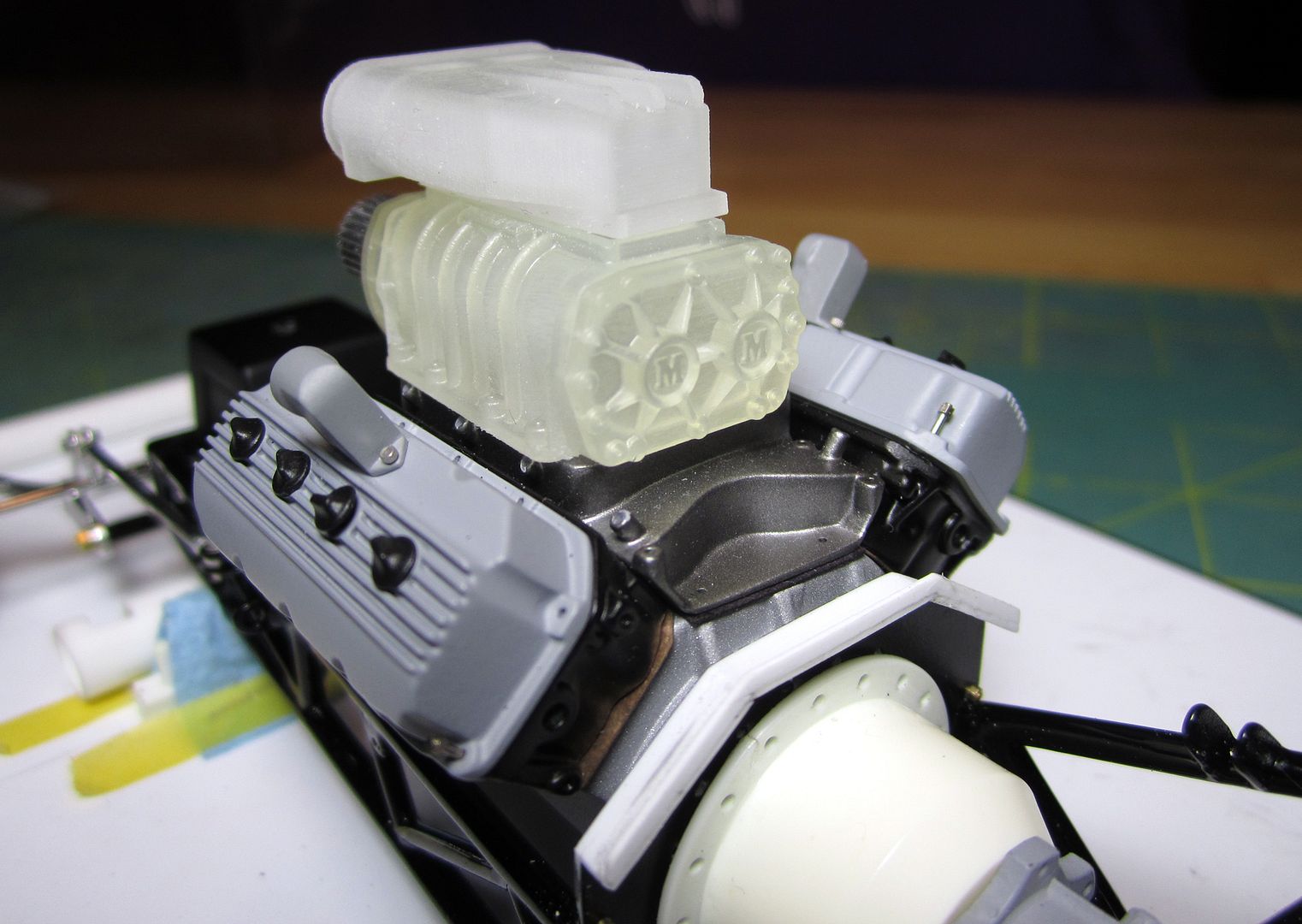

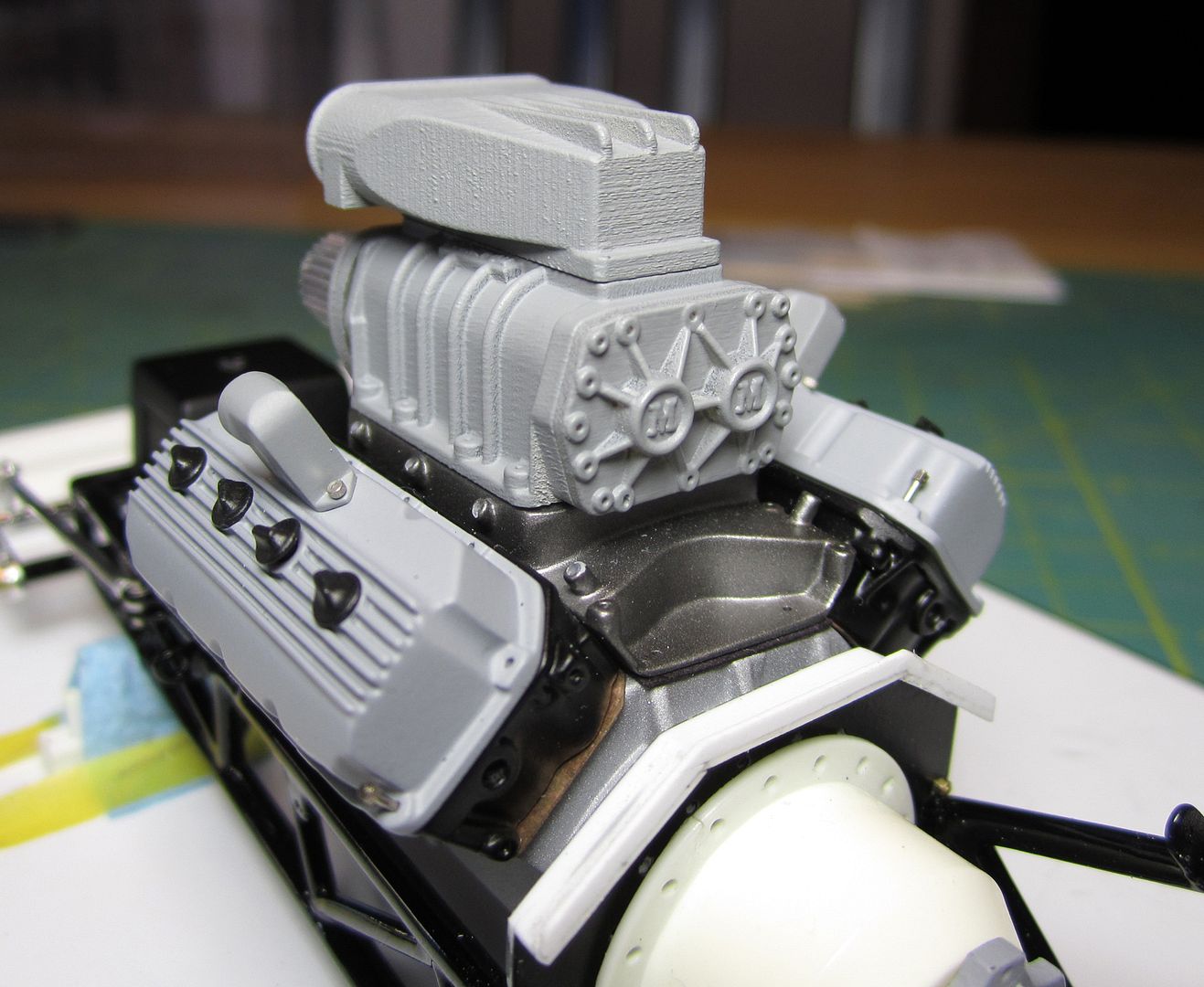

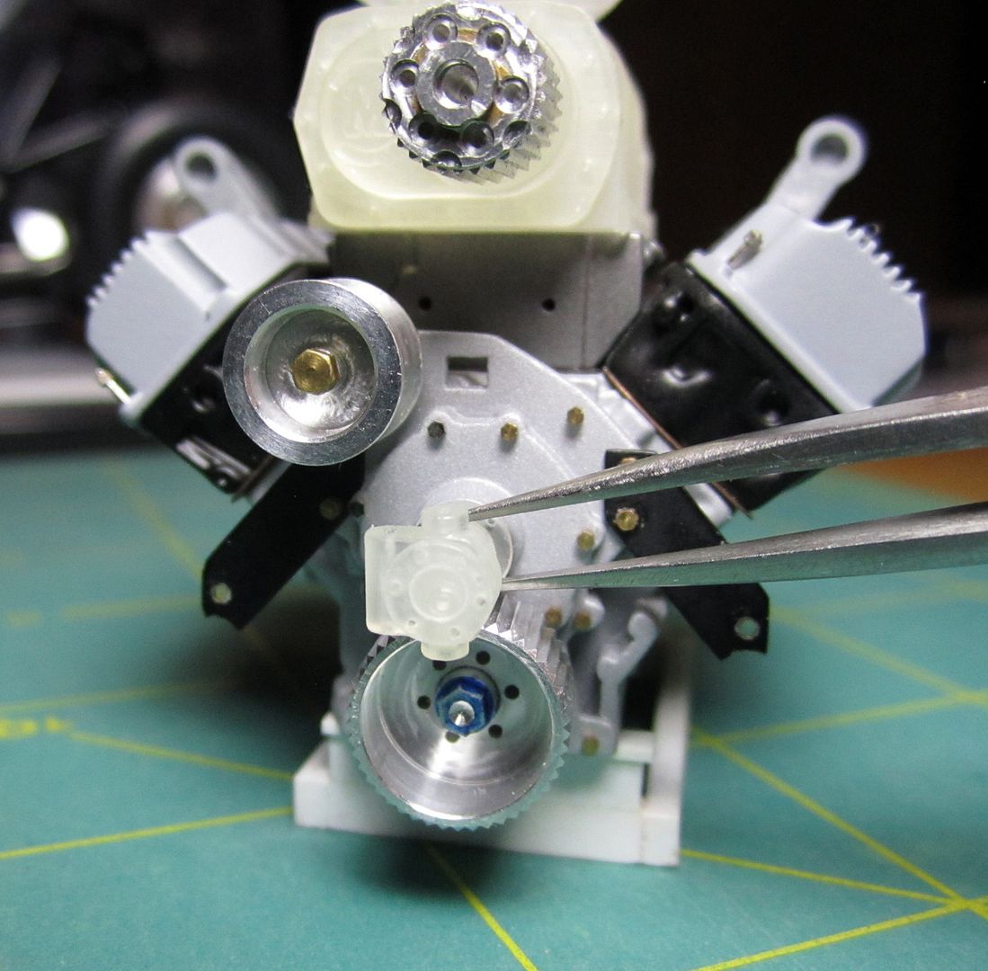

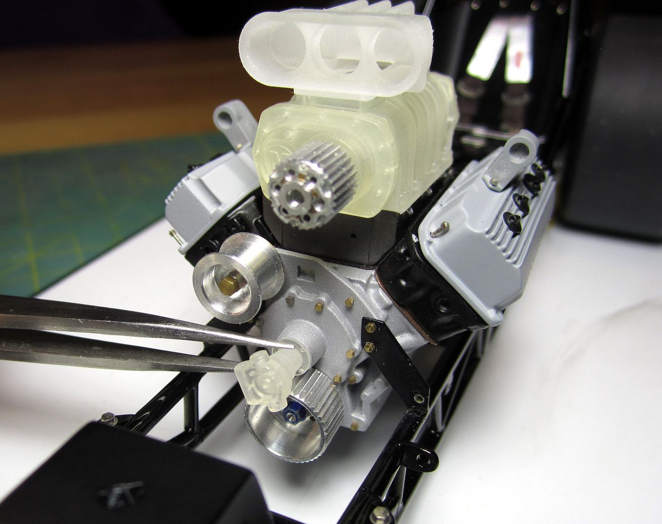

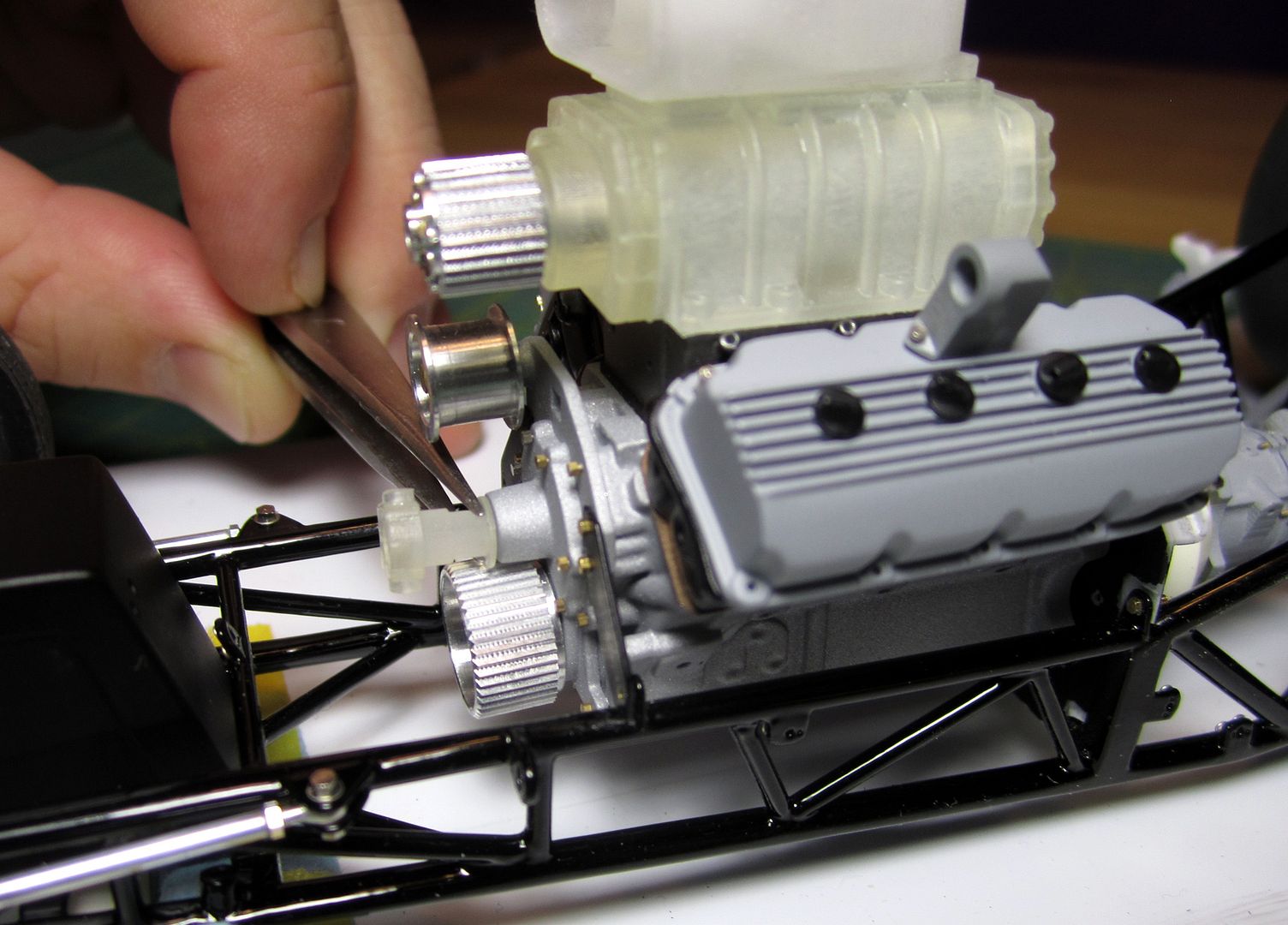

Mooneyzs Posted November 7, 2014 Author Share Posted November 7, 2014 Here are the 3 piece Hilborn fuel pumps: Here is the blower and injector hat placed on the engine to see how it looks: Back view and I love how the "M" turned out: Holding up the fuel pump to see how it looks against the engine: Here I placed the engine in the chassis to take a look at it: Quote Link to comment Share on other sites More sharing options...
Mooneyzs Posted November 7, 2014 Author Share Posted November 7, 2014 How the engine will look sitting in the car from the back: Here is a side view of the fuel pump checking clearances: another front view with the fuel pump in the chassis: I need to wash these parts up so I can get a quick coat of primer on them so you guys can see how they turned out with no prep at all. Then I can start prepping them by sanding and reprimering and then they will be ready for paint. I think I needed these parts to show up so it would give me some motivation to get back to this build. I have been struggling lately with getting anything done on it. I will get some pics up of the primered parts when I get a chance to work on them next. Quote Link to comment Share on other sites More sharing options...
John Teresi Posted November 7, 2014 Share Posted November 7, 2014 Chris.........all the extra effort you have researched and done........really paid off.........this build is totally insane........this model will be talked about for years when finished Quote Link to comment Share on other sites More sharing options...
futurattraction Posted November 7, 2014 Share Posted November 7, 2014 Those pieces look so cool Chris. Can't wait to see what they look like in primer. Quote Link to comment Share on other sites More sharing options...
Prostreet Posted November 7, 2014 Share Posted November 7, 2014 Nice work Chris, Those printed parts look very clean, can't wait to see them in primer. Quote Link to comment Share on other sites More sharing options...
Nitrozilla Posted November 7, 2014 Share Posted November 7, 2014 It's Christmas!!!!!!! Chris, those parts look terrific and I have a feeling that those Mooneyham emblems are gonna pop. I hope you don't mind me saying so because I know how much time you spent on the blower parts, but the new casing looks crisper even without primer. If I had a nickel for every part I had to do multiple times I would haz a multitude of nickels. Quote Link to comment Share on other sites More sharing options...
Codi Posted November 7, 2014 Share Posted November 7, 2014 Whoa Chris. I really like your new 3D pieces. Totally agree with you that the blower with the "M" truly stands out in it's detail. They all look nice that it even crossed my mind that you could show it with a spare blower and hat on a table next to the car (being worked upon maybe?) with 3D printed rotors too! Yeah, I'm nuts. Can't wait to see them in primer too. Cheers, Tim Quote Link to comment Share on other sites More sharing options...
Randy D Posted November 7, 2014 Share Posted November 7, 2014 Hi Chris, It has been awhile since I last checked up on your progress, very impressed with your efforts !!! The work you do in creating your 3d parts just blows me away. Look forward to more !!! Randy Quote Link to comment Share on other sites More sharing options...

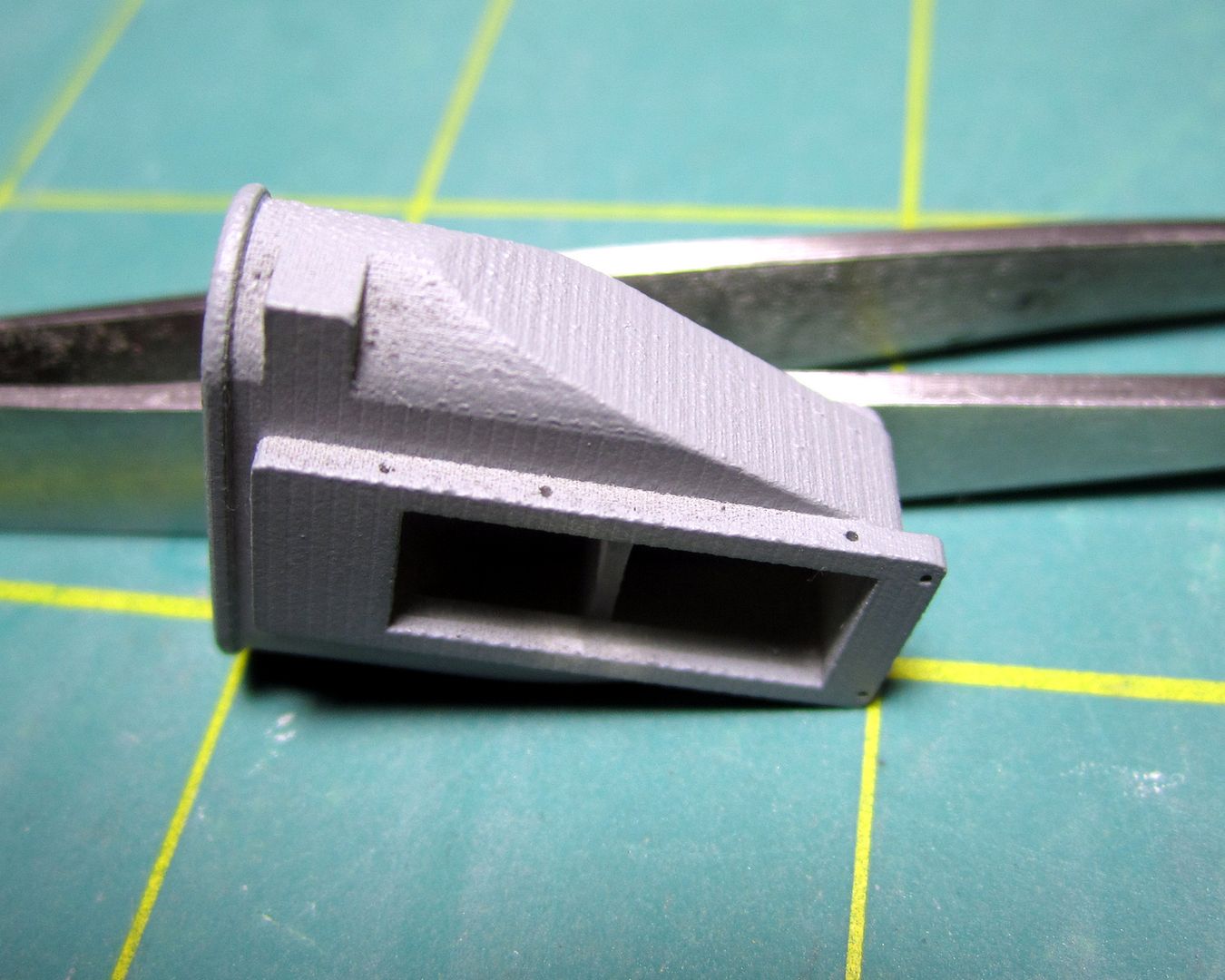

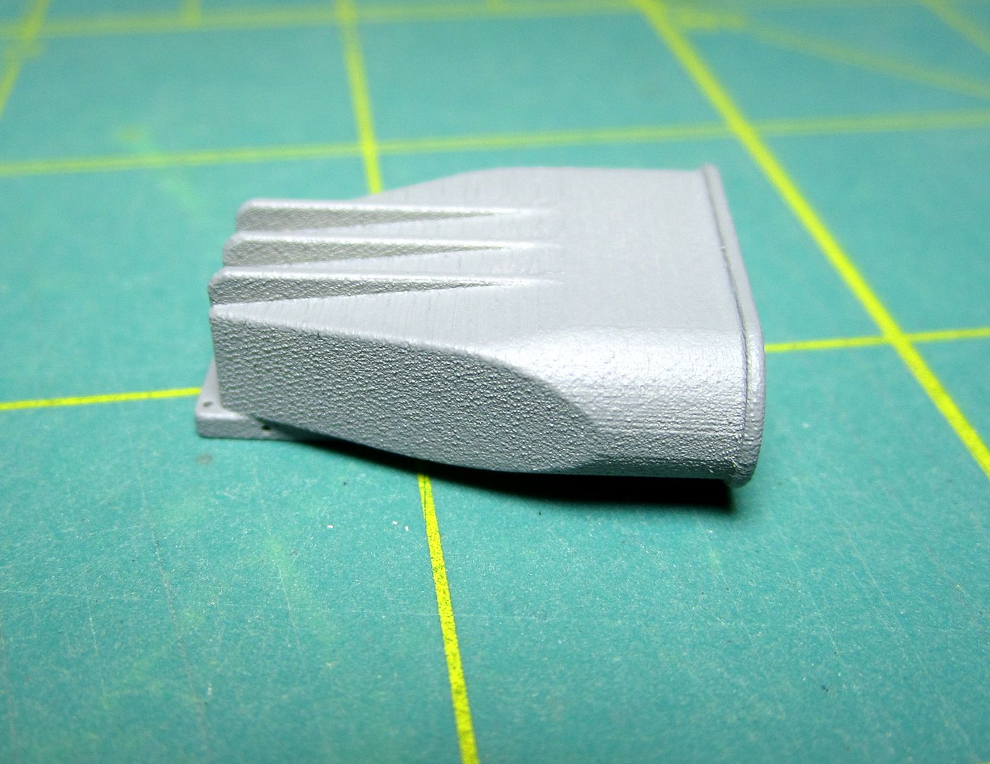

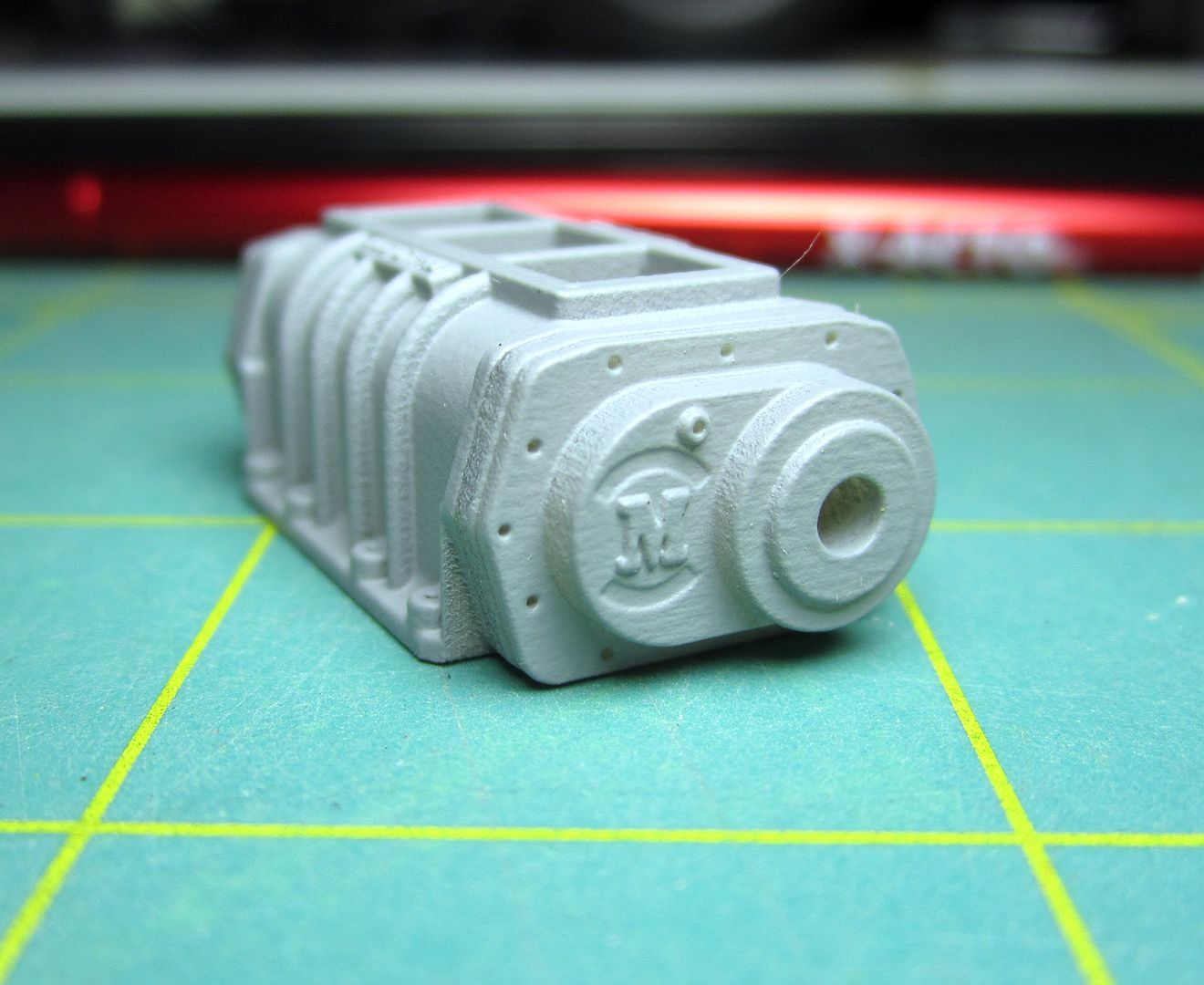

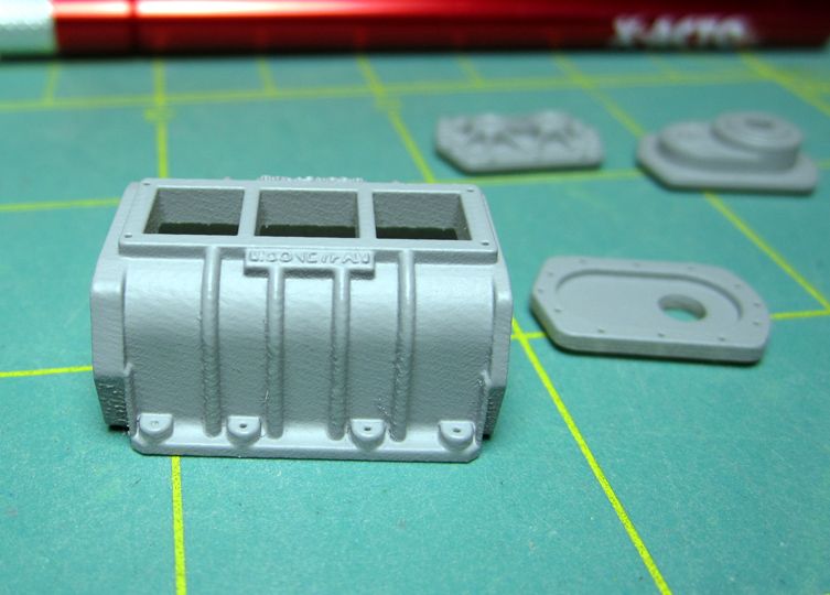

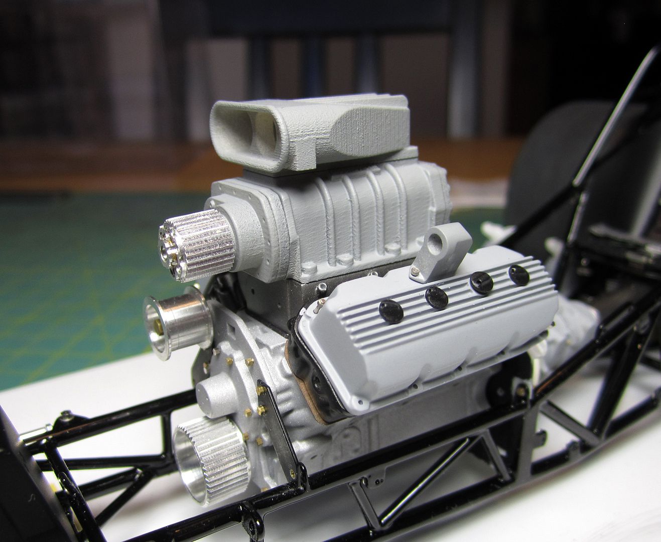

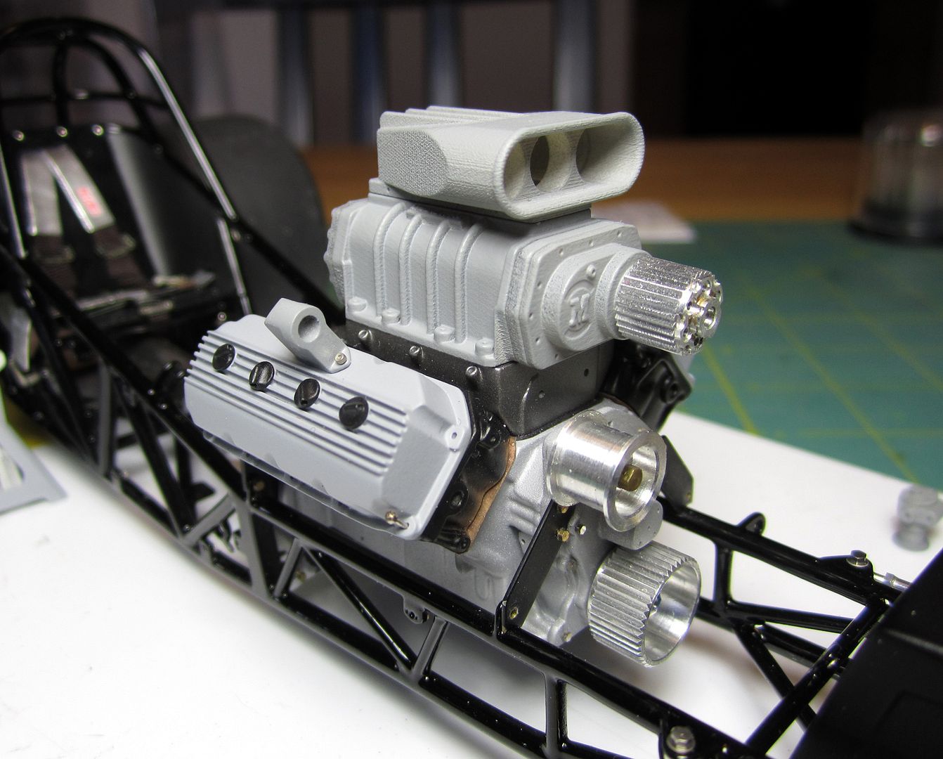

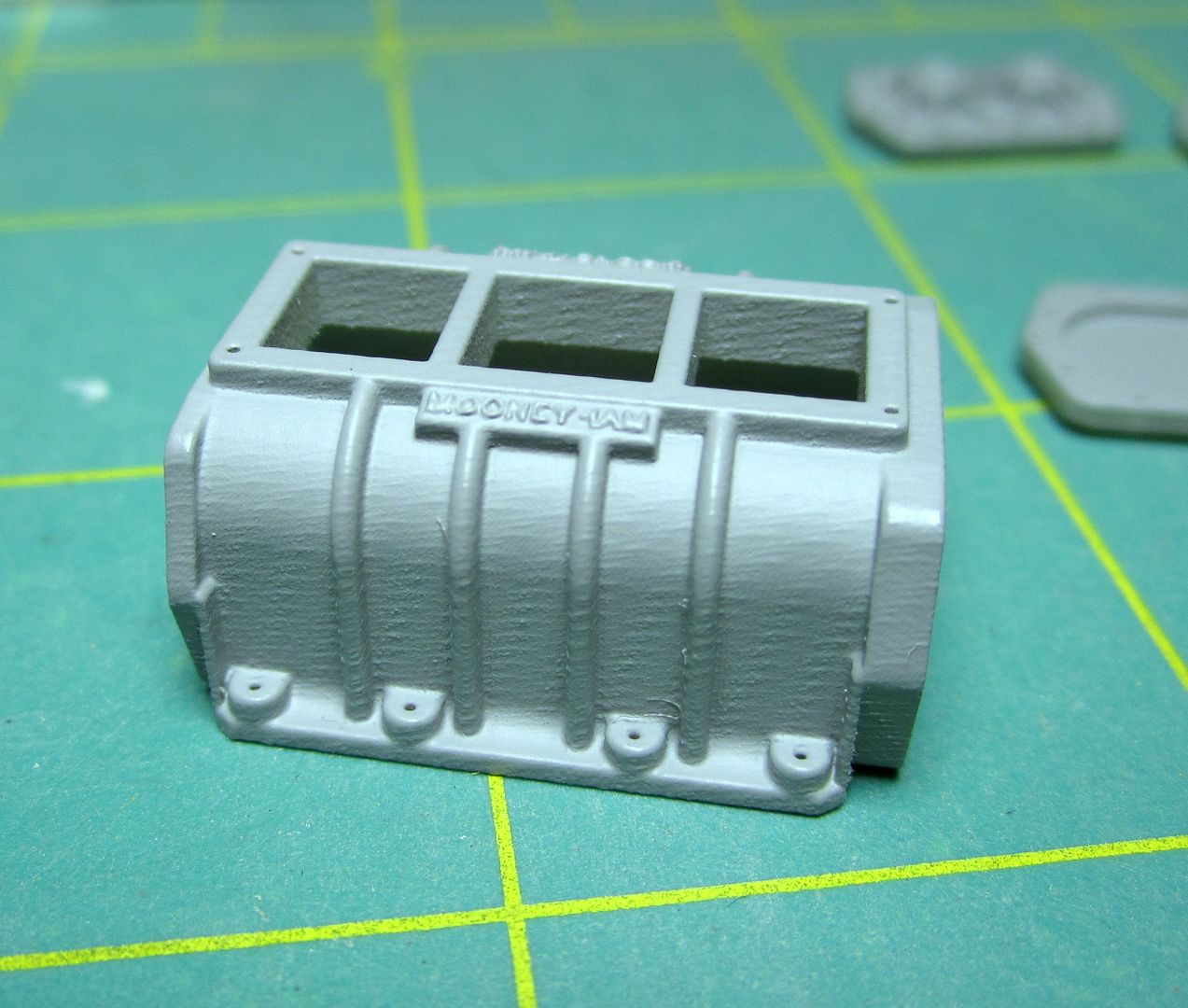

Mooneyzs Posted November 8, 2014 Author Share Posted November 8, 2014 Ok Fellas.... I got a couple quick coats of primer on the parts and the only prep I did to them was wash them with Dawn and warm water. I wanted you to see the finish which will all be sanded smooth. This Frosted Ultra Detail material is very easy to sand smooth. Here are a truck load of pics for you to look at.... Here is the font and rear panels of the blower: Here is one side of the blower along with the "MOONEYHAM" lettering printed on the side. it looked to print nice but missing a little bit of the lettering and I haven't a clue as to why: Here is the other side with the same result: Front panel on the blower: Here is the injector Hat: Quote Link to comment Share on other sites More sharing options...

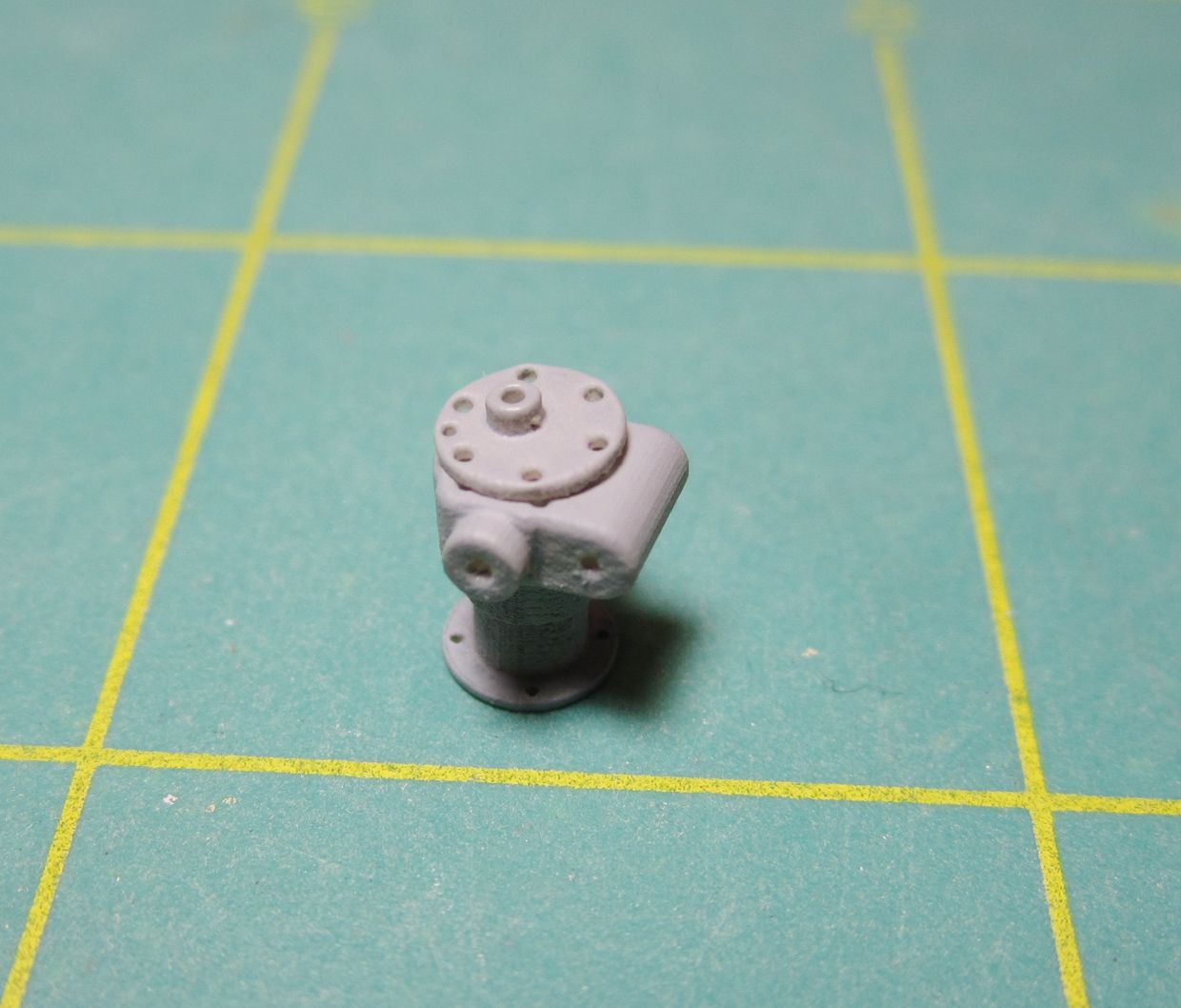

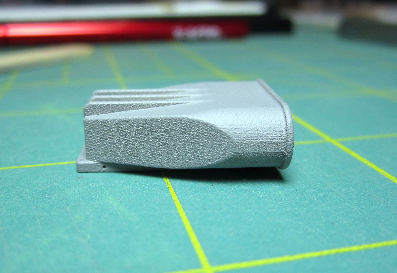

Mooneyzs Posted November 8, 2014 Author Share Posted November 8, 2014 More of the injector hat: Back: Front: Here is the 3 Piece Hilborn Fuel Pump: Quote Link to comment Share on other sites More sharing options...

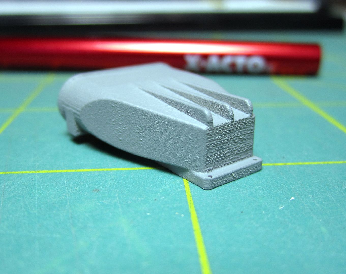

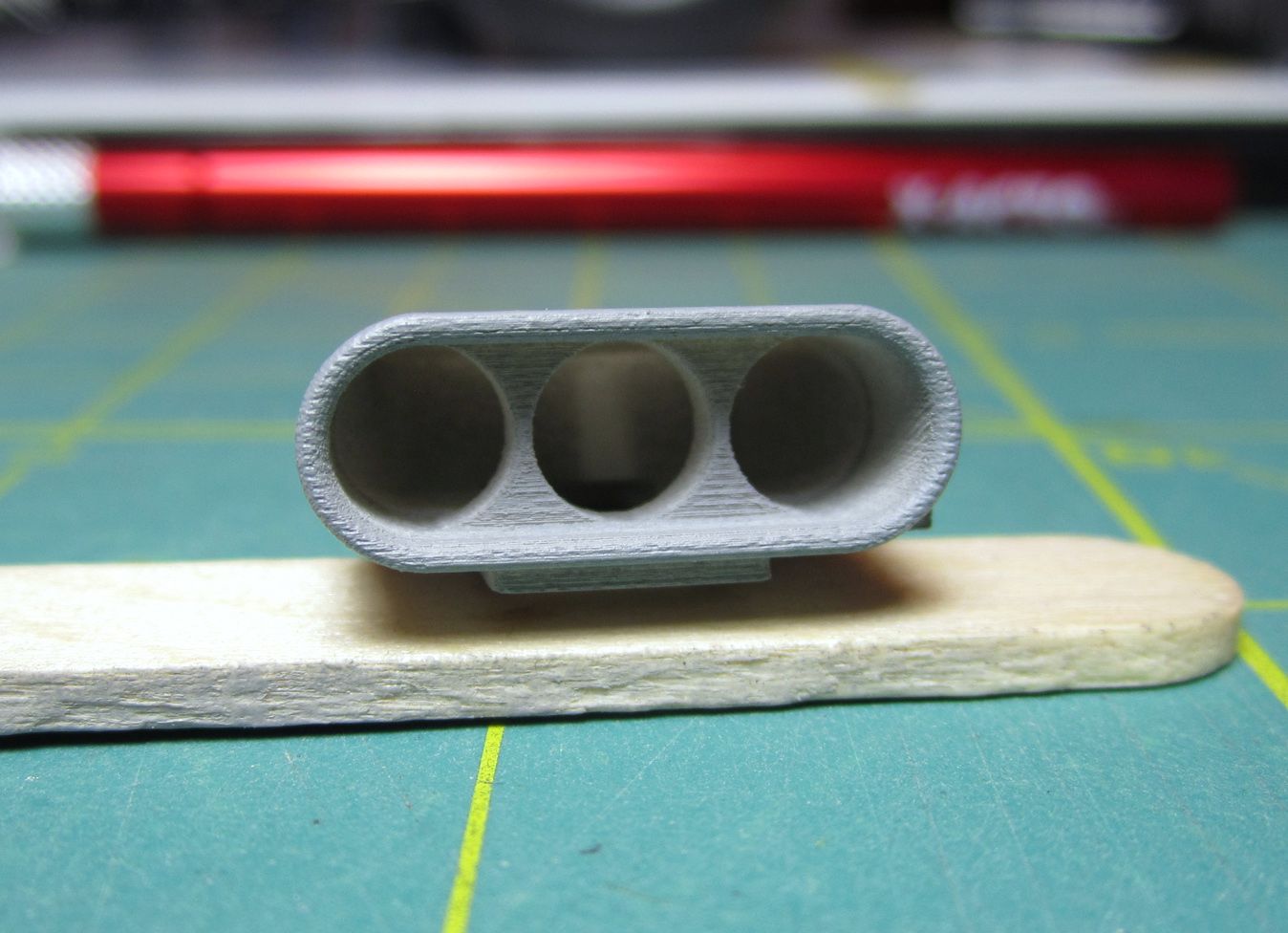

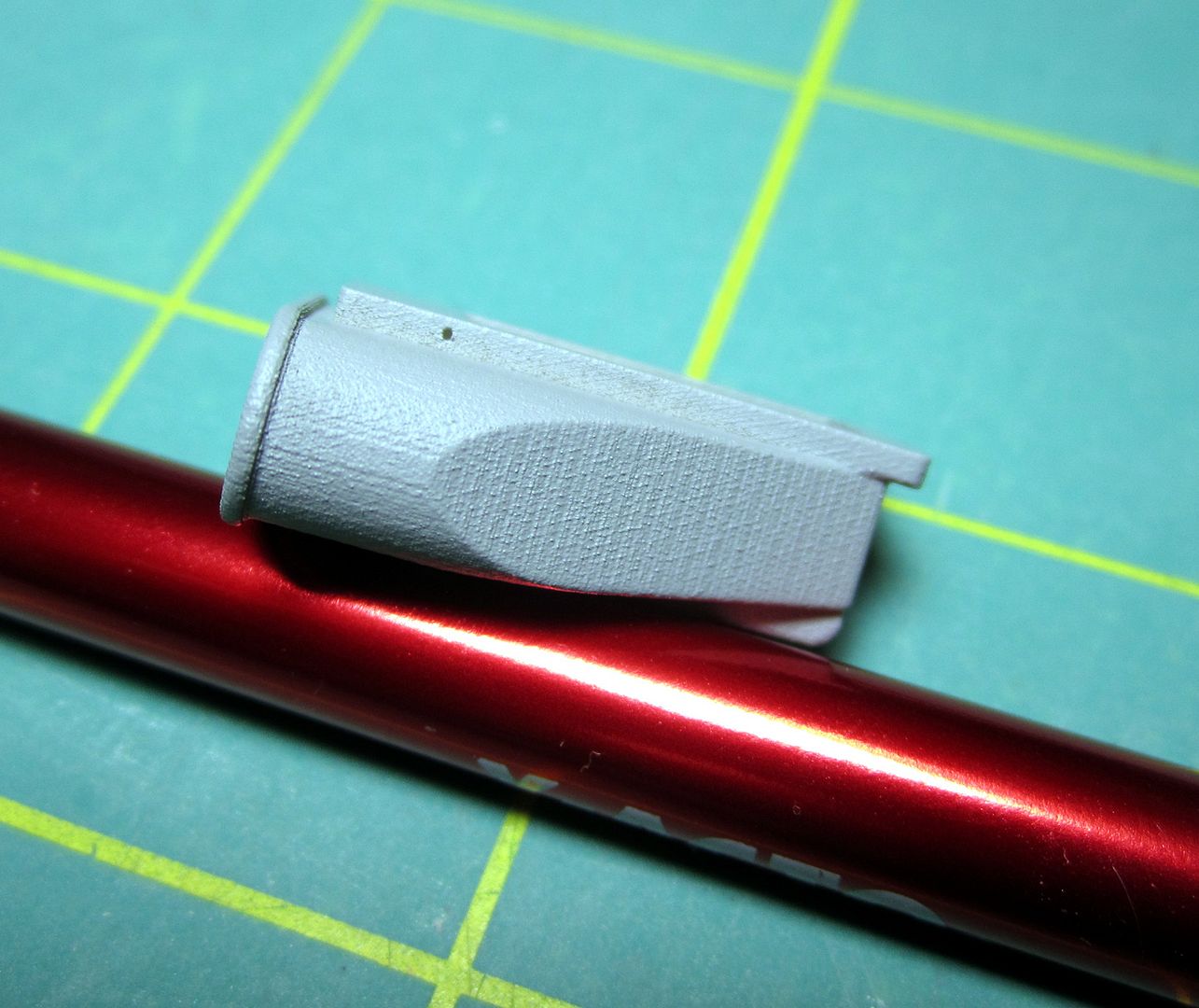

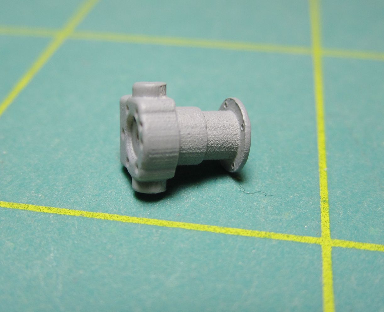

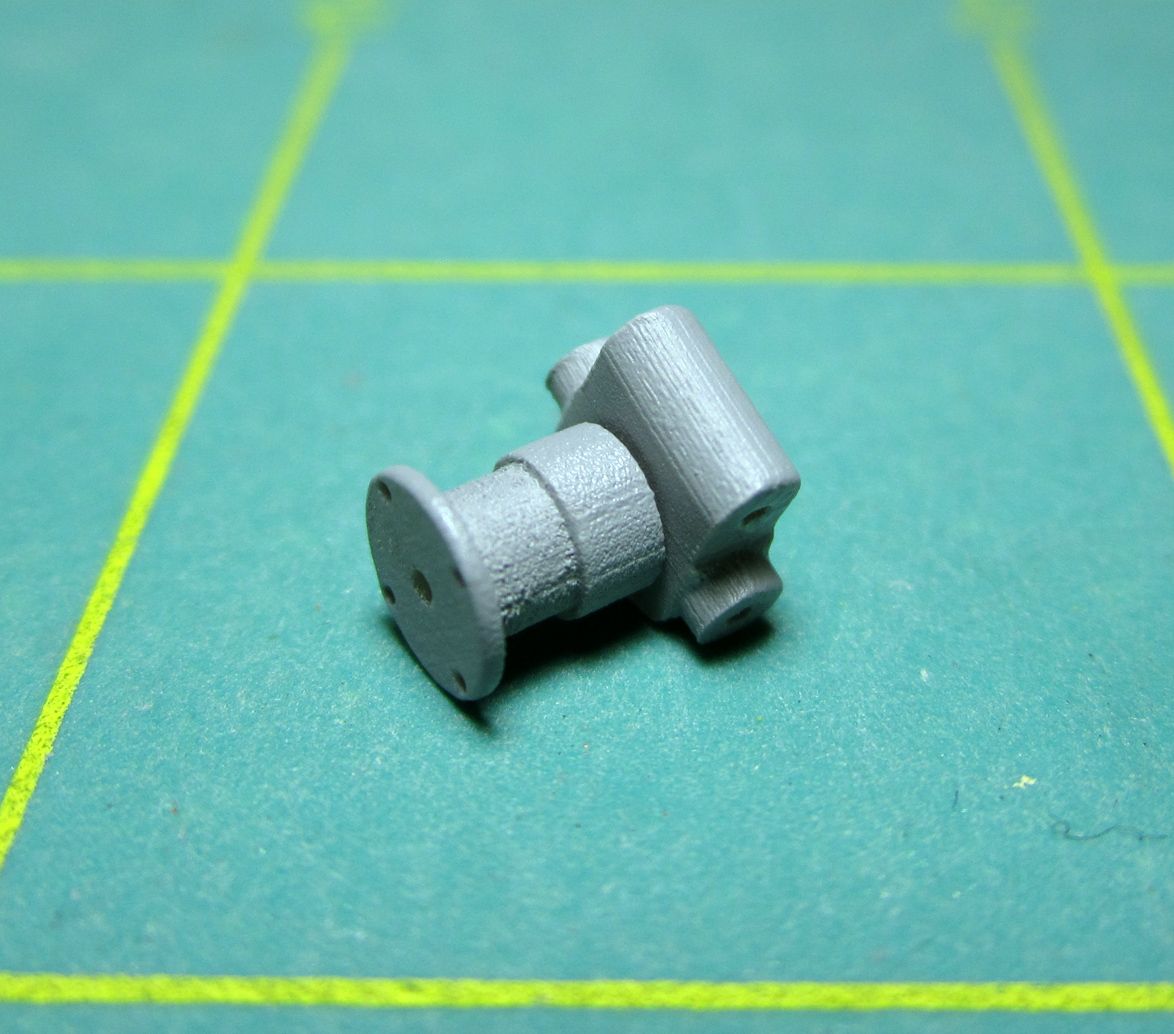

Mooneyzs Posted November 8, 2014 Author Share Posted November 8, 2014 Here are a few issues I had with the Injector Hat and as to why I said I needed to do a little redesigning to it. For some reason not all of the holes I had in it printed. I have a feeling that it was because I made them a tad too small. I sized them all to .016" of and I probably should of made them a min of .020. There should be 4 lines for the injector ports and there should of been the bore for the butterflies shaft: Here on the opposite side it only printed one injector port hole: Here are a few fun mock up shots: Quote Link to comment Share on other sites More sharing options...
nitro norman Posted November 8, 2014 Share Posted November 8, 2014 The parts look great. I can't help but notice the texture on them. Please forgive my ignorance, but are they easy to sand smooth ? Is this material similar to styrene ? I work at a dental lab and we 3D print some of our partials and they come with a texture on them also. I know, because I have to finish them. LOL Quote Link to comment Share on other sites More sharing options...
