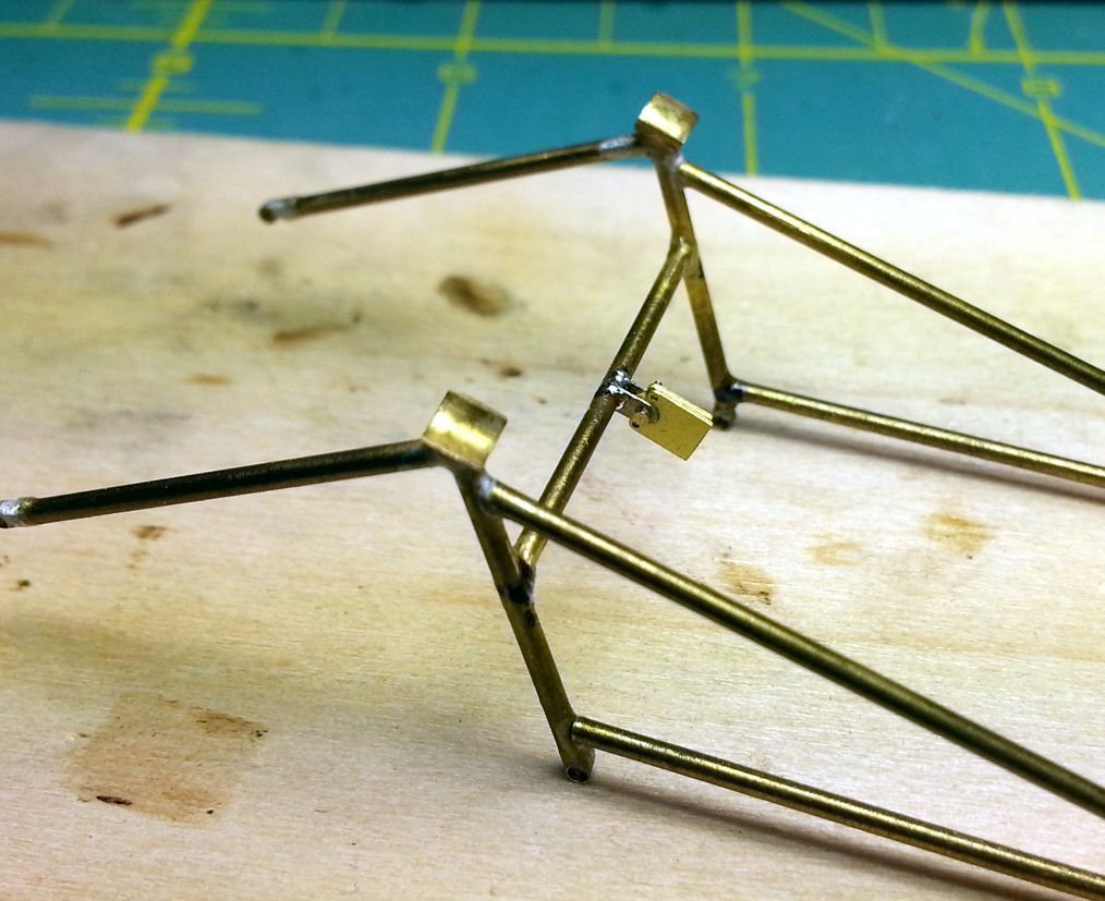

Ok Fellas another quick early evening teaser of what was worked on today and it seemed to take much longer than I was planning but it's ok because I need to make this before I could get some pieces in primer. I worked on the mounting bracket tabs for the body hold down latch. I started with Pro-Tech Throttle linkages and then Soldered them to my front body supports. I used some material as a spacer between the tabs. I apologize for the crappy picture, I took these with my cell phone because I was lazy to retake them with my camera:

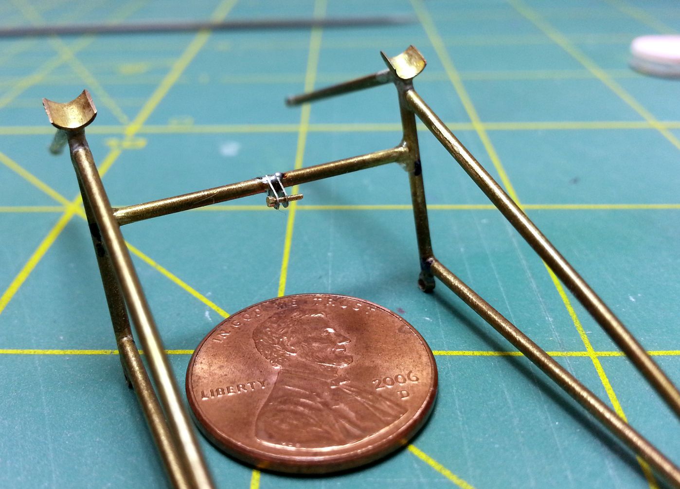

Here is a comparison with a penny in the picture to show how small the tabs were that I had soldered it was a pain in the butt to get the tabs positioned where I wanted them in order to solder them:
Next... I am going to work on the "J" Hook that will go in between both of these tabs which will latch the body in the down position.

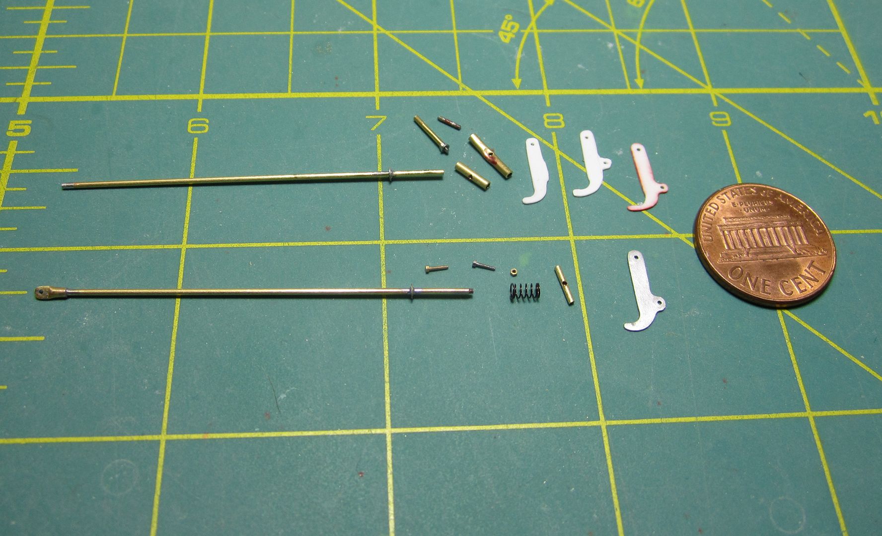

Alright Fellas... as promised here are pics of the pieces and how I made this latch up..... I still don't get why that other video hasn't been approved but when it is done I will post it as well.

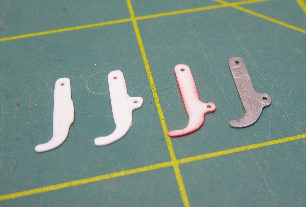

Here was the start of the "J" Hook. I first started with the template I made from some styrene since it was easier to cut and form. As you can see I had to make a couple before I was happy with it. Once I found that the third one from the left worked, I then copied it over to a piece of .016" thick piece of aluminum and cut it out with my dremel and sanded it to shape with a sanding stick and round file:

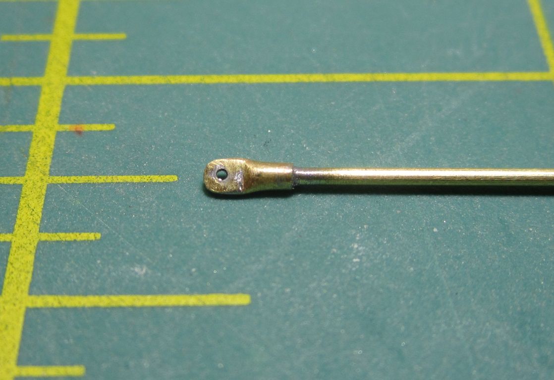

From there I started to make the Rod End that was going to attach to the J hook. I took some 3/64" OD tubing since the 1/32" OD tubing was the size of the man tube. I crimped the tubing down and shaped and drill the mounting hole into it and then soldered it to the 1/32" tube:

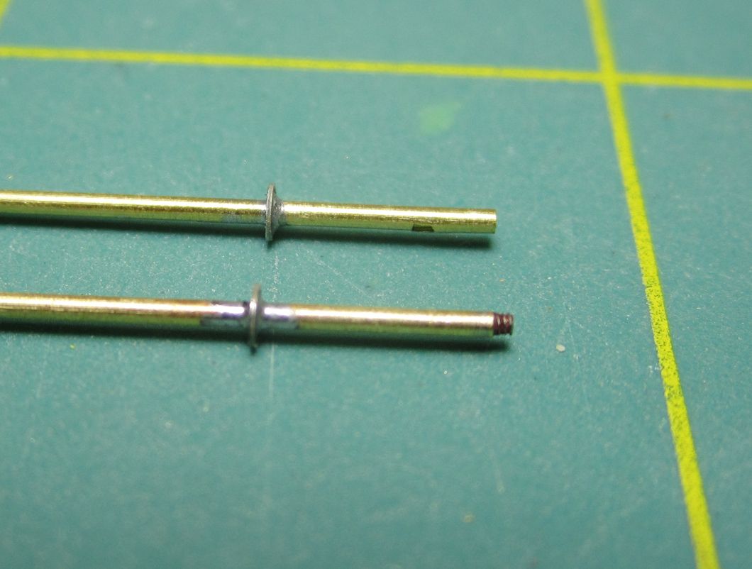

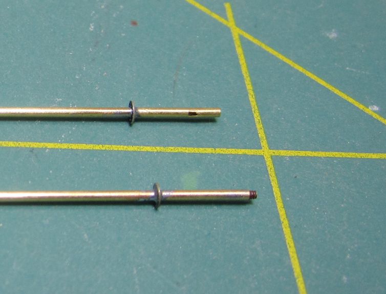

I then used a photoetch washer which was going to be the resting point for the spring and then I also drilled out the 1/32 tube so I could slid in piece of threaded rod. As you can see from the top piece, I drilled thru the wall and had to redo the tube. I had soldered the threaded rod into place:
Here are all of the pieces that I had used to make these parts. A few pieces in the pic were test parts:
