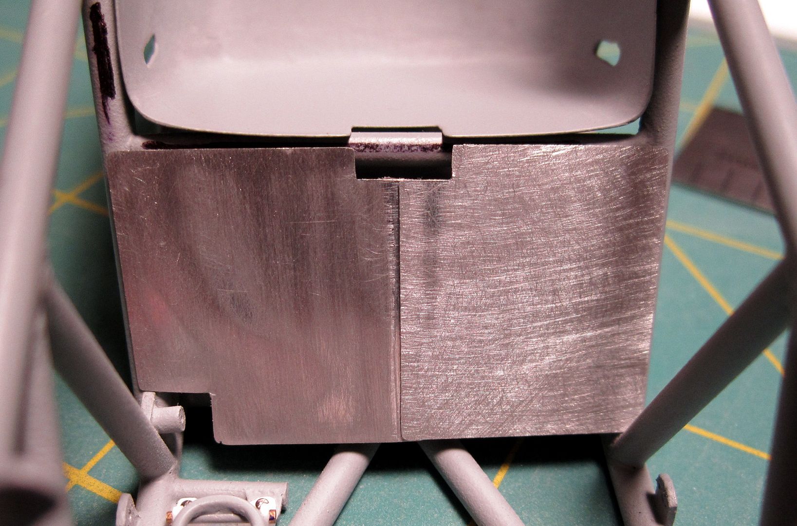

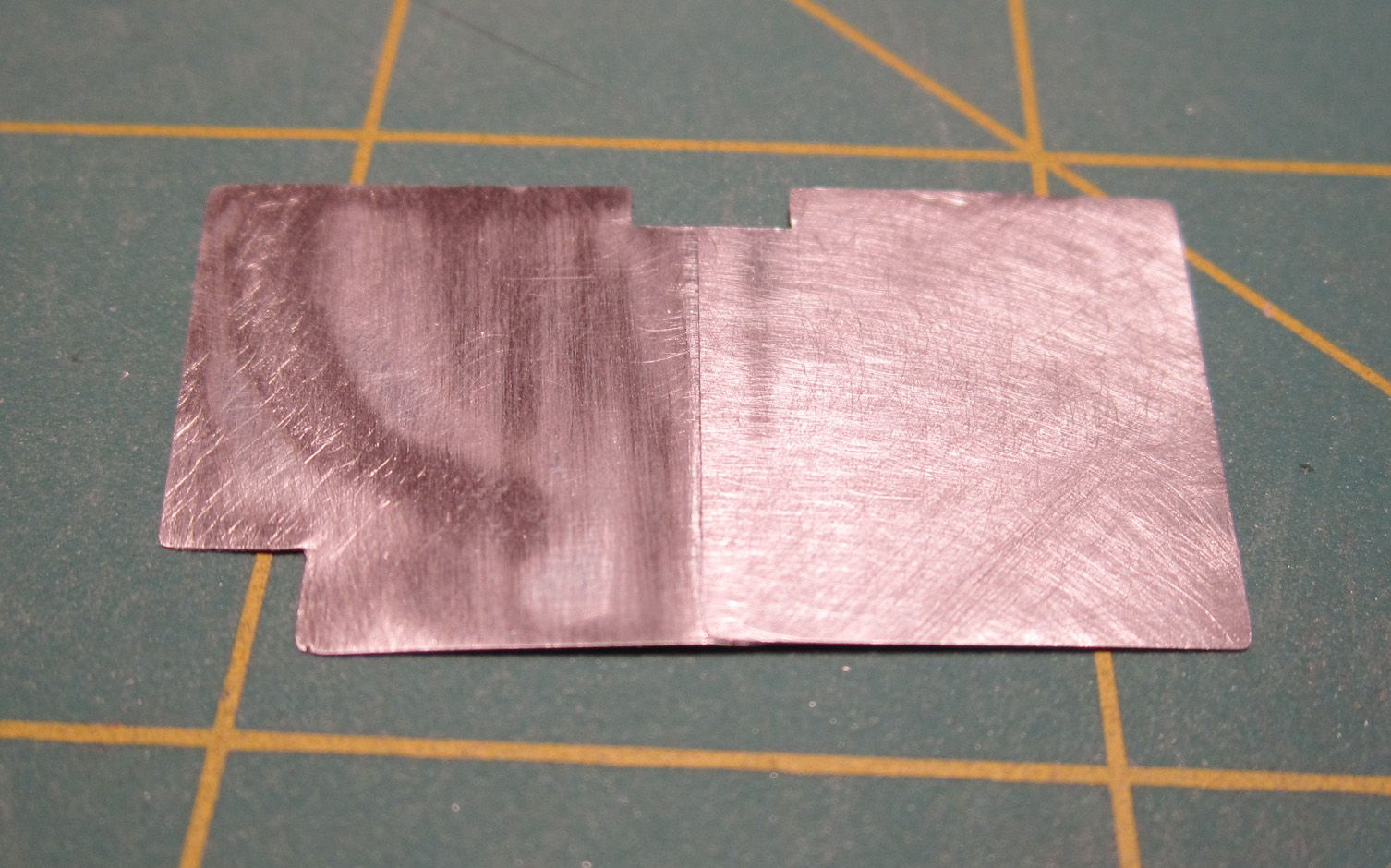

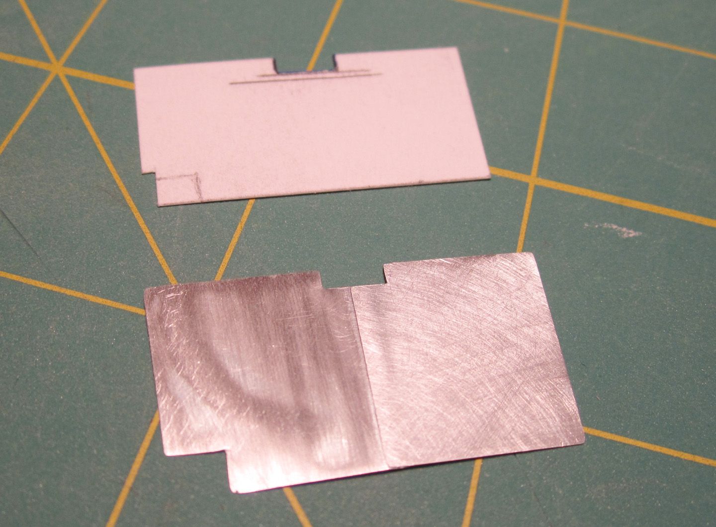

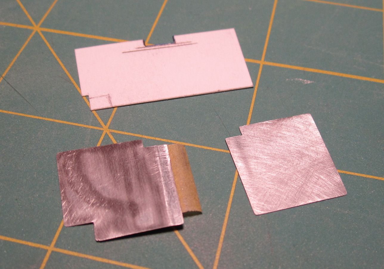

Mooneyzs Posted January 11, 2013 Author Share Posted January 11, 2013 Well guys I sat down and did a little bit of work tonight. Not much but did get a little progress one. I worked on some interior tins that mount below the seat. I am happy with them but I may redo one of them because the piece of printing plate I used had a little bow in it. Anyway here are a few pics.... I had first made a template from a 3x5 card to get the shape I wanted and then I transferred it to the aluminum printing plate and cut the parts out: Here I am just showing that I made it out of 2 pieces: Upclose view of the panel: Here it is test fitted into the chassis. I still need to determine where the drive shaft will be going thru the panel and cut the hole in for it: Quote Link to comment Share on other sites More sharing options...

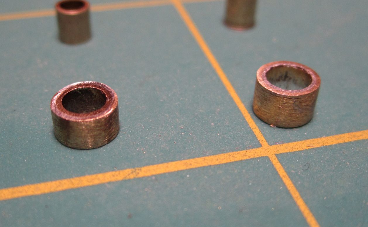

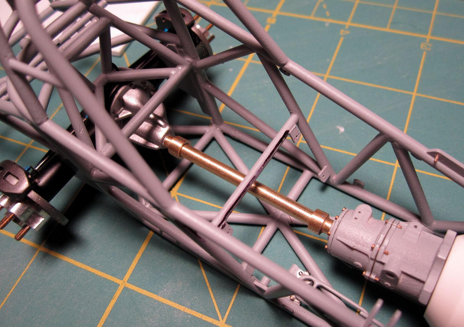

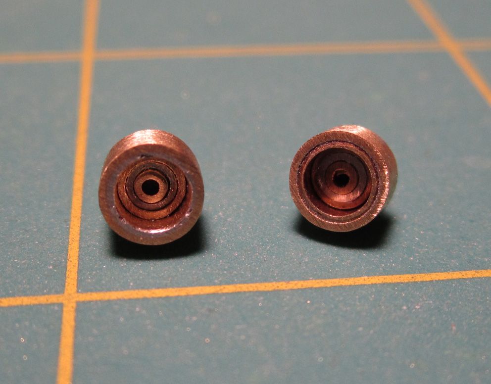

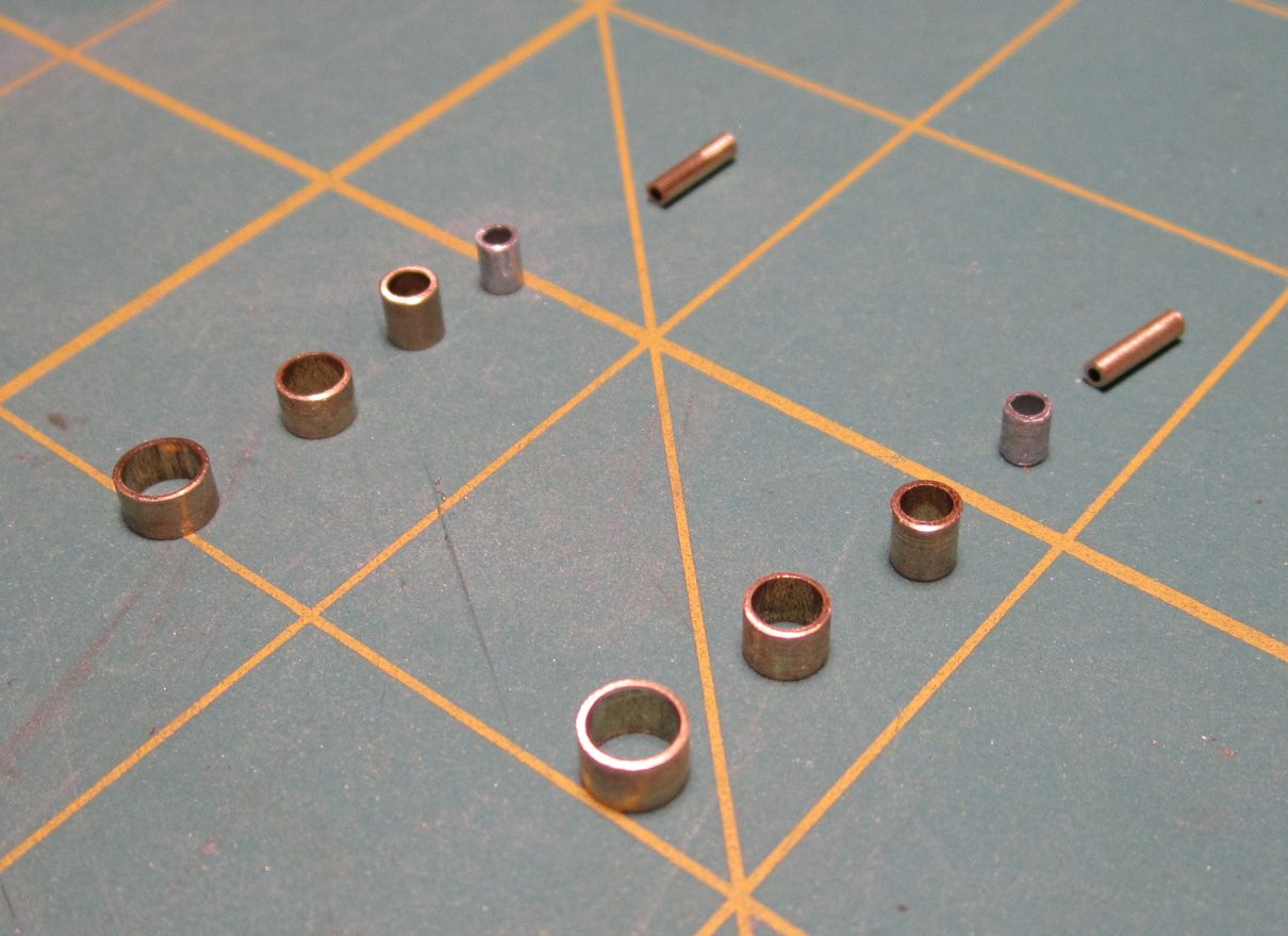

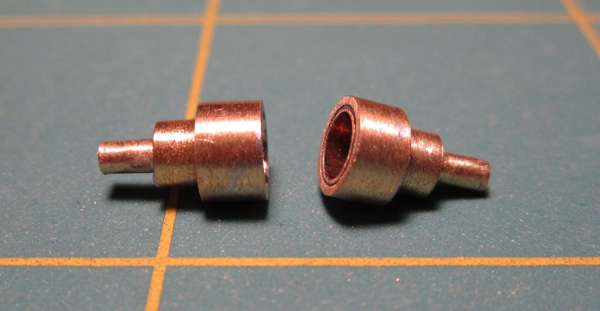

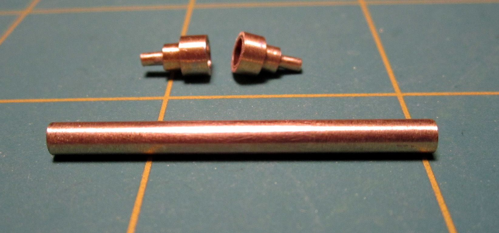

Mooneyzs Posted January 13, 2013 Author Share Posted January 13, 2013 Mike.... Thanks bud. Really feels great getting more accomplished on this. Darryl... Thanks buddy. It sure is time to fire it up. You wanna flip the switch on the starter or would you prefer to sit in the seat . Hola Fellas..... Well last night I tinkered a little bit but didn't get very far because I was digging thru parts and aftermarket Items looking for a few things and then I kept bouncing back and forth on what part of this build I wanted to work on But I realized on the two panels I recently made that I was going to need to put a hole in them for the drive shaft to go thru. So last night I was hand sketching out how I was going to make the couplers and drive shaft. So today when I got the time I sat down and worked on these for a good few hours tonight. So far I am happy with how they turned out. I made everything out of brass tube, brass rod and aluminum tube. Let me show you the pics Here are all of the pieces cut to make two couplers, I originally was going to make them all out of brass and solder it all. Well I realized that I was out of 3/32" tubing so I had to settle for 3/32" aluminum tubing and super glue some of the pieces: I did solder these two pieces together, these two will be the "cup" portion of the coupler that the drive shaft sits in: Here are the couples after they have been assembled and they just need to be prepped for primier: this is the inside or "cup" portion as I called them earlier: Here is the Drive Shaft with I just cut out of 1/8" brass rod and cut to length: I had to take the parts and mock them up to see how it looked in the chassis and I am very happy with the results: Here is a side view of the mock up: Next up is to get the hole cut in the plates that mount below the seat for the drive shaft to go thru. Then during this process of mocking up the drive shaft and couplers I have realized that I think I have the gas pedal sitting to far back (close to the seat) and I need to move it forward and figure out how I am going to remount it. Better to have found this out now before I paint the chassis. After I relocate the gas pedal, I can get the rest of the chassis sanded and re-primered that way I can get some paint on it and have a rolling chassis done and thanks for looking. Quote Link to comment Share on other sites More sharing options...

MicroNitro Posted January 13, 2013 Share Posted January 13, 2013 You nailed the drive shaft. Glade to see it getting close to paint. Quote Link to comment Share on other sites More sharing options...

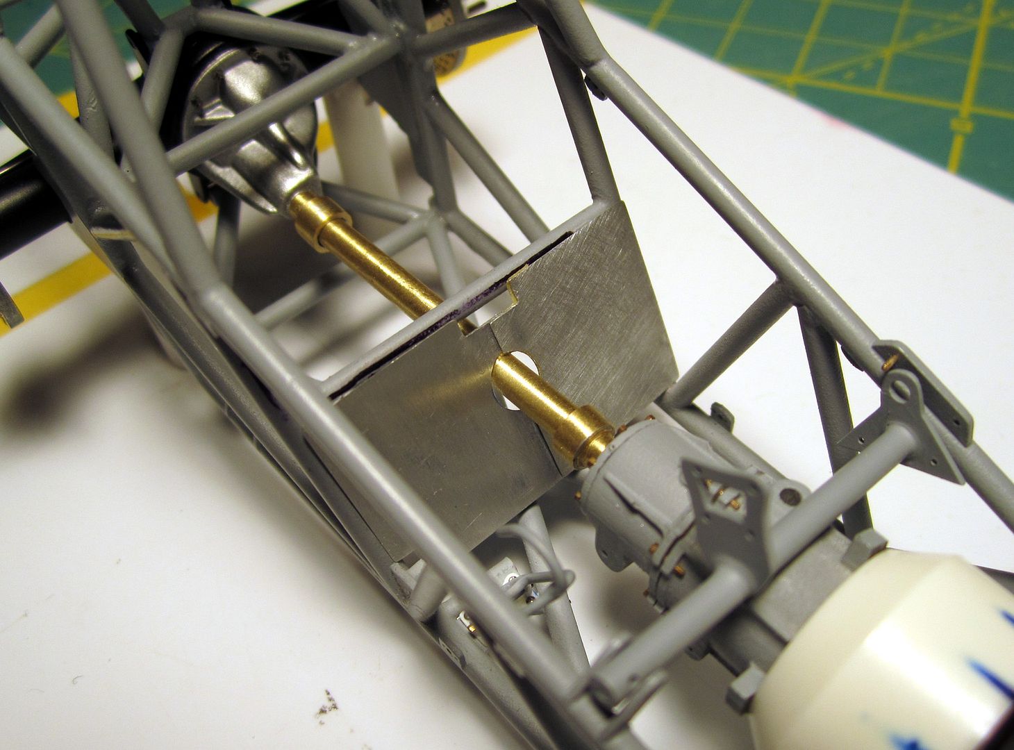

Mooneyzs Posted January 14, 2013 Author Share Posted January 14, 2013 Ok guys I really didn't get much done today but I did get the hole made for the drive shaft to go thru.... guess you can say baby steps today...haha Quote Link to comment Share on other sites More sharing options...

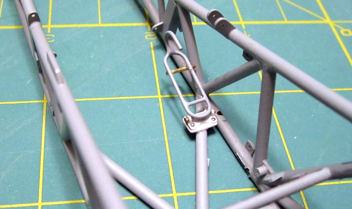

GoatGuy Posted January 14, 2013 Share Posted January 14, 2013 Chris- see this pic from Bruce Larson's Corvette FC. The circled area shows the pedal. I don't know if it helps, and I realize it's not the same year as the Vega FC. Quote Link to comment Share on other sites More sharing options...
Magic Photos Posted January 14, 2013 Share Posted January 14, 2013 Great work Chris the drive shaft looks killer Quote Link to comment Share on other sites More sharing options...
Mooneyzs Posted January 14, 2013 Author Share Posted January 14, 2013 Hey Dave... thanks for the pic. Some where I messed up when I was locating the pedal. not sure if it was before i moved the engine forward 1/2" or what but i will be fixing it and will located more like your pic. thank you for sharing it. Mike... thanks buddy. I am trying to figure what color to go with. I know it will be some sorts steel color... alclad or testors metalizer lol Quote Link to comment Share on other sites More sharing options...

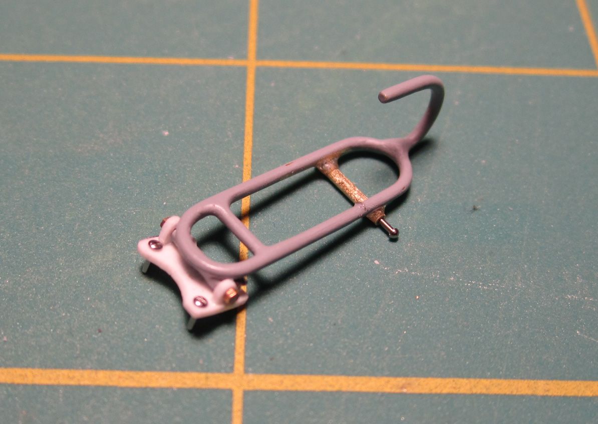

Mooneyzs Posted January 26, 2013 Author Share Posted January 26, 2013 Hello Fellas... Been a few days since I posted updates... and I have a small one that I want to show you that I worked on this week. As I mentioned that I had my gas pedal to far back so I finally was able to get it moved to the correct location and looks much better. Besides that I added a little more to the gas pedal, the pieces that the morse cable fore the throttle linkage will connect too. I am currently working on how I am going to make the morse cable look like it should, so stay tuned for that. I should have pics up tomorrow with the proto type of it...lol Here is the new location of the mounting plate that the gas pedal will mount too. You can see just to the right of it where I cut the old mounting tabs out: Here is the modified gas pedal that I added some more detail to. A big Thanks goes to Dave (Comp1839) because he showed me how the cable should connect to the pedal: And a mock-up of the gas pedal in place: Quote Link to comment Share on other sites More sharing options...
