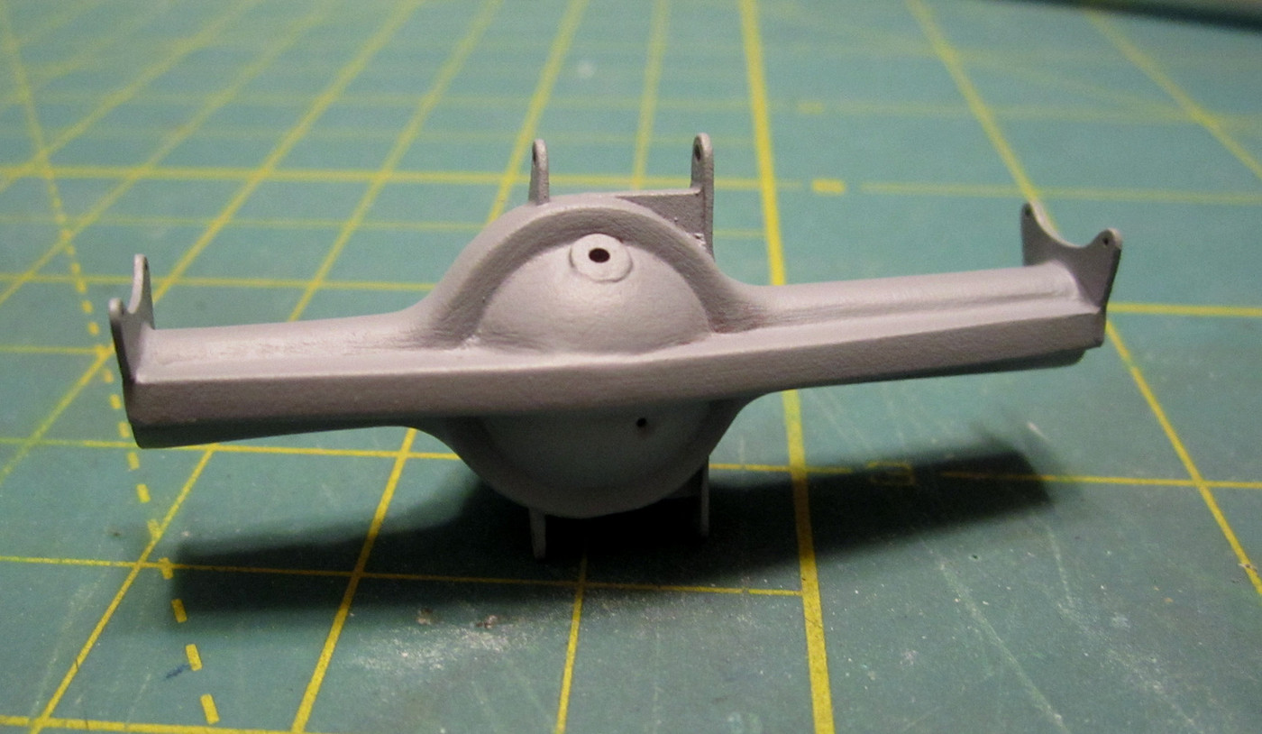

Well I sat at the bench for a few tonight, not as much time as I would of liked but I did make a little progress. I ended up getting the rear end looking better and with just a little more sanding an a tad bit more bondo I think I can call it good to after that and should be ready for paint. But I have been debating if I want to glue the axle in the rear end before I do this and if I do I am going to end up drilling two holes in the rear end so that I can get some epoxy in then I would go and back fill with putty. It's an idea I got tonight so that the axle will stay in the correct place for the ride height since there is room for a little play between the axle and rear end. What do you guys think?? Would it be better to glue the axle in place or not?? anyway here are a couple of pics....
Here is the rear end after getting a quick coat of primer on it after doing a little clean up and filler pieces:
Left Side:
Right Side:

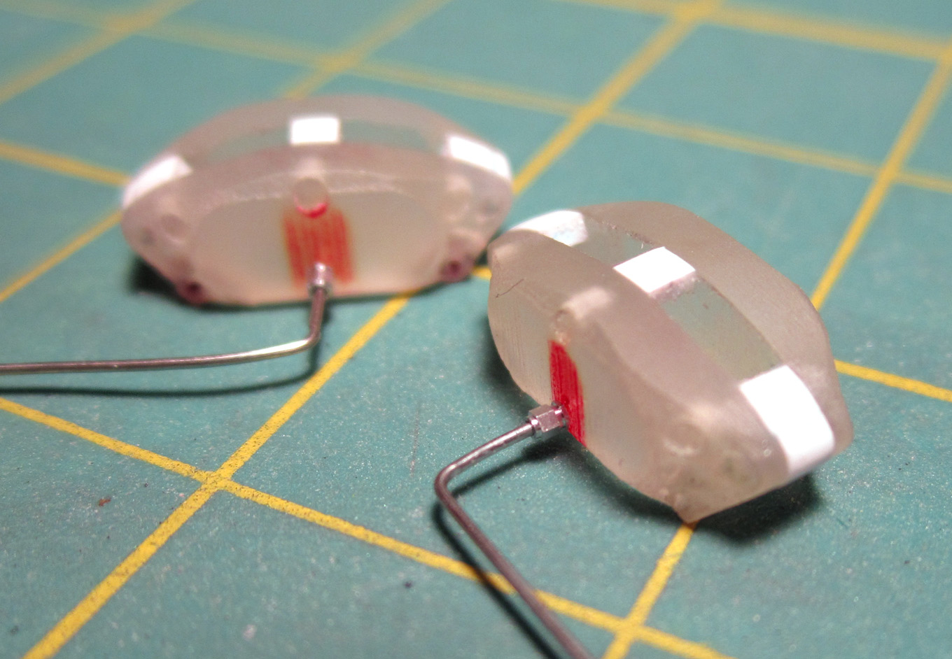

I did a little more work to the calipers by getting the holes drilled for the line and fittings:

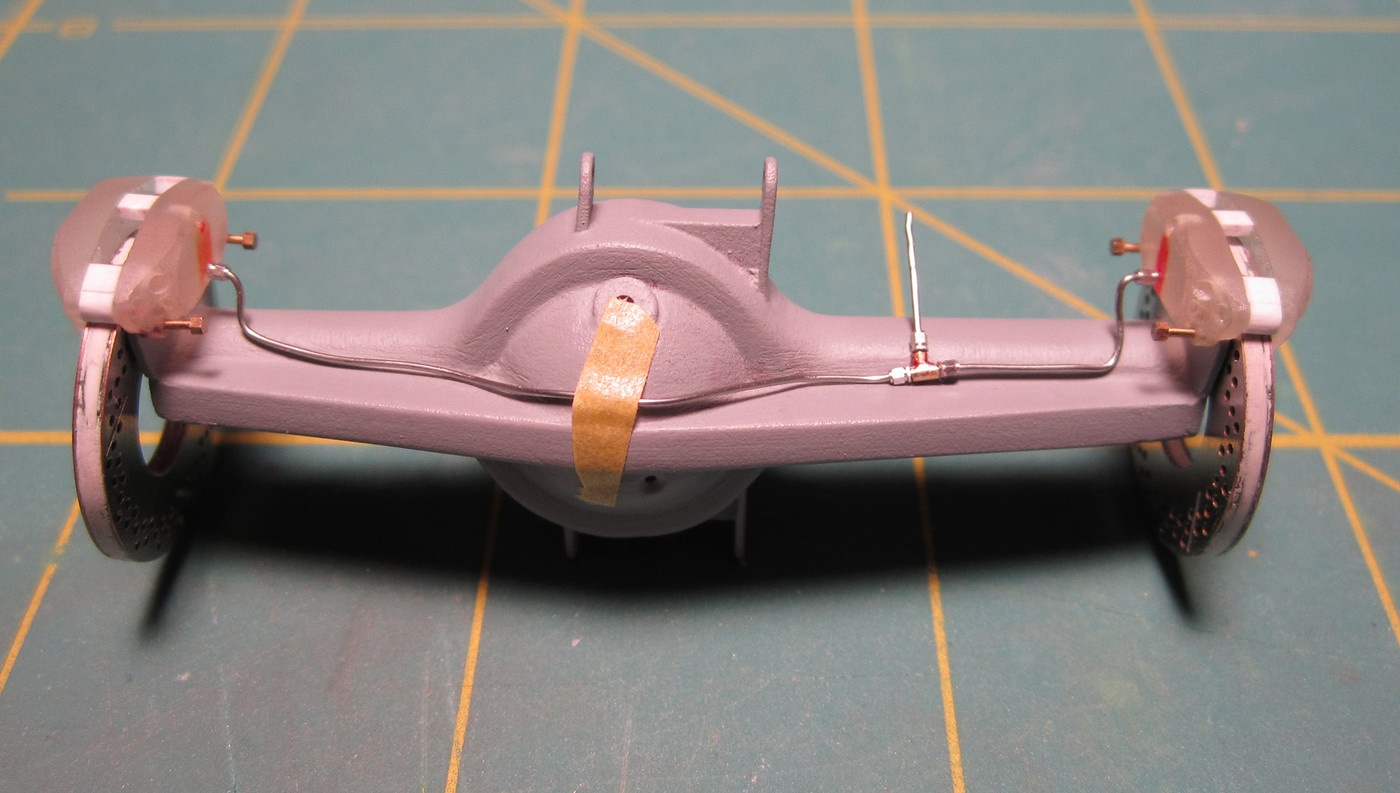

Well Fellas I got a little bit of an update for you. Got some bench time in tonight working more on the rear end and finally got my T-fitting for the brake line scratch built and did a quick mock up of the rear end. I feel like I am making progress and that I could almost paint the rear end. Its a good feeling to feel this close with it. :lol: I just need to do do some final sanding and primer on it. Here are the pics....

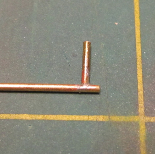

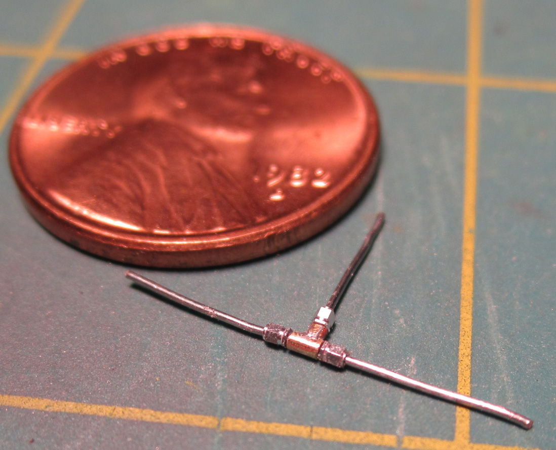

Here is the starting point for my Brake line T-Fitting. I started with 1/32" Brass tubing soldering two pieces together:

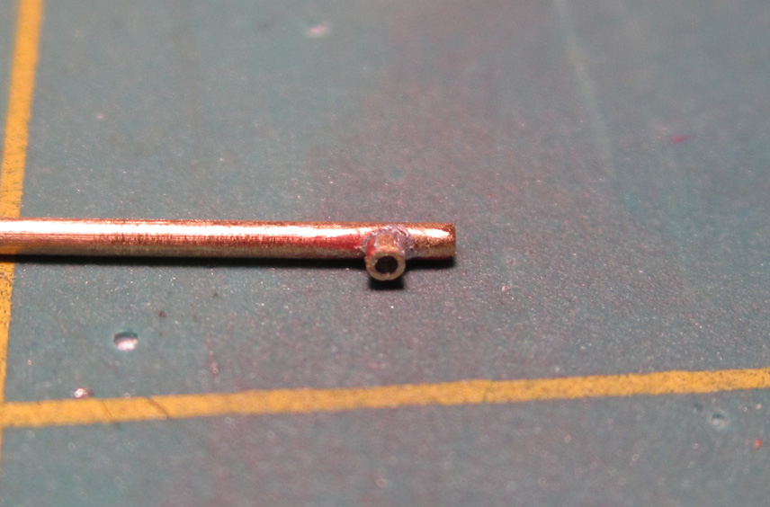

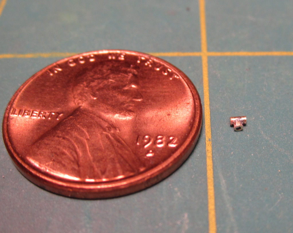

Once soldered I started to cut and sand to size:
Here it is after I was finished cutting and sanding, I placed it next to a penny so you can get the idea of the size of this thing :lol: . For some reason I think you guys are gonna go :blink: and then say I am nuts... :lol: :

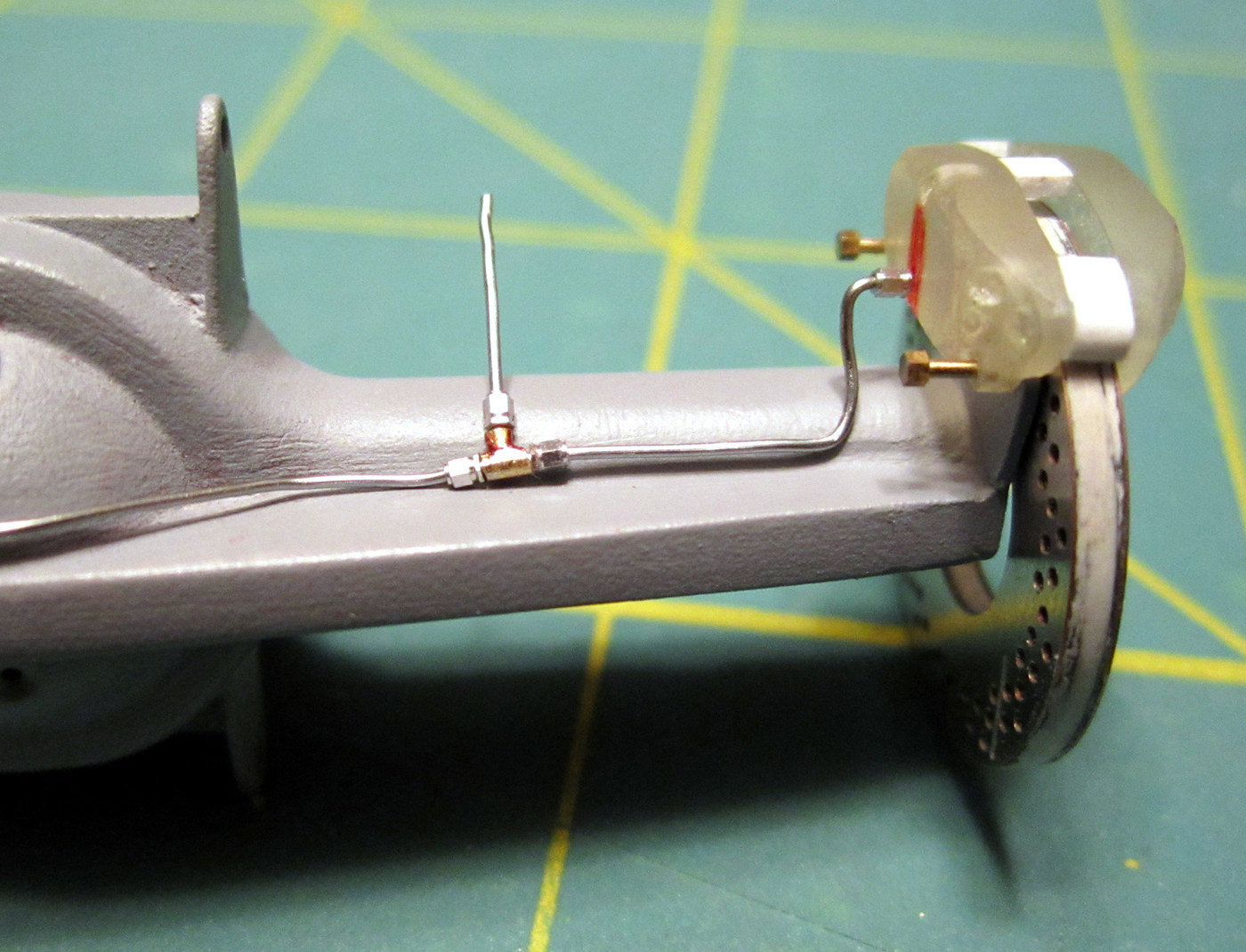

Here is the rear end with the brake lines and fittings mocked up. Sorry for the poor brake line plumbing, I was wanting to do it quick but when I do the final one I will have it looking a lot better:
Up Close View:

Joe....Thanks for the Kind words man. I also appreciate that you have been following along since the beginning. I know its been a long journey so far and I am really close to starting to paint a few pieces. I think once I get over that hump and having some initial parts painted that things should start moving a little faster. At least that is my though :lol: . You are right the T-fitting I made was small but I did have a T-fitting I bought through Scale hardware which was a little bigger than I realized and wasn't going to work. So to make it look right had to go ahead and make it.

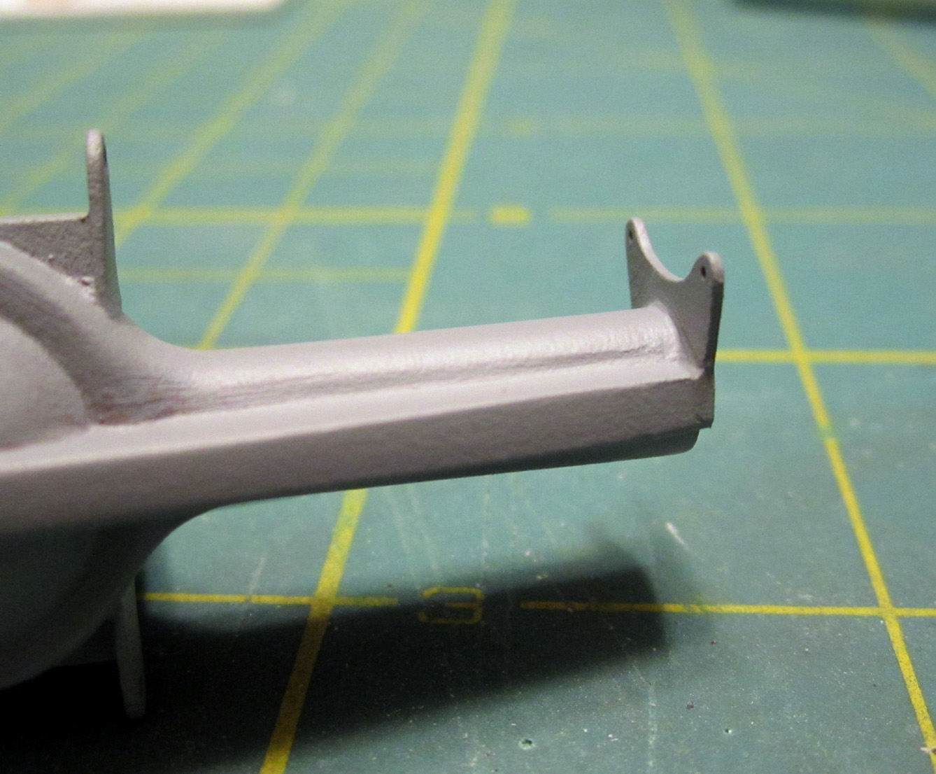

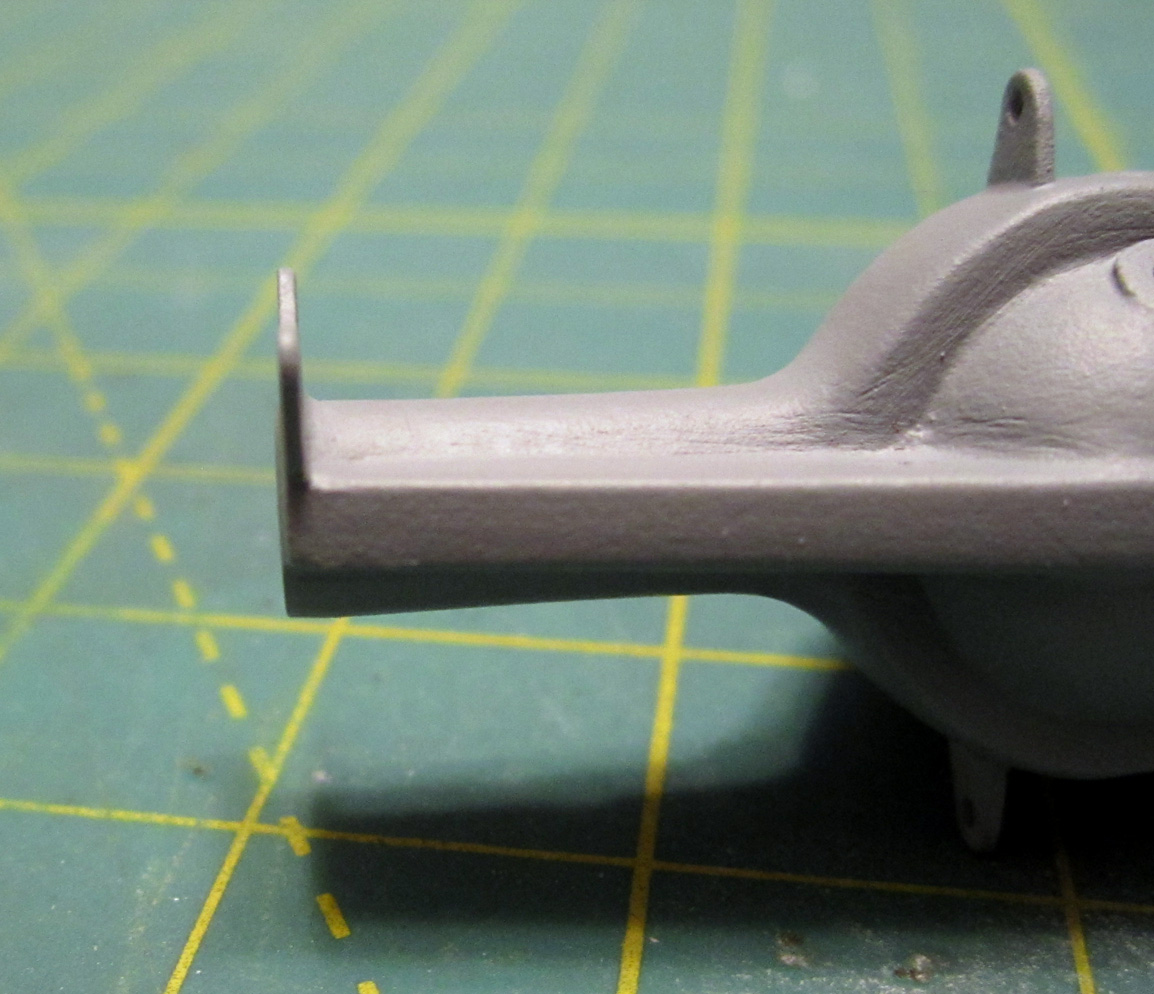

well guys I am sad to say that I haven't gotten any updates for you. I was hoping to possibly start painting some of the parts on the rear end as well as the rear end but I have one little detail on the rear end that i want to fix before I do paint it. I feel if I don't do it that I will regret it down the road. I am actually going to be filling in the mounting holes a little and shorten the mounting tab. This may not make sense of how I am describing it but when I put the rear end in the chassis for mock ups I can see a gap that has been bugging me and I want it to look right since I have gone as far as I have with this build so far. So bear with me and I will have some pics up soon with this fix to share with all of you.

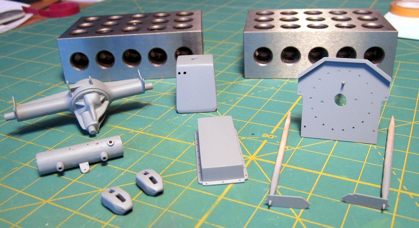

Well Fellas.... sorry I haven't posted much lately. I have been doing a little work on parts mostly sanding, bondo, more sanding and a little primering. I was hoping to paint some parts today but it has been really humid here lately and I have been a little hesitant on actually spraying because of how the weather has been. But I wanted to show a pic of the parts that I have pretty much ready to paint. They will need to be wet sanded again and hopefully I won't have to spray any more primer on them. I am hoping to make more progress on this build over the weekend. If i am not able to paint I will find other things on this build to work on to get ready. I have a list a mile long it seams on what needs to get done on this build. Thank you all for following along and being patient while I am slowly getting there. Any way here is what I have to share.....
