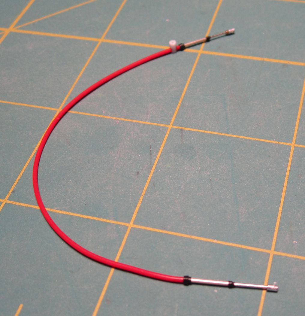

Here is all of the parts that I pretty much started with other than the piece of styrene rod that I am using as my hold down that ties the cable to the chassis. The Red tubing which is the main portion for the cable is teflon tubing that is basically 1/32" OD That I got from one of the guys at a local swap meet. The Items that I am using for the rubber dust boots are 1/24th and 1/16th Distributor cap boots from RB motion. I was digging thru all of my aftermarket items and was thinking how I was going to make those boots. when I ran across these distributor cap boots I decided to see if they would work for what I was doing and they were a perfect fit. And then the rest of the cable is made up of different size Nickel Silver tube (0.7 mm OD X 0.5 ID), Nickel siver rod (0.45 mm OD) and aluminum tube (1.0 mm OD x 0.25 mm ID) from a company called Precision metals that I picked up from my local hobby store (The Hobby Depot in Tempe Arizona). this tubing is not the cheapest but then again K&S doesn't make sizes this small.
Here is all of the components that make up just one end of the cable assembly. Note that I have two different cable end quick disconnects. If you guys want I could give you the dimensions of all of the pieces to the lengths that they were cut. just let me know and I will measure them for you.
Here is the cable assembled next to a dime so you can get the idea at how small this is:

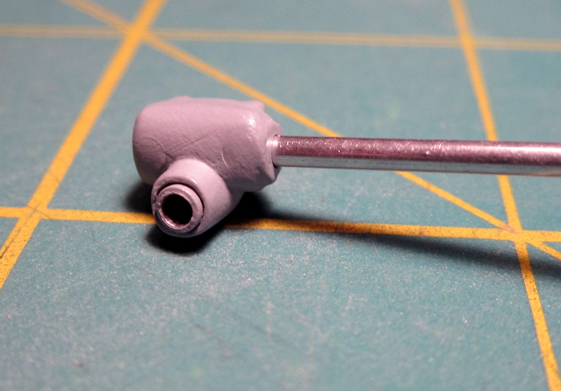

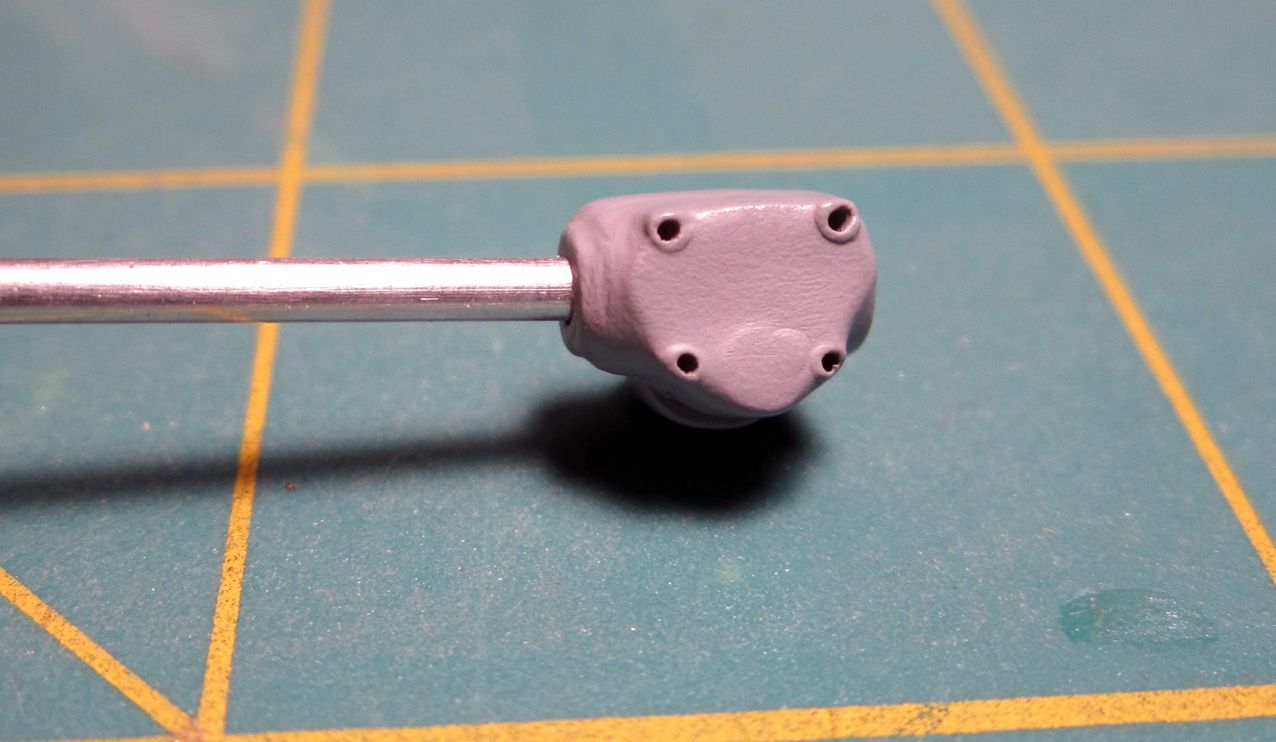

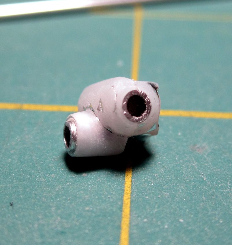

So I have been messing around most of the after noon with this build. I finished making the other end of the morse cable. Then started back on the steering gear box which I drilled out and stuck in aluminum sleeves which will hold the steering shafts in and got a quick coat of primer but I need to put some bond and sand down so Its still in a rough shape. Then I started messing around with how I was going to do the spark plug boots for the valve covers and got 1 proto type done. Here are a few pics:
Here is the Morse (throttle) cable as to what I am calling done for now until The engine goes in and I start installing it because I know I will have to cut the length down just a tad, sorry for the pic not being completely in focus I was having a tough time with my camera focusing in on it:
Here is the steering gearbox sanded down with the aluminum tube added for the steering tubes:
Here is the steering gearbox after a couple coats of primer, I need to add bondo to finish it:
the Back side:

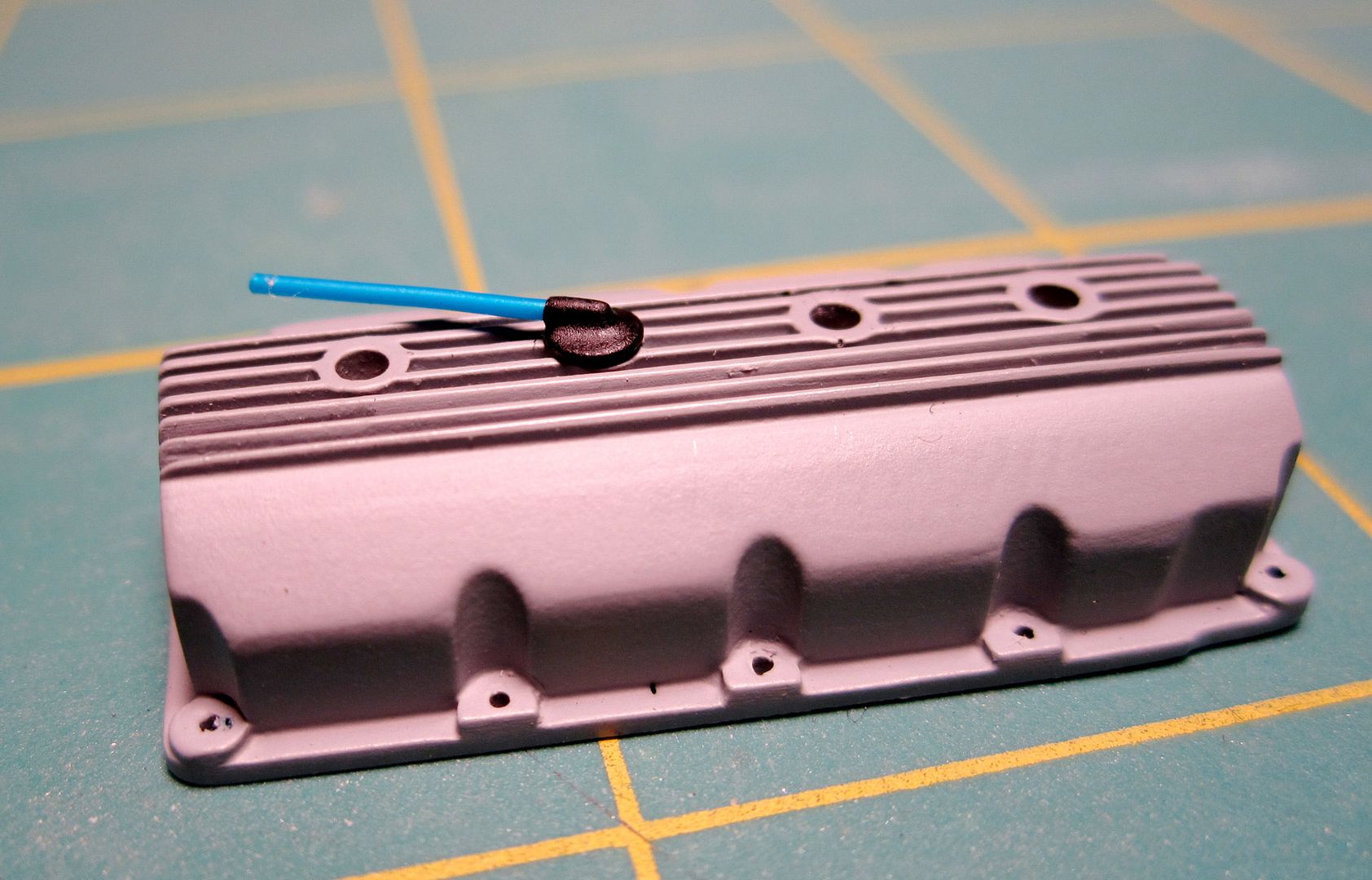

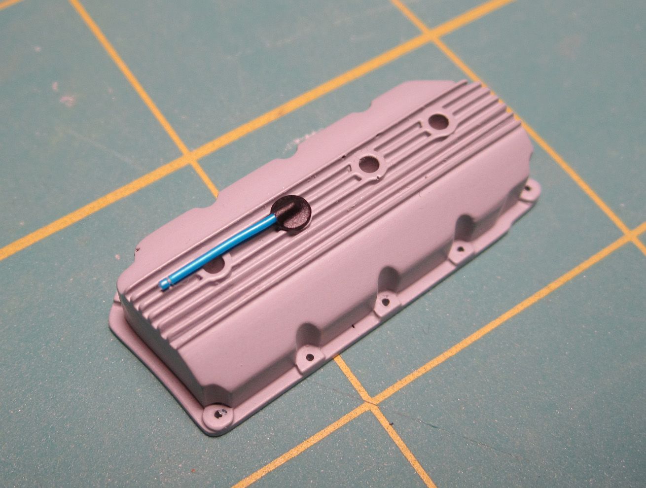

Here is my first prototype of the spark plug boots on the valve covers, I think I found what will work :D :
Another View:
