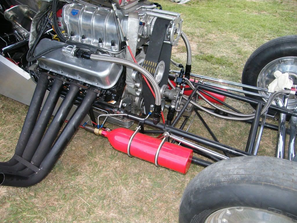

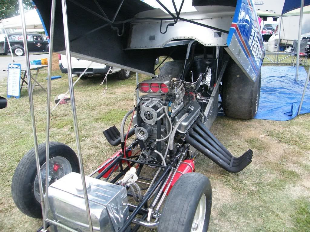

brett Posted November 13, 2011 Share Posted November 13, 2011 Chris I took these pics of a reasonably historically correct (safety updated mainly) BBC Nitro car last year. Looks to me they bolt to the front of the block hope this helps bud, your parts look great Quote Link to comment Share on other sites More sharing options...
comp1839 Posted November 13, 2011 Share Posted November 13, 2011 here is the plate in the background. i took this while measuring the fuel pump. the idler/ tensioner mount usually bolts directly on top of this. it is only exposed because this car is under construction. don't know if this will help or not. here is the front bolt pattern on a Keith Black block. if there is anything else you need .....just ask. Quote Link to comment Share on other sites More sharing options...
Mooneyzs Posted November 13, 2011 Author Share Posted November 13, 2011 Brett.... Thank you for the pics. Dave... Thanks for the reference pics. They are a big help. If I think of anything else I need to details to I will ask you. Thanks agains guy's I appreciate all of your help. I have a few pics of my progress from last night I will post.... Quote Link to comment Share on other sites More sharing options...

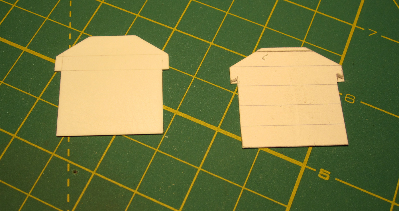

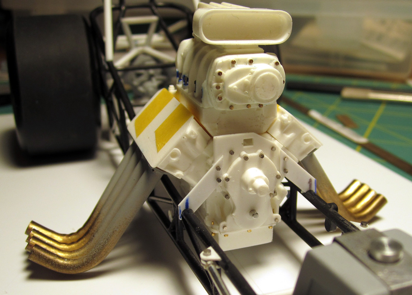

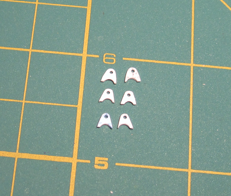

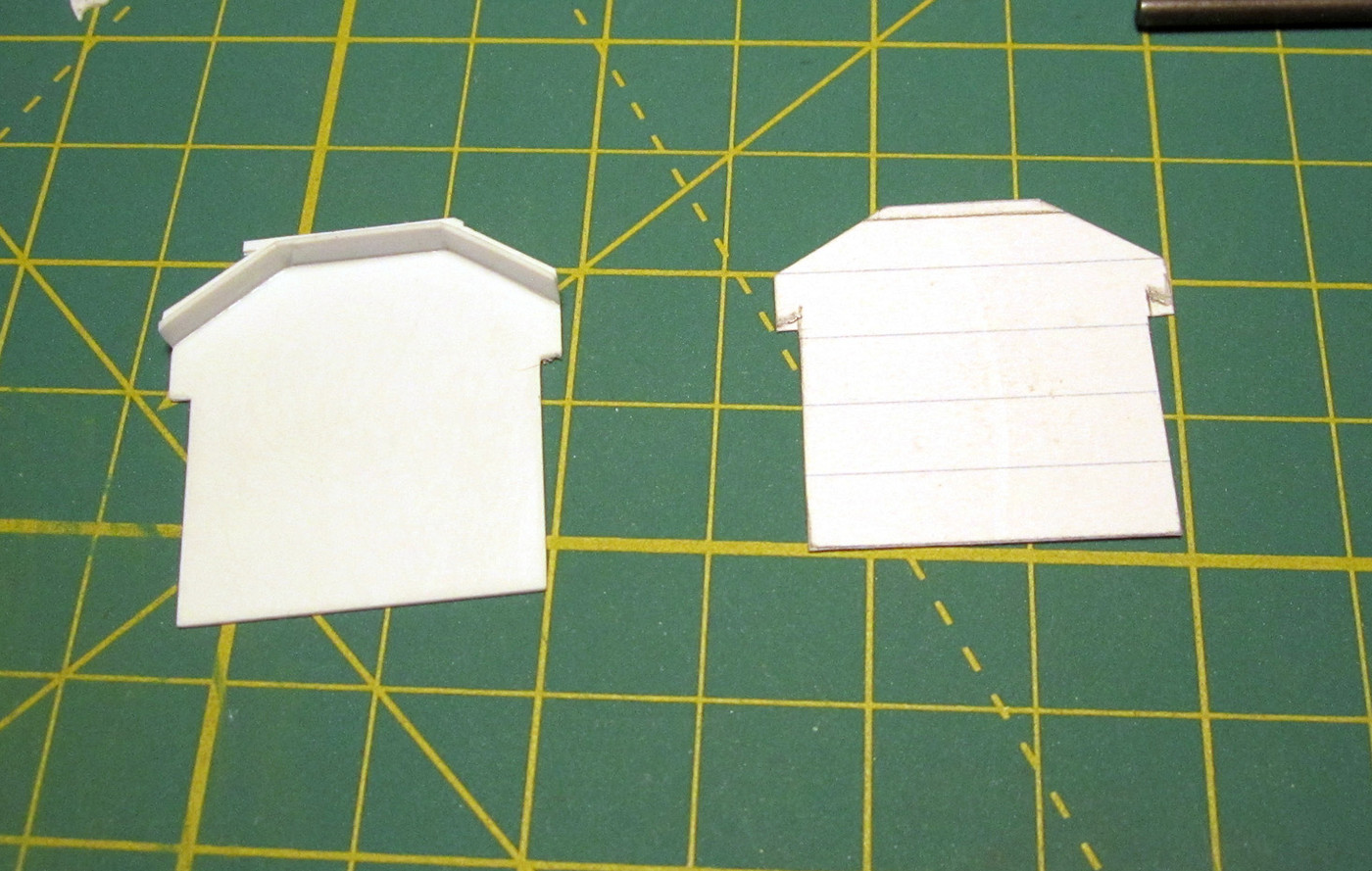

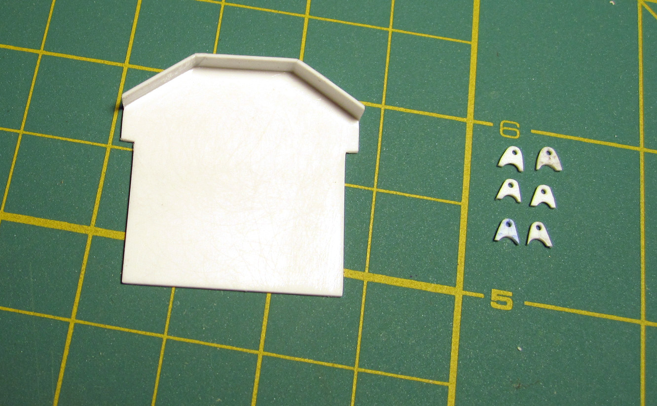

Mooneyzs Posted November 13, 2011 Author Share Posted November 13, 2011 (edited) So I was able to make some more progress last night and here are the pics...  Here is the back motor mount plate that attaches to the back of the engine block and what the bell housing mounts too. I decided to scratch build it since it was a little different shape than what comes with the kit. I first made a template from a 3x5 card and then transferred to sheet plastic and cut it out:      Here are the mounting tabs that will be glued to the chassis. Only 4 of them will be used. I had made an extra set since I wasn't happy with the first set...lol :     Added the top portion to the engine mount plate:  Edited July 24, 2017 by Mooneyzs Quote Link to comment Share on other sites More sharing options...

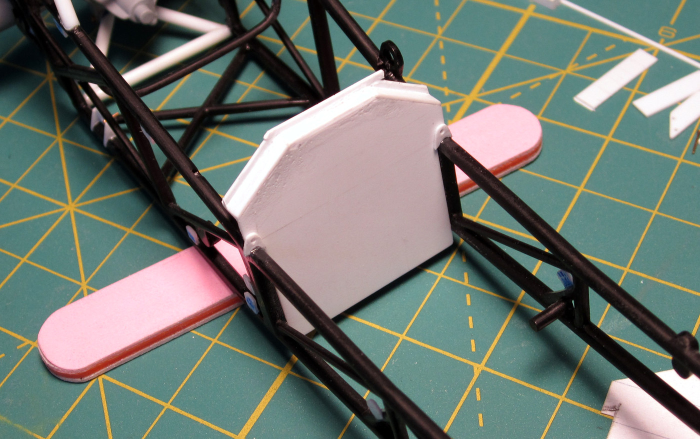

Mooneyzs Posted November 13, 2011 Author Share Posted November 13, 2011 (edited) Here is the engine mount plate with a flange that I added to that top portion, I should get a better pic from the other direction so you can see what I was talking about: Â Â Â Â Â In this pic I added the rear Engine Mounts to the chassis. Glued them with Weld-On #3 and let sit over night: Â Â Â Â Â I placed the motor mount plate in place to see how it lined up with the engine mounts. I now need to transfer drill the holes for the bolts to go thru as well as I am thinking of making brackets and gluing toward the bottom of the plate/Chassis and having mounts there too: Â Edited July 24, 2017 by Mooneyzs Quote Link to comment Share on other sites More sharing options...

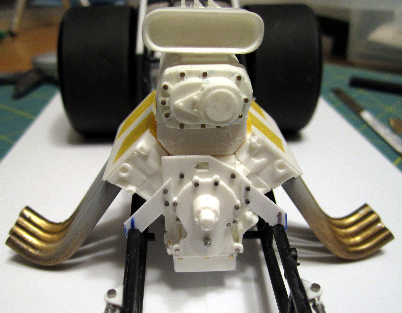

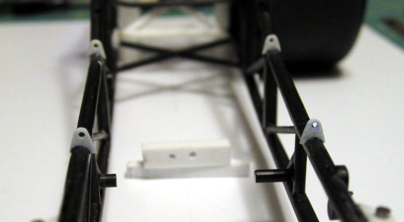

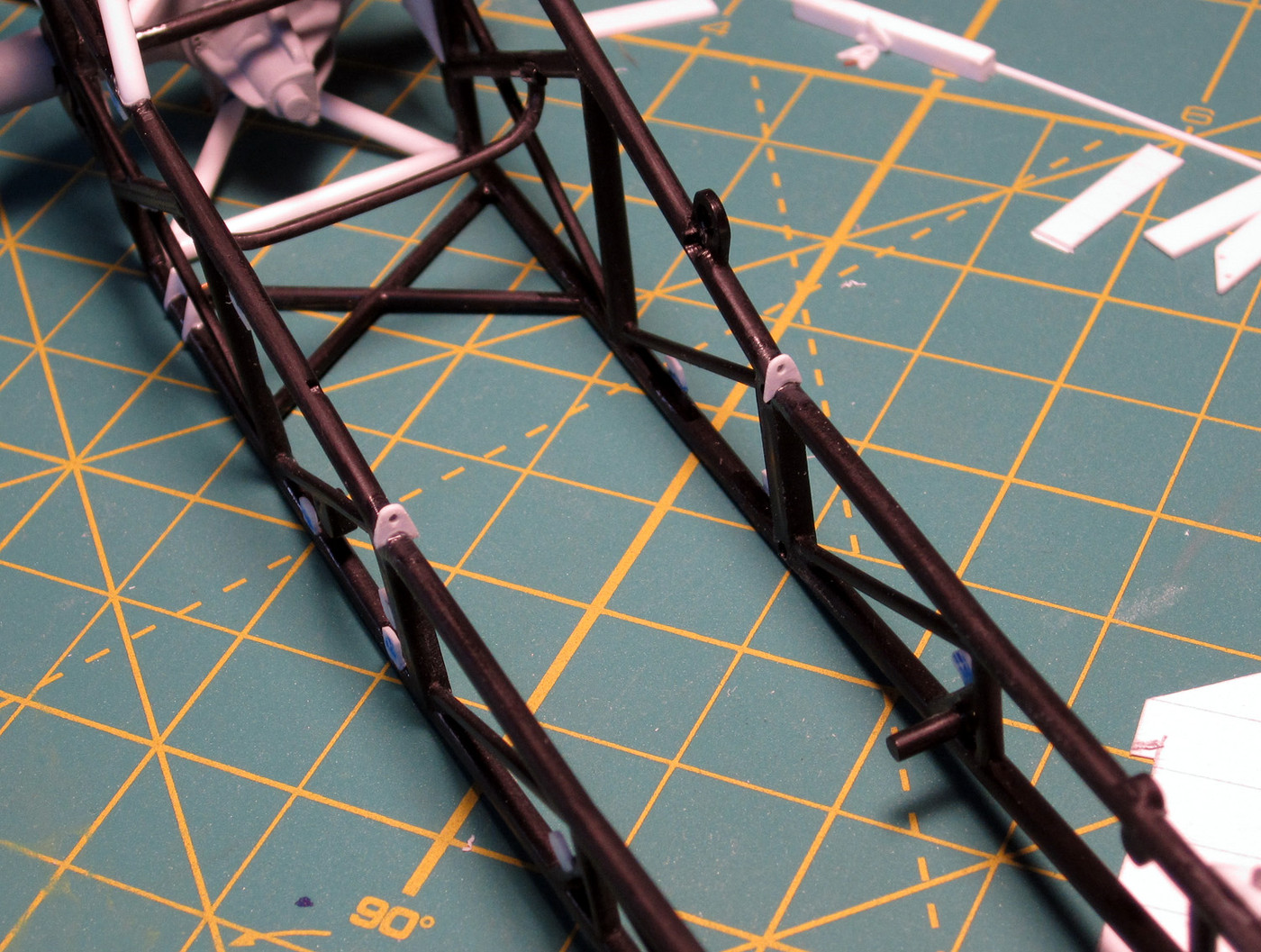

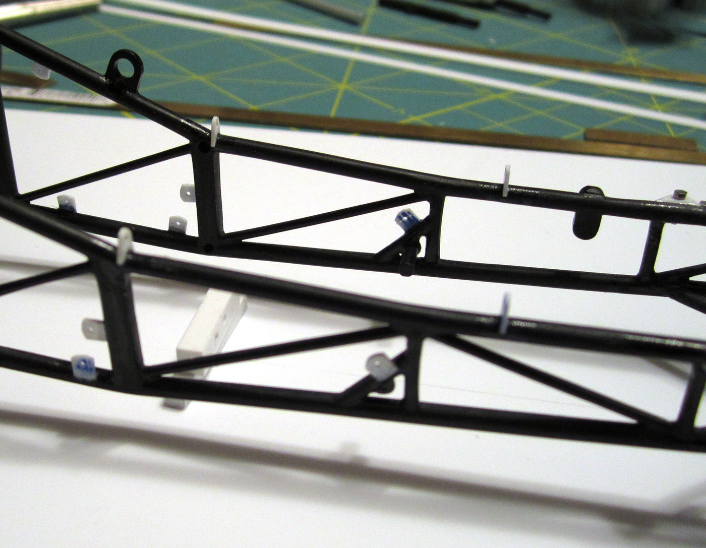

Mooneyzs Posted November 14, 2011 Author Share Posted November 14, 2011 (edited) Thanks Joe   So I did a little more tonight. I got the front motor mount tabs glued to the chassis and made some new motor mount brackets out of thinner plastic. Once the tabs that I glued to the chassis are fully cured I will go back and sand them down to make them fit the tubes a little better.Here are a couple pics. Sorry that they quality of pics aren't as good but I was kind of rushing since I need to head to bed.  Here is the front motor mount tabs glued to the chassis:     Side view of the tabs:     Some what of a side view of the new brackets:     Front view of the new brackets made from .020" thick plastic, which I still need to finish shaping the ends just a little. But after going back and using a thinner plastic, it looks much better in my opinion. I am still debating on possibly remaking these out of brass or aluminum:  Edited July 24, 2017 by Mooneyzs Quote Link to comment Share on other sites More sharing options...

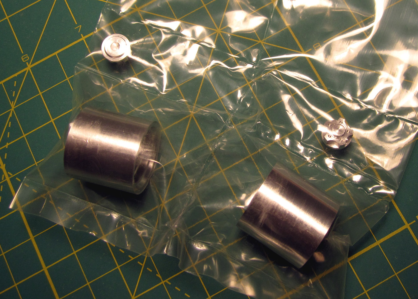

Mooneyzs Posted November 18, 2011 Author Share Posted November 18, 2011 (edited) Alright so a quick update. I received my Hubs and Rims that Jim redid for me and man did they turn out great. Jim another Big Thank You for getting these done for me. So excited to open my mailbox and they were in there. The only thing I am bummed about is my order from Micro Mark didn't get here. I am waiting on that package since it has my new tap for these hubs in it. last time I tapped the other hubs, the very last hole I rushed it and damaged the tap. Maybe it will get here tomorrow. Any way had to show you you a couple of pics from tonight: Here are the new Hub and Rims packaged from Jim aka Micro Nitro:Â Â Here I had to take the hub and put it to the disk brake and set on the axle: Here is the new position of the motor that I will be moving it to, along with making new motor mount tabs and having to reglue them as well as shorting my radius rods: Â Here is an up-close pic of the distance I need to move it. It will be moved 1/2" forward which is 8 scale inches: Â Edited July 25, 2017 by Mooneyzs Quote Link to comment Share on other sites More sharing options...
