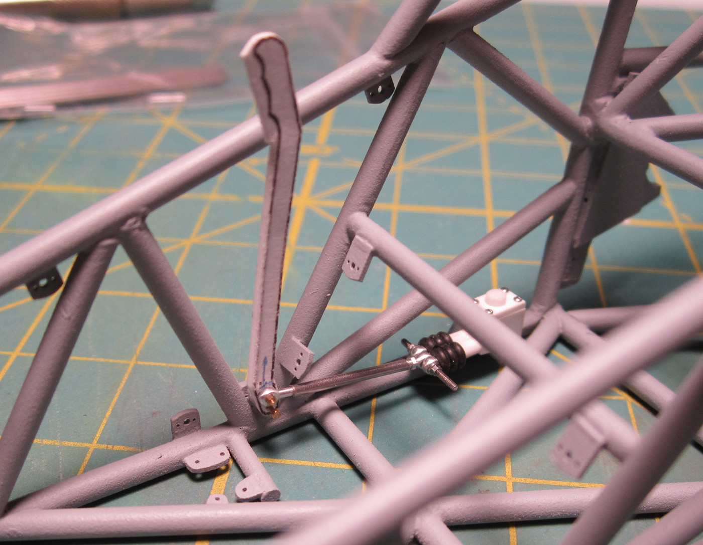

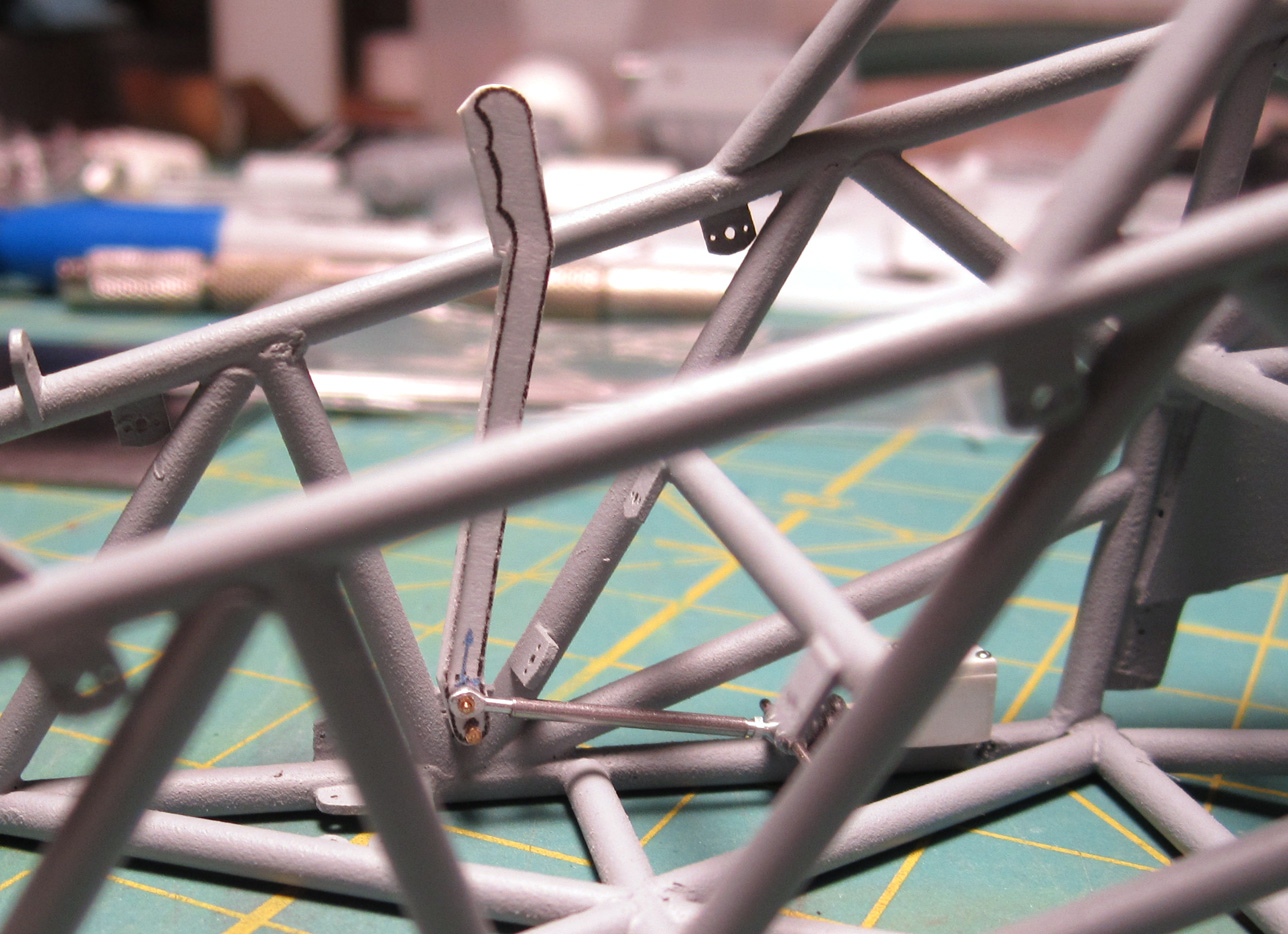

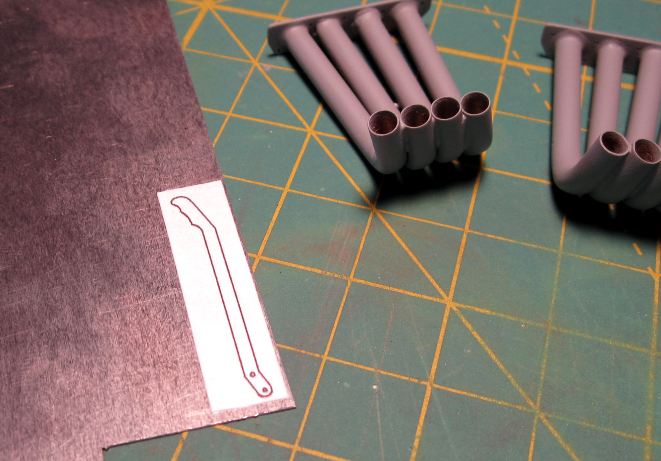

Mooneyzs Posted September 15, 2012 Author Share Posted September 15, 2012 (edited) Good Morning Fellas.... well last night I was going to post a teaser pic but couldn't get it to upload on photobucket. I just tried again and it worked. I was working on the brake handle and some more of the break system. It not much at the moment but what you see is a template which I will be making the part out of .016" thick aluminum plate which will be 1/4" thick in real life. Let me show you the couple pics, then its time to go get some Ice coffee from Dunkin Donuts and then start working on this build all day. Also Keep in mind that I will be changing the master cylinder to a single piston unit and I am actually going to make the brake handle a 1/6th of an inch taller. Stay tuned.... Here is the brake handled that I have drawn up on my CAD program and then laid it over plastic and cut away. As you can see I didn't fully cut the handle portion since I was trying to gauge for the height and over all appearance of it. Will change it with the new one. Another View of the handle where you can see I am using RB Motion Rod ends and tubing for the rod that goes from the handle to the master cylinder: Edited June 19, 2020 by Mooneyzs Quote Link to comment Share on other sites More sharing options...

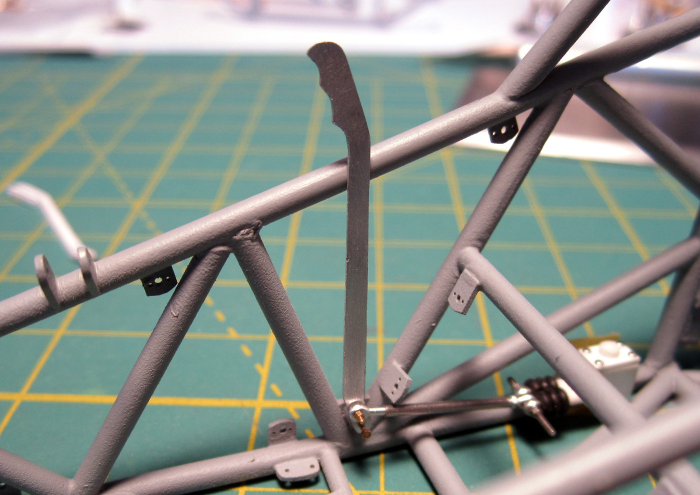

Mooneyzs Posted September 15, 2012 Author Share Posted September 15, 2012 (edited) More Updates on the brake system..... I have finished the brake lever and happy with it. Took me a little longer than I though but was worth it. Here is the start of scratch building it. Drew it up on Solidworks, Printed it 1:1, cut it out and glued it to my sheet aluminum and then Scribed and used a razor saw to cut it out: Here it is after I was done cutting and sanding. Set it next to the plastic template I did first: Then I had to mock it up to see how it looked with adding an extra 1/16th of an inch to the length. Think its a perfect height now: Edited June 19, 2020 by Mooneyzs Quote Link to comment Share on other sites More sharing options...

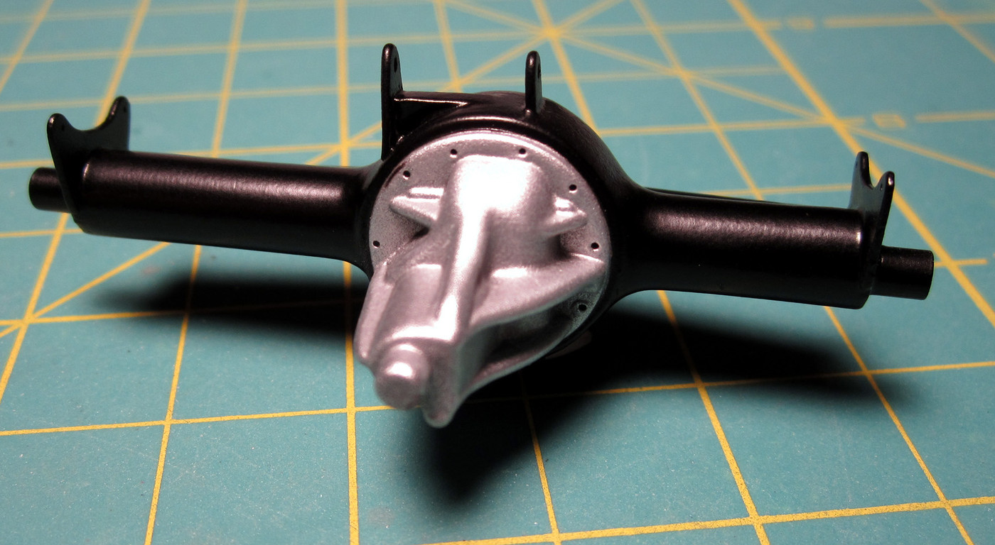

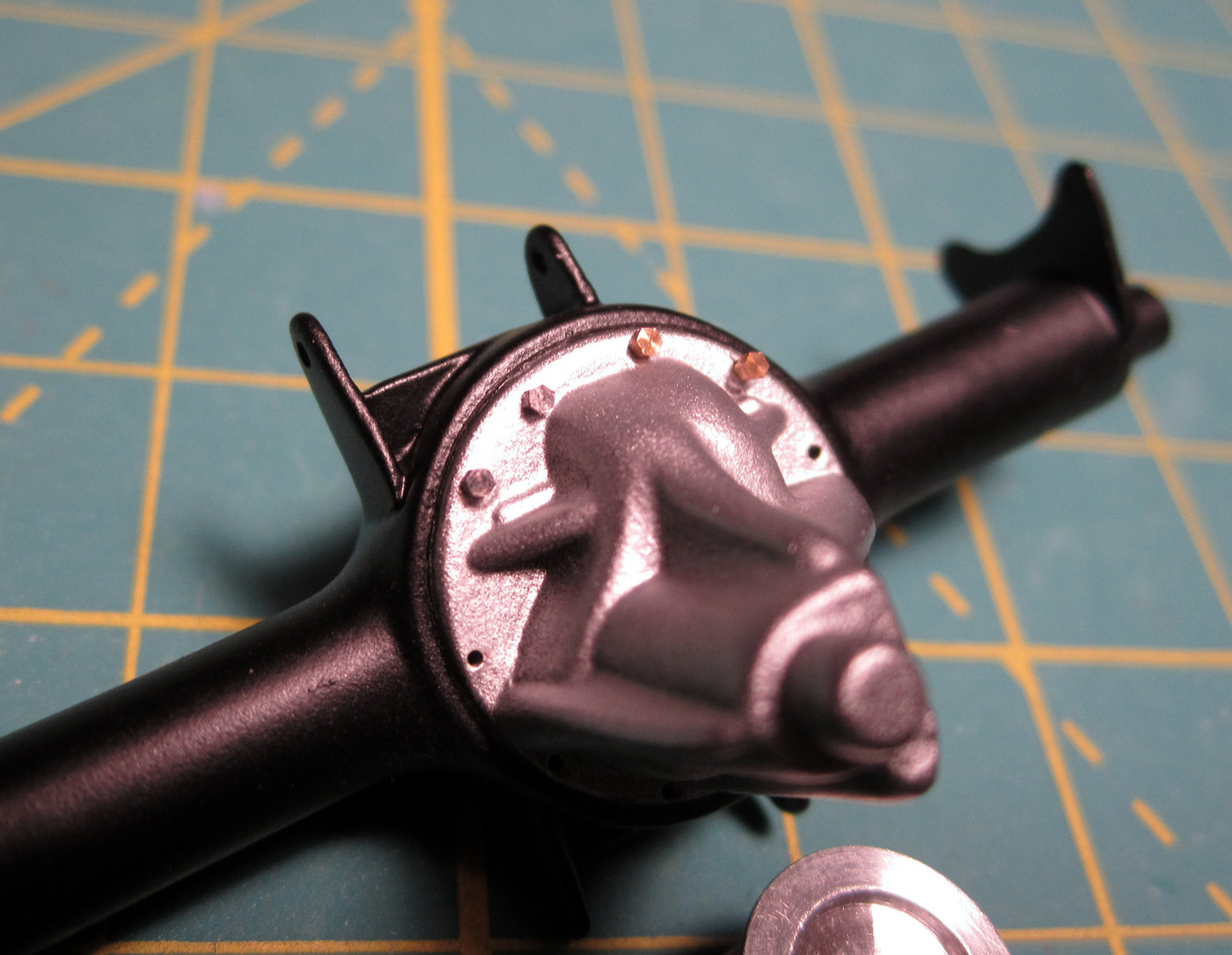

Mooneyzs Posted September 29, 2012 Author Share Posted September 29, 2012 (edited) Hey Guys.... thanks for all of the kind comments. I know I haven't posted much lately but I have been getting some parts repainted this past week and well I need your help at the moment. I have stuck two different bolts in on the rear end and trying to figure out which looks best.... the Nickle plated bolt or the brass bolts on the 3rd member of the rear end. Let me know which you think is best. Also note that this is the last time you will see the rear end before the rear end assembly is completed. I will be gluing the disk brake and hubs to the rear end as well as installing the brake line, calipers and the few other details this weekend. So stay tuned but here is a pic of the bolts. Let me know which you think looks best.... Thanks! Edited June 19, 2020 by Mooneyzs Quote Link to comment Share on other sites More sharing options...
vintagedragfan Posted September 29, 2012 Share Posted September 29, 2012 NICKLE hands down Chris! generally you don't see many brass bolts in 1:1 automotive applications except for fittings and such, they are used in marine applications occasionally for corrosion resistance , I think the nickle looks more like it would have been on the real deal, brass bolts generally aren't as strong as a steel bolt that has been hardened, keep up the fabulous detailing my man! Quote Link to comment Share on other sites More sharing options...
Mooneyzs Posted September 29, 2012 Author Share Posted September 29, 2012 Bill thanks man.... I was thinking the same thing. but the brass could kind of be like grade 8 bolts how they have the yellow zinc plating . Quote Link to comment Share on other sites More sharing options...
Alyn Posted September 29, 2012 Share Posted September 29, 2012 Bill thanks man.... I was thinking the same thing. but the brass could kind of be like grade 8 bolts how they have the yellow zinc plating . I was going to mention that too, Chris. The yellow zinc plated grade-8 bolts are as common as mud. I'd be more concerned about the style rather than the color. These drop-in center sections usually slide over threaded studs and then secured by nuts. The bolts just don't look right. Awesome work by the way. This is going to be a great resource and reference thread for years to come. Quote Link to comment Share on other sites More sharing options...
MoparWoman Jamie Posted September 29, 2012 Share Posted September 29, 2012 Nickle.. looks more like what you would see on the real deal. Quote Link to comment Share on other sites More sharing options...
Mooneyzs Posted September 29, 2012 Author Share Posted September 29, 2012 (edited) Alyn... You are right. I had over looked the detail of the studs in the rear end. So I pulled out some of my Simulated Hex nuts from Scale Hardware and swapped them out. But I am thinking of going with the threaded stud and nuts, shown just below the rear end. I just don't have enough of them to do the whole rear end at the moment. Looks like I may have to place another order to Bob at Scale hardware. Thanks for the compliments about this build. It means a lot. Jim... Thanks man. I have to agree with you. Edited June 19, 2020 by Mooneyzs Quote Link to comment Share on other sites More sharing options...
jasoncamaro Posted September 29, 2012 Share Posted September 29, 2012 Chris looks awesone i think you should just run with the simulated nuts and tread usually there is bugger all thread on a stud when the nut is on and the ones you are using look perfect Quote Link to comment Share on other sites More sharing options...
vintagedragfan Posted September 29, 2012 Share Posted September 29, 2012 there you go Chris, thats perfect, Alyn is right, That is the correct way it should be, worked out great that you had just enough layin around to get it done! very nice! Quote Link to comment Share on other sites More sharing options...
gasser59 Posted September 29, 2012 Share Posted September 29, 2012 Those look perfect Chris. I like them much better with the studs showing. Quote Link to comment Share on other sites More sharing options...
John Teresi Posted September 29, 2012 Share Posted September 29, 2012 Those look perfect Chris. I like them much better with the studs showing. x2.....yep,looks like the real deal.....AWESOME work Chris. Quote Link to comment Share on other sites More sharing options...
Prostreet Posted September 29, 2012 Share Posted September 29, 2012 Definatily the studs, what size are the studs and nut Chris? Quote Link to comment Share on other sites More sharing options...
