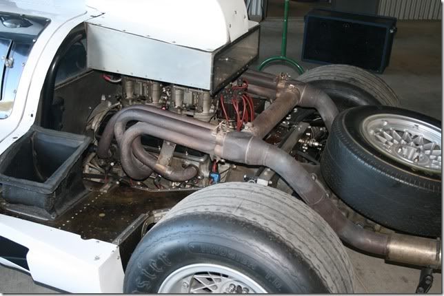

Here's a pic. I think this is the 2 speed.

That is fantastic on the engine! It is already wired, just need to modify the manifold and set the weber carbs upright. Being the I work in an aerospace parts manufacturing plant I am thinking about machining the tall stacks for it out of aluminum and then painting them the right color. But I also am thinking of using aluminum tubing from the local hobby shop and swedging them out.

I have the pics he sent in the email, how would I go about posting them from my iPhone?
Here in bit (dinner time now) I will try a few things and see if I can get them on here since they are saved in an email.

Let's see if this works.

Sweet!
