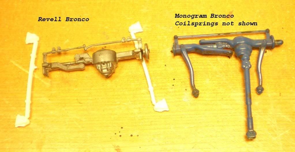

RodneyBad Posted April 24, 2011 Share Posted April 24, 2011 Here are 2 choices for Front suspension There is a 3rd which is MPC 80s Ford Bronco Sorry, no pics for that. Shouldn't be to hard to come by and with a Lil Modification, would work just fine. Quote Link to comment Share on other sites More sharing options...

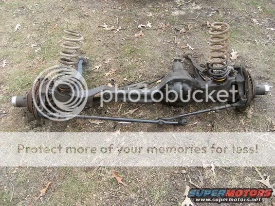

highway Posted April 24, 2011 Share Posted April 24, 2011 your close but no. i got a eddie burre model and the bumper does have strip but it has two holes in the center a rectange shape hole. Oh, I know which bumper you mean now! I think they used that style on the diesel equipped trucks, too. It should look like this one. I also found this pic that might help you for the front axle detail, too. Quote Link to comment Share on other sites More sharing options...
Guest Posted April 24, 2011 Share Posted April 24, 2011 The AMT or MPC Bronco would give you the best front suspension for your model. The Monogram Bronco is 1/24 which would make it too wide,but you could narrow it by simply cutting the stubs off of the wheelbacks to narrow the track. Even with the Revell TTB (which is 1/25),you could still use your radius arms and coils from your 2wd kit I would think. The front bumper with the rectangular holes in it must have only came with the LWB. The Lightning and Flareside came with solid bumpers,but have the rubber strip also. I have the LWB built,but haven't looked at it in years. Try putting up a wanted ad for your parts. Someone may have them rattling around in a box. Quote Link to comment Share on other sites More sharing options...
Casey429 Posted April 25, 2011 Share Posted April 25, 2011 (edited) The LWB kit has the same bumper as the Lightning, Flareside, and SWB kits. The bumper on the Eddie Bauers is in fact the same as the diesel trucks. Also, for '96 all trucks and Broncos came with the diesel bumper. Instead of making multiple bumper types, they made just the diesel one that year since they were getting ready to produce the new body style for '97. I'm building a replica if my 1:1 '94 and I used the Monogram parts since i had them laying around. I grafted on the spindles from the AMT 2wd suspension so the wheel mounting points would stay the same. This also allowed the use of the AMT radius arms. I also added some bits of aluminum stock to replicate the 4x4 front hubs. I added a decal of a Warn hub to the end, since I swapped them for the automatic hubs on my real truck. I also made my own coil springs and added some parts box shocks since mine has the quad shock option. No, my truck does not have an oil leak, but the position of the oil filter makes it near impossible to not spill it when I change oil. Edited April 25, 2011 by Casey429 Quote Link to comment Share on other sites More sharing options...
