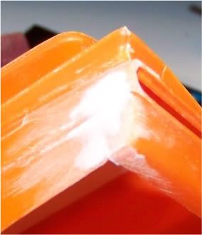

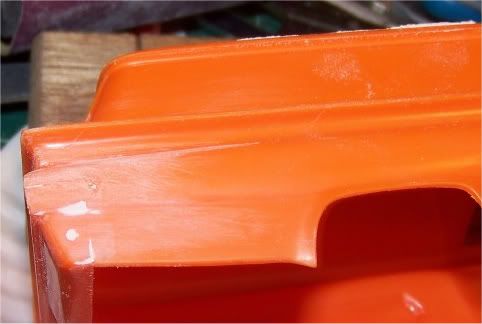

scalenut Posted May 5, 2011 Share Posted May 5, 2011 (edited) here's a tip....that bondo glazing and spot putty is designed to go on top of primer it's designed to work with and bond to primer ,, not raw plastic. It might work ok but thats not how it's meant to work. I use the non hardener type exclusively, as intended<< and have never had any issues with it in 8 yrs. On putties, definately go with a two part putty over a one part. No matter which you choose, it is going to have an odor. Do not waste your money on Evercoat!!!!! Don't get me wrong, it is the best two part putty on the market for autos, but it is also the most expensive. I used it for many years doing bodywork on 1/1 cars & trucks in my job, & agree it is superb, but it's really not worth the money for using on models. You run the risk of it going bad before you can use it all, no matter how tightly you seal it, & at an average of $40 a can, that's an expensive loss. I know, it's gone bad on me before Here's what I'ved used on models for a few years now & recommend without hesitation, Bondo two part Professional Glazing & Spot Putty: It's nearly as finely grained as Evercoat is, so it sands & feathers out just as easily. At $7 a tube, it's also cheaper, & depending on how much bodywork you do, a tube will last at least a year or longer. Make sure you get the one marked "Professional Glazing & Spot Putty", as it is a two part putty & will have the small tube of hardener in the package with it. Most any auto parts store will carry it, & some WalMarts do as well, in their automotive section. Take it from someone with several years real life experience with Evercoat, for models, it's really not worth the money. As to any one part putty, I don't recommend any of those. They are basically thickened lacquer primer, thus they dry by solvent evaporation, so you run the risk if it shrinking even after you complete the model. I've also had the one part putties attack the plastic before, due to the lacquer content. Here's a couple of photos of the two part Bondo I use before & after sanding; Before: After: Edited May 5, 2011 by scalenut Quote Link to comment Share on other sites More sharing options...
