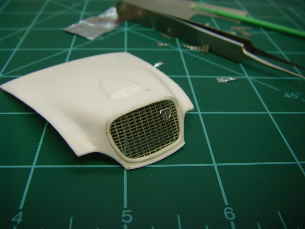

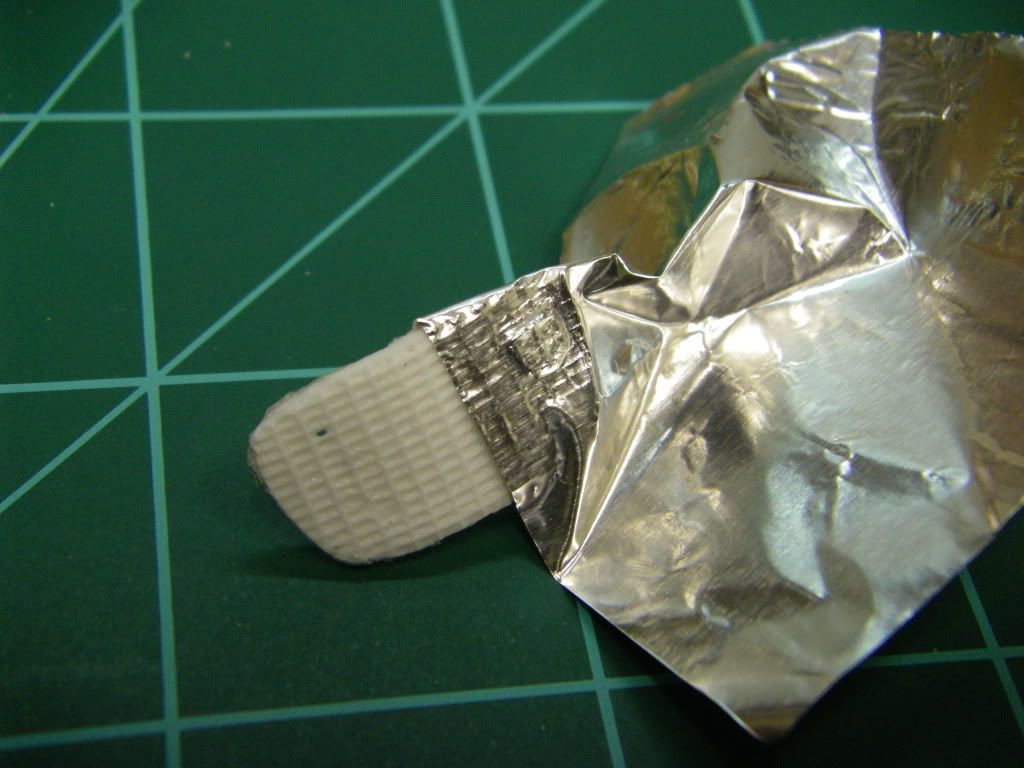

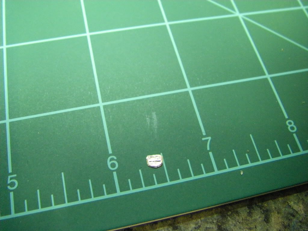

Indeed you do but it will be a while before it's finished. It's a '56 and loosely (and I do mean loosely) based on the R&R resin kit. A lot of stuff has to be scratch built or completely redone. Here's some teaser shots of the Packard 352 Sky Power in progress:

Ahhh Okay! I have one of his Hawks also and yes, a number of things need to be done to make it accurate. Fortunately, I have a Packard engine in scale that came from a resin '55 Packard convertible kit which I may never build.
If I do build it, it would be a curbside since that car's appeal is in its styling more than the engine.
Is your engine based on the 259 V8 that came out of the '53 Stude kit, or is it based on something else? Also which set did the PE come from for the grille? I have a '58 Golden Hawk (which I'd like to get to redoing sometime) that could use a PE grille like that.

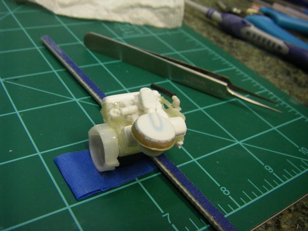

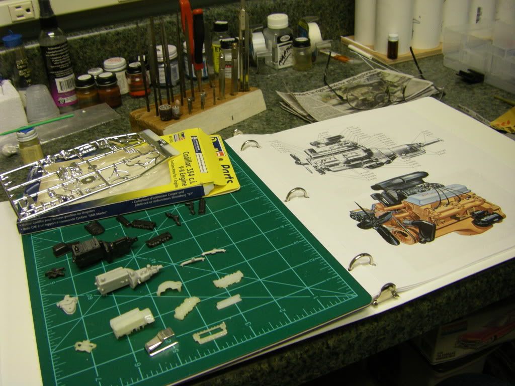

The engine has the block, heads and water pump from Revell's Parts Pack Cadillac with the starter and fuel pump moved to the opposite side and there are parts from '59 Cad, Chevy 396, Avanti 289, Parts Pack 283, and the air cleaner is just all kinds of bits and pieces - some of it actually glows in the dark! A real Frankenstein. I didn't know there had ever been a resin (or styrene) Packard V-8!
The PE grill is from Model Car Garage:
http://modelcargarag...5&idproduct=377
The '55 Packard resin kit was cast in very limited numbers by the late Ed Fluck of F&F Resin. I've had it sometime since the late '90's, and it's not a bad casting at all..........just needs some cleanup to be nice.
Now that I see what you used to make your Packard engine, I may keep that resin one with the Packard, and make mine out of those parts! :unsure: Thanks again for showing how you cast that emblem for the hood..............Ray gives you a rather rudimentary grille with not much detail as far as the grille pattern.
If/when I ever get around to building my '56 Hawk, I've definitely saved this tip! Also thanks for the link where I can get that PE. ;)
