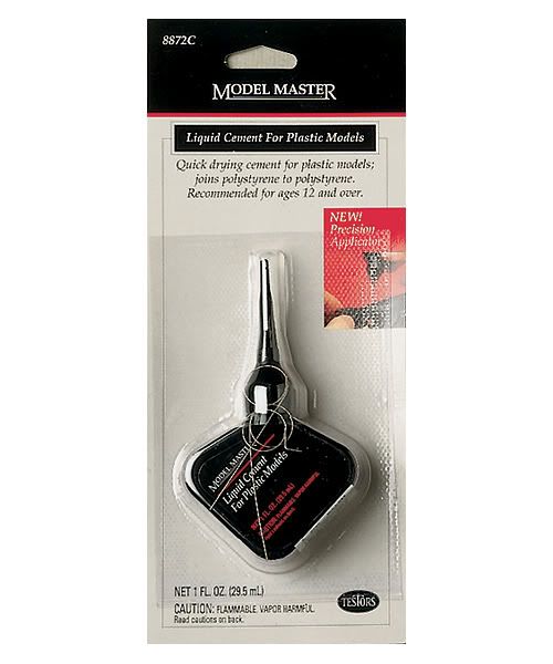

I get the idea of mixing glues for an in-between consistency, but, isn't that exactly what Testors Liquid Cement is?
In any case, I'd never let the old tube glue in my house to start! : :)
