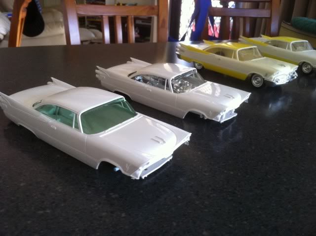

Hypermung Posted September 17, 2011 Share Posted September 17, 2011 Hi Guys. Now I (sort of) know how to post pix, I'm going to share the progress on a build I've been collecting bits for, for a few years now & only recently started. Please excuse me if the text is a bit fragmented, but I'm still learnin!. There's upteen threads on Mustangs, Chevys, Batmobiles, dozens of General Lee's, etc, etc, but I've only seen 1 other thread on a 59 Dodge & that was a very nice wagon in April last year, so I thought I'd get you all 'Forward Looking' & show you what I consider to be one of Virgil Exner's best designs. The 1959 Dodge Custom Royal Lancer body is not an original Johan issue (that are prone to warpage issues), but the later 80's Excell re-issue kit with the better plastic throughout. As this is only a kerbside kit & I want total detail throughout, the first order is to open the hood up. Easier said than done though as the plastic towards the bend of the hood is at least 1/4" thick (they must have hung them by the back or something?)Noticed the AMT 58 Plymouth in the background?. Well, the Dodge needs an engine bay & chassis detail, & as I haven't found a 59 Mopar with under hood detail, a 58 will have to do (not quite 'correct', but near enough). I'll modify it to suit the 59. Quote Link to comment Share on other sites More sharing options...

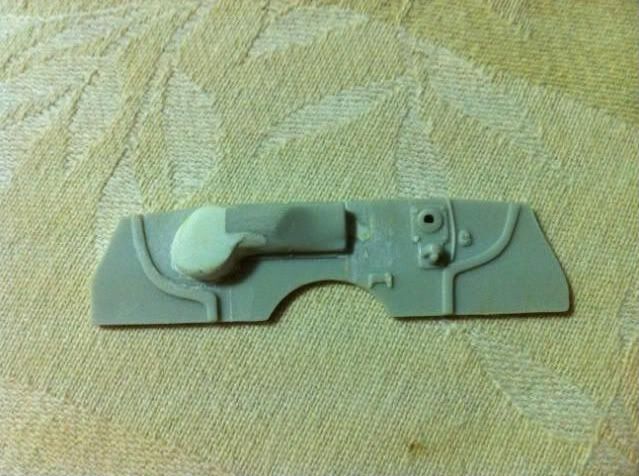

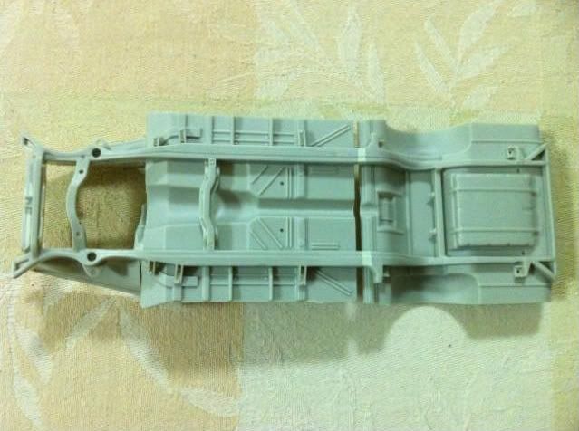

Hypermung Posted September 17, 2011 Author Share Posted September 17, 2011 Two issues I had to deal with straight away, were the firewall & chassis. The 58 uses a different heater box. Similar, but different. So I cut the motor part off the end & the other end got shaved as well, then used some model putty to rough out a correct 59 heater box. It still needs heaps more work, but at least it's sort of the right shape. Now the chassis. The AMT Plymouth has wonderful chassis detail almost identical in every way to a 59 Dodge, except the Plymouth has a 118" wheelbase, & the Dodge uses a 122" wheelbase. So I cut the chassis & floor pan just before the rear wheel humps & spring perches, & extended the chassis to 122" (scale). More putty to finish the chassis join nicely. Quote Link to comment Share on other sites More sharing options...

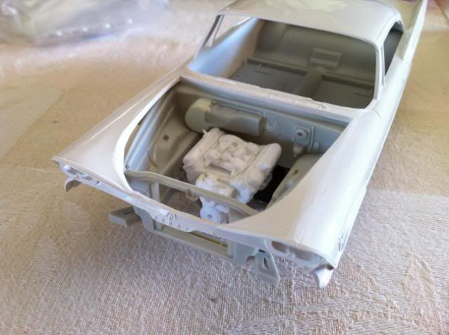

Hypermung Posted September 17, 2011 Author Share Posted September 17, 2011 Here I've test fitted the engine bay to the chassis. The engine bay itself is going to need a lot of sanding in the appropriate area to get it fitting under the body nicely.. Early days yet. Quote Link to comment Share on other sites More sharing options...

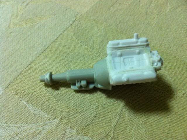

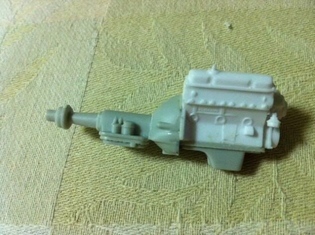

Hypermung Posted September 17, 2011 Author Share Posted September 17, 2011 Attention turns to the basic engine. The 58 Plymouth's engine seems to be a curious mix between an early Mopar 350 big block, & a later 318 poly engine? Perhaps Revell used something that was already modeled previously? Anyway, this is going to be a model of the rare D-500 option which used the (as then) NEW 383cu big block. I sourced a few kits for a '383' & found a couple of nice examples, but decided to go for the Revell 68 R/T Charger kit as this one comes with both a Hemi & a 440 big block. The 440 is almost identical to a 383 externally, so I decided to go with this & modify the 440 to emulate the 383 (& then I've still got a Hemi to complete the 68 R/T someday). The 58 Plymouth's engine was cut from the Torque Flite transmission, & the 383 (440) was mated to the tranny. The sump from the 58 Belvy was also used so the engine / trans combination will fit the front crossmember correctly. Then we can test fit the whole package for the first time. Quote Link to comment Share on other sites More sharing options...

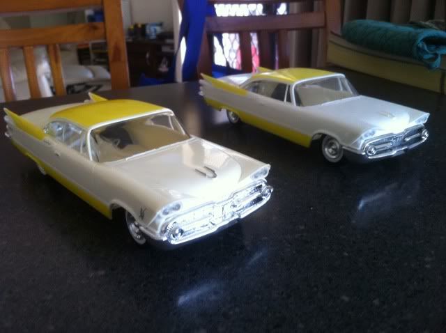

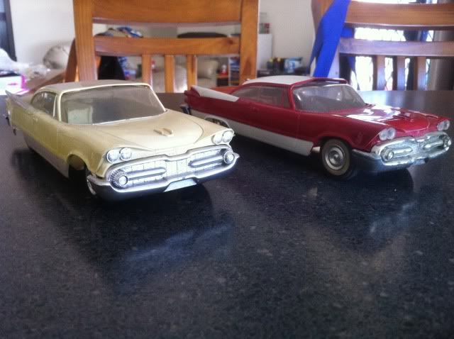

Hypermung Posted September 17, 2011 Author Share Posted September 17, 2011 Very nice work on your research of the engine and trans. You appear to be on the right track and may produce the first 1950's vehicle for this build off as it appeared out of the showroom. My hat's off to you. If you need reference pics, pm me. Thanks for the encouragement Guys. It's very appreciated. I don't need reference pix thanks as I can always go to the shed to reference my 1:1 Very rare kit you are building. Your progress is looking very good so far. Keep up the work I have been collecting 59 Dodges for a number of years now. I still have in my stash 2 unbuilt re-issues (1 with the uncommon green tint 'Solex' glass), & 2 factory assembled re-issues. I also have a number of Johan originals... I guess you could say I love my 59 Dodges Quote Link to comment Share on other sites More sharing options...

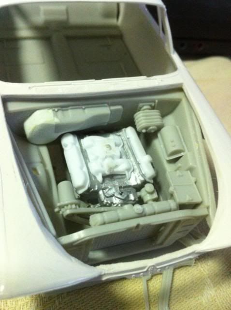

Hypermung Posted September 18, 2011 Author Share Posted September 18, 2011 Another update: I've used the fan belts, generator & power steering pump from the 58 Belvy kit on the '383'. Also test fit the radiator, battery & power brake setup. It all appears to fit ok @ this stage. The gaps on the edge of the engine bay will be filled with some sheet styrene to mate it to the body when it finally goes together.Lookong fairly close to the real thing Quote Link to comment Share on other sites More sharing options...
