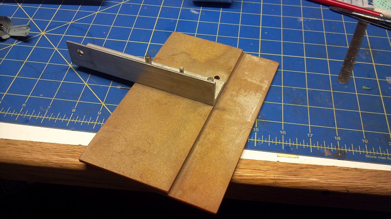

I made a right angle sander for squaring off the ends of strip, rod, square, hex or any other shaped platic. I've never seen anything that works better than this if you want a perfectly squared off end on a piece of plastic! I had a piece of phenolic resin type plastic laying around so I used that as the base. Just laid one piece on top of the other and then attached a piece of angle iron made of aluminum at a right angle. To keep it square I drilled 2 holes and pushed in a couple of steel dowel pins. That way, if I ever want to set it up at an angle I can get it back to perfectly square in a few seconds.
Here's one view of it....
Sander2-vi.jpgHosted on Fotki
And here is how it's used. You can use anything you want to do the squaring...sanding block..piece of sandpaper wrapped aroun a block of some kind...a file..whatever. In the photo I'm using one of my homemade sanding sticks as described in my previous post. Keep in mind that you need to use your left hand to hold the piece of plastic up against the angle iron and also give it some pressure forward to the sanding block. I had to use my left hand on the camera for this photo...
Sander1-vi.jpgHosted on Fotki
