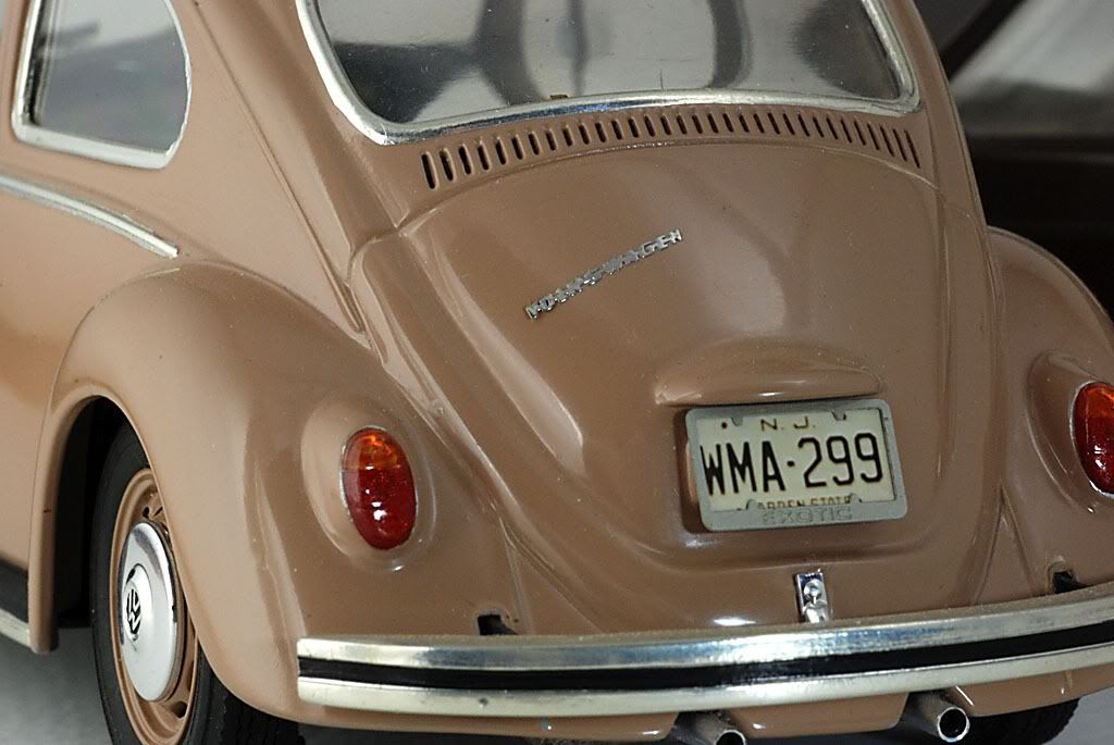

I'm throwing a pic of the first airbrush paint job I ever did when I got back into modeling about 20 years ago. It's some Testors enamel form the small jars which matched the tan of my wife's VW closely. The air brush was the first release of Testors cheap plastic one given to me as a gift. I'm sure no lacquer was used as all I would have surmised at the time was using the enamel thinner on hand. I still get amazed how smooth this came out. I had no idea about polishing kits at the time ,,, the paint is untouched except for some wax maybe. I do love lacquer for how fast it dries, but nothing but enamel seems to come out so shiny right out of the brush.
Share this post
Link to post
Mike, many of us started this way, and then somewhere along the way we start craving more and more shine, but sometimes as simple smooth paint job will make a model look more realistic. Case in point with your VW bug there. It looks good.
