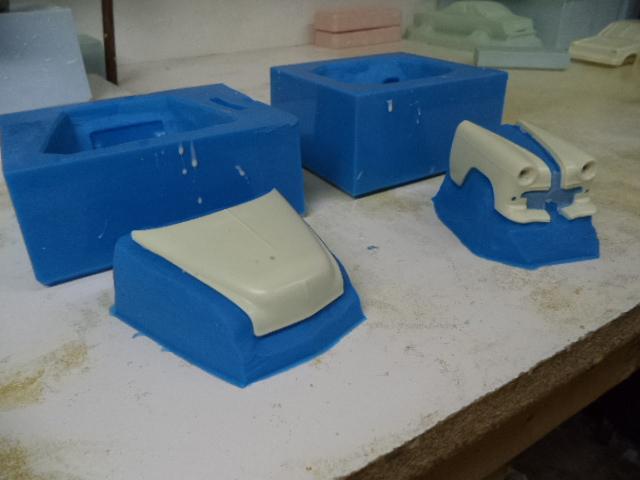

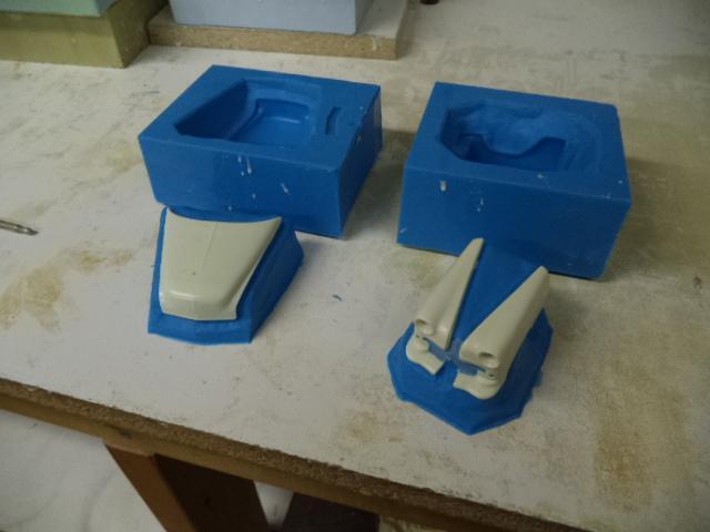

72 Charger Posted December 15, 2015 Share Posted December 15, 2015 Will you be getting the whole body cast once you have done all the correcting of the body ? Fantastic work BTW ....! I never knew that the body was that bad Quote Link to comment Share on other sites More sharing options...
Scott Colmer Posted December 15, 2015 Share Posted December 15, 2015 Great upgrades. I also had no idea about that body being so off base. Quote Link to comment Share on other sites More sharing options...
Mr. Metallic Posted December 15, 2015 Share Posted December 15, 2015 Nice job going the extra mile to make it accurate. since he went through the trouble of making those molds maybe copies would be available? Quote Link to comment Share on other sites More sharing options...
Greg Pugh Posted December 15, 2015 Author Share Posted December 15, 2015 I'm sure he wouldn't mind doing a couple extra pieces seems how the mold is ready to go. I kicked around the thought of casting the entire body once it's done but there would have to be enough interest in it to make it worth it. It's quite a bit of work. Quote Link to comment Share on other sites More sharing options...

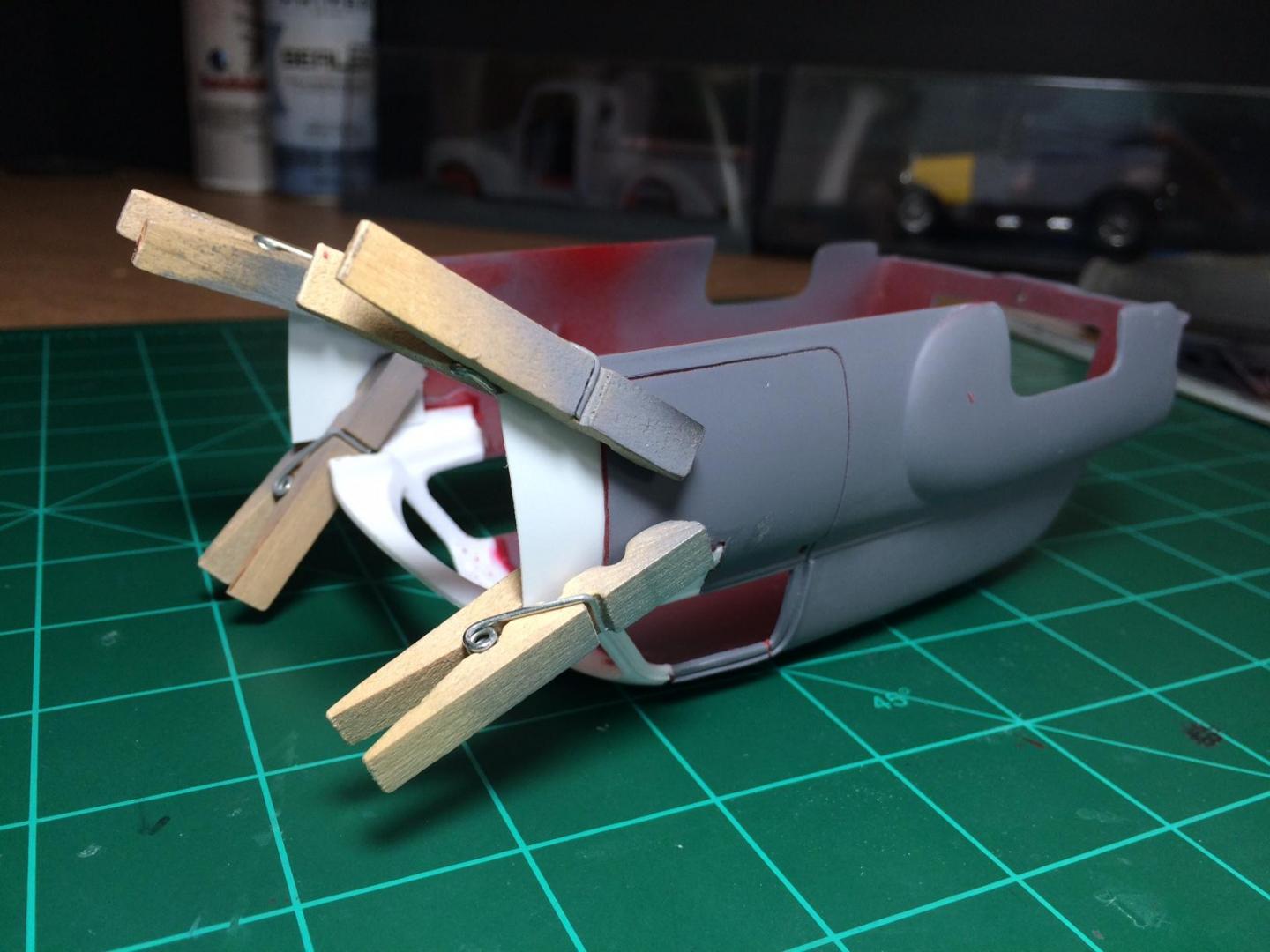

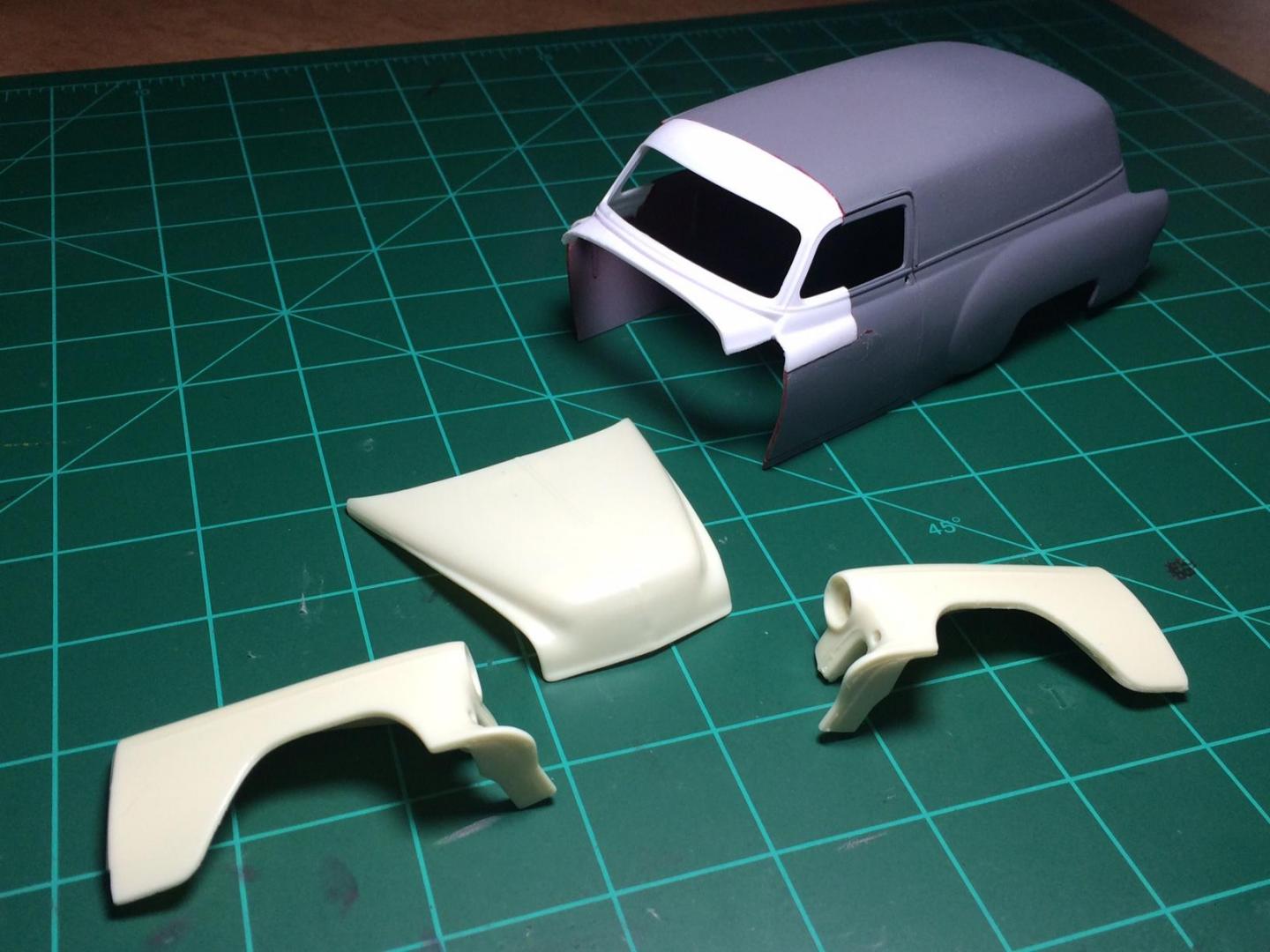

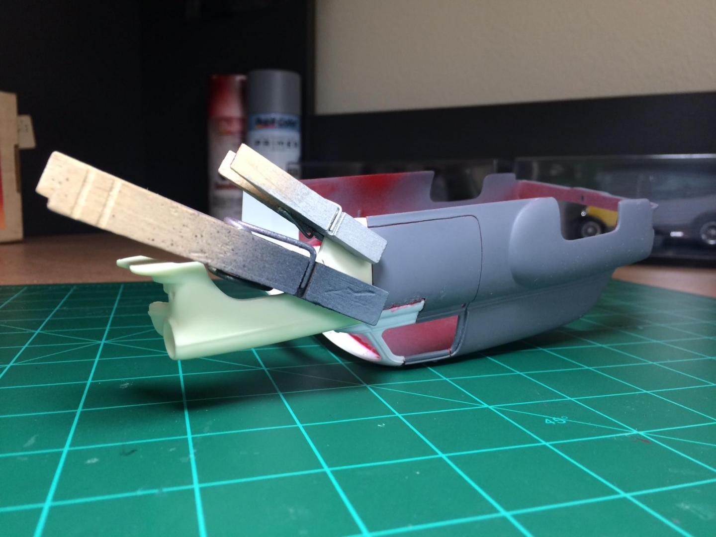

Greg Pugh Posted December 30, 2015 Author Share Posted December 30, 2015 Got the resin pieces back a few weeks ago but have been busy and today was my first chance to play around with them. First I had to continue to clean up the fenders. Not because of the resin castings but because they were cast from the diecast pieces that needed cleaning up to begin with. As suspected, it was MUCH easier to clean up the resin pieces than it ever would've been cleaning up the diecast pieces. Once that was done, I was ready to install the fenders. I glued styrene sheet to the inside of the body to add strength to the fender-to-body joint. There was a bit of time spent making sure everything lined up but overall...it went pretty smooth. There's a lot of body work to do now BUT...it's starting to look like a car again!  Quote Link to comment Share on other sites More sharing options...

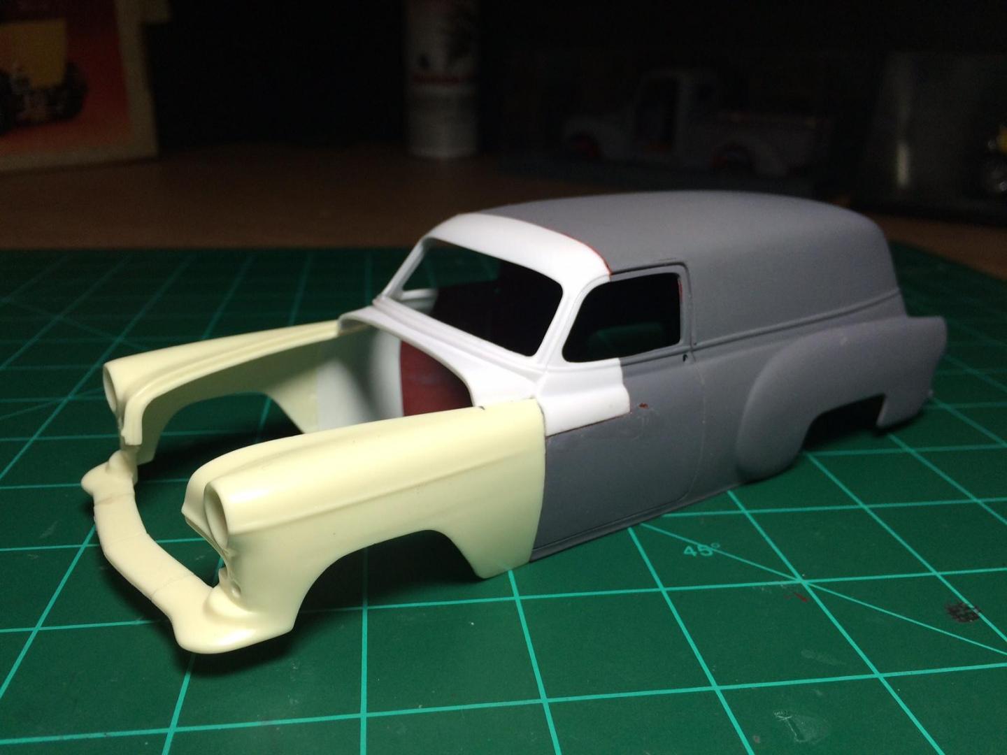

Greg Pugh Posted April 30, 2016 Author Share Posted April 30, 2016 Well, so much for getting right back on this! Lol! I've had it in my hands and in front of me probably a hundred times since my last update. I was concerned that proportionately, it wasn't jiving. But, the more I look at it, the more I think maybe I'm just going crazy. I've asked several people for their opinions and collectively, it seems like everything is just fine. So with that behind me, I'm feeling a bit more motivated on this. I ended up having to quarter the hood. I needed to use the rear section of the Olds hood and the front section of the resin piece that was cast from the diecast car. Then, I had to cut each one of those halves in two as they both were too wide. Anyways, everything is glued and roughed in but that's about all. Just like the body, I've got a lot of body work yet to do. I'm just glad to have it starting to look like something again. Quote Link to comment Share on other sites More sharing options...
