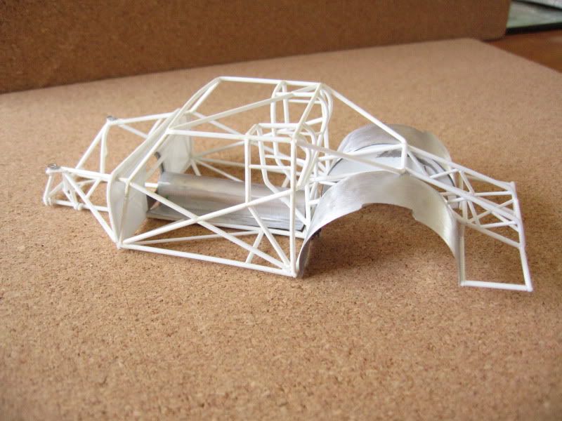

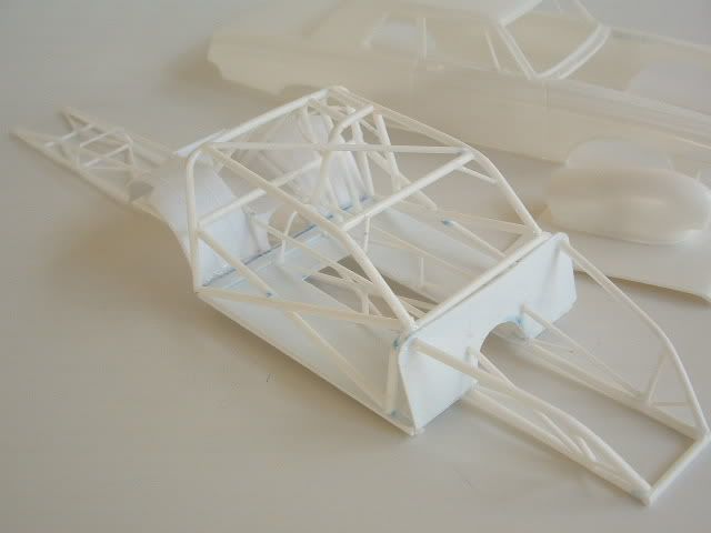

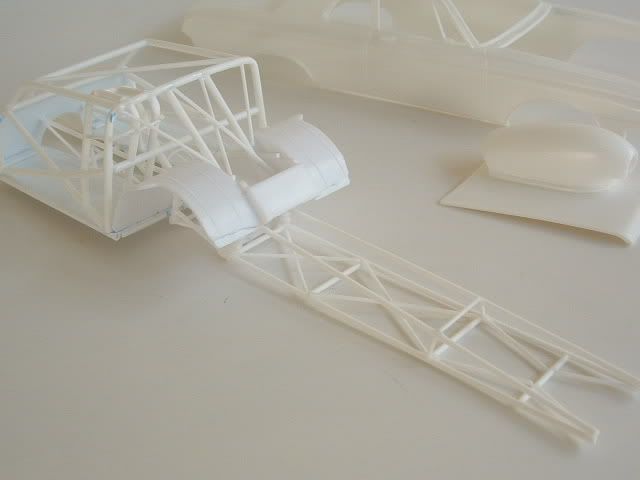

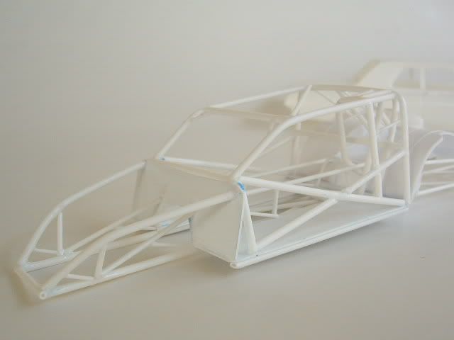

Mister Twister Posted January 10, 2012 Share Posted January 10, 2012 (edited) This is a project that I just started and there is a long road ahead but I definitely have made progress on it so far. I made the chassis except for the wheel tubs and I would have done them also but after wasting almost a sheet of plastic I gave up. I couldn't get the tubs to hold their shape at all. The next time I'll use sheet aluminum and that will remedy the problem about shaping the wheel tub. I'm in no hurry on this one. Thanks! Edited February 21, 2012 by Mister Twister Quote Link to comment Share on other sites More sharing options...

eviltwincustoms Posted January 10, 2012 Share Posted January 10, 2012 Sweet looking build, probably not my first pick for a body to do Pro Mod but very interesting subject. I know.. Wheel Tubs can be a bit tricky with sheet plastic for that specific reason, getting it to hold a nice round curve... Virtually impossible, even tried sticking it in hot water... nada, zip, zero results. My best suggestion is POP Can! It is already curved and will continue to hold that shape, and in fact it does about a scale 40" Wheel Tub for 1:1. Just add the styrene part and glue in place with JB Weld and you are good to go! Here is mine to show you. Quote Link to comment Share on other sites More sharing options...

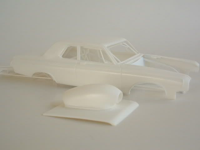

Prostreet Posted January 10, 2012 Share Posted January 10, 2012 Very nice chassis work, Who makes that snorkle? Quote Link to comment Share on other sites More sharing options...

futurattraction Posted January 11, 2012 Share Posted January 11, 2012 (edited) This will be a fun one to watch. I'll make a suggestion you can try sometime for tubs. For my original Fairmont tubs, I laminated two piece of .020" styrene sheet together and wrapped them around a larger OD socket and set them up in a fixture to hold everything together while they set up. They may not completely maintain the original shape, but having the two separate layers adhered together in an arc made them hold their shape pretty well - it certainly made them manageable to fit into the rest of the pan. Just so I don't hijack Darryl's thread, I'll post pics how I made mine in a separate thread. I'll post it in the tips and tricks area. Edited January 11, 2012 by futurattraction Quote Link to comment Share on other sites More sharing options...

Mister Twister Posted January 11, 2012 Author Share Posted January 11, 2012 Very nice chassis work, Who makes that snorkle? Joe, this is a scoop that 1320wayne poured and he gave it to me a couple of years ago. Quote Link to comment Share on other sites More sharing options...

Truck parts Posted January 11, 2012 Share Posted January 11, 2012 What size of tubing did you use for the cage? Quote Link to comment Share on other sites More sharing options...
Mister Twister Posted January 11, 2012 Author Share Posted January 11, 2012 What size of tubing did you use for the cage? For the main tubing on this one I used Evergreen part no. 223 3/32 tubing that has a diameter of .093. I normally use part no.222 1/16 rod with a diameter of .062 for the entire structure. But, I wanted it to look a little beefier so I went with the larger tubing. Supports and bracing still utilizes the 1/16 rod and smaller 3/64 rod also. Quote Link to comment Share on other sites More sharing options...

futurattraction Posted January 11, 2012 Share Posted January 11, 2012 That's a super job you've done on your cage and chassis work so far. It's interesting that it's almost impossible to see the difference in tube size. I'm looking forward to updates! Quote Link to comment Share on other sites More sharing options...
