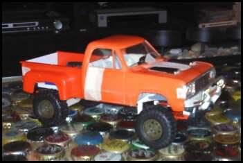

Hoping this pic works!
http://i172.photobuc...werWagon001.jpg
Thats all I have available to post right now. Have to get my laptop fixed! grr!
I am working on that one and a Lil Red Express turned 4x4 right now.
More work being done to the LRE as that required saving the frame/chassis after a back chop years ago when I was a kid. IMO I did a remarkable save to it, just wish I could get some pics of it postyed, and soon, as I would like some feedback on it.
Hoping to get some more pics up soon! Just wanted to get a teaser out to everyone!

I haven't done much work to the one pictured. Seem whoever apinted it before I got my hands on it painted it with some kind of paint which so far is resisting the stripping powes of the Purple Power. grr!
I have heard of using Oven cleaner, but I know that stuff is kinds potent, I have never used it, and I am resisting using it so far because I don't need anything eating away at these kits as they are getting expensive lately. Anyone else have any stripper ideas I could use?
Hope to get some pics of the Stepside soon! Been alot of reworking of things to get everything fitting to my liking.
The stepside will be painted Root Beer Brown metallic with real wood bed side inserts, with a lil smaller lift that the one pictured with TruXus M/T tires. The one above had the Super Swampers on it.
The sidestep will also be my 1st attempt at building my own leaf springs. Haven't yet decided on what axles I will use on it. Leaning towards the box stock axles, but i do have another set of Rockfords I could use.
The fleetside pictured will be mostly just rebuild with a surprise under the hood if I can get my hands on the powerplant!

finally a pic! crummy cell pic but a pic!
Scale 8" lift on scale 37's!
I cut out the scoop from the old MPC monster truck kit and filled it in along with the openings for the zoomies. added hood scoops from the 71 duster.
Since this crummy cell phone pic I have redone the front suspension, scratching up some more realistic arched leaf springs.
The front bumper is from a diecast Humer I have modified slightly to my liking.
she will have a fuel injected 440 backed up by a 727. T-case will be married and came from a SoReal chevy diecast I bought solely for the wheels and t-case. lol!
More done to her to get her to look like this than what you can see from the pic! Hopefully more soon!
