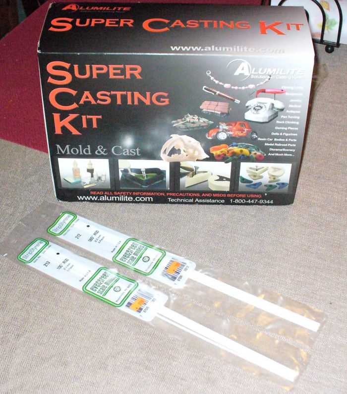

Yep, that's Evergreen rod and a resin casting kit. Sure enough, I am going to learn how to cast parts in resin (and don't even think I'm going to become one of those people that make copies of other people's parts and sells them - this is strictly for my own purposes). So, there we have it - my new project. This should take me some time...;)

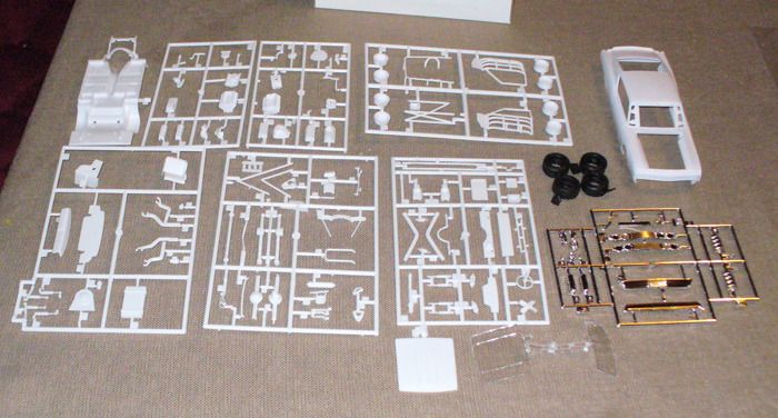

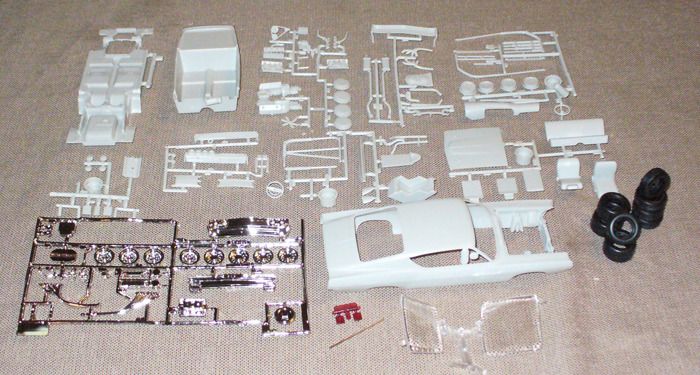

So here's a comparison of the two kits. First up is the Polar Lights Talladega:
You can compare the parts count and pieces to the AMT Torino:

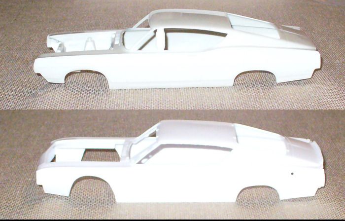

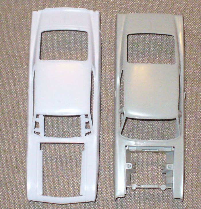

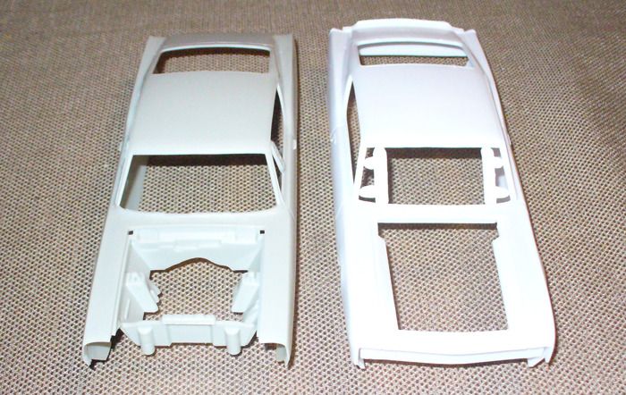

But what's most important, I think, are the bodies. Here we have a comparison of the bodies between the Talladega and the Torino:
First things that pop out to me are the following:
1) I will have to cut out the inner fender walls and that terrible radiator support on the AMT car and scratch build a new radiator support. Okay - I need to find those sheets of Evergreen styrene.
2) Lots of sanding is required on the AMT body to get rid of the emblems, trim behind the windows, etc. I am sure there are other things but these two pop out at me.

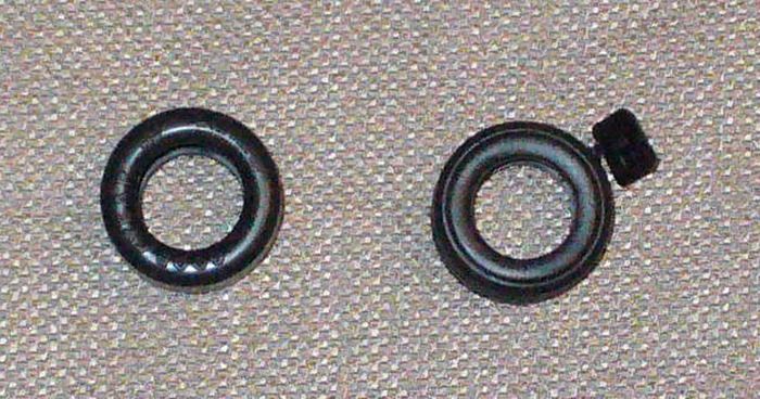

Okay - one final note:
While comparing the two kits, I realized the huge difference between the racing slicks in the AMT kit and the ones that come in the Polar Lights kit. The AMT kit has nice Goodyear slicks, while the PL kit has blank, no name, generic-looking slicks. Hmmm... AMT beats the PL kit in one respect so far.

Actually AMT is probably behind, as those tires are from a much later era, so they are totally wrong for the cars you're building, unless you want to represent them as modern day "vintage racers" in that case you would have to add a few things such as a rear tail light in the back window opening, as these cars are used on road race circuits, & are required to meet SCCA rules.

well, okay then - thanks for that info. I guess the AMT tires are not so good for what I am doing, then.

The tires in the AMT kit are way too big, and the wheels are too deep, especially if you don't cut out the front inner fenders on the Torino kit. (I've got one of those built that had problems because of that.) The correct tires for that car are treaded ones, like in the PL kit, anyway. You could cast up a set of wheels and tires from the PL kit, or use some wheels and tires from PPP to use on the Torino to make your life easier, and make it more correct.
Hope this helps.

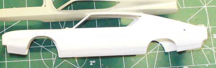

I know you said you were building the Polar Lights kit OOB, but it bears mentioning that the body is kinda goofy....the front fenders slant uphill. To make it look right, you'll need to "bend" them back down. I was beginning on that same kit, and somehow lost the body. Looking forward to watching your build.

When I did my Torino's, when it came time to bend the nose down, I did it this way
1) I cut releaf cuts in the left and right engine compartment panels to make the bends easyer.
2) Put the nose in boiling water for one minute and remove and GENTLEY BEND the nose down. You might need to repete the process more then once.
3) When the nose looks right , run the body under cold water to set it.
4) Let cool for a couple of hours before starting to work on the body.

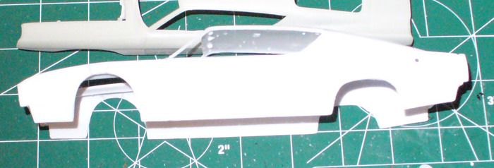

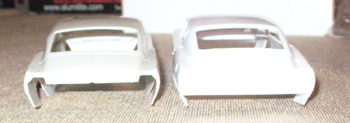

And the final update of the night. I have fixed the upward curvature of the fenders on the Talladega. Here is the before shot:

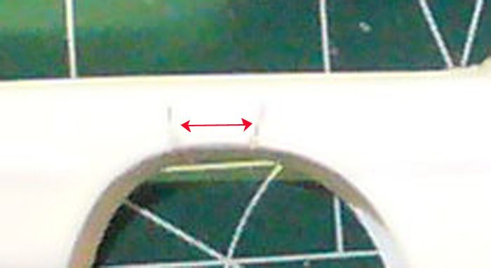

Here's where I made a couple of small cuts on the fenders to make bending easier:
I then used Douglas's suggestion and dipped it in hot water for a few, bent it into shape, then put it under cold water. Here it is now with the upward curve resolved. I may still have to make some adjustments, but it's getting there:
You can also see in that pic that the inner fenders on the Torino are being removed. I'm not done with that yet, so no full on pics of it yet. I have also sanded down all the trim, emblems, side reflectors, and front turn signals and I have drilled a hole in the rear fender for the gas cap. More to come...
