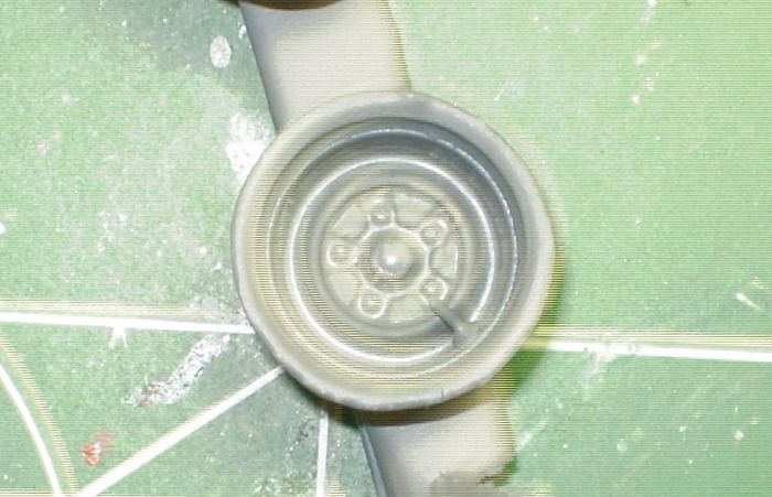

Thanks for the comments, Bruce. I appreciate. it. Not alot to post today - been sanding and cleaning up the resin parts that I cast. Here's one of the wheels freshly primered and getting all ready for paint:
Nice thing about getting to the primer stage - it helps show you where you still need some work. Forgive the quality of my pictures - this was the best picture out of four of them that I tried -yes, this camera sucks

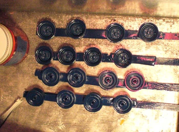

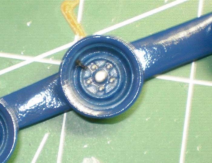

I do have an update - all eight wheels have received the basic paint now. Unlike the Belvedere I did previously, the cars this year had either black or dark blue wheels. I decided to go with the dark blue. Here's a pic of the wheels so far. Note that there is really no red on these at all - that's just a reflection from within the spray booth. Sorry about that:

Not much to post tonight. I've been doing some sanding and prep getting the bodies all ready for paint. I did finish painting the wheels, though.
The blue is actually darker than this - the camera's flash kinda washed this out. Sorry about that.

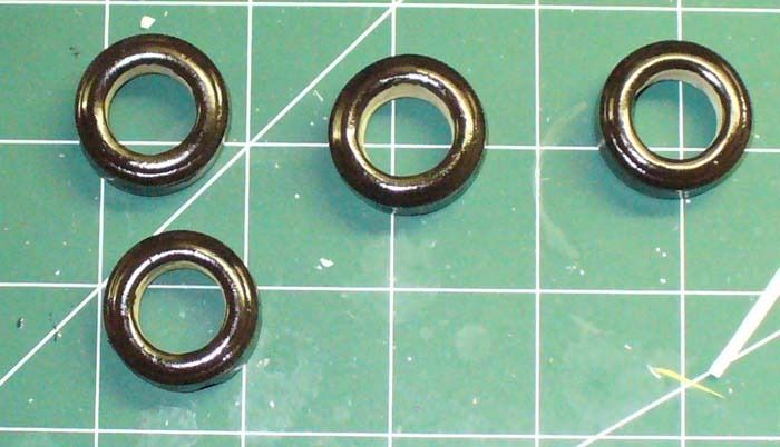

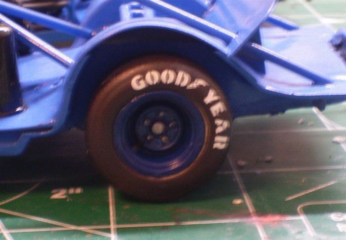

Well, after last night's little accident, I wanted to have something positive to post today. So, here's a picture of those resin-cast tires that I made - they are all ready for some decals and a nice flat coat:

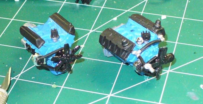

Here's the engines mostly complete, as well. They just need the top end finished off:
I haven't decided if I will wire them or not yet. I already put in the kit distributors, so that rules out what I normally do. I am still thinking I will maybe, but if I do then I am going to try a different way that I heard about. More on that later if I decide to go that way.

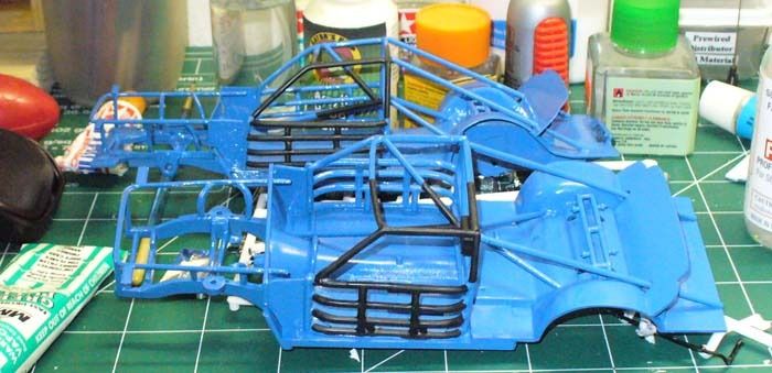

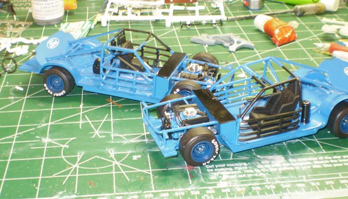

I also thought I would show some status pics of the chassis. They are coming along. I'm still kinda slow on all the scratch-building stuff, but they are getting together. The blue is actually a bit lighter than what shows in the pics - it's closer to the blue of the engines shown above.

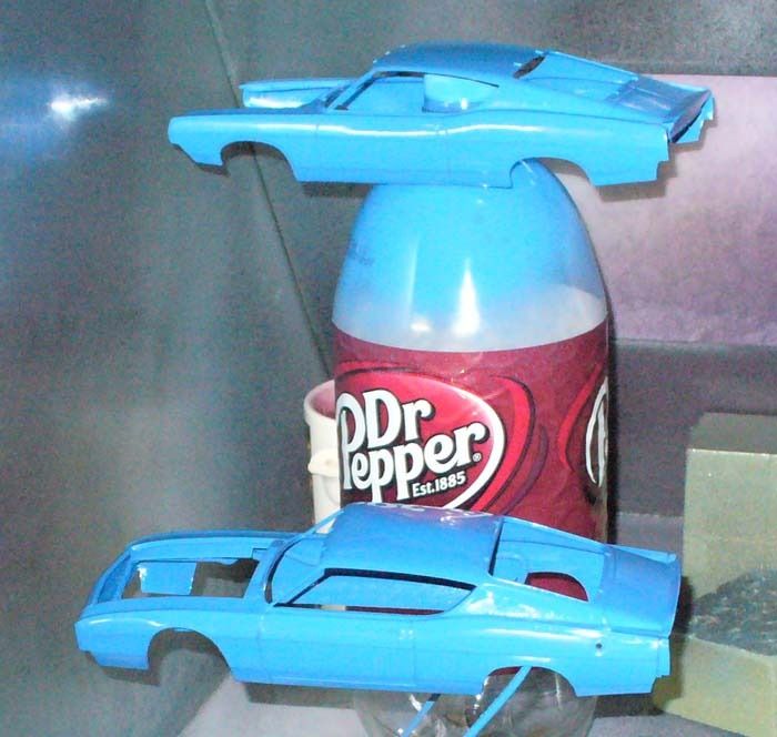

Finally, I started painting the bodies. Other than the fuel vents on both cars that I showed earlier and repositioning the gas cap on the Torino, I also added the little window clips around the frame on the Torino. Here they are in the spray booth, followed by a couple of shots of them by themselves. They do still need some work as I got a little orange peel in a few spots. On a side note, I have gotta stop taking pics in the spray booth as it throws the color off. These are showing lighter in color than they really are in the individual shots. Oh, well.... new camera is still on my wish list.

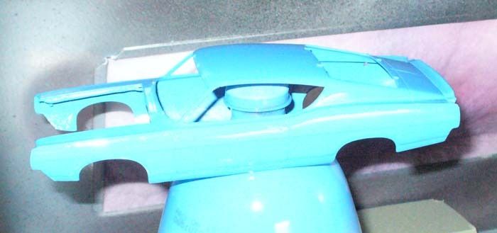

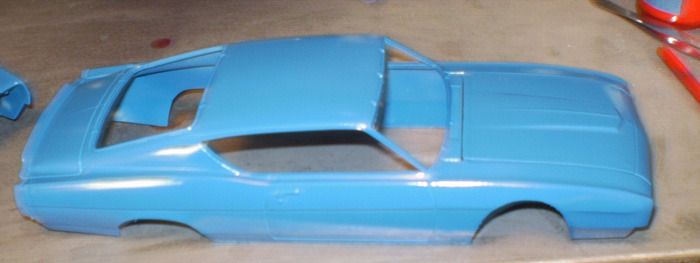

Thanks alot, Dan - I appreciate the comments. I did sand down the bodies last night, then primered 'em up - gotta lay the paint down again - I had a few bad orange peel spots show up. Hopefully it'll do better this time.

Well, I decided to wire up the engines after all - they just look too plain without it. Someone had suggested using firm wire that holds its shape, glue in the plugs first, then just shape the wire so it comes up to the distributor. You can then just glue the wire to the distributor.
I thought, "What the heck? I've tried it other ways and it's not too bad - let's try it this way". Gluing the spark plug boots in went well. I then started to bend the wire to route all the wires to the distributor. I gave them all a nice little curve at the end so they all went down onto the little nubs of the distributor cap. Then I took a little superglue and dropped it onto the distributor cap to hold the wires in place. I had my finger holding things in place but when I moved my finger, all the wires on the distributor came loose.
So... we try again. Get all the wires into place on the distributor cap, finger holding everything in place, drop the superglue into place on top of the distributor cap, stand still to hold it. Then a brilliant idea hit me! Why not just spray some CA Activator in there so it gets solid and I don't have to hold it anymore? So, I pull it out and spray. Gently moving my finger, everything stays in place. Woo hoo!!
Then I try to remove my finger. Apparently, there was some CA on my fingertip when I sprayed the accelerator on. My finger was firmly glued to the wires coming out of the cap. So, I did what came naturally to me: I pried my fingers off the wires leaving a nice sheet of skin behind. Now my plug wires coming out of the distributor have a wonderful little cover on them. Oh, well. Now I know better. I said at the beginning of this build that I was going to try new things. Next time, I may not try this again.

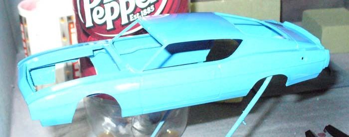

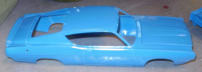

On a brighter note, I checked out the paint jobs on the two cars and no more orange peel finish. These are about ready for me to start foiling - woo hoo!! Here's the Torino:
And here's the Talladega:

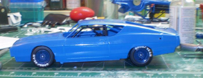

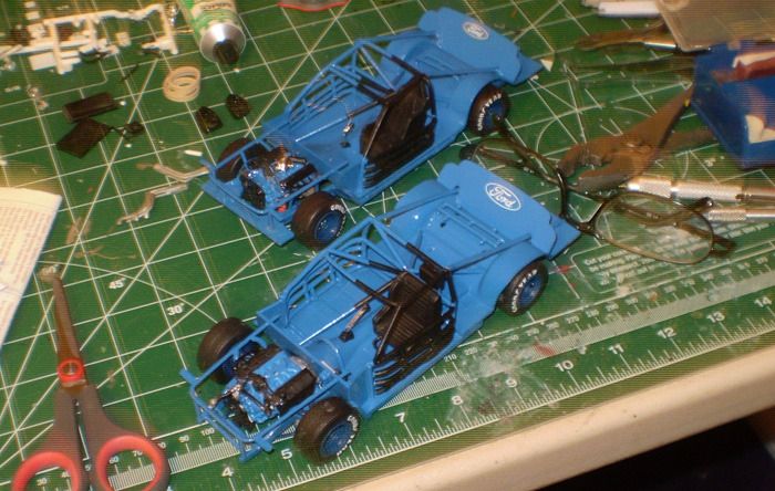

Well, the decals for the tires finally came in, so I was able to finish up the wheels today. Here's the two chassis sitting on the tires:

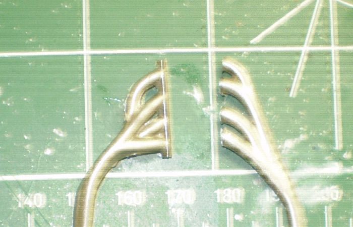

I was going to put the headers on, but I found that they stuck out way too far down. I knew this to be the case for the Talladega, but this is also the case for the Torino. I had to cut part of the header flange off in order to get the headers to fit tight up against the chassis instead of dragging on the ground. Here's an uncut header on the left and the modified header on the right:
Finally, I just had to do a mock-up to see how everything is fitting together so far. It's not coming out too badly:

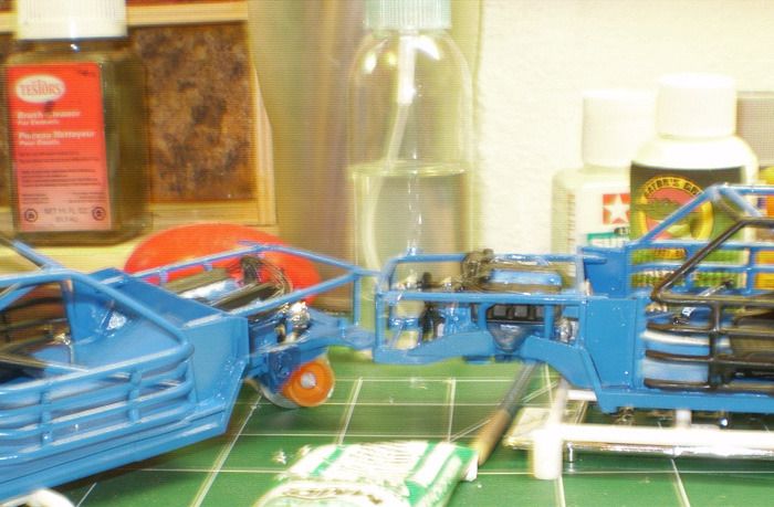

Well, I did get a little done today. Finally put together the rear end coolers that I made from resin and got those mounted, along with the air tank behind the driver's seat. I also made a couple of small adjustments to the mounting locations of the wheels so I could adjust the ride just a bit. Here's the chassis as they are right now - still a little bit left to do, but coming along:

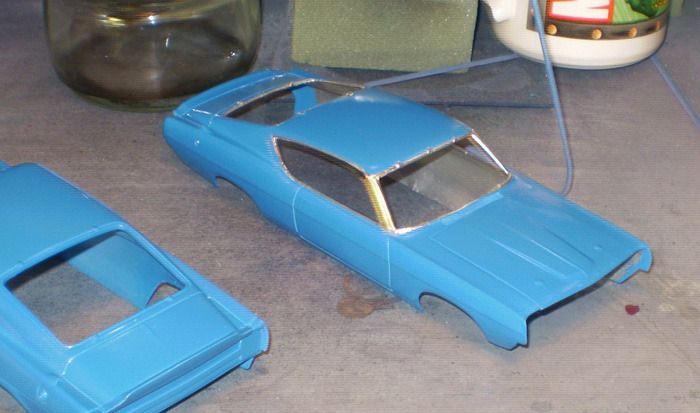

I also started foiling the windows on these cars. There is no side trim, so it's only the windows that needs the BMF on these two cars. Also, note that the interior is not painted Petty blue. One done - one to go:

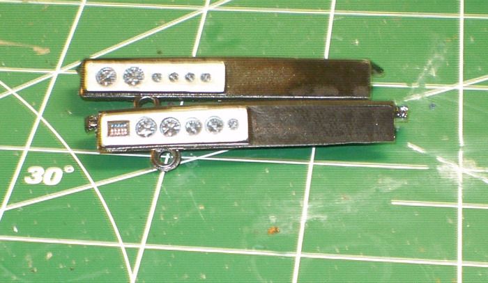

I finally finished up tonight by working on the dashes. I didn't make a resin copy of the Talladega dash, but I used the flat dash that came with the Torino instead. Since the gauges were different on these, I went ahead and just decided to just go with it. I did have to modify it a little to make it fit in the new rollcage I made, but overall I don't think it's too bad.
